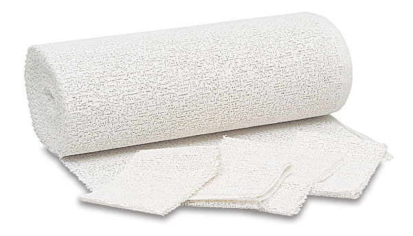

It won't stick to plaster, eh? Do you think I could use this stuff for molds? Or at least as a first step towards a mold then smoothing it out and such?
I wouldn't recommend using plaster bandages...your best bet is going to be to make your piece via a clay sculpt or other medium, and then remolding it out of plaster or hydrocal. making a solid piece ensures strength in the mold and many casts to follow. It also provides rigidity as when you suck the plastic down on top of it, the pressure will not buckle the piece or mold if it were just plaster bandages.
