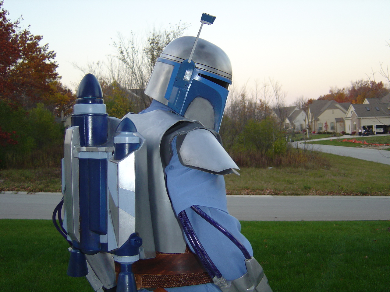

I made it. It heats up not quite as smoothly as sintra but it does work. I was able to shape my back plate pretty well. It's plastic, ya know...garbage cans..it won't stop bullets but it's **** strong. It won't break. It's actually preferable to my sintra armor as I find it more durable.
It paints well with layering and you can sand it just as smooth although it will take a bit longer and more work to get the surface there. Above all, it's cheap, very available and easy. If you make a mistake go buy another 5 dollar trashcan and make another whole set.
Here are some pics of my Jango set I made for Halloween
Hope this helps.
Nice pics, Rupidupe! (and I'll add nice pose for the first one!)
