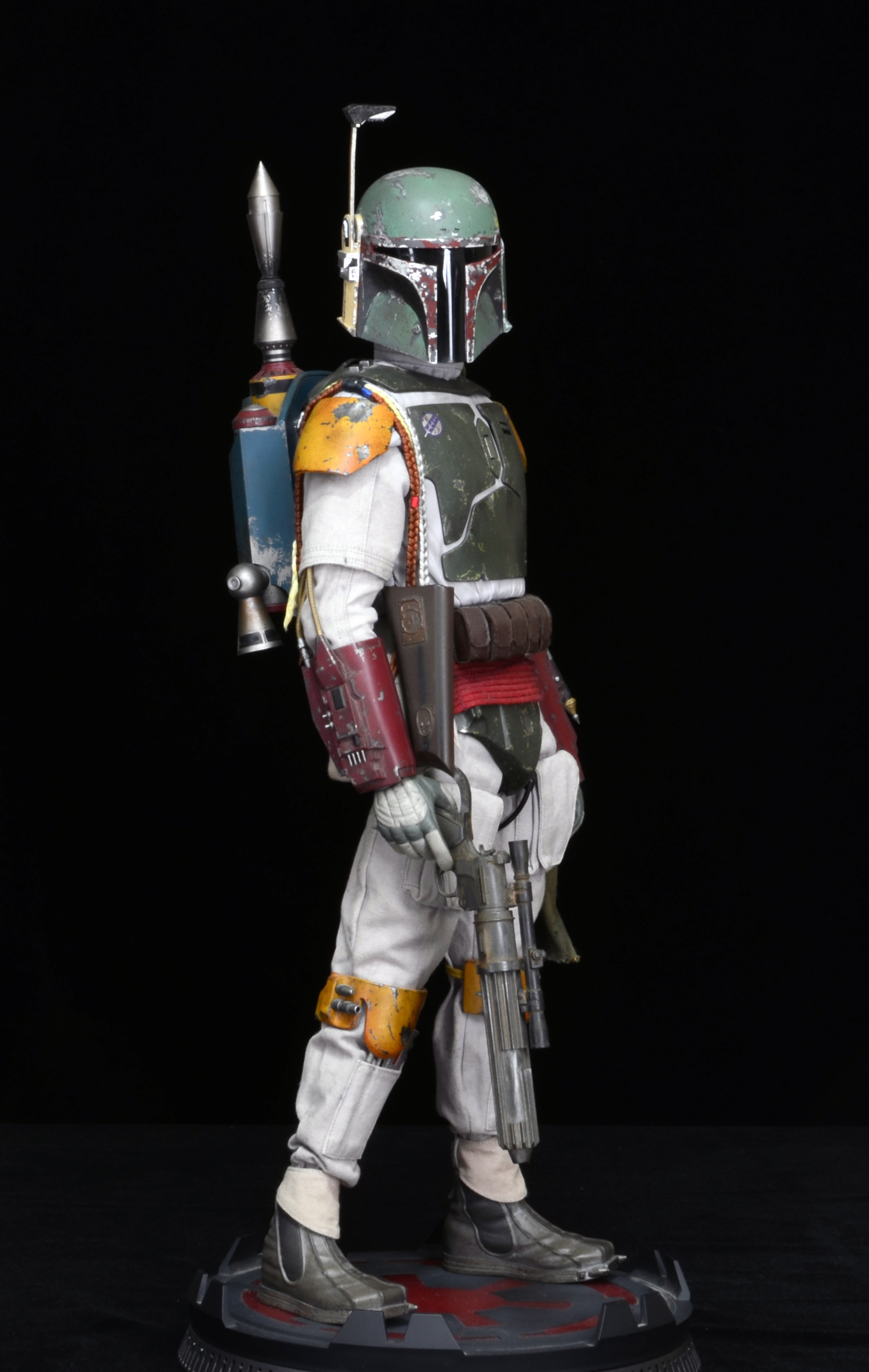

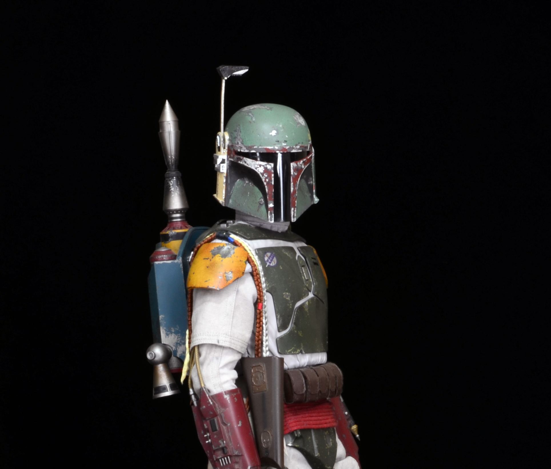

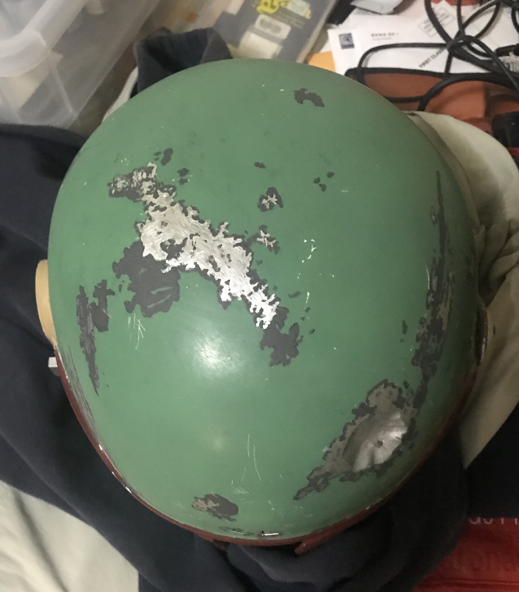

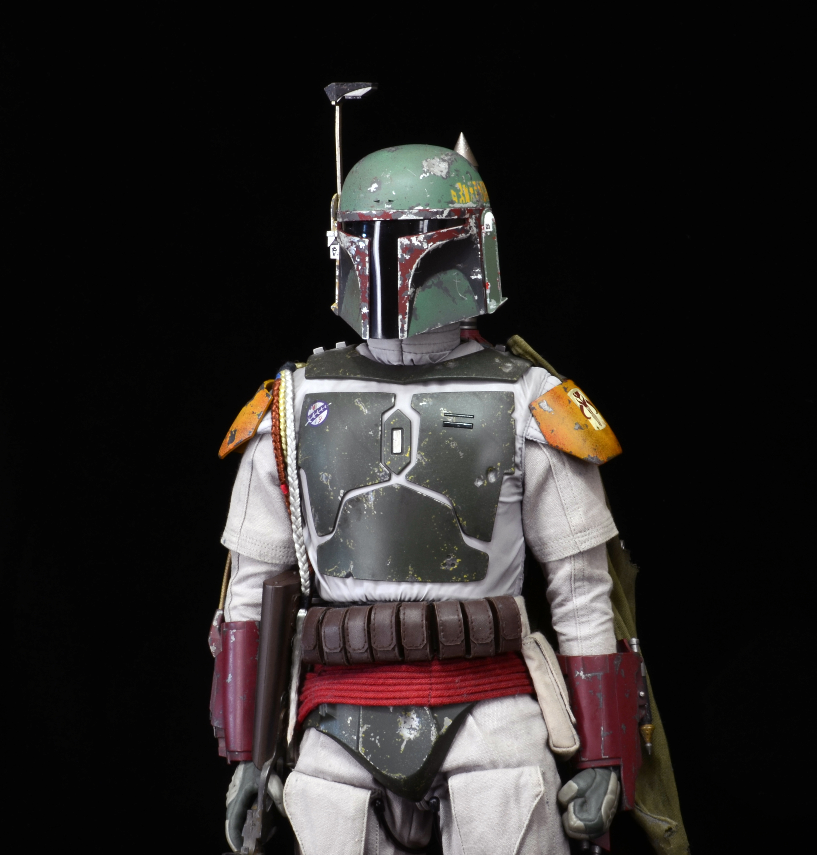

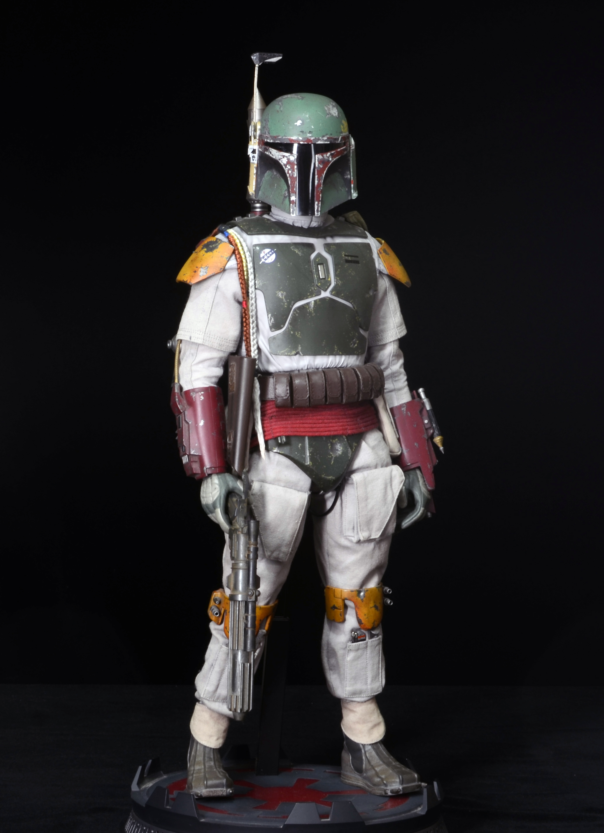

I’ve repainted a spare Hot Toys 1/4 helmet with the Archive X colors, minus the upper cheek area and the brown splatters and yellowish areas around the helmet. I misted heavily on the dome and cheeks, using ONLY their Lark Dark. More colors mixed into the dome and cheeks would’ve been preferable, but I was satisfied with the outcome. The misting definitely transforms the vibrancy of the Light Green. I’m working on a 1:1 helmet using the same colors, as well.

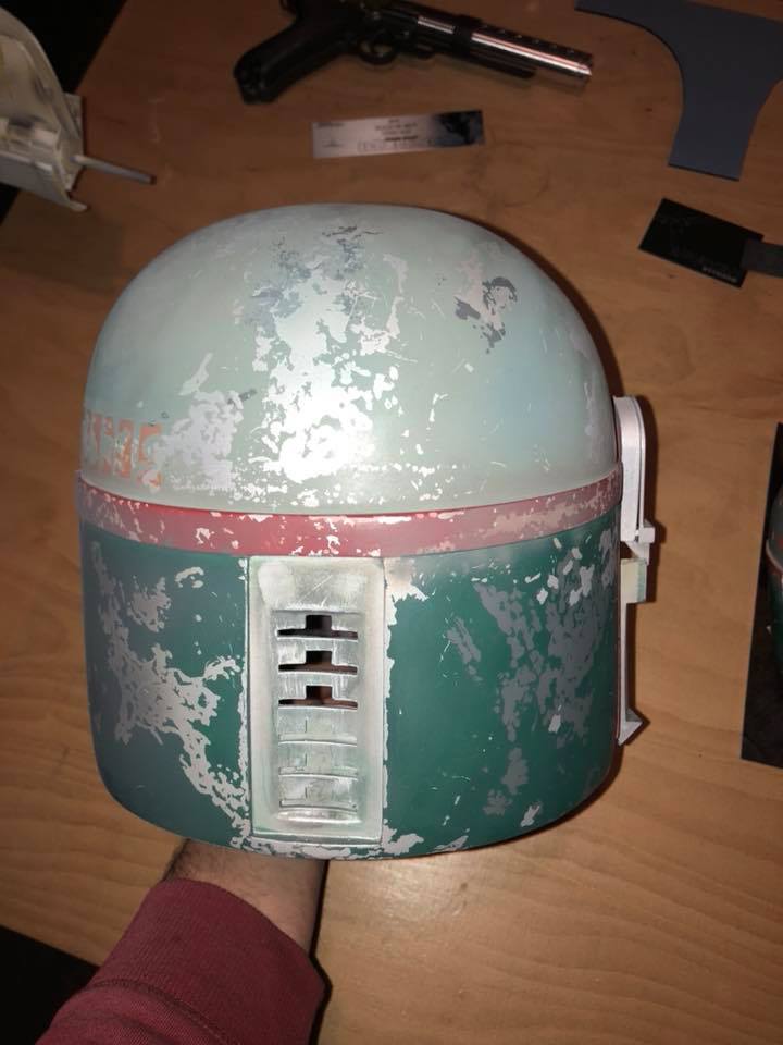

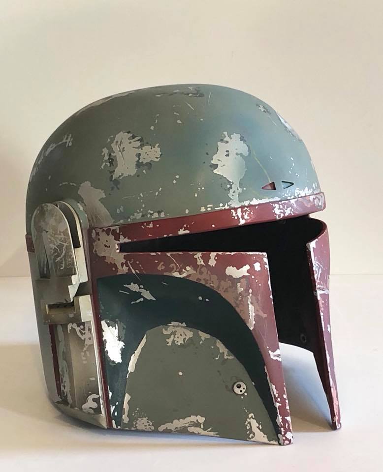

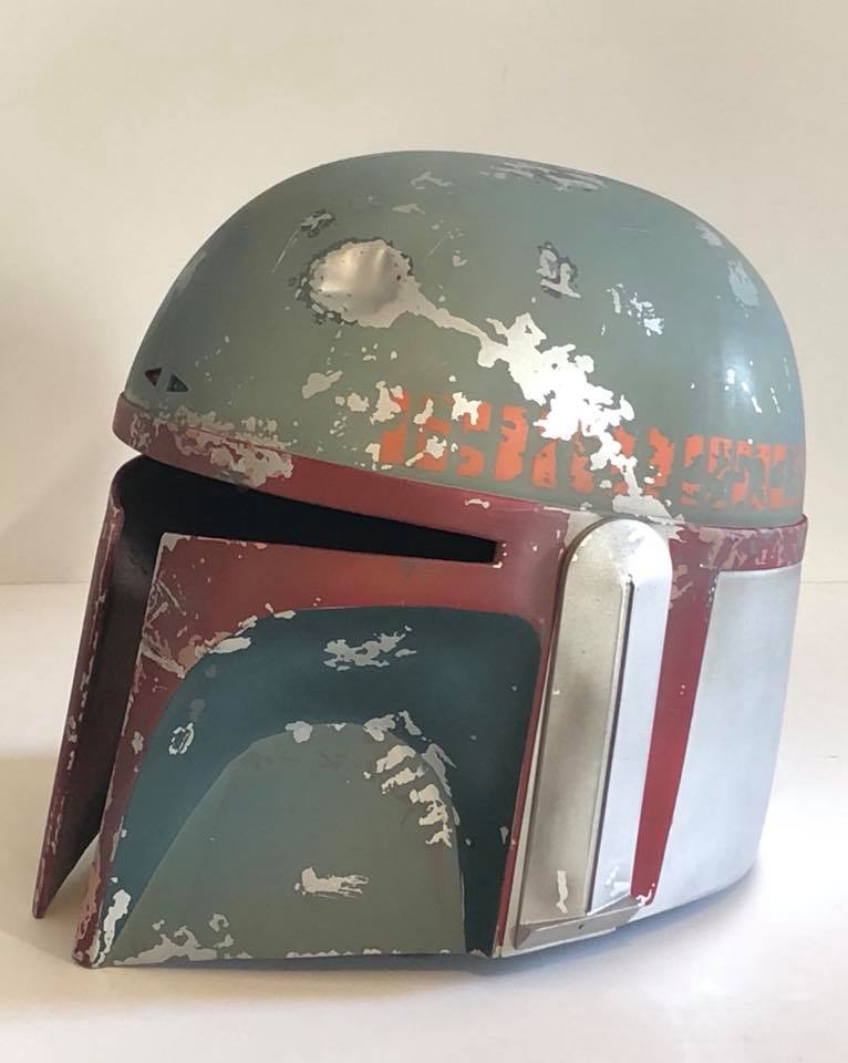

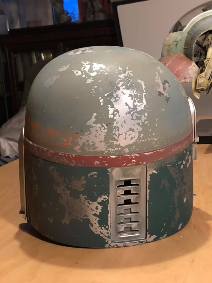

Lovely to See the PP2 getting some Archive-X love, beautiful and very quick work by John Simmons, his first helmet and hopefully not last
Using GN Grey Green and grime mix with Dark Green and d&H caboose red misted or darkened with engine black. John has made a blue ish mix for the misting coat but Reefer grey would be a great replacement too. Reefer orange for the kill stripes. Even nicer was Sandy herself sent her approval in a message.

Just to be clear here. The upper cheeks were painted Brunswick Green but you're offering Engine Black instead? Or Engine Black was used on them?
What color was used on the left ear? Is it the light green alone or is it a mix? I know the rust spattering changes the tone to more of a medium green/olive color but just want to know how the 2 distinctive greens have been derived and is Jon open to giving out his ratios for his final base colors before weathering.
I was told that it was the light green as a base then altered slightly with misting/toning/weathering, though I did not get details on the colors used for that process. IMO, coach green is a solid match for how the left ear appears on screen.
Thank you for the reply. I will investigate the coach green.

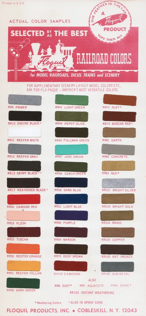

Looks like coach green is a lighter color now than what it was in 1975 in order to be the right color? I would assume the light green by their direction is correct. Don't want to hijack this thread so I hope they can elaborate on the actual color used or combination of colors.
