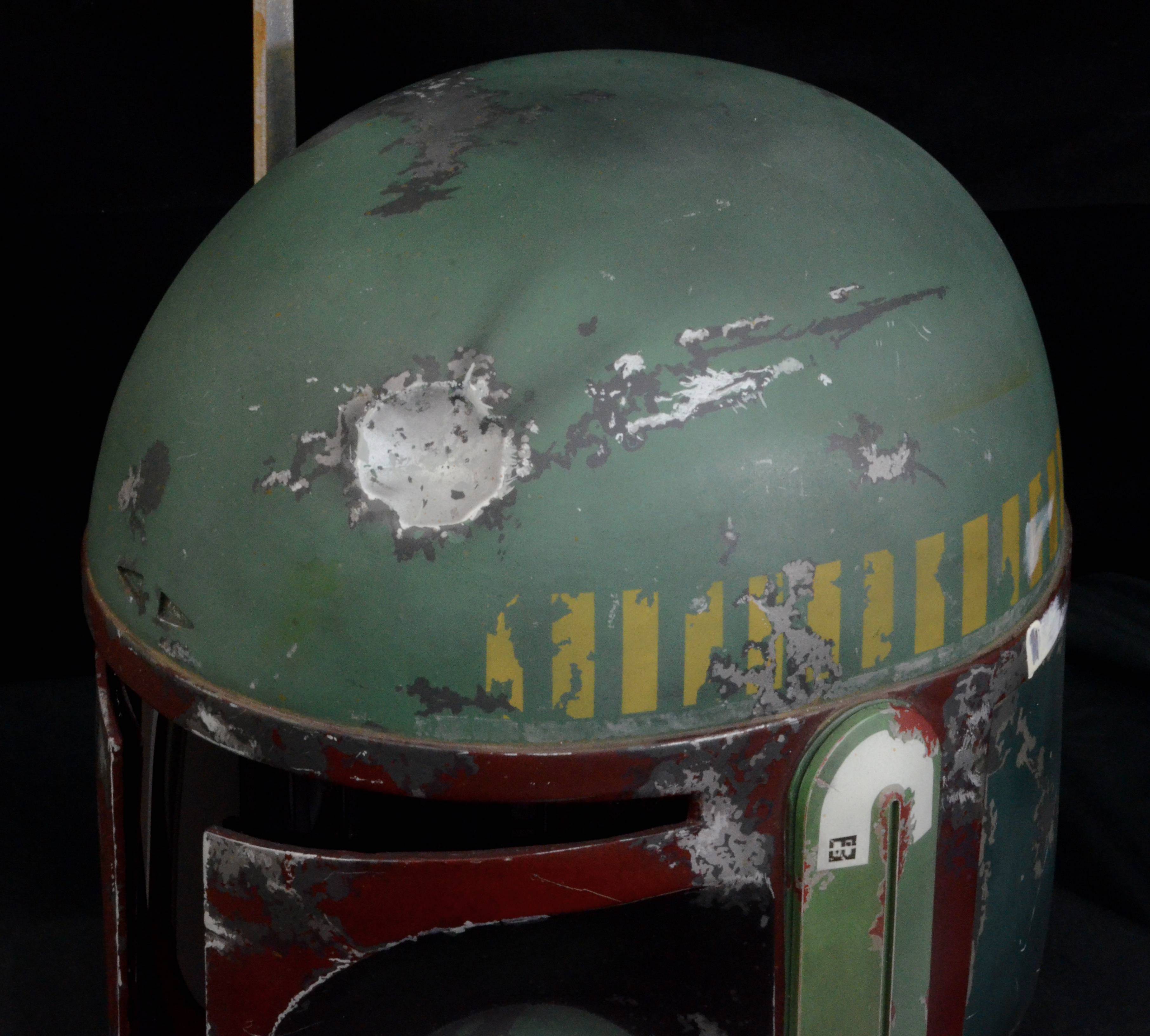

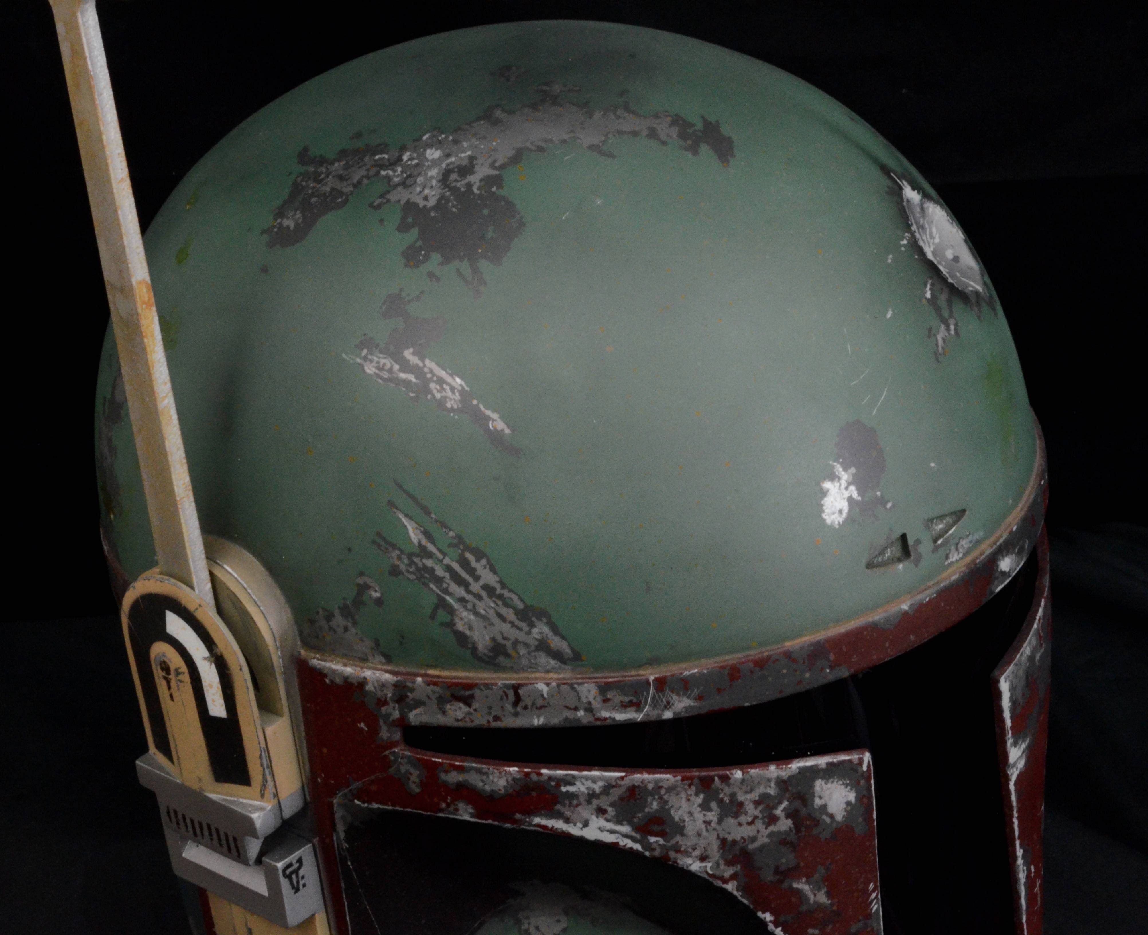

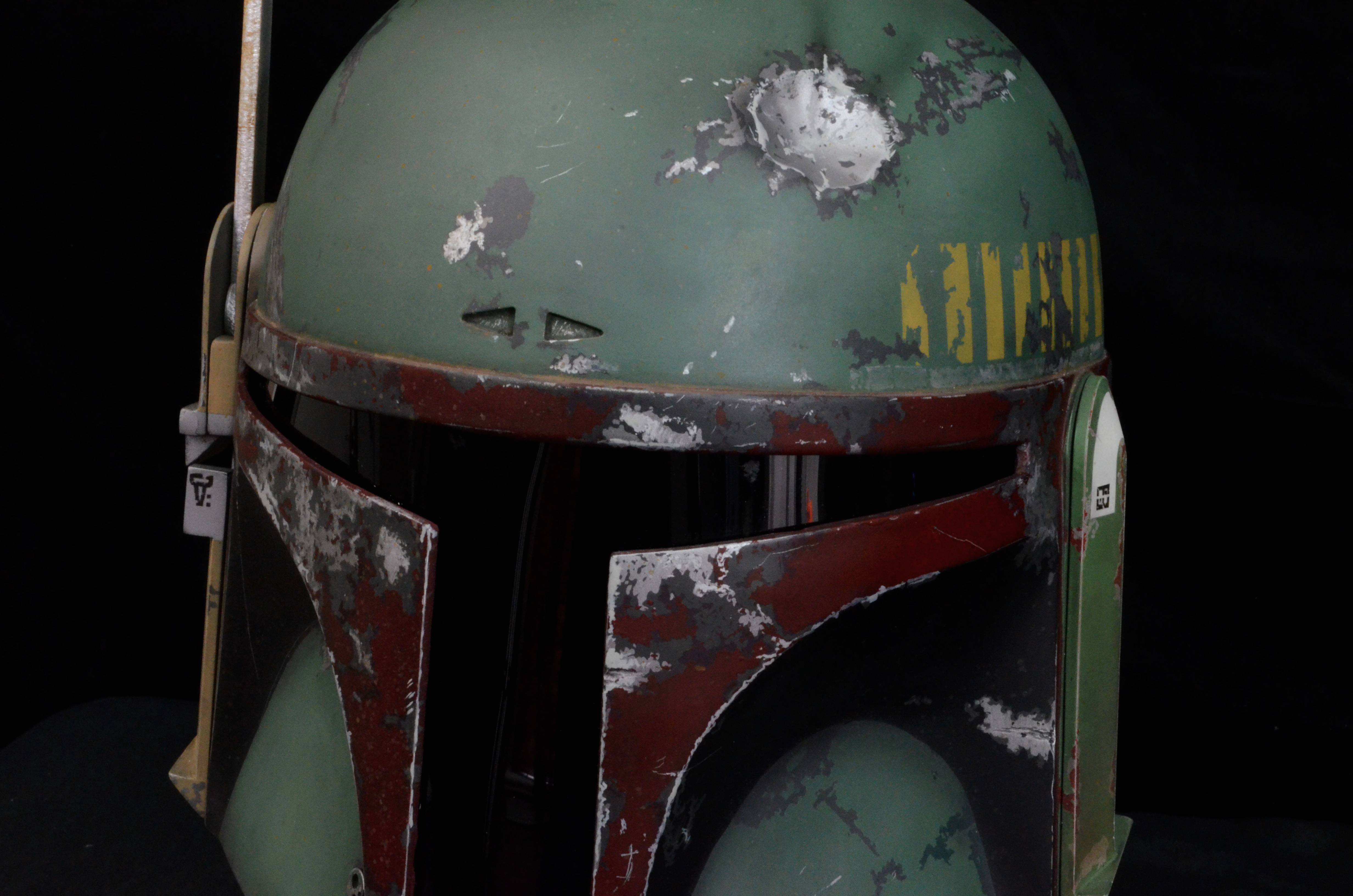

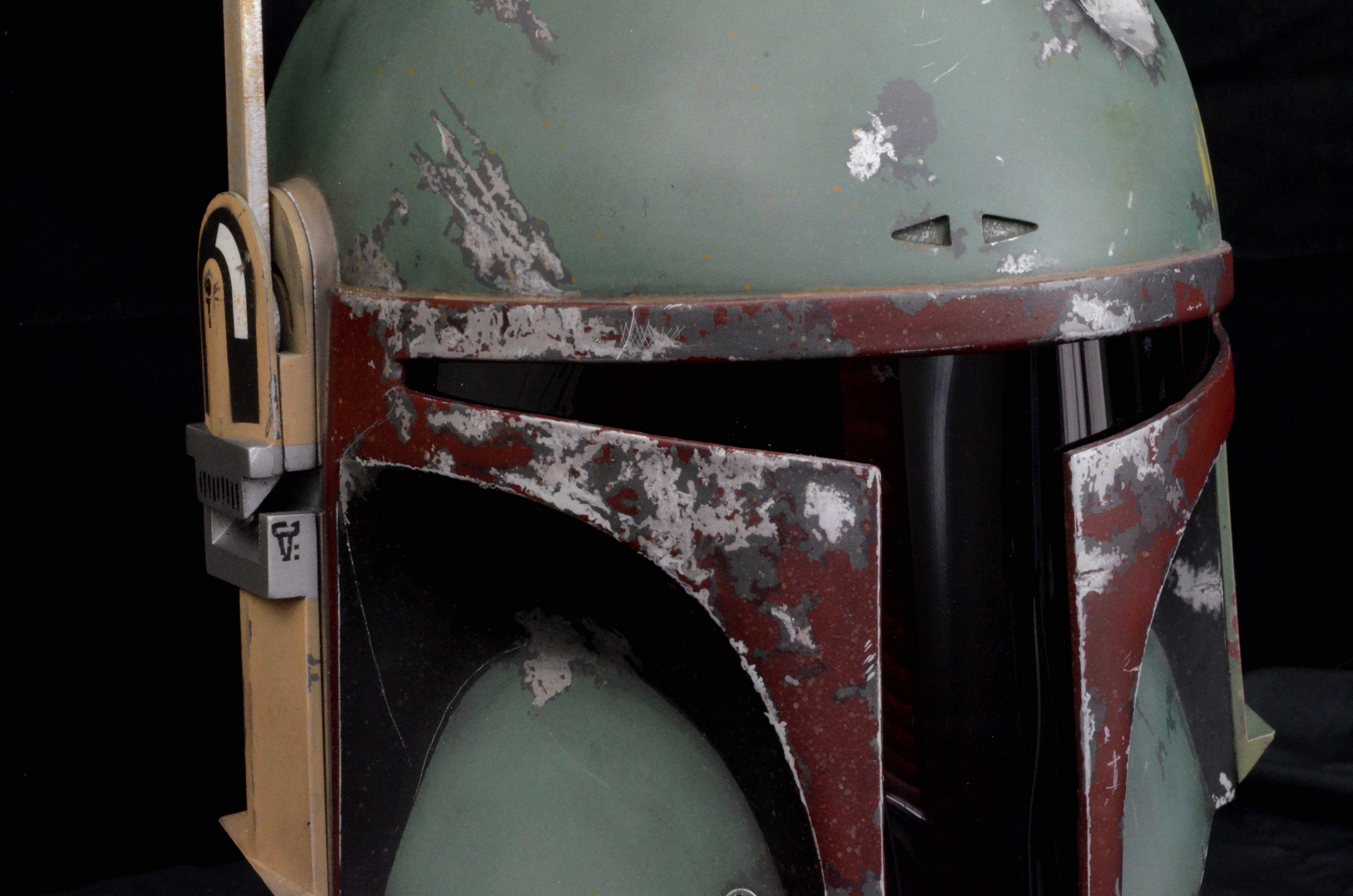

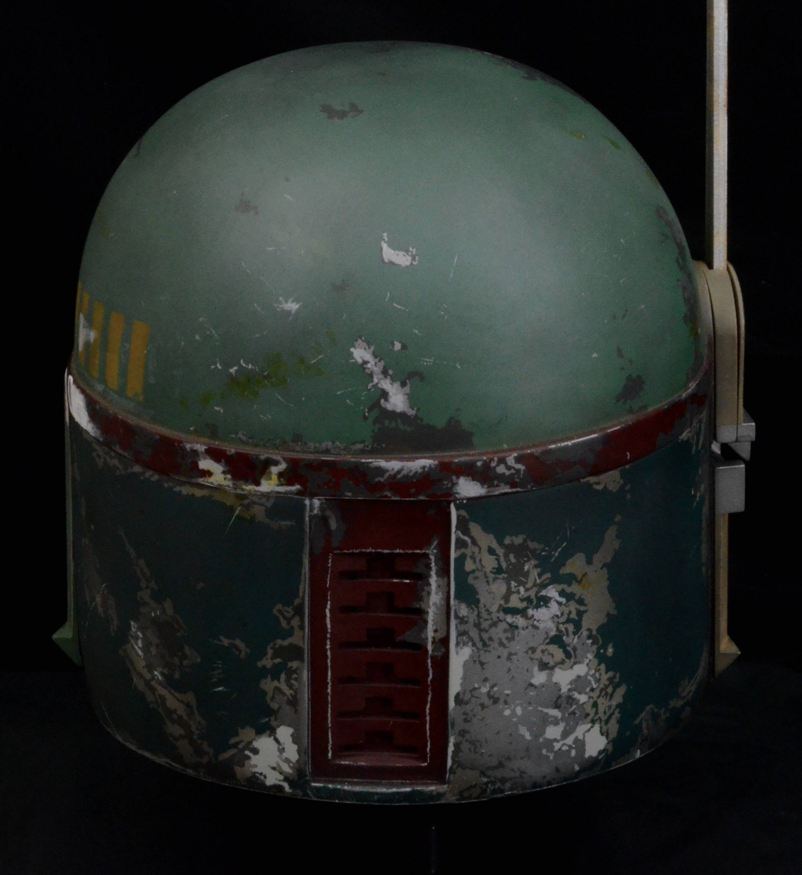

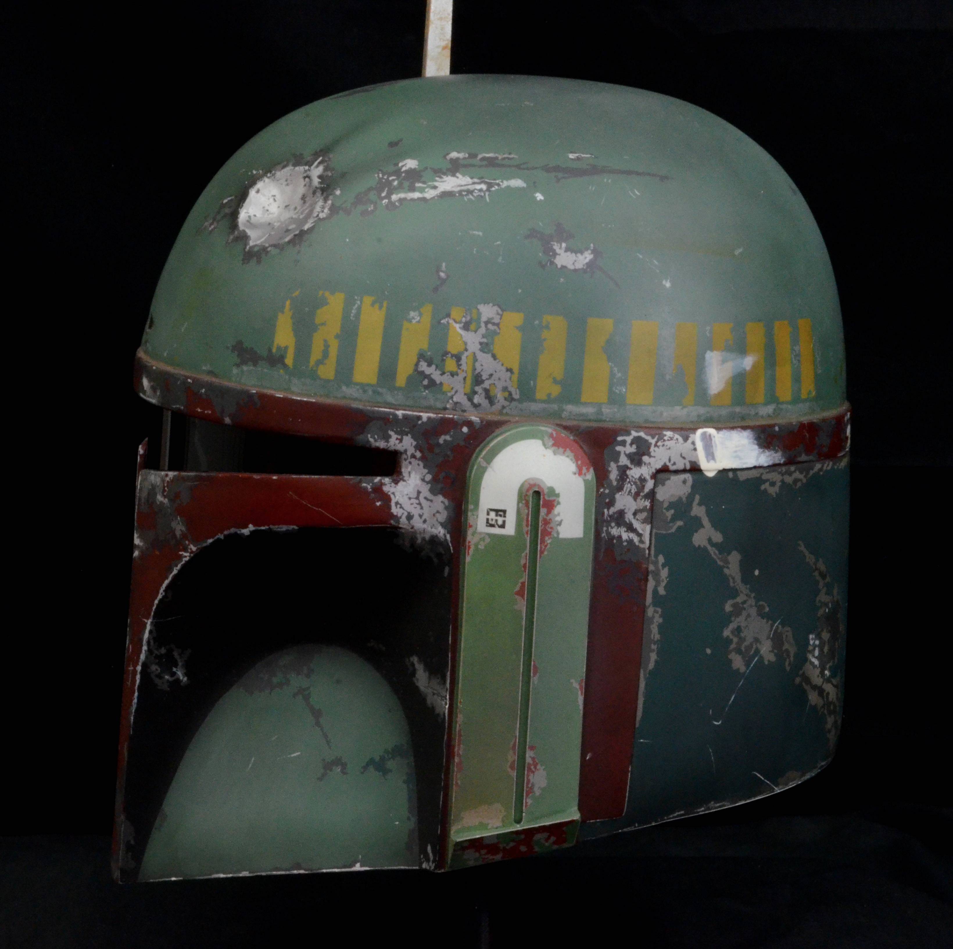

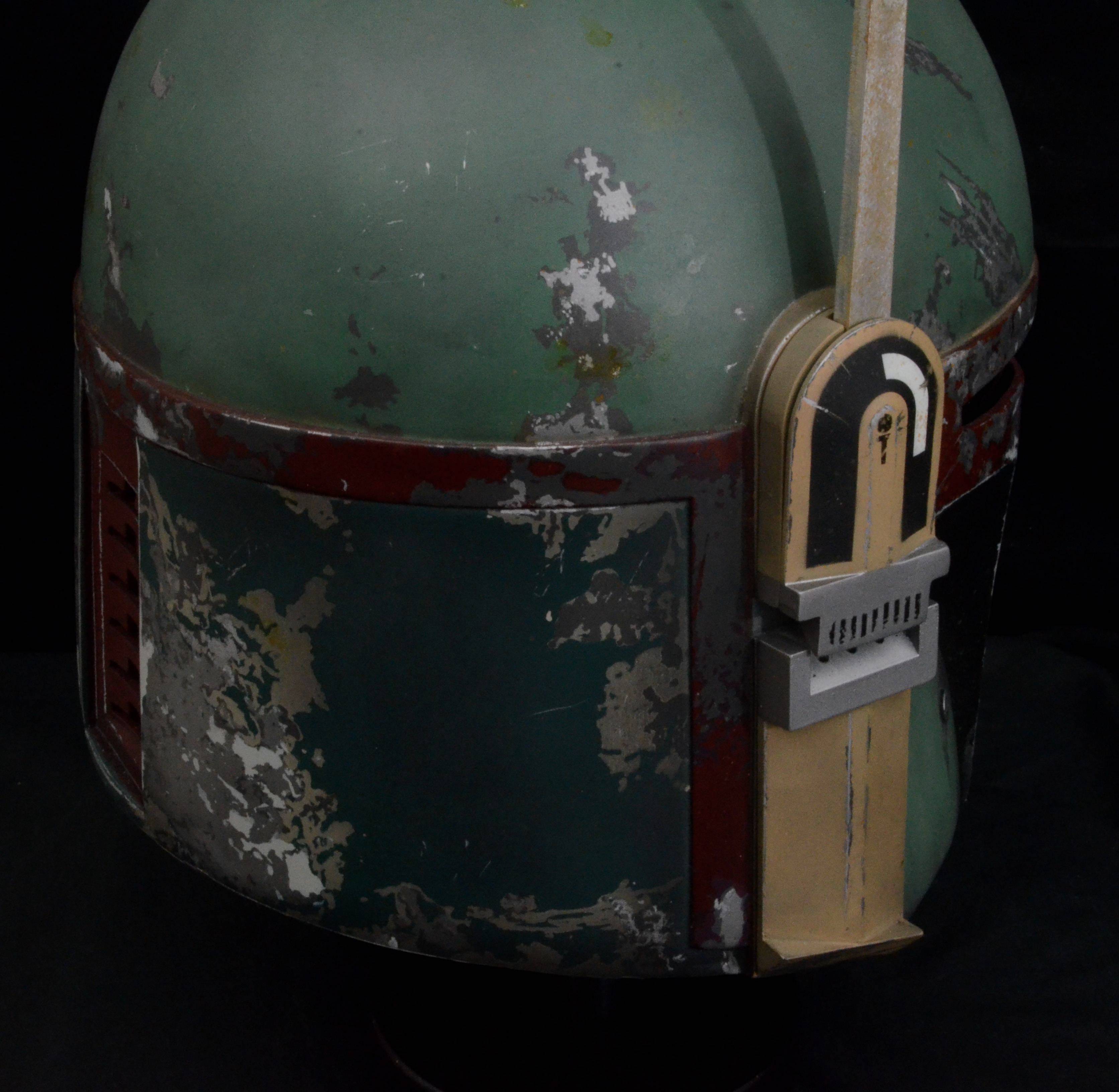

Im so pleased with how this turned out especially as most of the hero colours are now known to be a match to the vintage Floquil Hues, Still got some tweeks to be made on the next one but its looking rather special I think, Its painted by Jon Bird here in the Uk and resides in its new home in the USA now. Cant wait to try this myself now and get a few more done to see how far we can take it. Really hope you enjoy looking at this as much as I do. All vintage Floquil Hues aside from the silver base and all from our range, a few new colours will be added asap that we know are even closer than our current line, Rome wasn't built in a day !! This paint up is the start of some really interesting developments and Jon has done an amazing job at capturing the feel of Joe's work.

Colours used here
1975 D&H caboose red, confirmed to be the correct red for Fett helmets from ESB
1965 Earth or Earth Lt as we call it, again confirmed to be the correct ear colour
1975 Rust
1975 Engine black, though Jon did use Brunswick Green on this helmet for the black
1975 Dark Green.......
We experimented for a long time with the green on the rear and realised that when its mixed with Engine black it is identical to the rear, though mixing wasn't that common, after huge amounts of Floquil research there was just no colour that did the rear back in the day. So when the mixing theory was tried it just worked and is also matched, its possible its layered with black over the green but to get the translucent look it's likely a mix. The red Helemt can sometimes appear to have a dark Blue to it, this is the effect of the added Engine black
Dark Grime.......
This is a colour that shifts time and time again in hue from year to year, we've always suspected it was Grime behind the Dark Green and its confirmed now with a new swatch of vintage grime we have, its a tiny bit darker than our current grime but the same colour, we're still deciding if its worth developing just for Fett but after weathering and the rust/yellow stains are applied you'd never tell the difference
1975 SP Lark Dark Grey....
for years its been suggested its Reefer Grey on the helmet, thats because the newer enamel range fro Floquil thats more common Reefer Grey is closer to the older SP lark dark than the old Reefer grey but it is not the same hue... SP Lark Dark is confirmed a match to the helmets
1975 Light Green.....
Is still up in the air if Light Green was the base for the dome and cheeks, Im adamant it is as so far every other colour is coming back as a vintage railroad colour, no military colours and some that are currently suggested weren't actually in production when the helmet was painted, though very nice and close not historically correct. Light Green is the only RR colour possible that could be the dome, but painted as JJ did back then its a maze of layers , opaque layers and misting and staining. Historically its obvious but the jury is still out
1975 SP Lettering Grey....
For the lighter Grey on the front thats topically painted, its possible that an older SP Lettering Grey was used but seems to have a lot of blue in it, not conclusive as yet though our 1975 SP Lettering Grey is the closest colour in our range
For the dark Marron, this again has been so frustrating as I see Maroon and also weathered black, Floquil vintage Maroon just isn't dark enough, we've bought many vintage bottles and can't get the results from them. In a test to match the colours we see on the helmet I decided to try the same theory as the Dark Green and the results where almost instant, be it historically correct I doubt we will ever know. mixing D&H Caboose with Engine Black gives the perfect dark Maroon colour that appears both red and Maroon and Brown in various lighting just as the original helmet.
1975 SP Armour Yellow......
for the kill stripes, it's also believed that UP Armour Yellow is contender for this but weathering will bring both closer together, I hope to have a good vintage UP Armour Yellow available if demand is there.
1975 Reefer White
The more I see the helmet the more I believe that Light Lark Grey is also used to distress and mist but tests need to be done
One thing that keeps occurring is that the Floquil weathering colours are used for weathering and also used for black colour, its a pattern with the ILM style that was formed by JJ
The reason we focus on vintage hues is they do not resemble the modern enamel range by Floquil in Hue, the name stays the same but the colours are different. Hence the Reefer grey situation
AT archive-X we are mostly focused on the historical choices as opposed to what is considered the norm. One thing though is that these colours raw are nothing like the mixes suggested that Ive seen and the key to any good Fett regardless of colour is the artist and their talents. Ive seen some incredible helmets done with all manor of paints but we prefer historically accurate asa starting point. seems like the best place to start for us.

Another theory that I believe from studying the ref is that the reds extend beneath the black in the cheeks, thats why you see a maroon shade to it in certain light, its the same on Slave 1 in many areas, they seem to just go over it, Im convinced there is some opacity to the black and beneath is Red and Grey. Ilm worked in very thin layers when layering, though the steps in the upper helmet on the paint lines are more solid, under the black was not as thick as just over the edge work and likely not masked off.

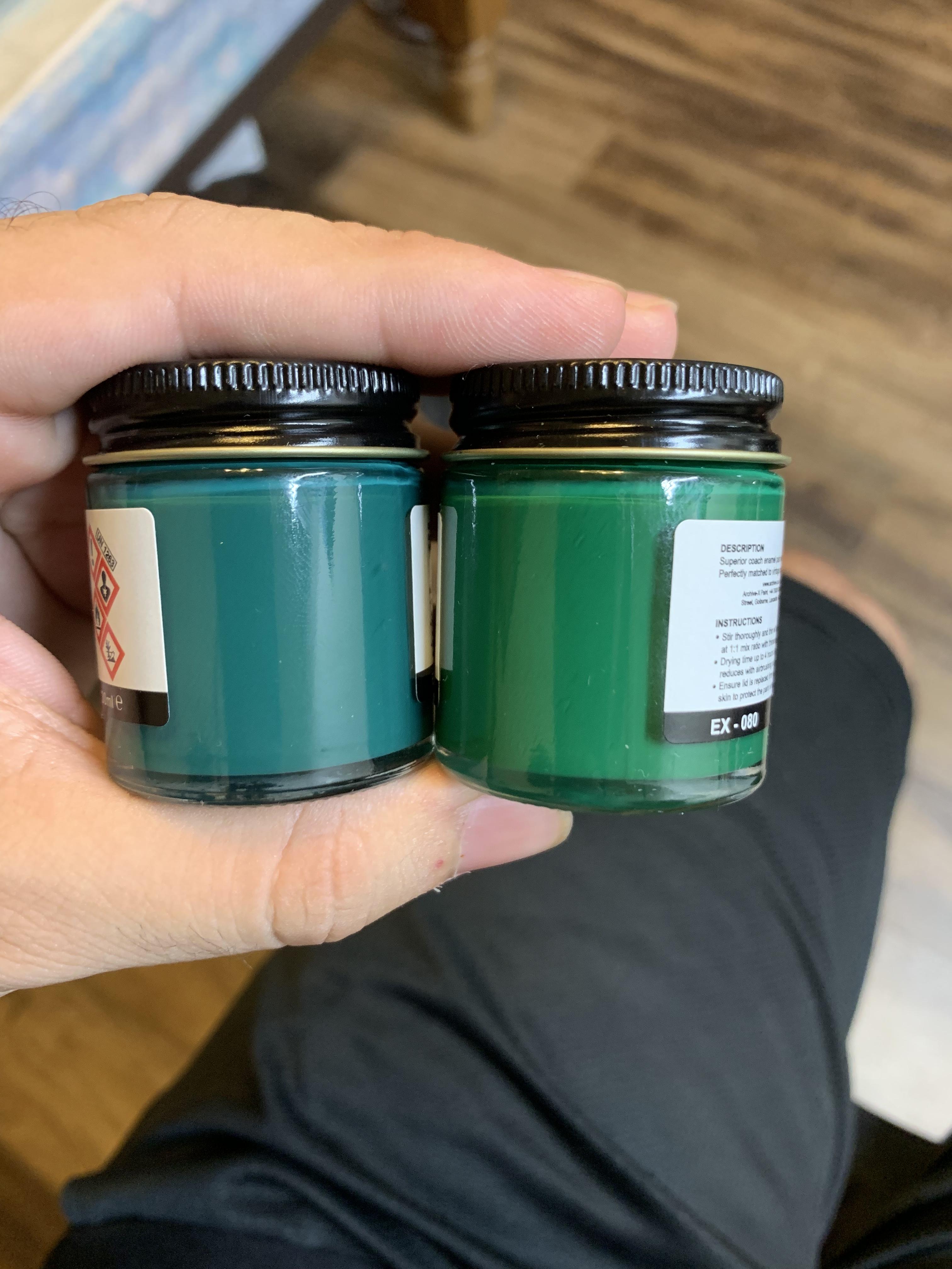

I ordered some of the 1975 Dark Green for my helmet, but also included in the package was another color labeled Dark Green (LT) EX-80. I didn't see it on the website and I don't know much about it, does it have any relevance to Fett? Looks like I could possibly use it for the armor although I’m not too sure about that match.
WhiteShadow
I ordered some of the 1975 Dark Green for my helmet, but also included in the package was another color labeled Dark Green (LT) EX-80. I didn't see it on the website and I don't know much about it, does it have any relevance to Fett? Looks like I could possibly use it for the armor although I’m not too sure about that match. View attachment 177528
Shhhhhhhhh.... Not so many questions. You got free paint... Time to melt into the shadows
ArchiveX
That was a gift as we had a slight delay sending your paint, its a colour we had done as a test that we're unlikely to run in the future. Some of the 60's colours are more accurate in hue to SW, but this was a little off, but you can see howe the colour developed over time as there is a stark difference, and that's the point of Archive-X to track down the correct hues
