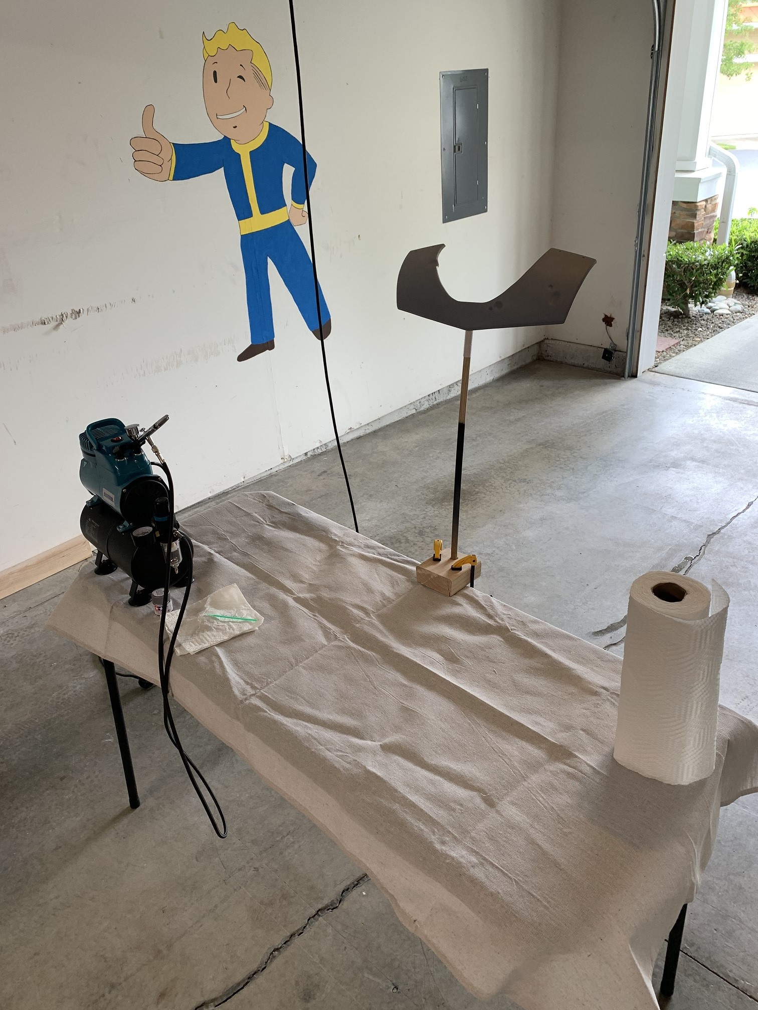

My Paint Station.....
I used the Tamiya Acrylic X-11 (Chrome Silver) And again, I didn't get any clogs and the iWata HP-CS didn't experience any type of spitting the paint due to the consistency of the paint. I ended up giving the Boba Fett Collar Armor two coats of this without issue.
