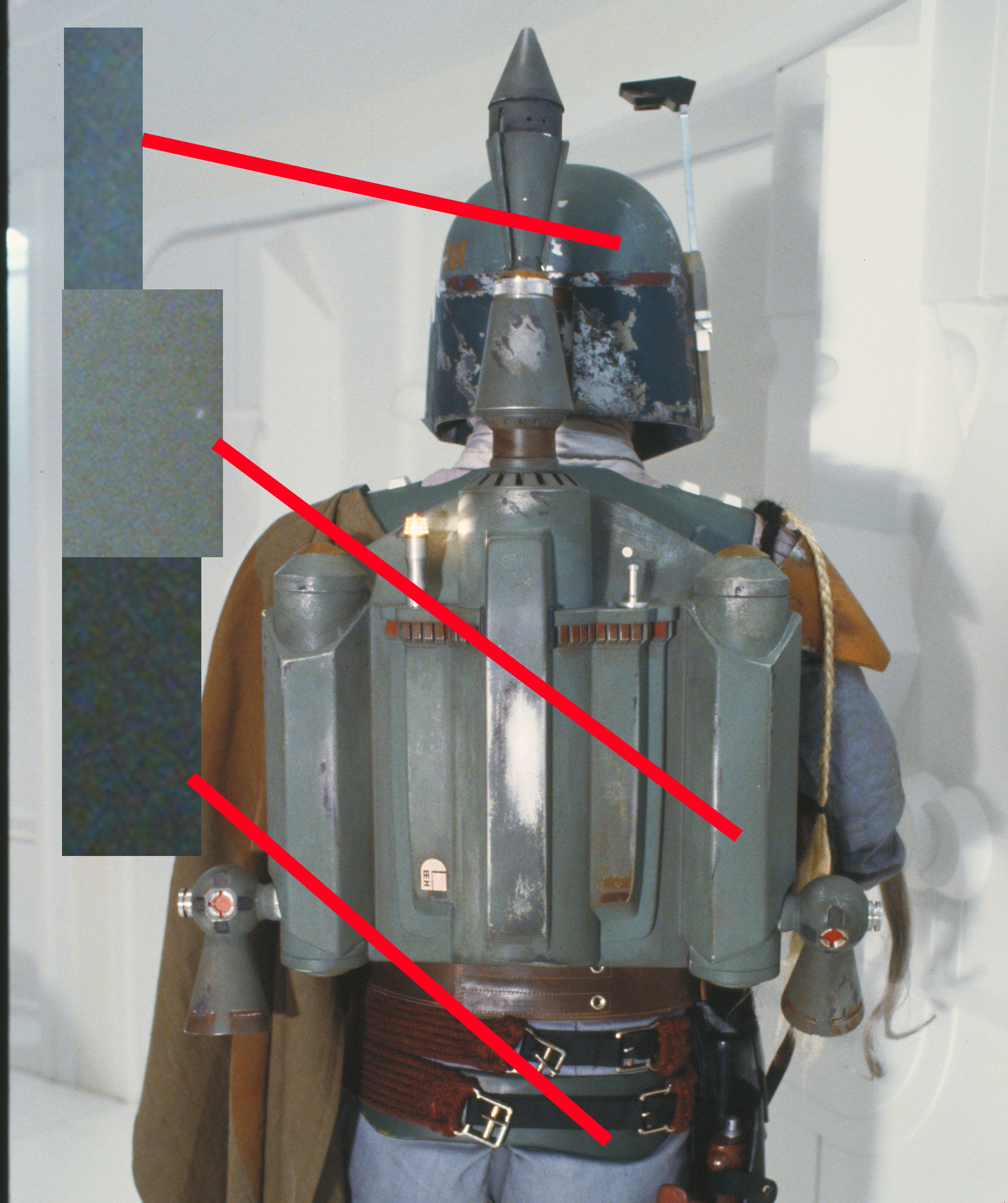

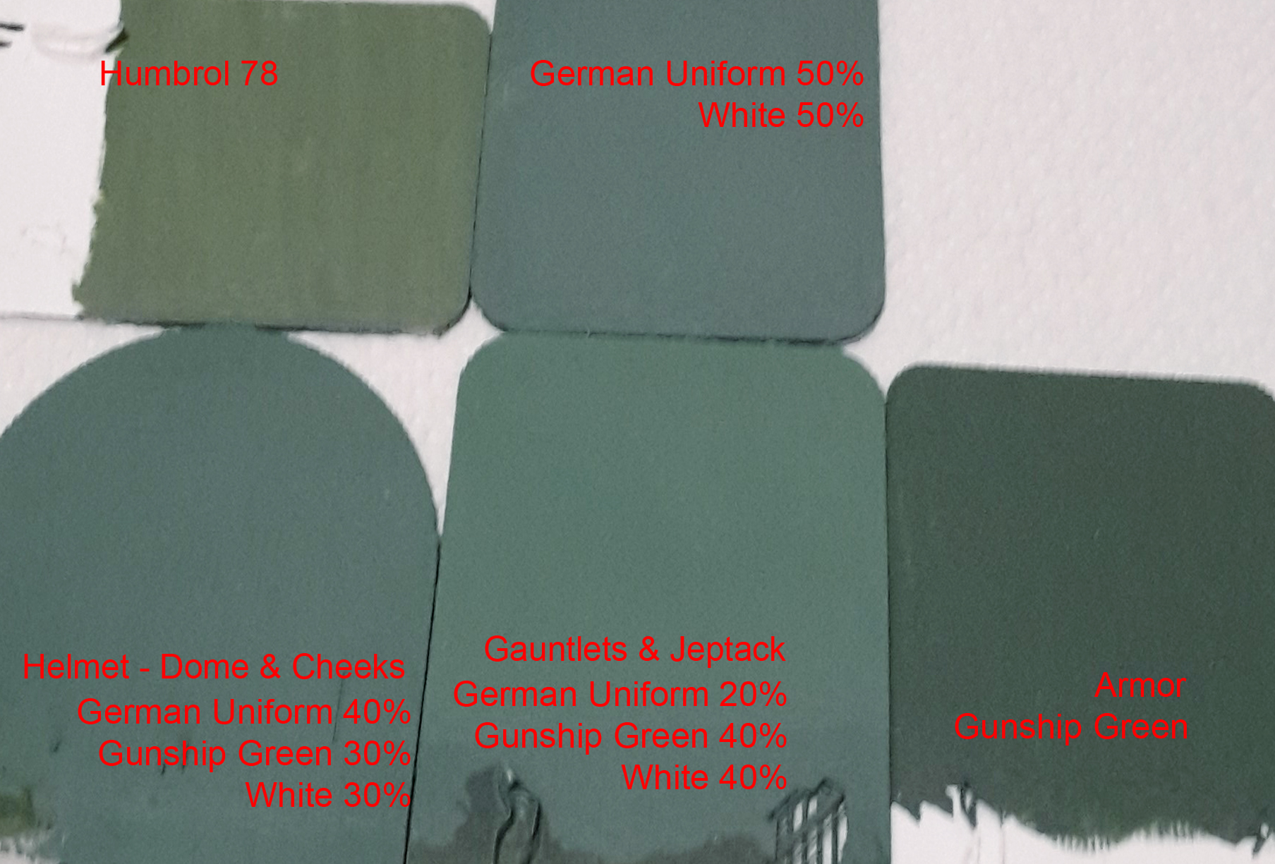

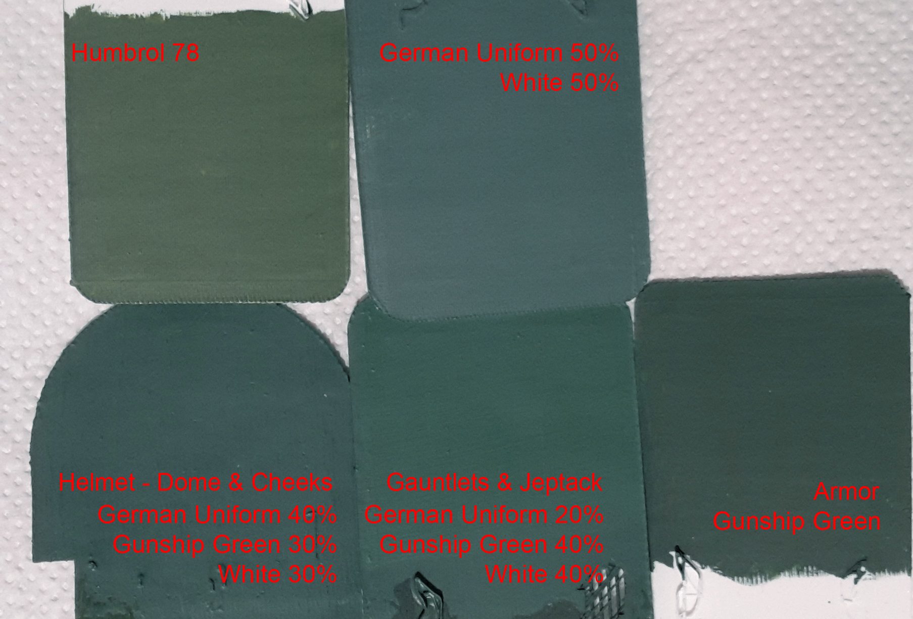

- Cheeks & Dome (base color - green):
There are a couple of "Humbrol to Vallejo" conversion charts available, but there isn't any equivalent of Humbrol 78 from Vallejo. But it's one of the most important colors, since you need it for the cheeks and dome of the helmet. Some people use Vallejo German Uniform. I painted some test objects and compared it side to side to Humbrol 78. German Uniform looks nothing like Humbrol 78: It's way too dark and it's doesn't even look very green to me. I looked at some other peoples paint jobs and original reference photos and tried to mix my own base color which also differs from Humbrol 78. I tried to achieve something like a slight "mint green". See the pictures above.
- Gauntlets & Jetpack (base color - green):
Other people noticed that the Gauntlets and Jetpack have the same color, which is brigther than the base color of the armor and even brighter than the cheeks and dome. So I tried the advice I found online (Gunship Green) which was again very dark. So I mixed my own color again. This one was very hard because it had to be similar to the cheeks and dome but brighter as well. From my point of view it shouldn't be a "mint green" but I'm not sure about that. I added more of Gunship Green to make it more saturated. See the pictures above.

You shouldn't be trying to colour match the humbrol list. Those aren't the correct colours. They're the best colours available in the humbrol line as per Terminal Fettler's colour list. For the helmet you will have better matches from MM panzer olive green 1943, Vallejo 70920 German Uniform, and Tamiya TS - 78 than you will from humbrol 78.

But there are 3 major green base colors for the costume that need to be in balance to each other.
Maybe my eyes deceive me, but from what I can tell from reference photos the green tones of the costume should look like this:
Armor:
- a strong, dark, saturated wood green
Helmet (dome & cheeks):
- a brighter, faded mint green with a tint of turquoise / cyan
Gauntlets & Jetpack:
- similar to the helmet but even brighter, more faded and less cyan (but still a tiny bit)

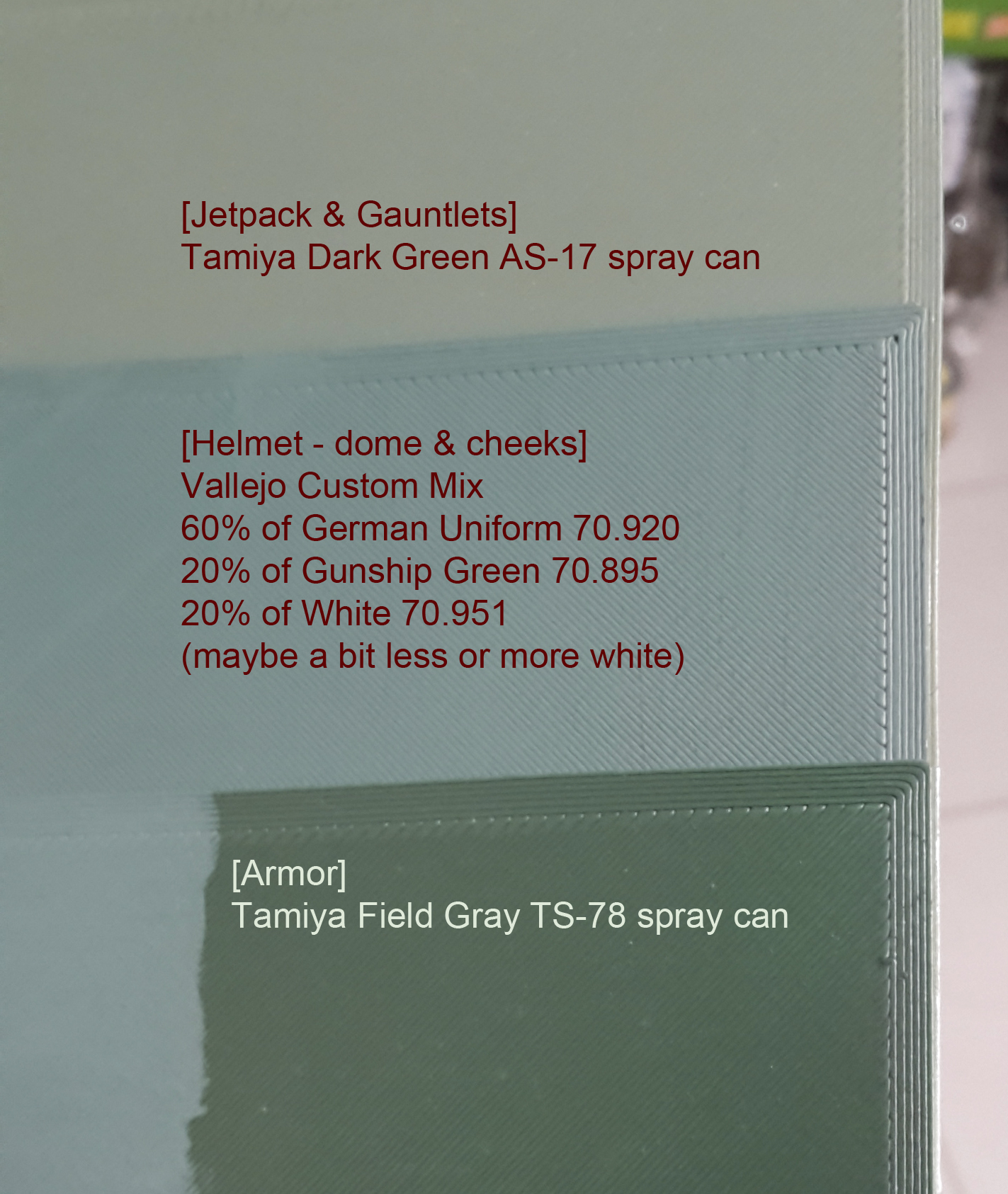

When I go with Tamiya Field Grey TS-78 and Vallejo Gunship Green 70.895 (which seem to be in good balance) I can not use TS-78 for the helmet as well. So I would use my custom mix (Vallejo German Uniform 70.920, Vallejo Gunship Green 70.895 and Vallejo White 70.951). But I think that that it would be too bright in comparison to the Tamiya Field Grey. When I don't mix the colors and use Vallejo German Uniform 70.920 only it looks almost as dark as the Armor and it doesn't look green at all but more like dark grey. So that's the reason why I brightened it up.
I'm not even sure if Vallejo Gunship Green 70.895 is the perfect choice for the armor. Right now it's my reference point: So the other 2 colors need to be brighter, more faded, more blueish etc... Never had any quality helmet in my hands so I don't know how bright the helmet should be, but from what I can tell it looks very bright in comparison to the armor and almost not even green but turquoise. On photos the efx helmet also looks very turquoise and very bright but I've never seen it in person yet. Still waiting for my order and they have delivery problems due to corona virus but that's a story for another thread.
The gauntlets and jetpack should also have similiar colors, so having a the same base will work. The weathering (dark grey, umber or black) will change the shade slightly or signficantly, it will be a matter of personnel prefence.
After following both your advices and buying a lot of colors, I made a final decision for the 3 green main colors:
I'll use:
- Tamiya Field Gray TS-78 spray can (since the airbrush version dries darker) for the gauntlets & jetpack
- Tamiya AS-17 Dark Green spray can for the armor
- Vallejo Custom Mix (Vallejo Model Color 70.920 + 70.895 + 70.951, ratio 3:1:1) for the dome and cheeks
