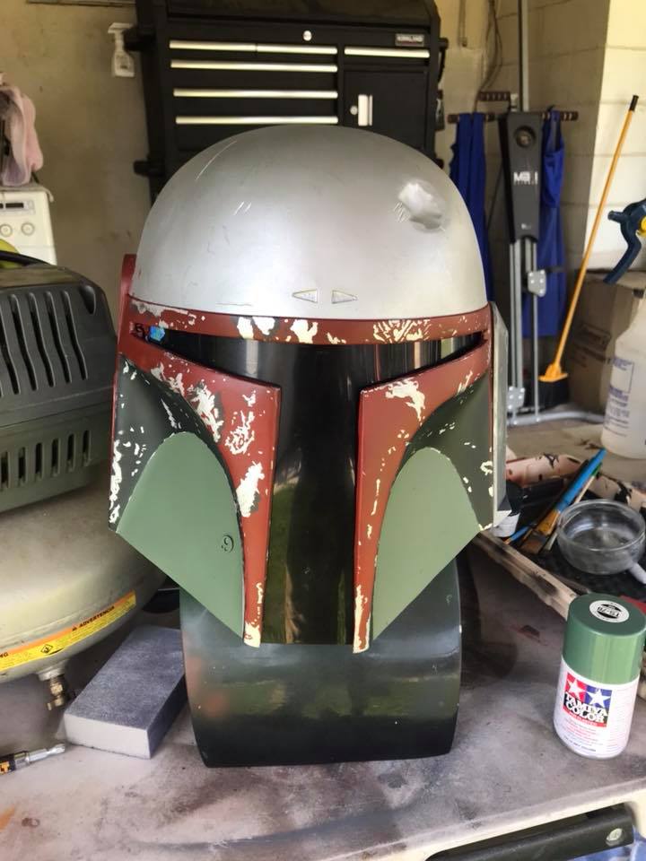

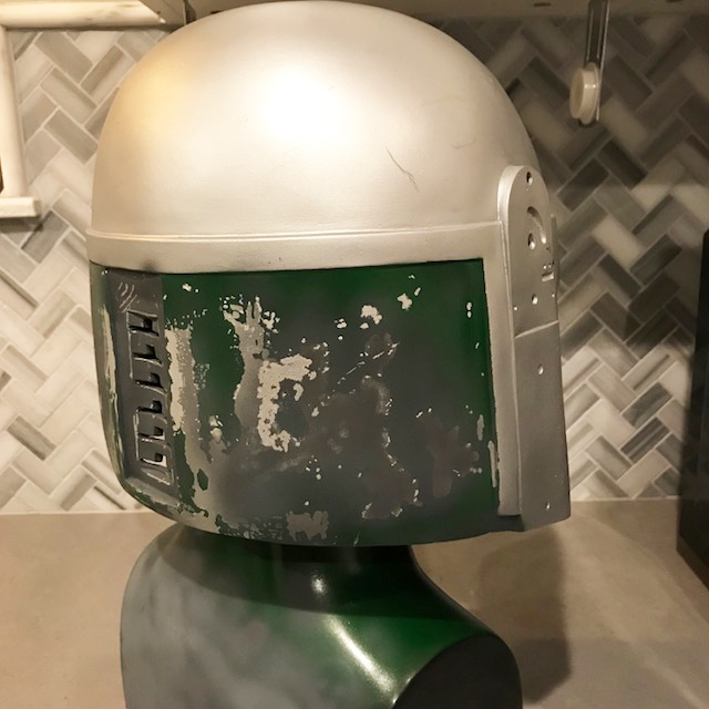

Silver Layer-Testors Metallic Silver

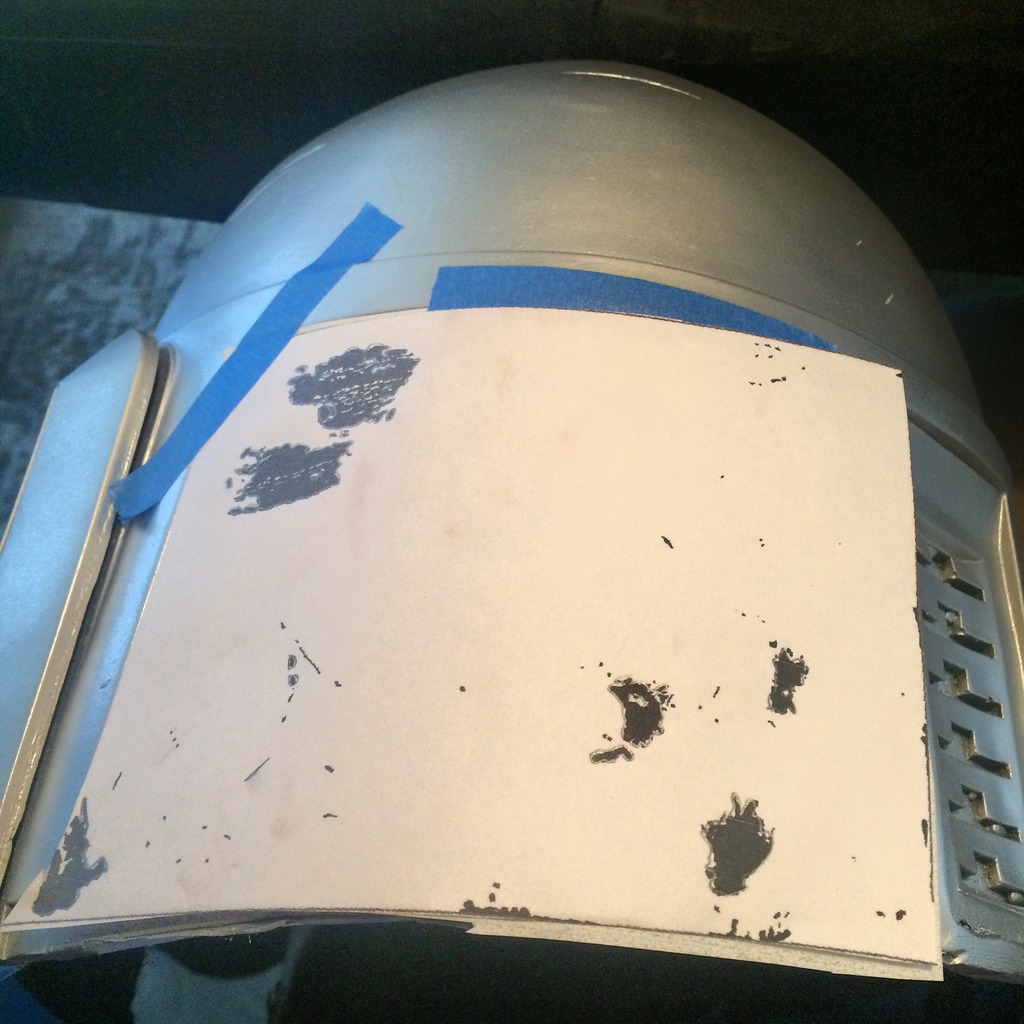

I used Tracedown waxfree tracing down paper to apply the stencils

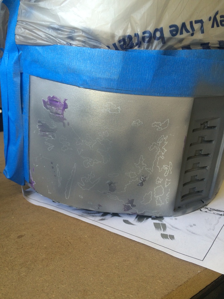

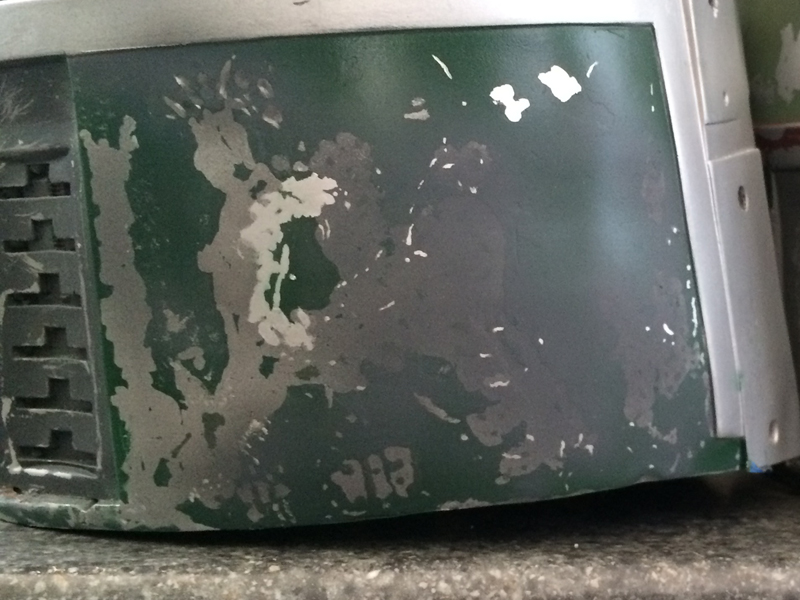

Using Maskol, I masked the silver parts and weathered the fading silver

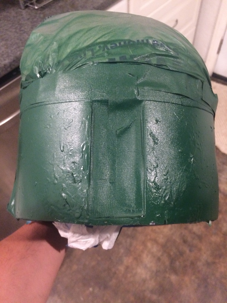

For the backpanel green, I used Rustoleum Hunter Green
Without getting into crazy detail, I end up misting with dark grey using an airbrush and topcially applied the silver damage to the back panels.

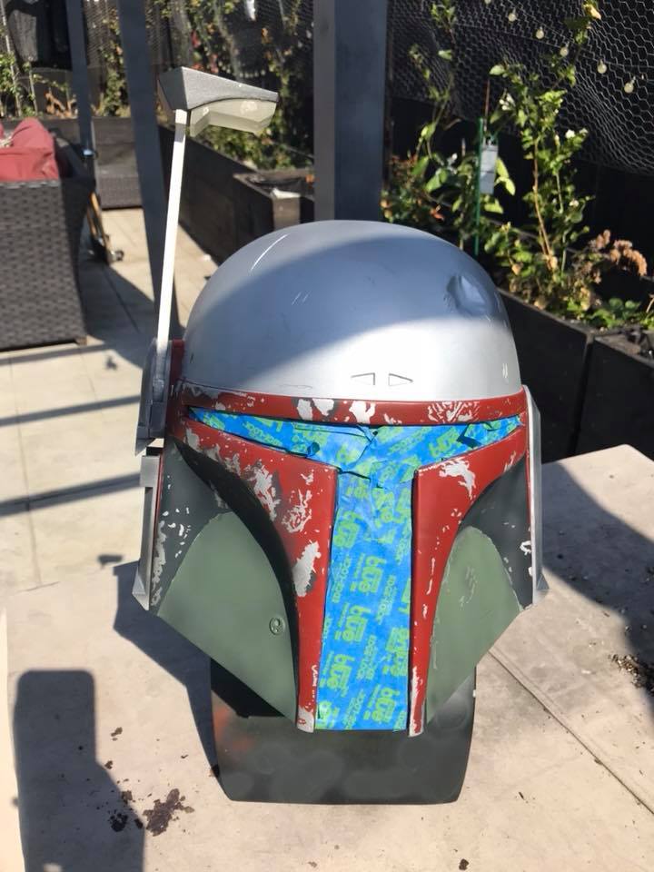

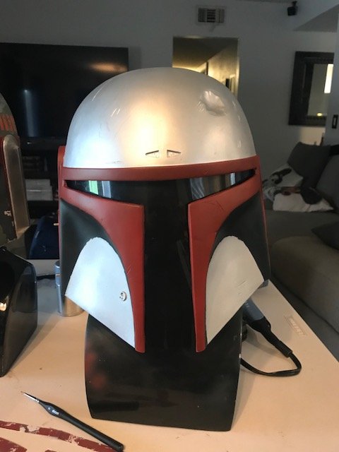

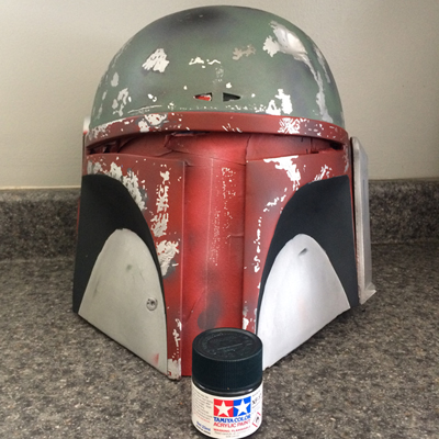

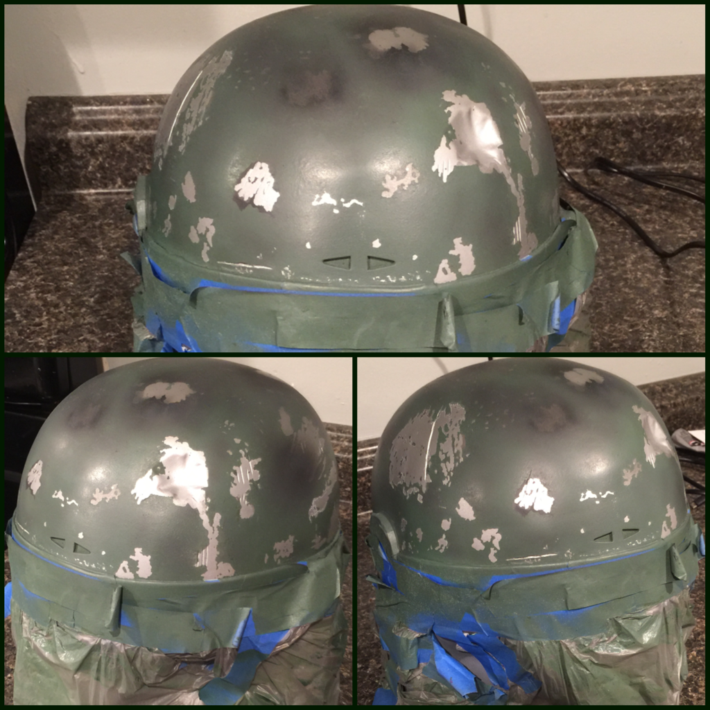

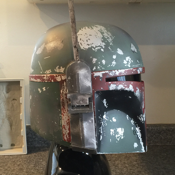

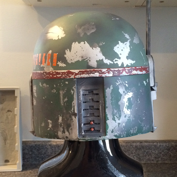

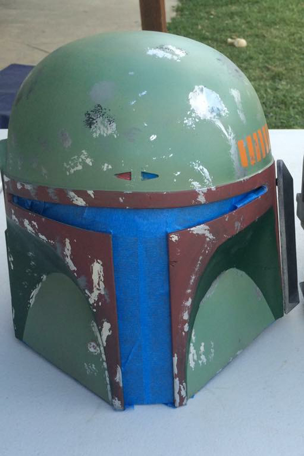

Next thing I tackled was the dome. Once again, I used the stencils, masked, used dark grey airbrush to hit the spots needed and end up using a combo of dark grey and black airbrush for weathering effect:
For the dome green, I used Rustoleum Spruce Green. I learned that attempting to mask smaller details is too hard, so it was easier for me to topically apply the smaller detailed silver damage.

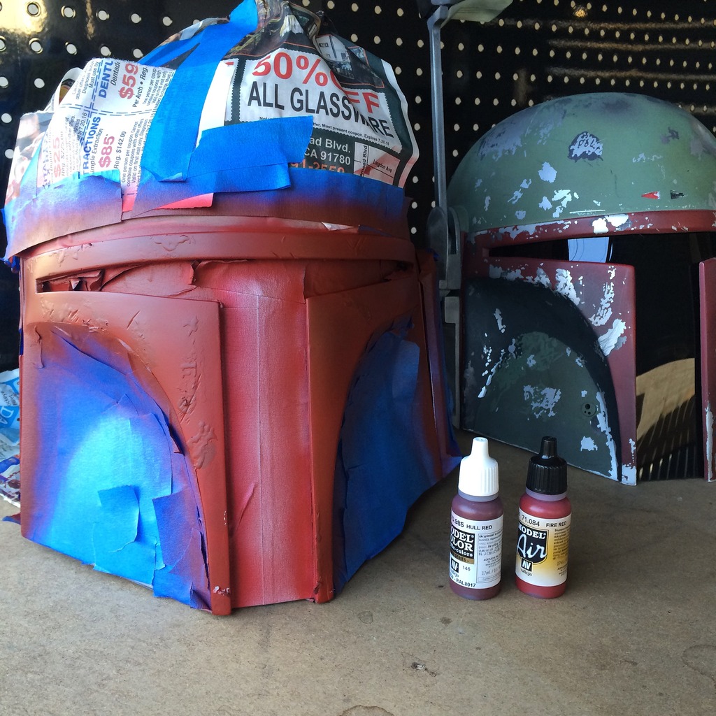

For the Visor rim, I used a combo of Vallejo Acrylic Paint of Hull Red and Fire Red mixed 75-25 and airbrushed it on. Once again, I only masked bigger silver damaged and topically applied the smaller details. I then airbrushed the weathering using dark grey and black.

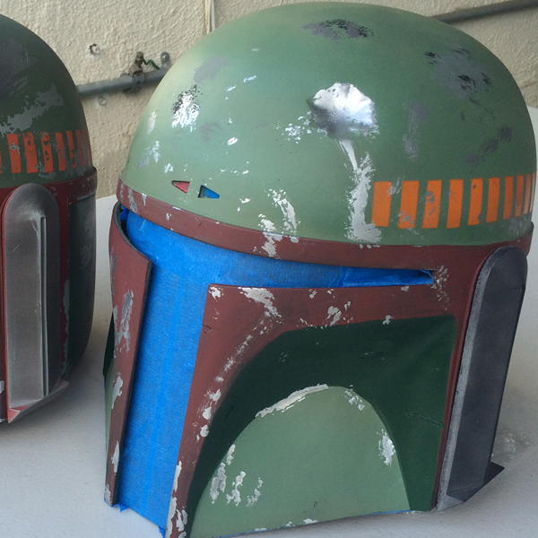

The upper mandibles I used Tamiya Acrylic Sea Blue XF-17:
And lower mandibles, I used Spruce Green, same as the dome.
I topically applied the majority of the silver damage on the mandibles, misted and weathered with dark grey and black airbrush:

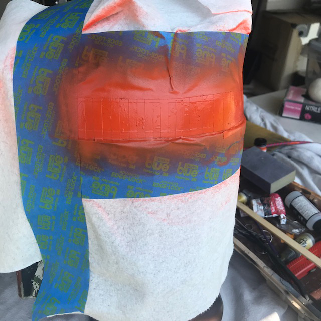

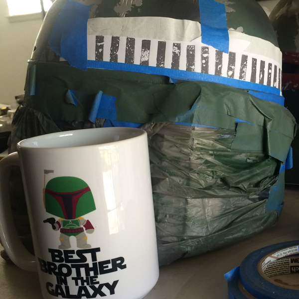

For the Killstripes I could not find the recommended Vaspar Hacienda Tile from Lowes, so I settled for Lowes Vaspar Island Orange. I used Testors Masking tape 1/4inches to get the line spacing between the stripes. After painting on the stripes, I used a exacto knife to cut out the kill stripes damage while the paint was semi dry and rubbery.

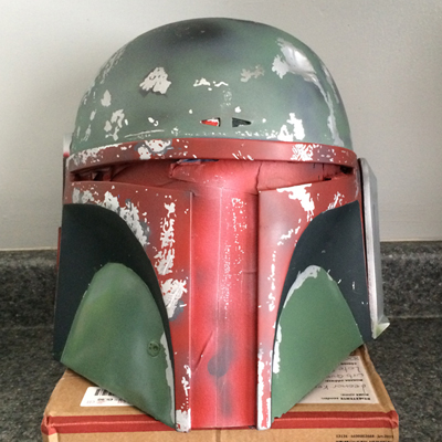

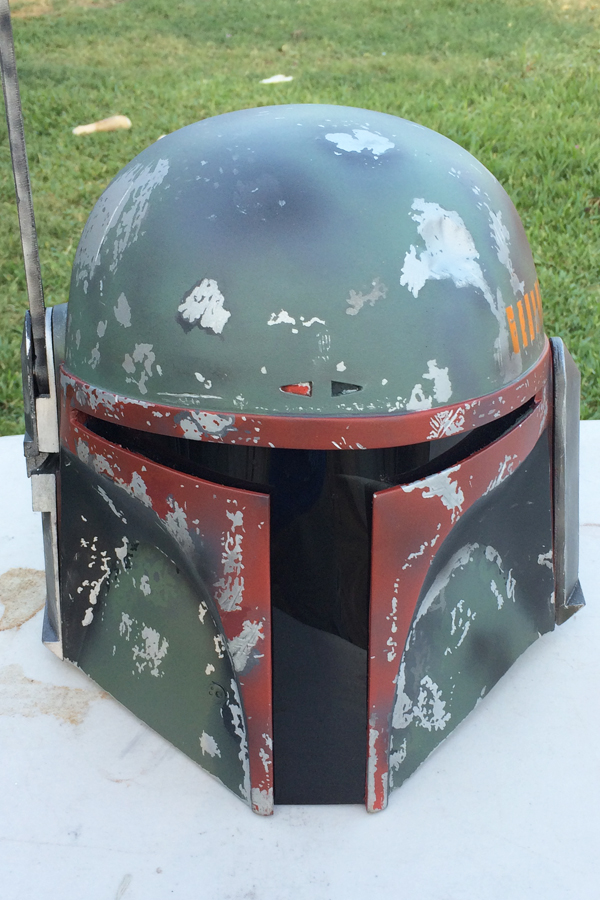

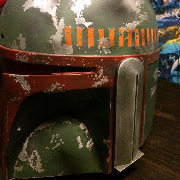

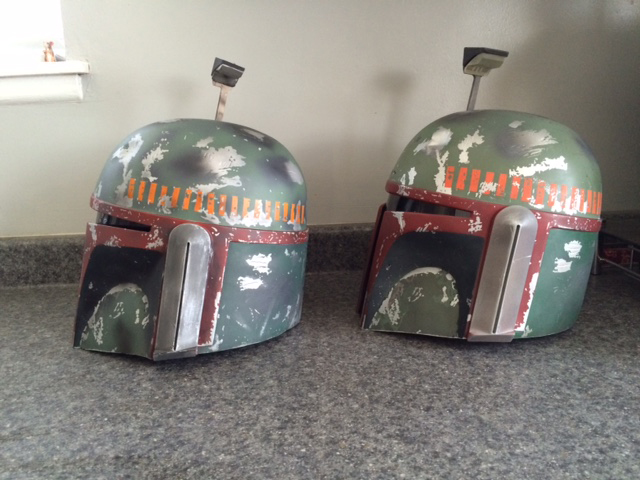

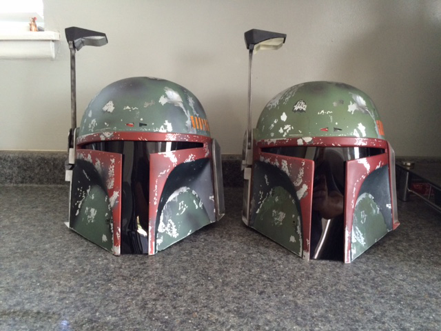

Finally after about 2 months of repainting the armor and another 3 repainting the helmet, I am done. It was definitely a learning experience. For all those guys like Darth Voorhess, Fett4reals, Afettfullofdollars, 22ssplt, Fettseven or anyone else who does commissions, Kudos to you guys for mastering this craft. It truly is an art form and your prices for commission are well worth your time and work. You defiantly get what you pay for and hope this is lesson for those considering buying pieces on the cheap from little known makers of Fett or from ebay.
Here the finished helmet.
The helmet did not come with the rear dental files, so I picked up a 3D set from Toolguy.

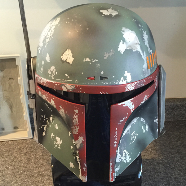

Just a quick before and after:

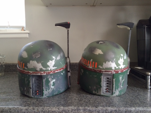

I can say this, it might be a recast, but definitely not the quality. I have a Fettpride helmet and the weight, quality, mold are night and day when you see it up close and get your hands on it
No speculation...it's a FPH2 recast. Chris (Fettpride) pointed this out months ago when corbanth (Randy) first started selling these.
Sent from my iPhone

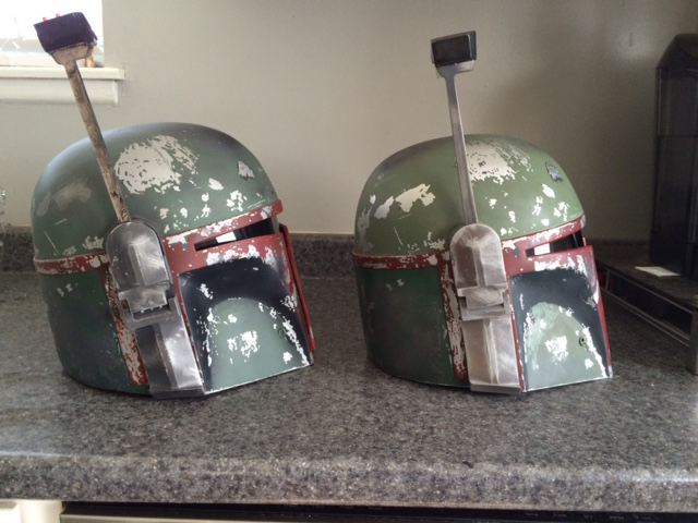

Dom, thanks again for the info. I decided to do a comparison shot. On the left is the cast from Randy Johnson. On the right is the FP GMH. I forgot to also mention. The range finder he sent is made of wood, which I had to sanddown as well and will ultimately be replaced.

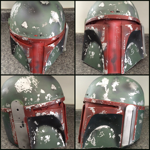

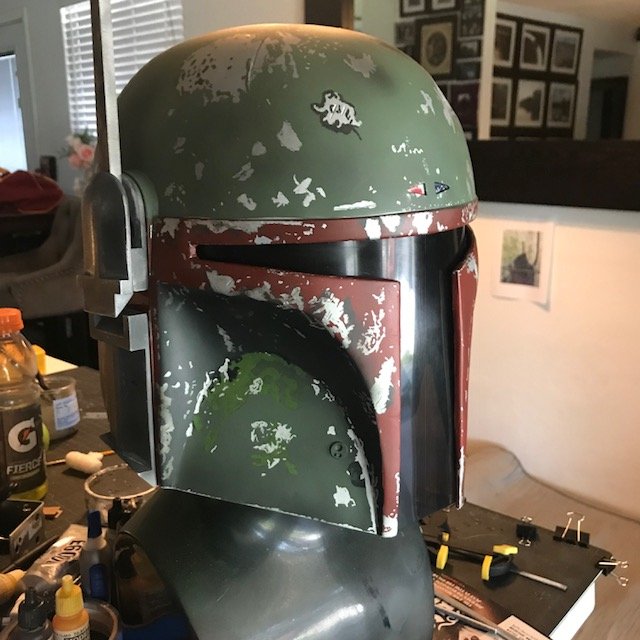

I recently helped out Gionny with his ROTJ helmet paint up and I wanted to share some paint changes that worked out, especially since they do not include Humbrol or Rustoleum. So while it is fresh in my head, I decided to document it before I forgot.
Here is my ROTJ Helmet Paintlist:
Main Dome and Lower Cheeks: Tamiya Field Grey Spray Can (TS-78) replaced Rustoleum Spruce Green
***NOTE Tamiya Field Grey Spray and Bottle Paint for airbrushing dry very differently. The bottle dries much darker and a few shades different.
Back Panel: Tamiya Green (X-5)-Acrylic Airbrush Bottle. replaced Rustoleum Hunter Green
Upper Cheeks:Tamiya Sea Blue (XF-17)-Acrylic Airbrush Bottle
Kill Stripes: Model Master International Orange-Acrylic Airbrush Bottle
Red Visor: Vallejo Hull Red and Fire Red mixed 75-25-Acrylic Airbrush
Ears/Keyslots: Vallejo Dark Grey Acrylic Airbrush
Primer: Model Masters Spray Primer
Silver Layer: Testors Gloss Metallic Silver Spray Can
Detail damage paint: Vallejo Aluminum and dark grey -Paint on with detail brush
HELMET: Fettpride GMH
Upper Cheeks: Tamiya Sea Blue
Silver damage applied topically with detail brush and Vallejo Aluminum and dark grey acrylic
Tamiya Field Grey Spray can used for lower cheeks and dome
Airbrush weathering using grey and black
Rear Panel Tamiya Green X-5 which replaced the Spruce Green
Kill stripes: Model Master International Orange which replaced the Lowes Vaspar Island Orange.
Final look using paintlist

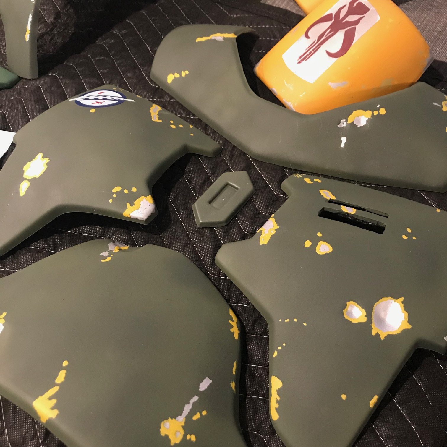

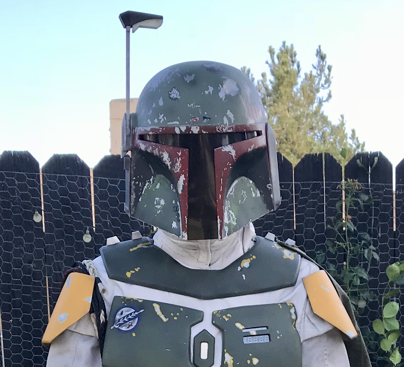

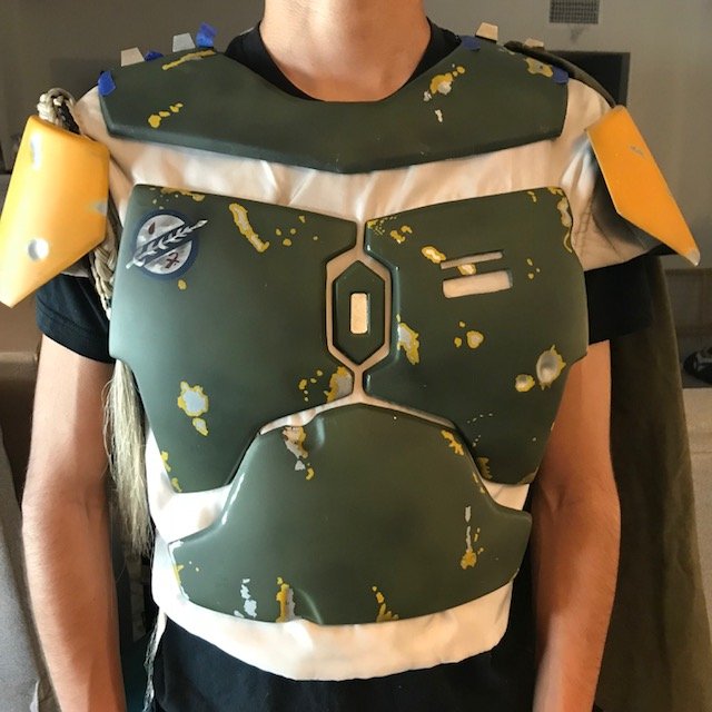

While helping out Gionny with his armor, I also made some changes to the paint I used for the ROTJ armor
Here is my new paintlist:
Armor: Tamiya Field Grey Arcylic Bottle Airbrush (Not Spraycan)
Silver: Testors Gloss Metallic Silver Spray Can
Yellow: Model Master Zinc Chromate (Airbrush)
The new results with RKD armor:
Weathering detail added

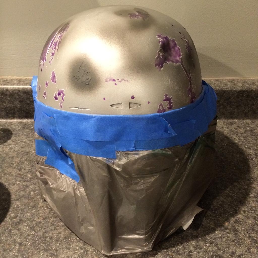

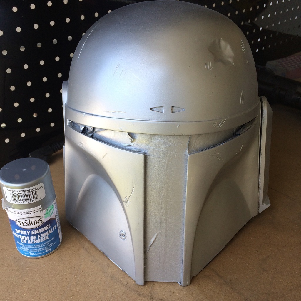

I my name is Sean and I recently acquired a ROTJ complete kit from a member we lost to a heart attack about 2 years ago. I believe I have that exact same helmet from Sith Planet with the wooden pieced range finder as well. The paint on the armor and helmet is so bad. You have done an amazing job here. I just bought an airbrush machine on amazon which will be here tomorrow but I have never airbrushed in my life and I'm scared to death. I was curious about the stencils. I was able to download and print them but I am not exactly sure how to use them. It looks like you have that waxpaper on the helmet then the stencil over that. Does that put wax on the helmet that you just paint over? How do you mask it? What is that stuff that appears to be purple in color almost looks like wax. Just trying to find out how to use the stencils. This is a great build thread thank you. I hope I can follow it well enough to do what you did, otherwise I just have to pay someone to paint this armor and helmet for me. Any idea how to fix or buy another rangefinder that will fit this helmet? What did your friend end up doing for that? Thank you.
bh19812 check out these videos they will help you understanding the stenciling/masking process.
