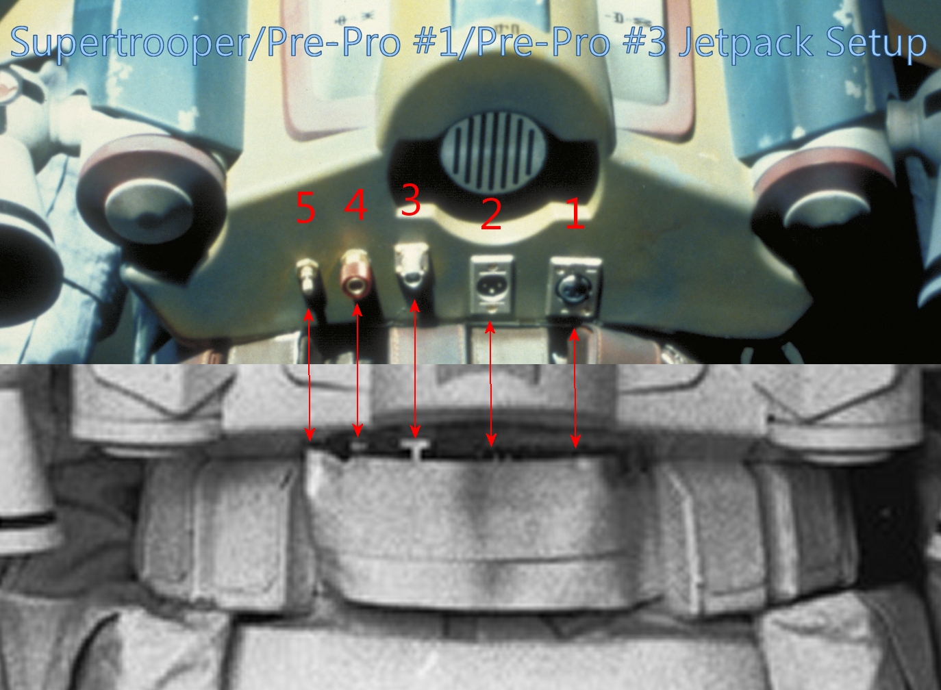

OK guys,what are your thoughts?
As there is no reference to go on for the greeblies on the bottom of the Supertrooper jetpack what do you think would be the best thing to do?
I'm thinking the best bet is to copy the PP1 layout as that version has a lot in common with the Supertrooper. Would be greatful for some input.

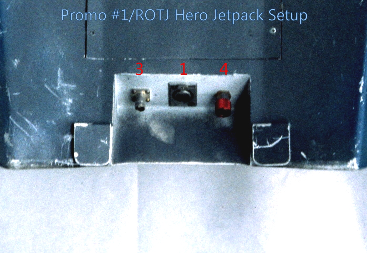

Most of the Supertrooper/Pre-Pro #1/Pre-Pro #3 (the same jetpack) greebles are/were on all jetpacks, at least this is what we can understand looking to the Supertrooper/Pre-Pro #1/Pre-Pro #3, Pre-Pro #2 and ROTJ jetpacks:
ST PP1 PP3 Jetpack Connectors.jpg PP2 Jetpack Connectors.jpg ROTJ Jetpack Connectors.jpg

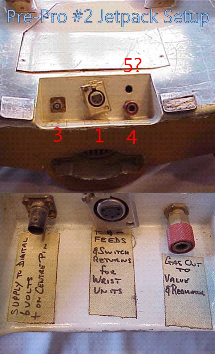

The Pre-Pro #2 jetpack bottom writing describes the following greeblies:
1. + & - FEEDS
& SWITCH RETURNS FOR WRIST UNIT - This is connected through a cable/hose to the right gauntlet, which operated 2 toggle buttons for the jetpack trusters.
2. This connector might have been connected to the chest display or the abdominal speaker.
3. SUPPLY TO DIGITAL 6 VOLTS
+ ON CENTER PIN - Judging by the Supertrooper image, this was connected through another cable/hose to the left gauntlet and operated the flamethrower's gas lighter with another toggle switch.
4. GAS OUT TO VALVE & REGULATOR - This was connected through another cable/hose to the left gauntlet and its purpose was to feed the flamethrower with propane gas.
5. This seems to be a push or toggle switch to turn ON/OFF the electronics in the jetpack.
Nice...now I see the PP1/PP3 and the ST packs together in that first picture. Mad as I've looked at that picture of the supertrooper so much and never seen it.The way the ammo belt if worn draws the eye away from a lot of the detail.
