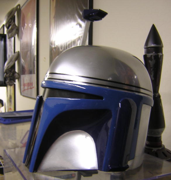

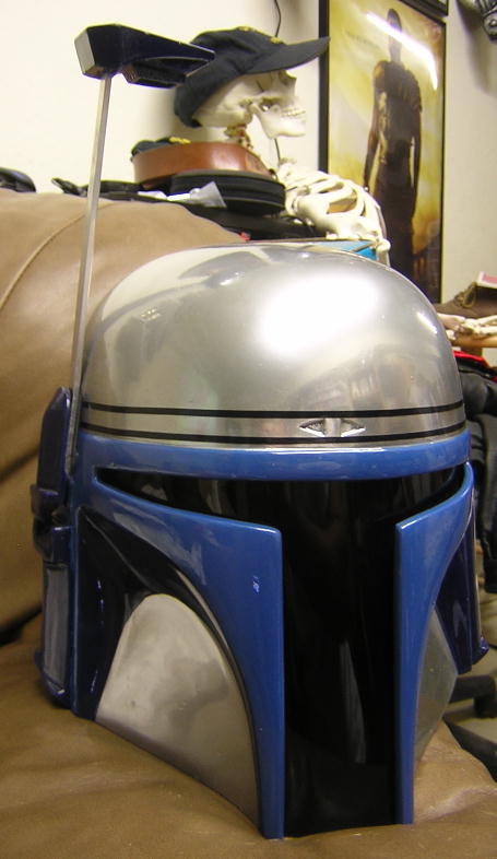

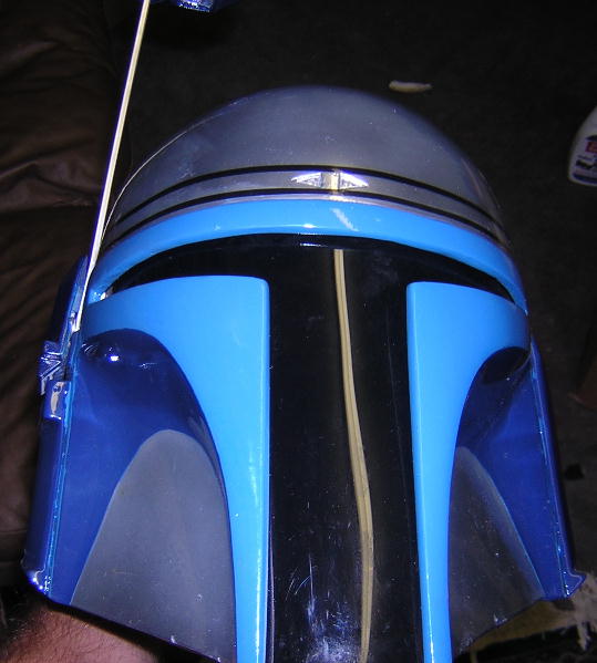

I've painted the other (Navy) blue. I think it might be just a bit too dark and I didn't do such a great job with the masking, so I'll probably be doing some touch up with a brush. Then it's time for another clear coat and final assembly.
I really like this pic the most cause it was supper SHINEY
Here's a metric butt-ton of pics. They should be pretty self explanatory. These include the velcro-in neckseal at the bottom of the helmet.
The fan is mounted inside the left side of the helmet with an on/off switch at the edge so you can reach it without opening the neckseal.
The pinstripes are 1/8" adhesive pinstriping available at any auto supply shop. I didn't feel like rolling the dice by doing the pinstriping by hand.
I mostly feel like I'm done with this one. :thumbsup: I may still cover the wiring inside the helmet and black out the epoxy putty I used to hold the fan, switch, and visor in place. I don't think anybody will ever see them though.

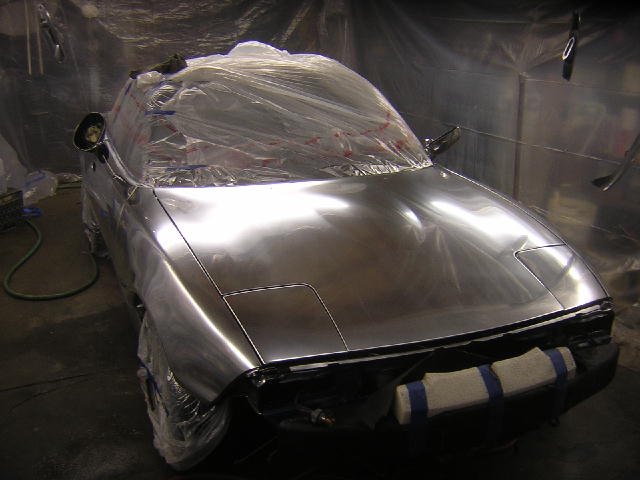

I just wanted to show this off too. I painted the whole car with the same chrome paint as my Jango helmet. Once I hang the front bumper back on it I'm considering putting a couple of blue racing stripes on it. Then if I finish the rest of the Jango costume, I'll have a car that matches it.
Maybe I've already taken it too far.

How's that chromed paintjob on that miata (?) comming along?
The Miata has seen a bit of a setback. There were a few rough spots on the chrome layer. I went ahead with the clearcoat anyway and caused all sorts of problems. It turns out that I didn't give the chrome enough time to off-gas all of the solvents. So the nice metal layer that had laid flat and looked like chrome ended up moving just enough to look like normal silver paint in a lot of places.
Now I'm going piece by piece and sanding through to the black basecoat, respraying a clearcoat, re-chroming, and then clearcoating after waiting long enough.
It will take me a lot longer, but when it's done it should be perfect. I'd post pictures, but there's nothing to be proud of right now.
