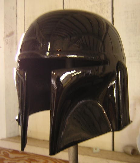

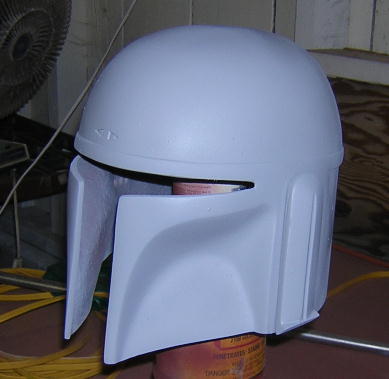

These first three photos are of the helmet with a red sandable primer, then a grey primer, then the black basecoat with three coats of clear.

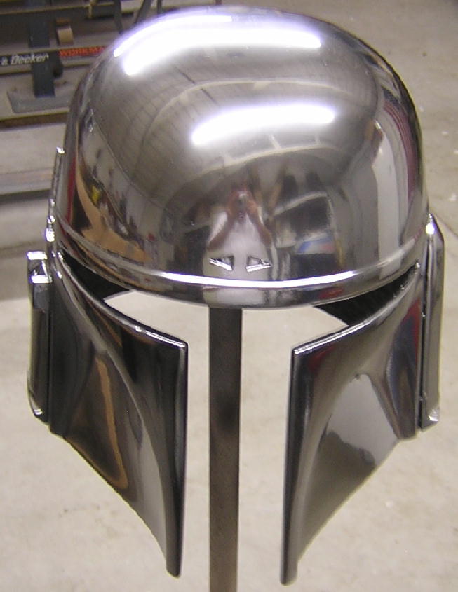

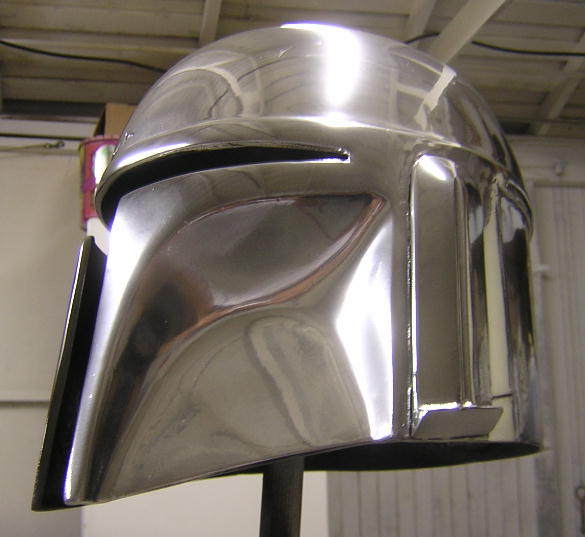

After waiting about 8 days for the clear coat to finish off gassing, I was able to put on the chrome layer. I think this came out pretty good, but there are a few flaws. It turns out that every mistake is visible through this paint.

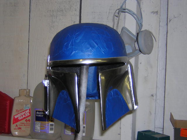

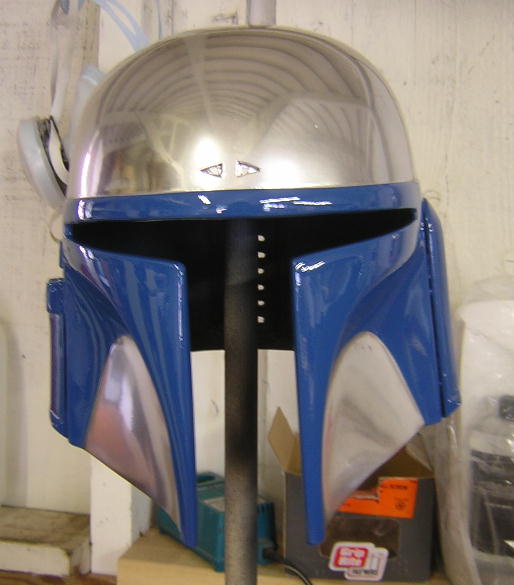

The next step was masking and painting the blue. I'm using Rustoleum Royal Blue for the light color and Navy Blue for the darker. I'm sure it's not screen accurate, but I like the contrast and the chrome is too bright as it is. It actually looks to be really close with a flash.
The chrome paint that I used is a product called Mirrachrome made by Alsa Corporation.
Here's a link to their page for it:
http://alsacorp.com/products/mirrachrome/mirra_prodinfo.htm
It's a little on the pricey side, but it takes very little to paint one helmet (less than 1/4 ounce) and there's nothing like it anywhere else.
The good part is all you need to apply it is a regular automotive HVLP Spray Gun or a dual action airbrush. I haven't tried it with my little cheapo Testors airbrush, but it would probably work passably well.

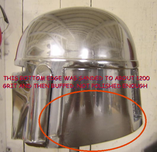

The trick to it is that it must be applied over a perfect gloss finish. Every little mistake you make in the prep work will show up in the final product. Here's a pic of a spot on the back where I buffed out a run in the clear coat:
The other nice thing about it is that it's dry within about 30 seconds of coming out of the spray gun. No buffing. No elbow grease. Just wait a few days and clearcoat it with any automotive clear and the finish is just as tough as the paint on a new car.

I've painted the other (Navy) blue. I think it might be just a bit too dark and I didn't do such a great job with the masking, so I'll probably be doing some touch up with a brush. Then it's time for another clear coat and final assembly.

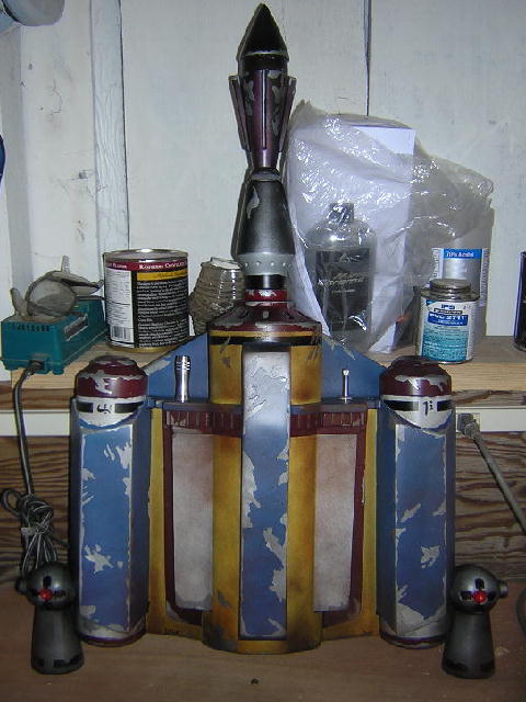

I posted a pic of the jet pack in the show off your jet pack thread, but here's the picture again. I think I went a bit overboard on the weathering, but without making it so grungy, the colors just looked too bright.
