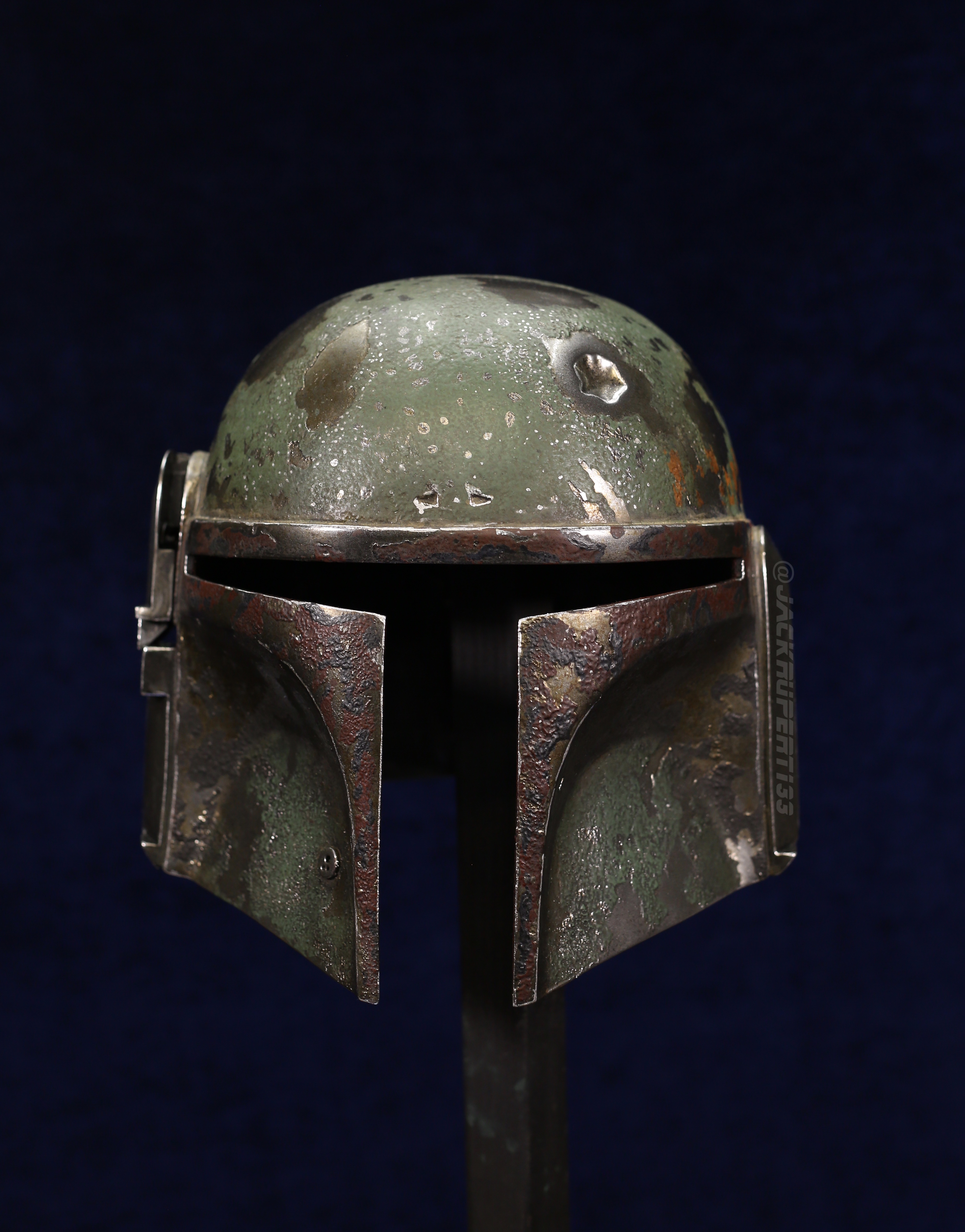

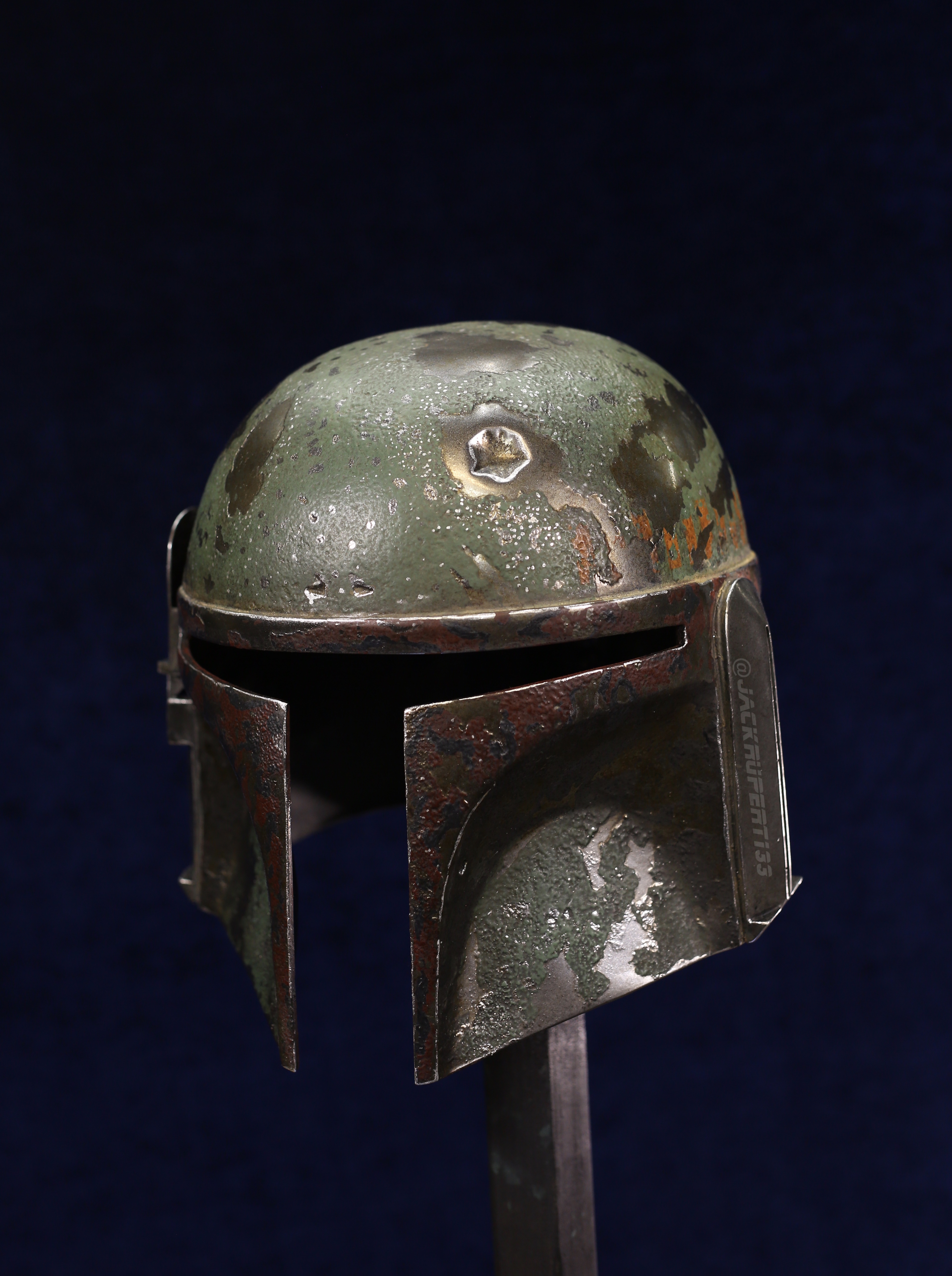

Hey folks, I figured I should share some progress over here as I work on my take of the Post Sarlacc or “Vanth” style Fett helmet. This started as a recast of the Sideshow ROTJ helmet with modified turn signals. The cast needed a lot of clean up and microbubbles filled before I could start texturing and painting. To do that, I shot a few heavy coats of primer and rubbed it in with my hands. I then wetsanded it back until it was nice and smooth.
From there, I masked off the areas that would later be smooth metal with liquid latex. Nothing fancy, I mix my own masking latex, much cheaper than buying little bottles of Maskol or whatever masking product. The texture was achieved by stippling bondo on the surface, and knocking it back lightly with 220 after it cured up.
Then I 2K clear coated and Alumalustered the helmet, followed by one more coat of 2K to seal the chrome.
The piece was masked off once again with latex and I applied some Archive X paints for the base. This is as close all I’ll ever get to doing a “Boba Fresh” I hope.. Then some weathering to tie it all together and make it look nasty.
Without further ado, here is the (almost) finished helmet. I’m still adding details here and there and need to install the visor and rangefinder of course.

Some FAQ from other places I’ve posted this.
How did you do the texture? Bondo body filler thinned out with acetone and stippled on.
“Why did you put the texture under the chrome instead of over top?” Well, to be frank it’s because that’s how it was really done. If one looks closely at the real helmet, you’ll see that to be the case. There are many areas where you can see the texture under the chrome. In addition to that, putting bondo over a high gloss 2K clear coat is not a great idea as it would be very easy for it to chip off of the surface.
“What chrome paint do you use?” Alumaluster, always.
“What 2K clear?” Transtar 6571
“Will you be selling or taking any on commission?” Not at this time. It is an exhausting thing to paint, and it wouldn’t be cheap. If better castings become available in the future I may consider doing a very small amount of them.
