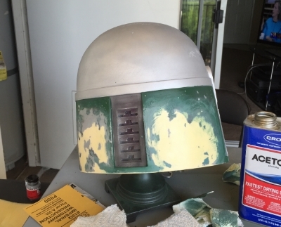

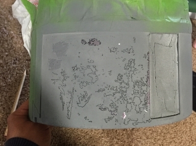

I hit a snag. Apparently, either an older bottle of masking fluid I had went bad, or had a bad reaction with the paint.....I don't know. I was feeling really good about my masking job, and Jayvee's colors were just KILLING it.
So when I went to start removing the mask......gum.
Gummy, gooey, gluey....it just wouldn't separate. I used a rubber cement remover, a high-end eraser, a razor blade. Everything but the kitchen sink. And it wouldn't pull the mask up fully. It really was a shame, because the spots where the mask came up cleanly were AMAZING. The proper blending of the gray mists is sooooo rewarding to see. So I really was left with no option except a full teardown.
So here's a cringe-inducing photoset of how it went. You might want to put on a cup:
I'm not worried, though. Round 2 will be even better.

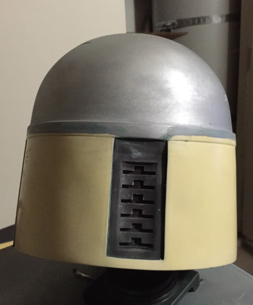

Okay, so I got the helmet primed and wet sanded. My intention was to work on the helmet throughout the weekend, but things came up. Had to help a coworker pack for a move across country yesterday. It ended up taking quite a bit more time than I had planned on. And then, with today being Mother's Day, my afternoon will be spent thanking her for giving me life, blah blah blah, yaknow, that old yarn. Kidding! Happy Mother's Day to all moms out there!
I was able to hit the lid with a new coat of silver last night, and color sanded it this morning. The silver is the last coat that is possible to sand, and it has always been important to me to have the smoothest surface possible to start with. And this baby is smoooooth. I haven't used Humbrol silver before, and honestly, I don't like it much. It's a very thick paint and gave me fits trying to thin it out enough. I usually just use a rattle can for primer and silver, and I'll probably go back to that in the future. The nice thing is that, after color sanding the silver, I was left with a VERY nice, slightly uneven look. It was unexpected, but I really like it, as gives it a vintage look. The picture exaggerates the effect, as it's not as dramatic in person, but you get the idea. I'm hoping to get the silver masked before I head over to my folks' place, and hopefully be able to hit the lid with at least one of the gray mists before the night is over. So I'm almost back to where I was. And like I was hoping, I think things are going better so far!
Sorry for the long post!
I like the new start. As you said, "uneven" , being a desired aspect, is a large part of the correct look of Fett. Age, deterioration, realness, add to the beauty of a well painted replica.

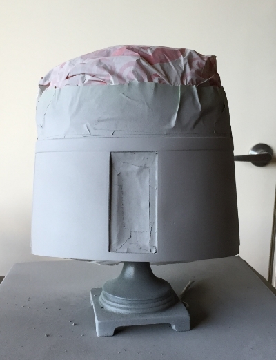

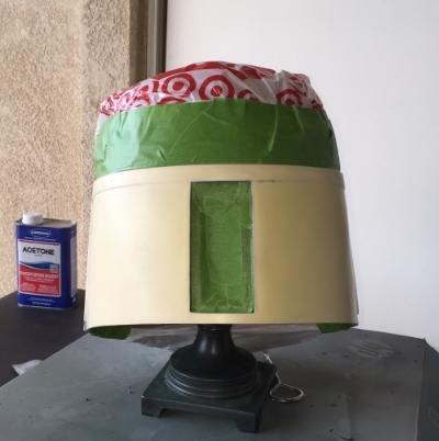

I got quite a lot done tonight. Last night I was able to mask the silver off and lay down the lighter gray color.

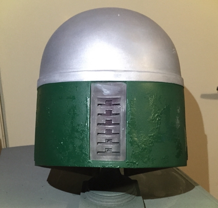

So after work this evening, I was able to mask off the light gray, lay down the dark gray mist, mask that, and spray the green.
I'm now back to where I was, and I think this time is superior. Snapped a few quick pics as I was moving through things. Now dry!
Looking really cool! Are you using carbon paper to transfer the stencils? I have the wax transfer paper and the lines never transfer that crisp!
