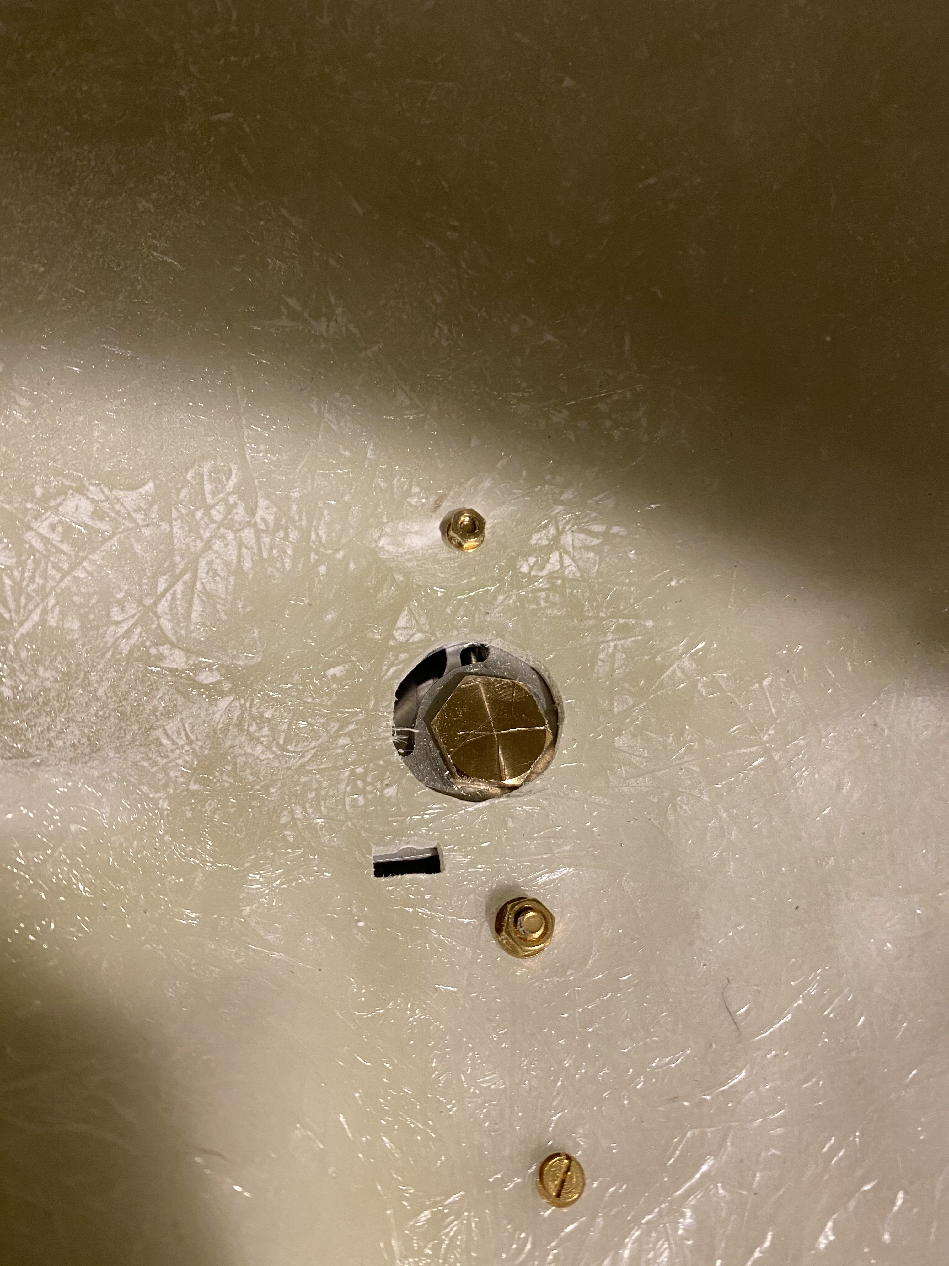

I had to sand the area around the top screw in order to attach the top right ear.

How far down did you sand? That has been my problem to get that top screw to poke through the helmet.
That picture is where I'm at.

If you haven’t already make sure the ear sits flush on the ear platform. The moulding process left some rough lines on both the top and bottom of the right ear.
I used a Dremel tool to sand it down a little inside, just enough to get the nut on the top screw.
I did give the ear platforms a good, but gentle sanding. I know they'll never be truly flush due to the nature of the helmet, but I think I'll keep going on the route you suggested.
I ended up just replacing the screw for a longer one, didn’t want to remove material from the inside of the helmet. I might be wrong but looking at Rob’s tutorial, it seems he’s used a longer stainless screw instead of the brass one.
What screw did you end up replacing it with? I went back and looked at the videos again, and you're absolutely correct about him using a different screw.
The supplied screws are imperial sized, so harder to get hold of- it seems the one’s RS supply are difficult to get in a longer size (possibly why they don’t give you one that is long enough to go through the helmet ear platform?).
In metric size, I got a M2.5 with 12mm length (M3 seems slightly too big).
One thing I did have to do was file the head of the bolt slighty (so it fits flush in the countersunk hole) as it caught on the range finder- only a couple of minutes with a file.
