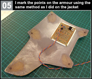

In the BobaMaker thread, he says “I mark the points on the armour using the same method I did on the jacket.” To me, that means using the test piece holes to report the bolt locations on to the back of the ‘real’ pieces. Here is the relevant step from Bobamaker’s thread:

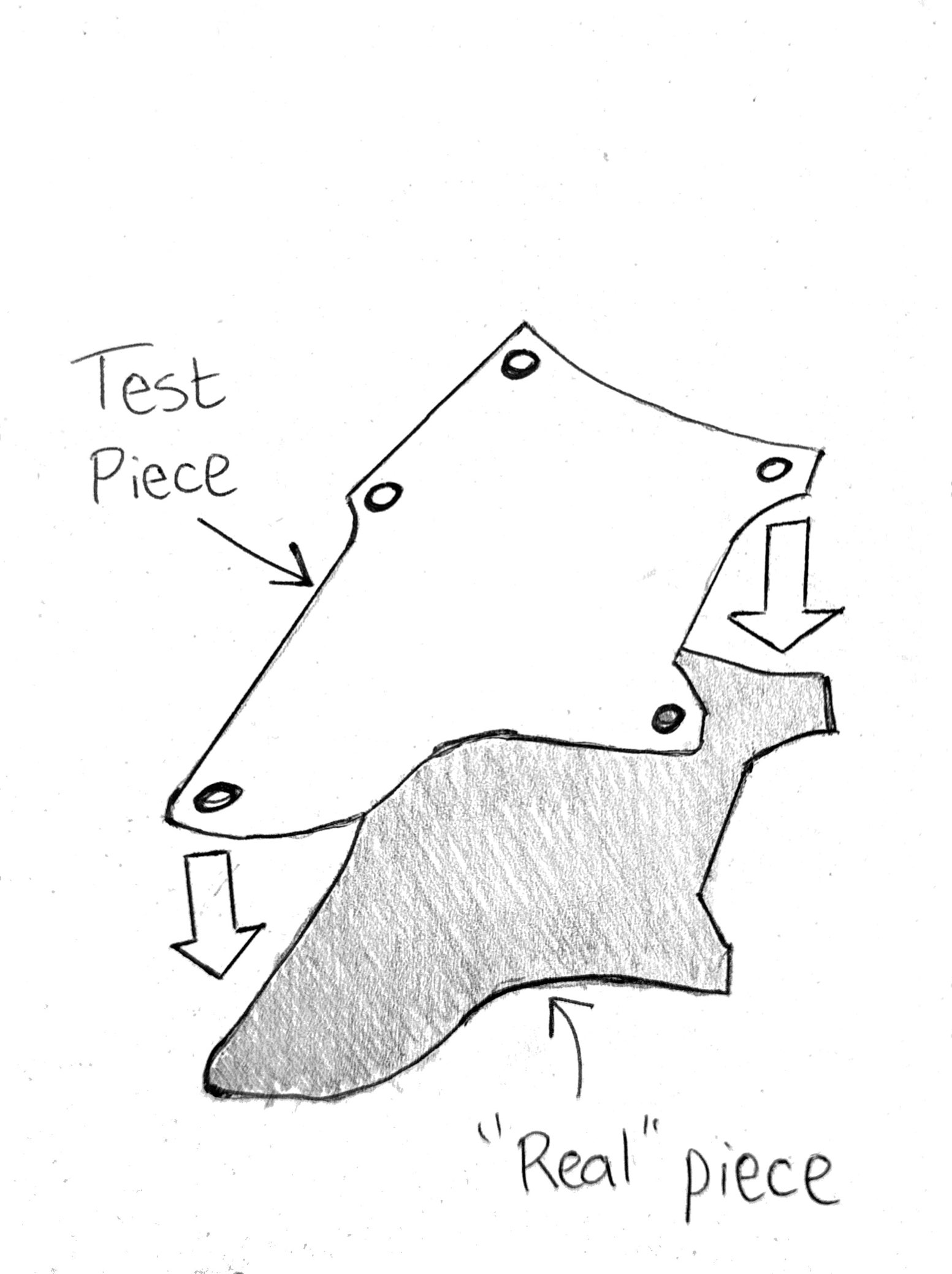

I can only assume he’s laid the test piece over the back of the real piece to report the bolt locations, like this -
The issue I can see is keeping both pieces properly aligned while they’re stacked. I suppose you could tape them?

This sounds like a pretty good idea. I've already ordered the test pieces from MinuteFett though. He only charged me shipping but I suppose I'd better get some use out of them!
I have no problem drilling holes into the test pieces so I think I'll try what I describe above - use the holes in the test pieces to mark where the eyelets will go on the vest, then lay the 'real' pieces on top of the test pieces and use the holes to mark where to attach the bolts on the real pieces.
that is the method used on the original costumes. It works really well.
Outstanding! Super satisfying that my thinking was correct! And thanks for linking to your thread. My armour is from MinuteFett and I’ve been thinking of getting my flightsuit from clothears, your comments on how great the armour looks with clothears soft parts may have just sealed the deal on that! That 32 week lead time is going to kill me though!

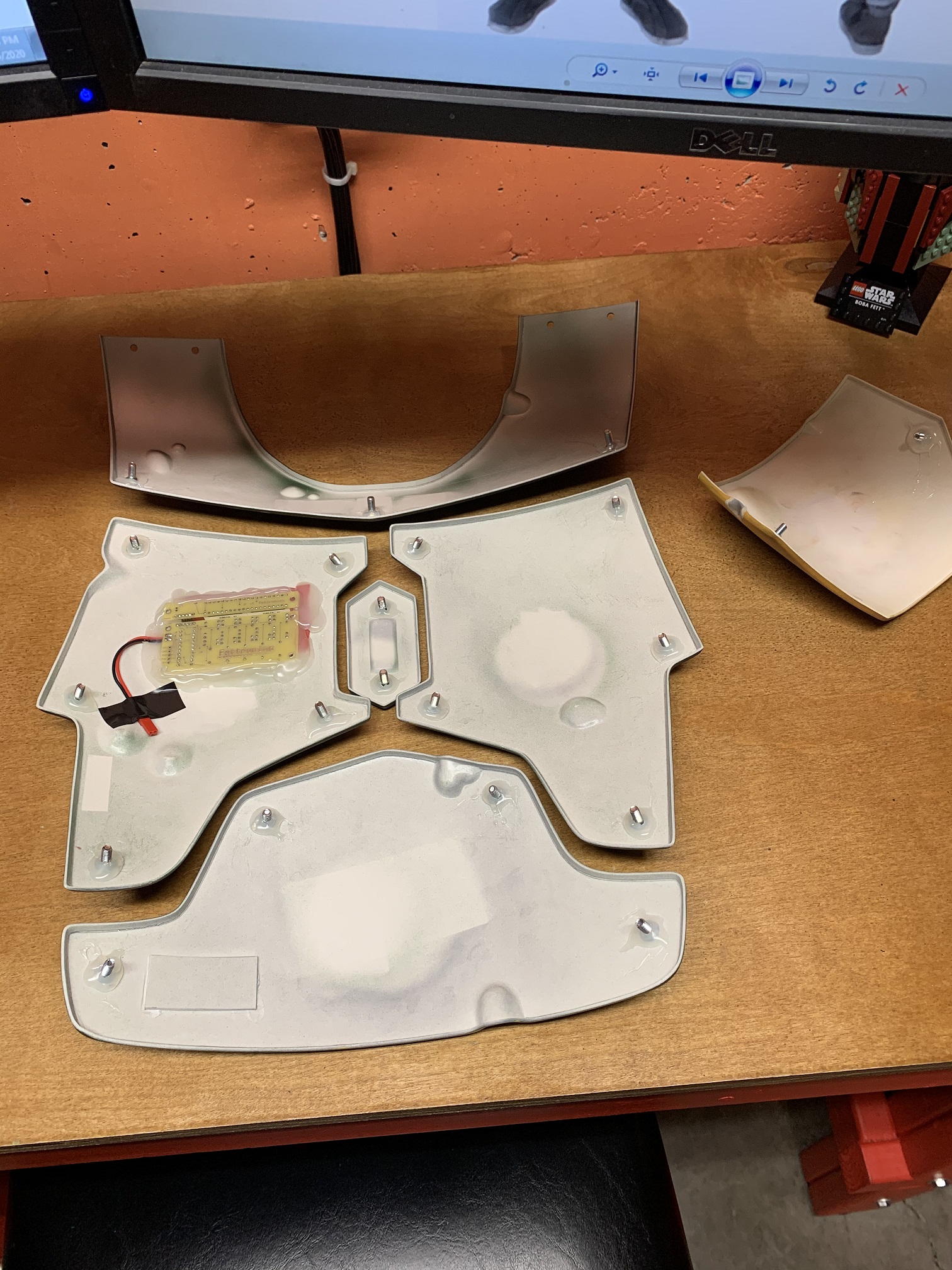

I know the above pic shows zinc hardware, but also I initially used hot glue too, while it was secure for about half a dozen troops, the bolts did begin to pop off the armor one at a time. And when that happened, that's when I made the decision to swap them out for Stainless Steel hardware and use epoxy rather than hot glue. Because as most Fett's will tell you (Myself included), you WILL sweat in this costume, and moisture on Zinc does indeed cause rust. And so, since doing this (nearly 5 years later) the bolts have NOT come off using the epoxy, I mean, I have yet to re-affix one bolt. And I've been out dozens of times in my Fett, many times for extended periods.
I eyeballed where the Bolts would be placed and using a drop of Gorilla Glue Gel fixed the bolts in place. I then used the Epoxy around the base of the bolt to secure them to the armor pieces. I let it cure for 72 hours before continuing....

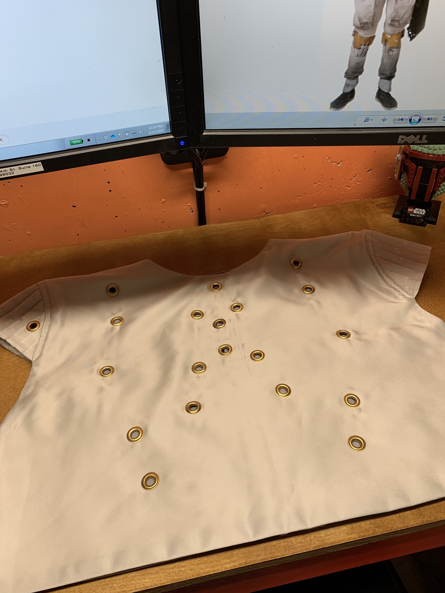

And to install the grommets, here is what I did:
Step 1: Hammer on the grommet cutting tool, which doesn't cut Arkady's material by the way.
Step 2: You can see the circle indent it makes.
Step 3: Using a hobby knife, cut out the hole.
Step 4: You'll also have some padding to deal with underneath, so make sure to clean that out.
Step 5: Using the Grommet Cutting Tool Hammer the hole again. (This is for the reverse side)
Step 6: Flip the Vest over and you should see the indent, Using a hobby knife, cut that piece out.
Step 7: Put on the Grommet.
Step 8: Pound on the Grommet.
Once this was complete (and I have two left to do - Left Shoulder Armor) I was treated with this.....
Armor mounted on great!

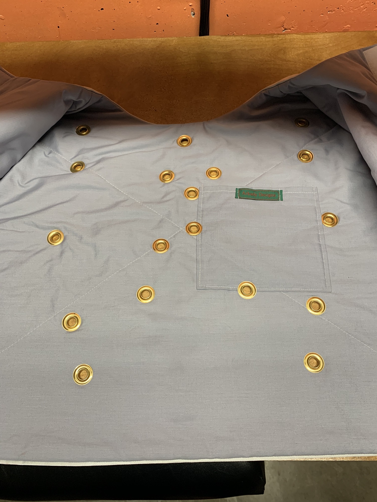

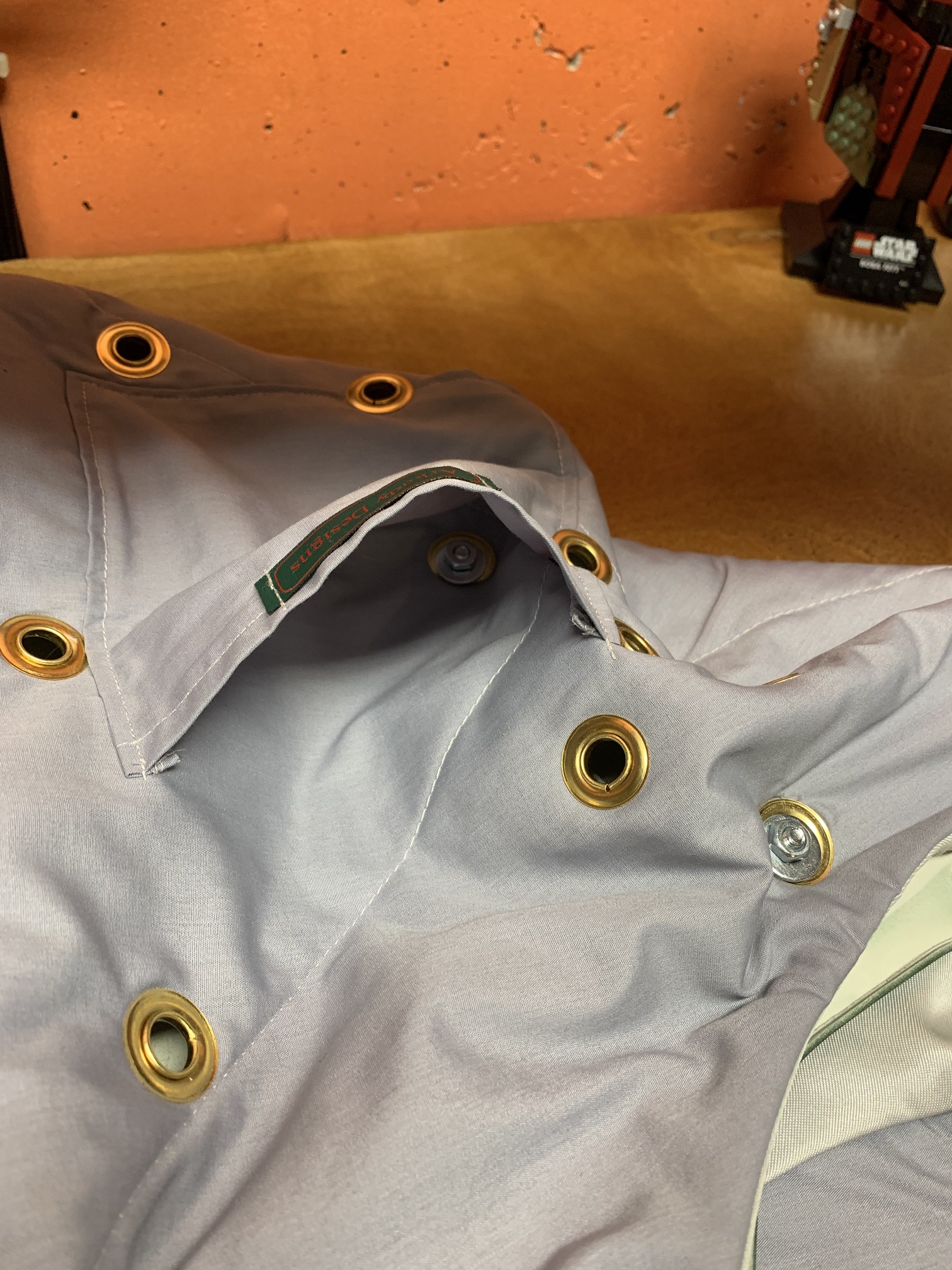

That procedure took a few hours and was a very monotonous and tedious task indeed. Just glad it's over. Just a note......but a couple of the Grommets may interfere with the inside pocket that Arkady sews on the inside of the vest.
1) One grommet for me, landed on the inside of the pocket.
2) Another Grommet had me cut the bottom seam of the pocket.
