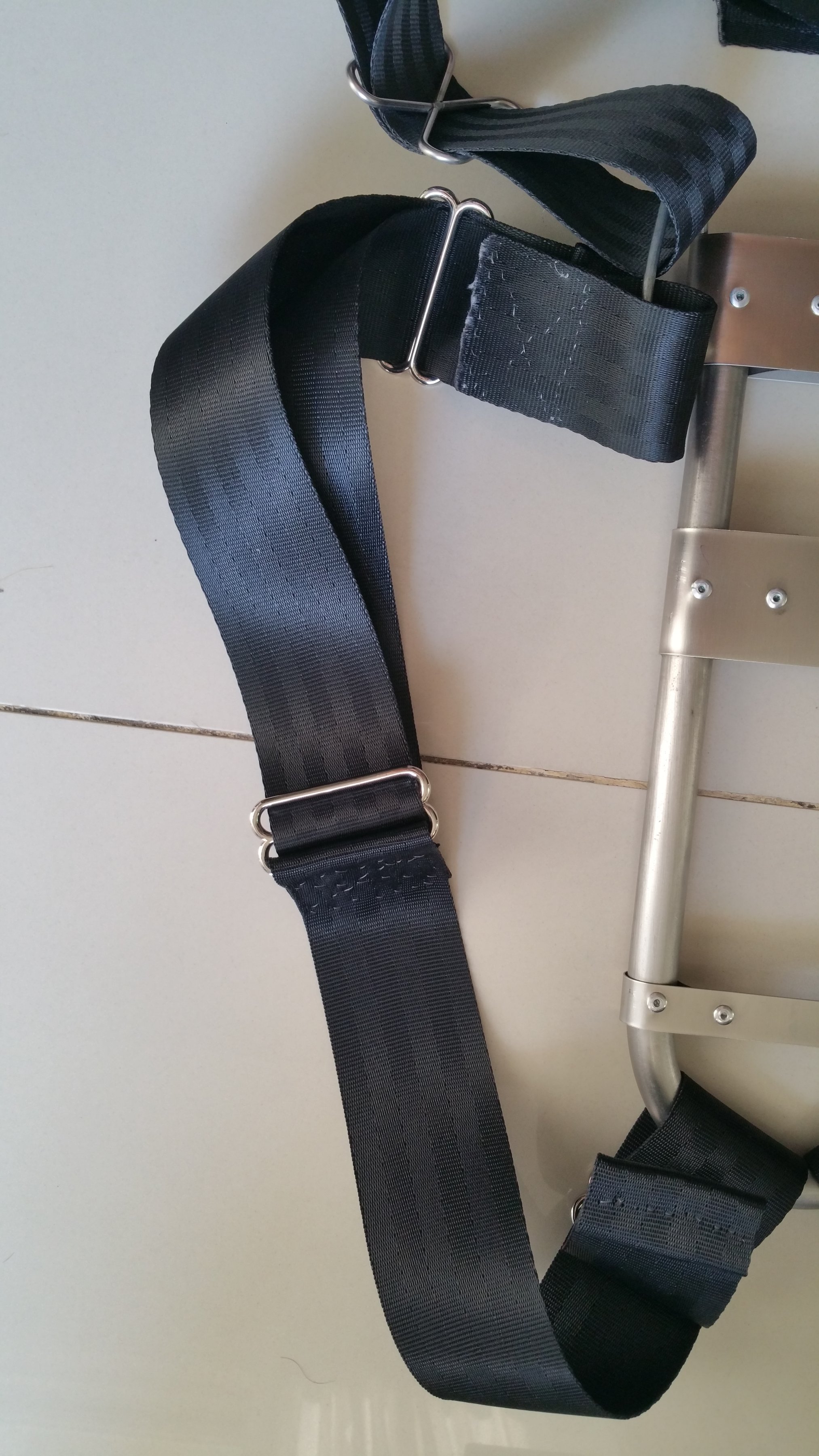

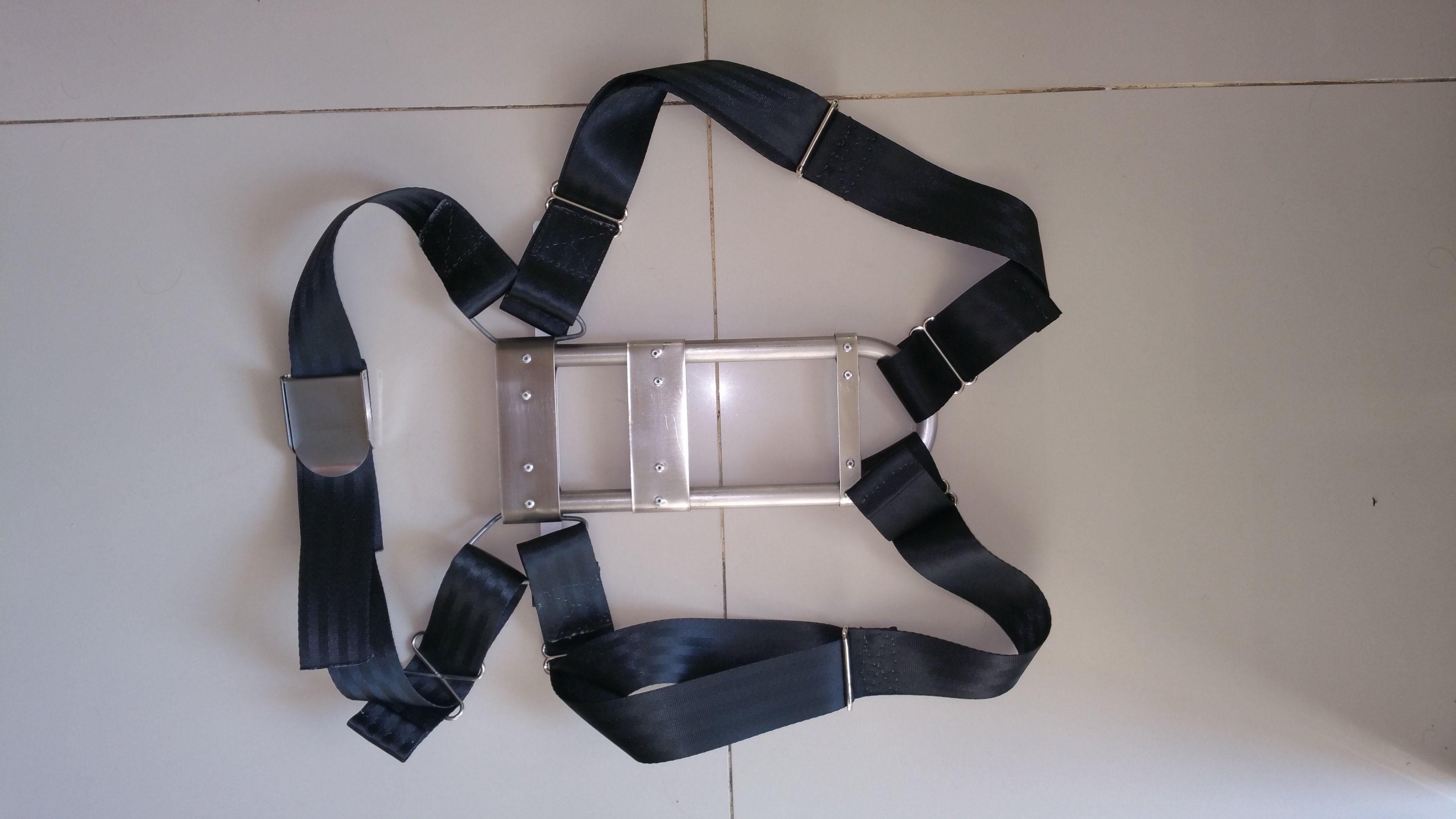

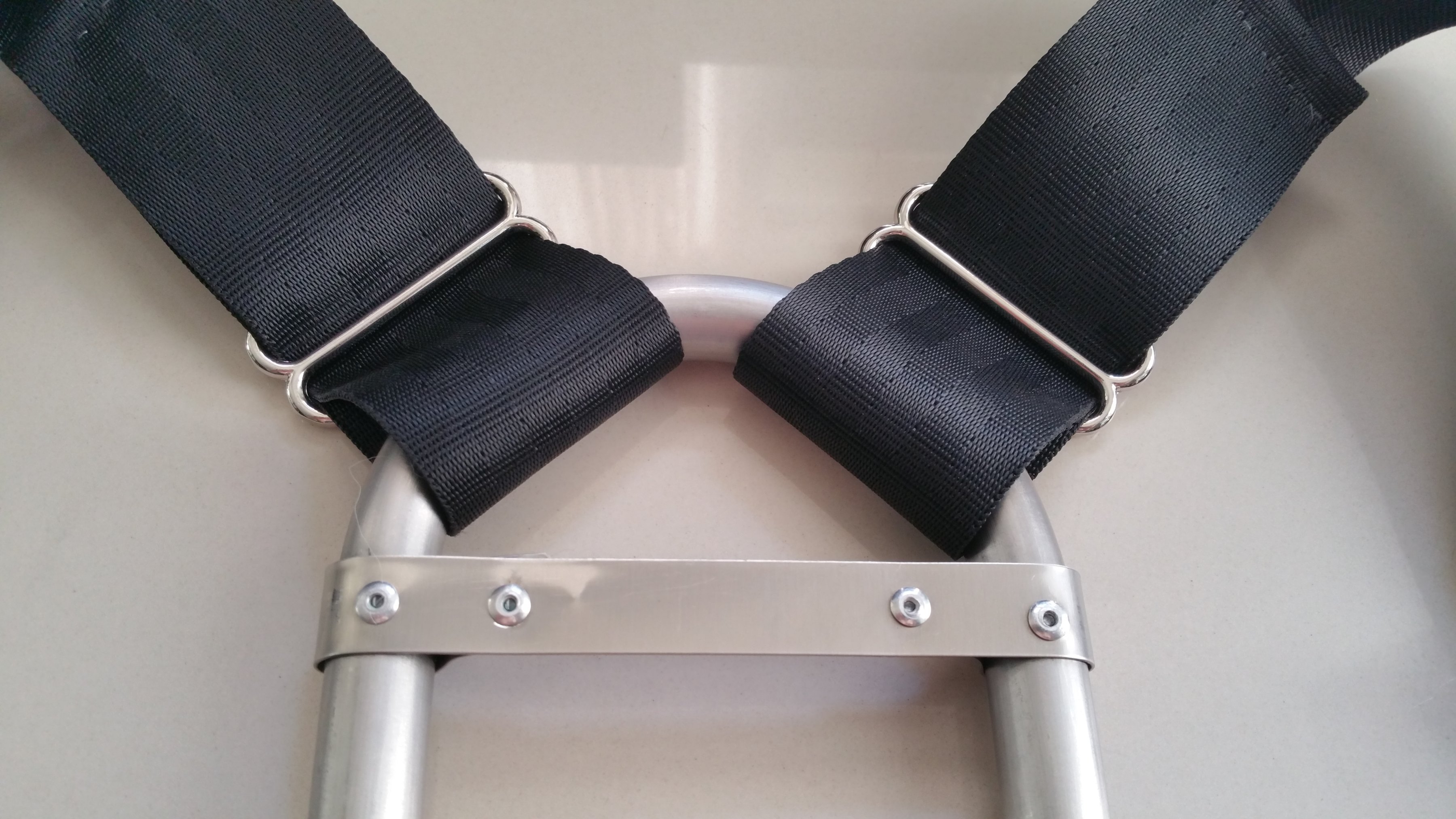

Received a bunch of items and couldn’t wait to start working on them! I must commend every vendor I mentioned below for their excellent craftsmanship, and also a huge gratitude to several members for their exceptionally inspiring and detailed build threads.
I'll start with the jet pack harness.
Breakdown of parts;
- Harness from Bigdane.
- US Divers buckle replica from full metal fett.
- 2 inch Seatbelt webbing from Amazon - Amazon.com : Country Brook Design 2 Inch Seat-belt Black Polyester Webbing, 5 Yards : Climbing Webbing : Sports & Outdoors
- Triglides from Amazon - Amazon.com: 10 - Country Brook Design 2 Inch Metal Round Triglide Slides
I adapted the strapping methods from the awesome tutorials by The5thHorseman for the shoulder straps - Boba Fett Costume and Prop Maker Community and full metal fett for the belt strapping - Boba Fett Costume and Prop Maker Community.
Some changes I made to my rig;
The strap ends that attach to the top of the harness are installed using triglides instead of sewing them up to allow further adjustments if needed.
The same triglides are also used to connect the upper and lower shoulder straps.
Sewed up all the ends to finish off except for the loose strap on the belt. Otherwise it won’t fit through the buckle.
This will do for now as I wait for the jetpack and the back armor to work out the rest of the alignment and rigging.

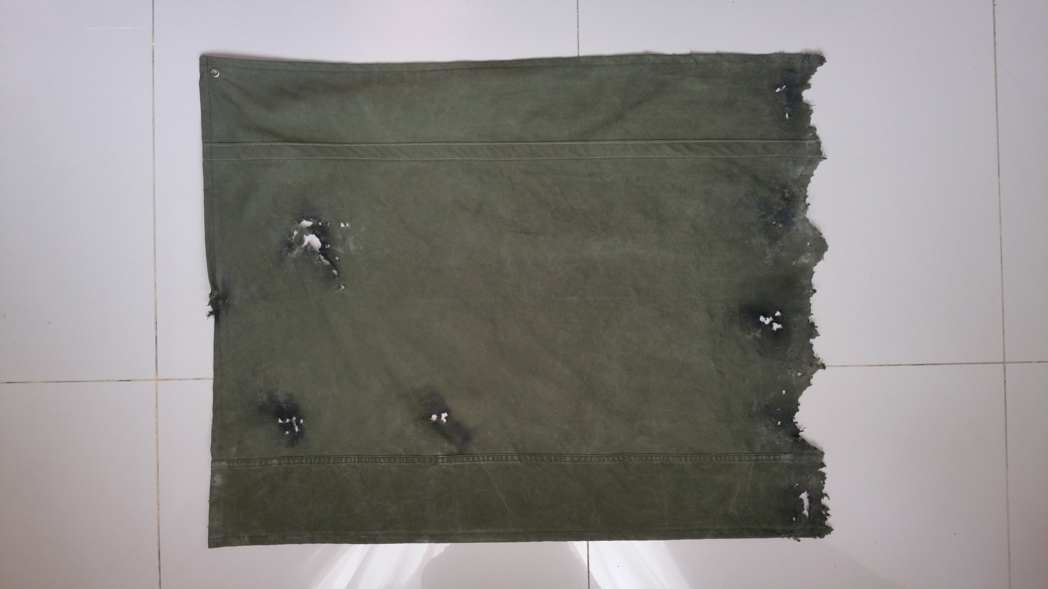

Cape from woodman. Before weathering...
...after weathering. Bashed a rock on the edges, sprayed black on the holes and gave it a light misting.

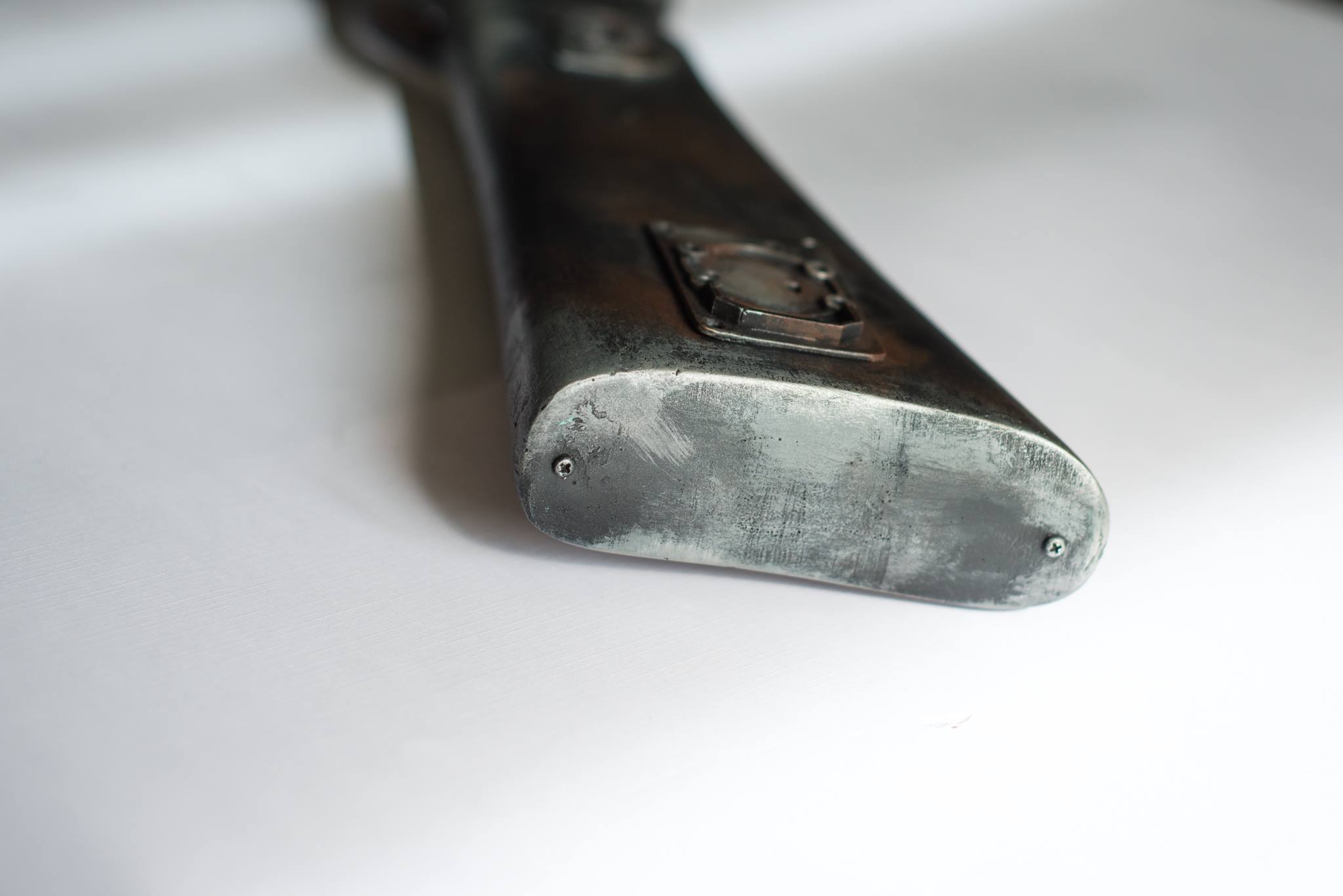

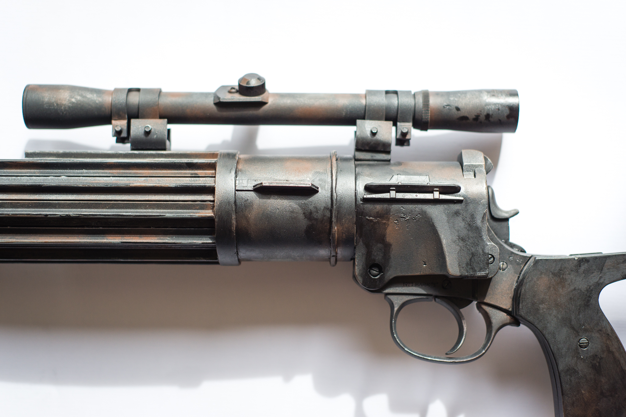

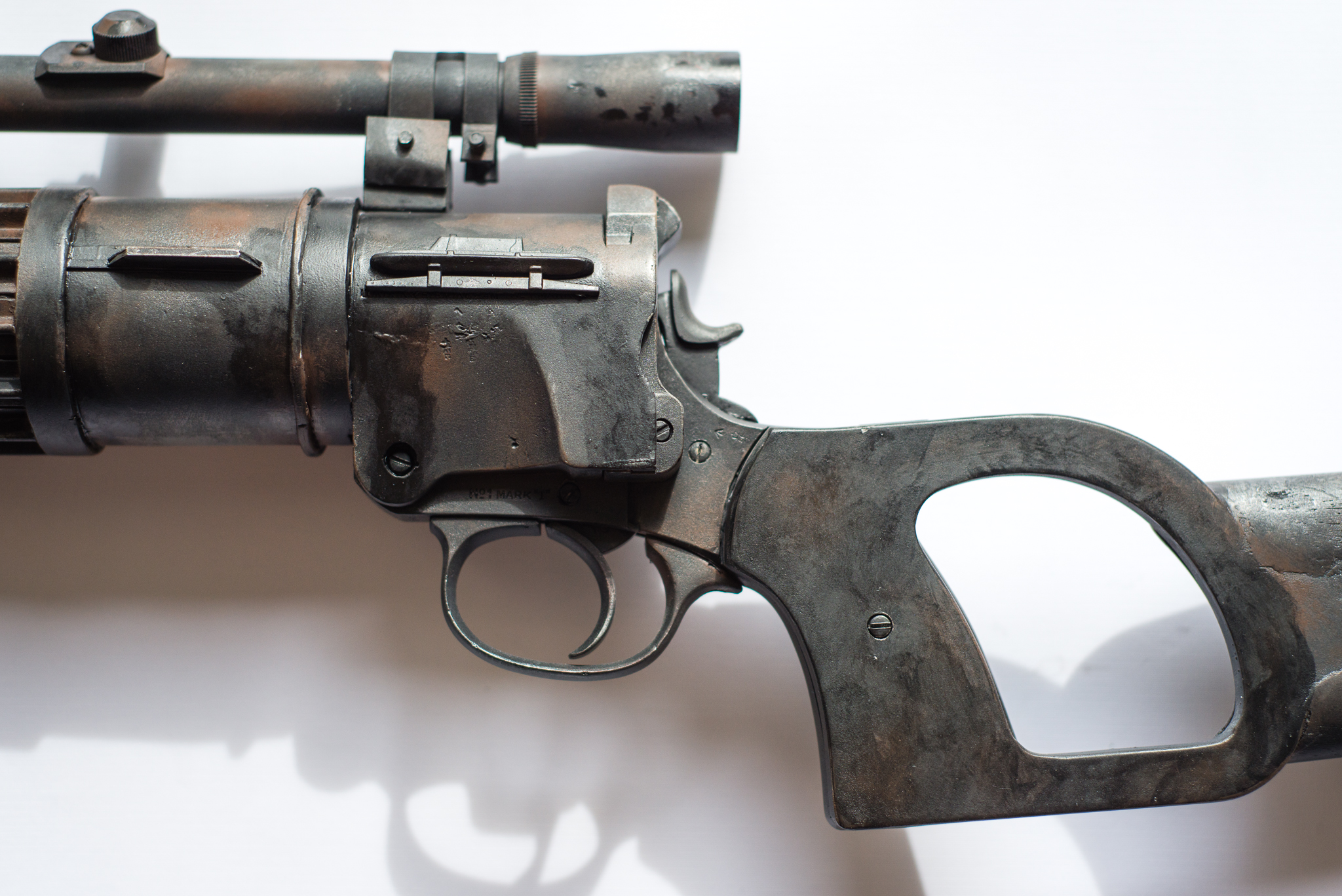

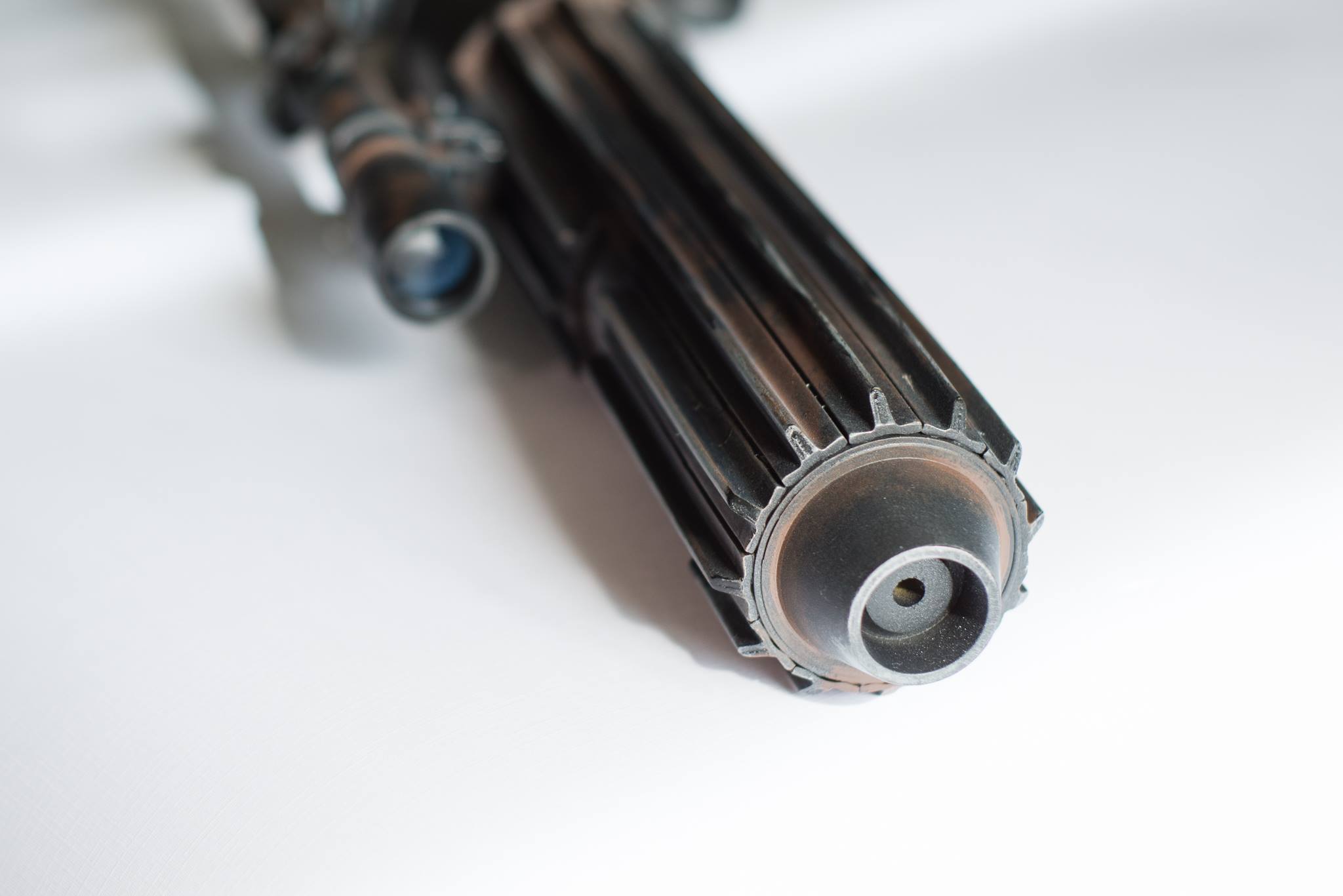

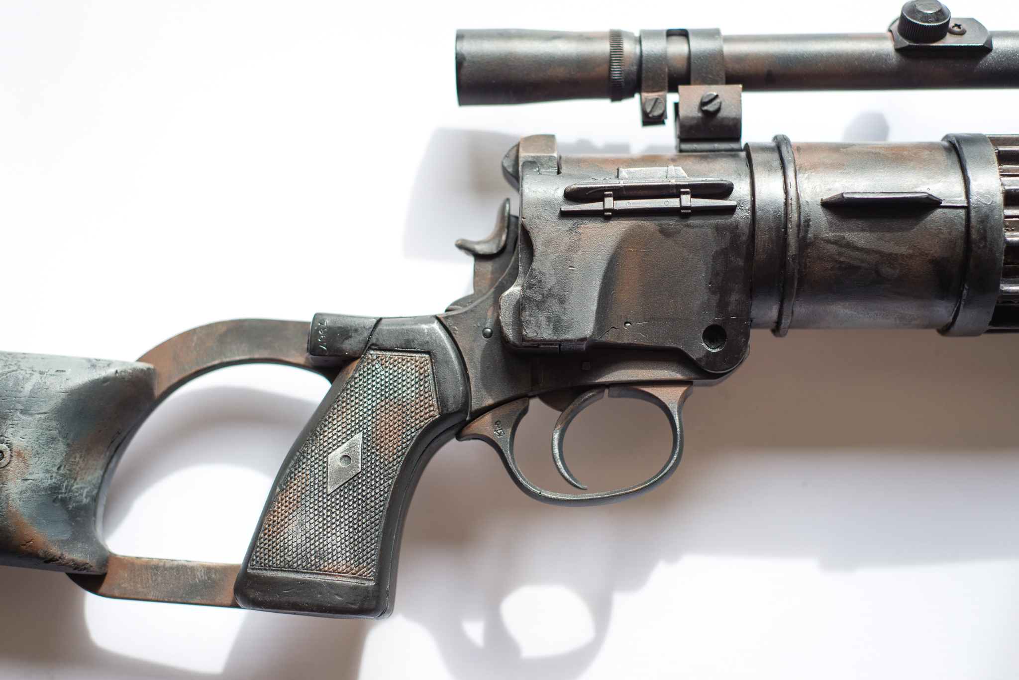

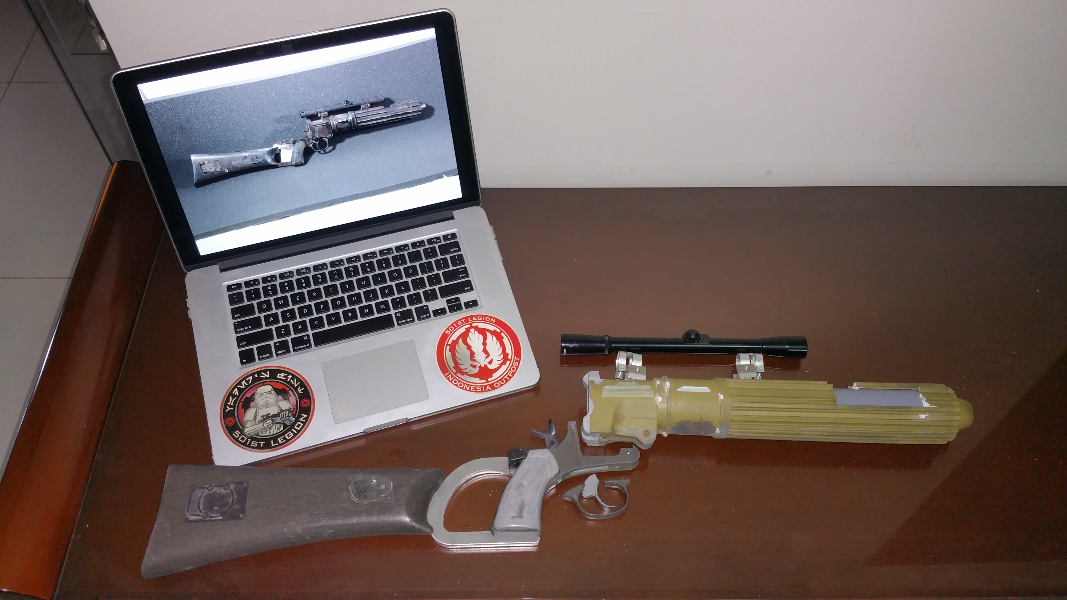

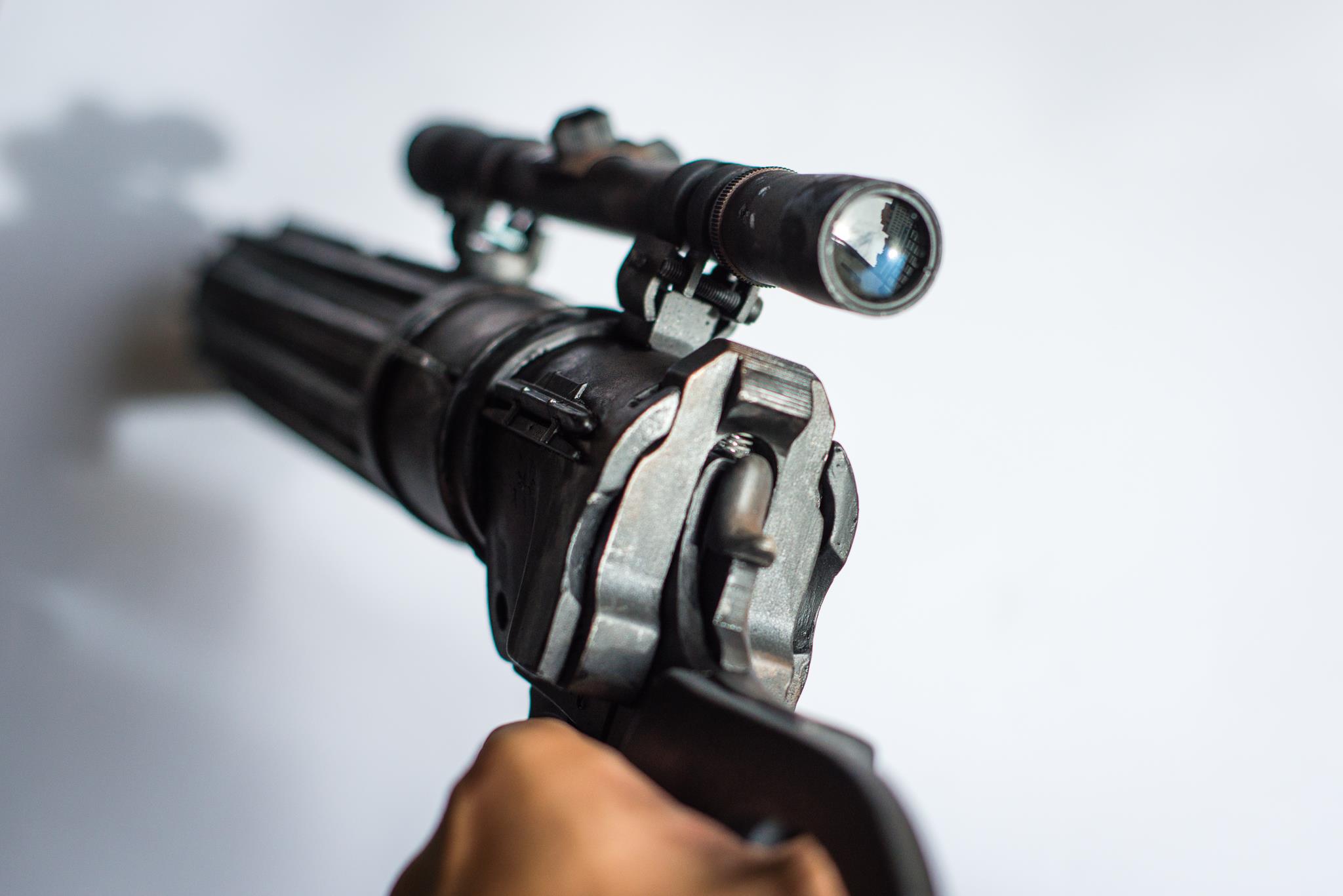

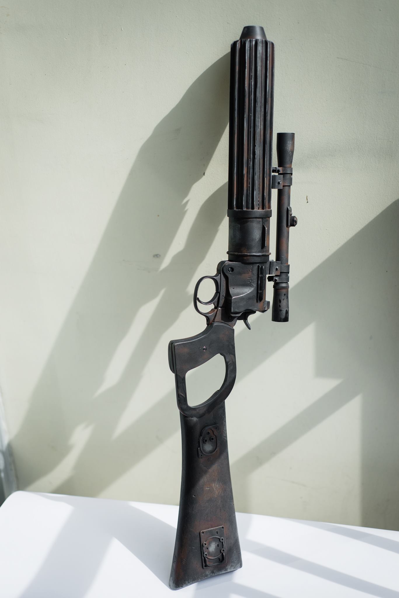

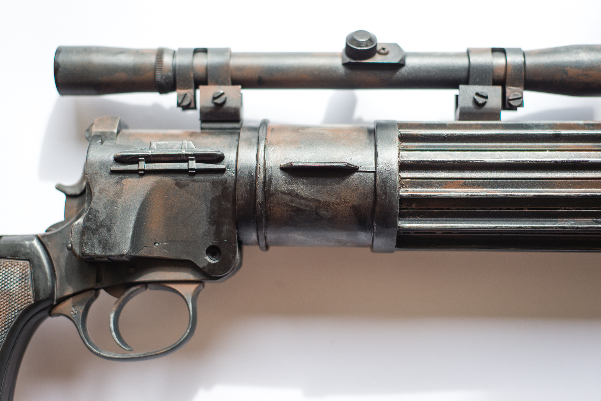

Here's a quick update on my @Sidewinder EE-3 blaster kit build. As most of you should know, Simon's cast is exquisite and requires minimal clean up. I ordered the kit with metal scope mounts and stock bracket upgrade, and is fitted with a vintage Webley & Scott 4x20 rifle scope that I got from Andy @intwenothor.

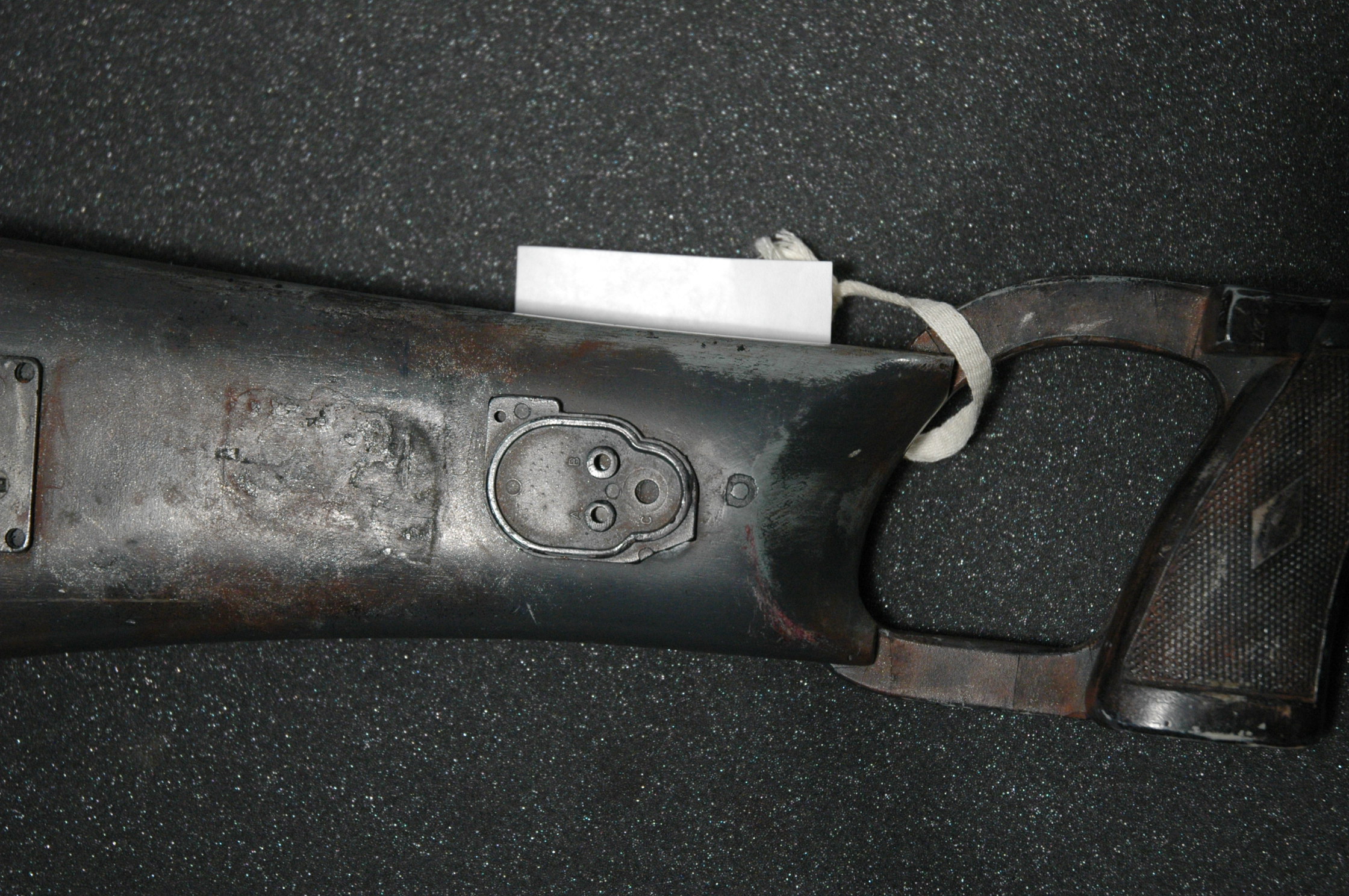

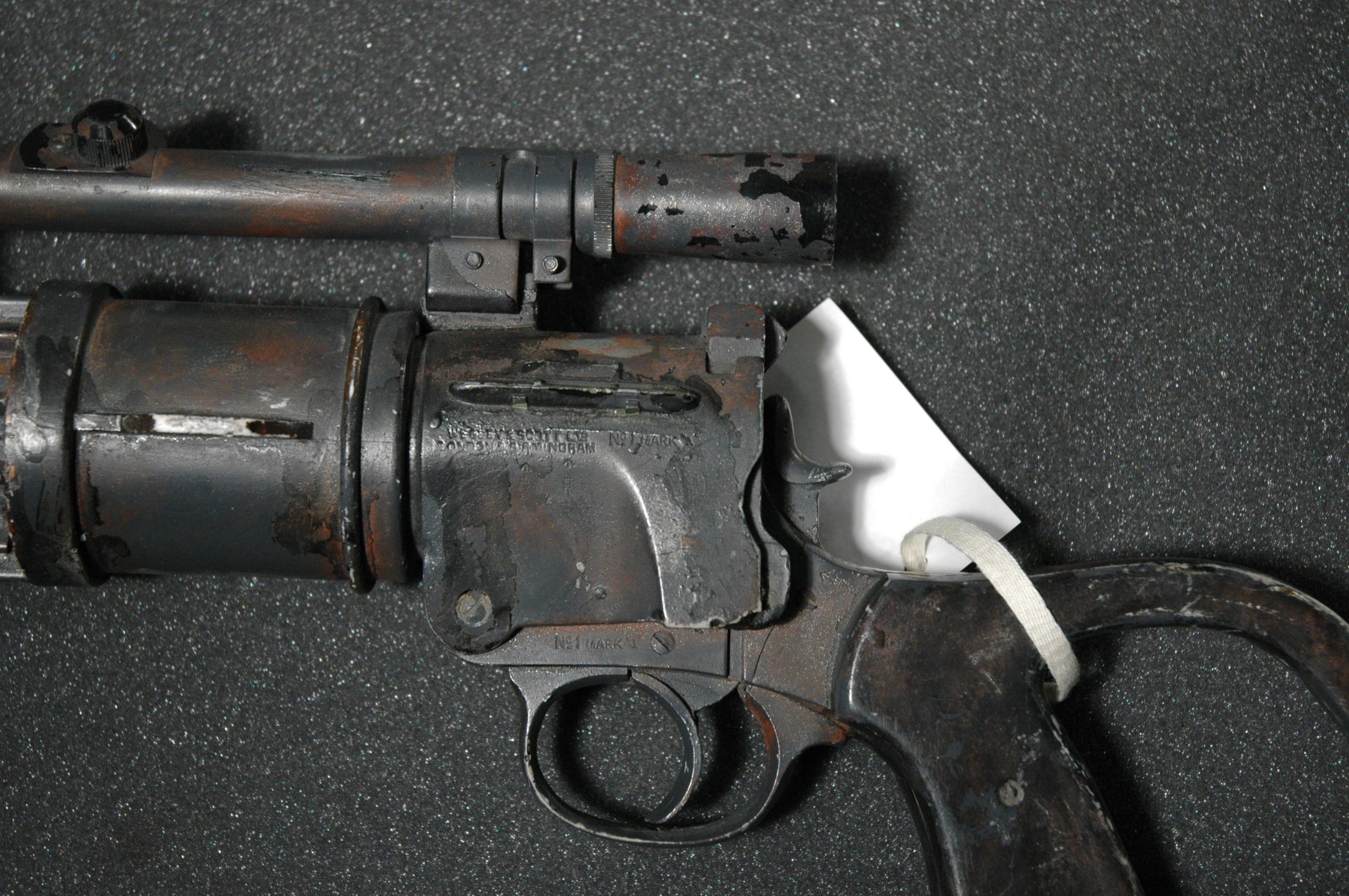

Two Philips-head screws were added to the stock butt as shown in the reference photo from the gallery: https://www.thedentedhelmet.com/forums/media/boba-fett-return-of-the-jedi-blaster-rifle.7403/full
The kit was modified to include a working trigger and upper receiver latch + hinge. I followed some of the techniques from this amazing build thread by @The5thHorseman: Blaster - EE-3 Carbine build as ESB using Sidewinder's kit. *Final update: Painting+Assembling*
For paintwork, I used Ace primer and flat black, misted with Tamiya gun metal, then weathered with My Color enamel paints. I followed the reference photos (Boba Fett Return of the Jedi Blaster Rifle | Boba Fett Costume and Prop Maker Community) as closely as I possibly could to replicate the weathering. Here are the photos in sections.
Note that the hammer was shortened to match reference photo: https://www.thedentedhelmet.com/forums/media/boba-fett-return-of-the-jedi-blaster-rifle.7382/full
In this reference photo https://www.thedentedhelmet.com/forums/media/boba-fett-return-of-the-jedi-blaster-rifle.7390/full, a corner of the skull-shaped greeblie is broken. I chose to leave it intact since it is unknown (at least to me) if the damage was made during or post production.
