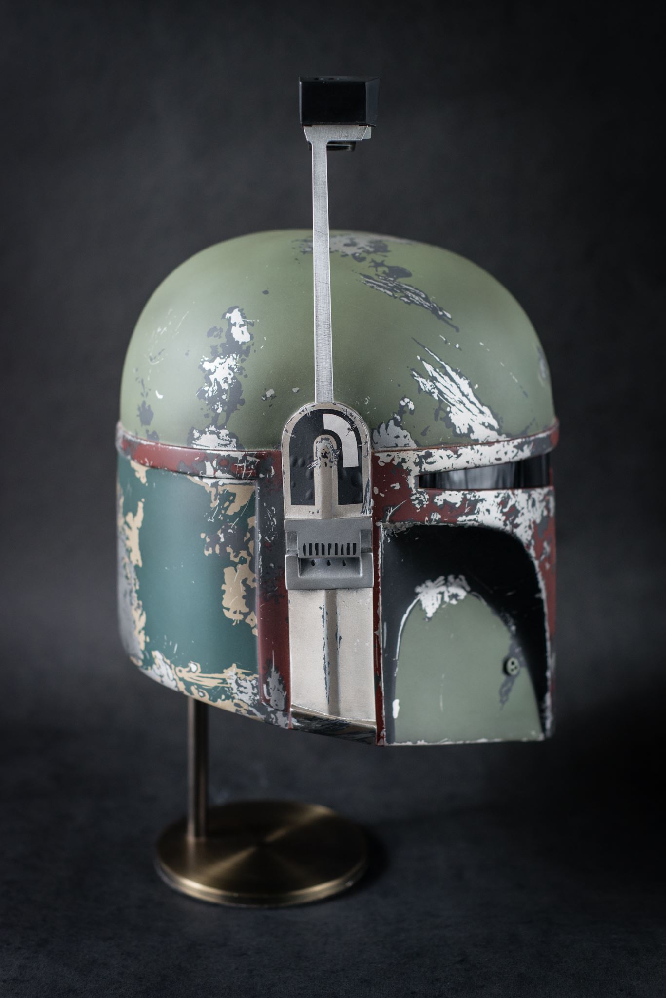

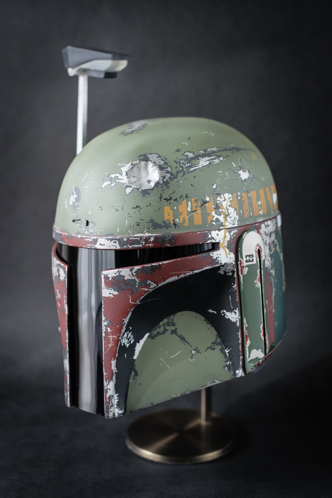

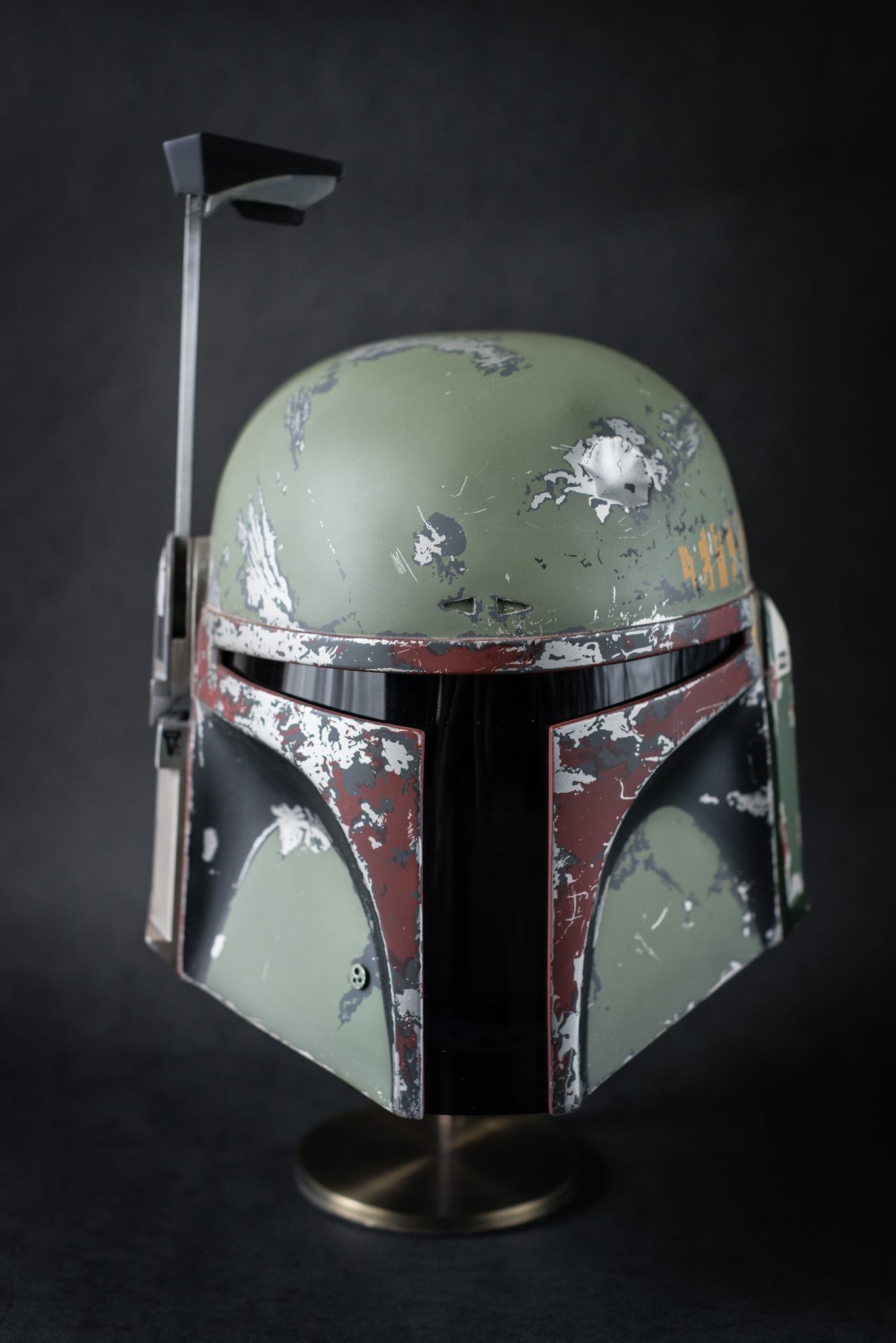

I am failing miserably at posting progress on this build since I can't seem to stop and take photos once I get into the groove. So I thought I share some photos of the gorgeous helmet by Daz (Bobamaker).

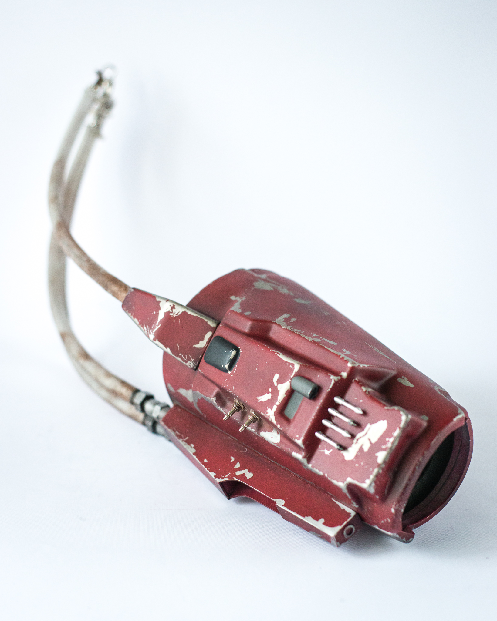

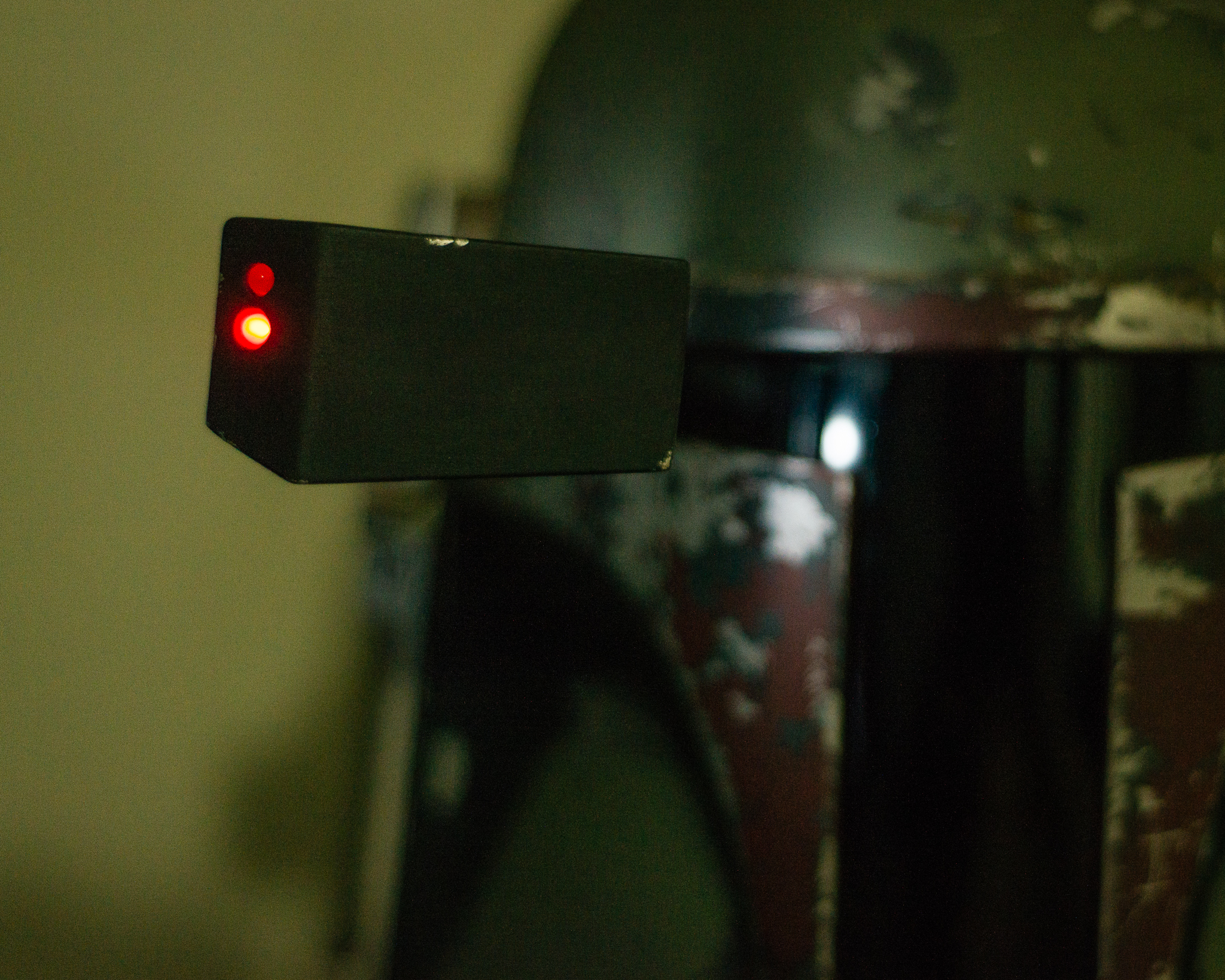

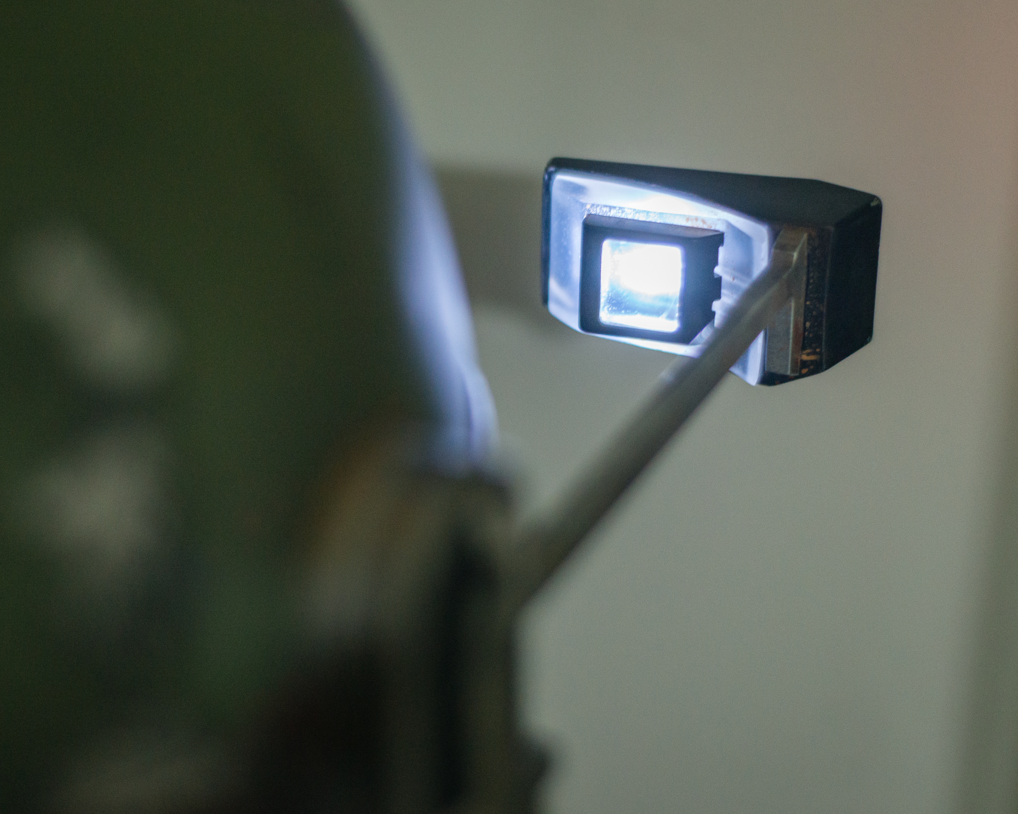

An animefan rangefinder has been modified to fit the stalk and is fitted with a self-contained light kit by Jc27.

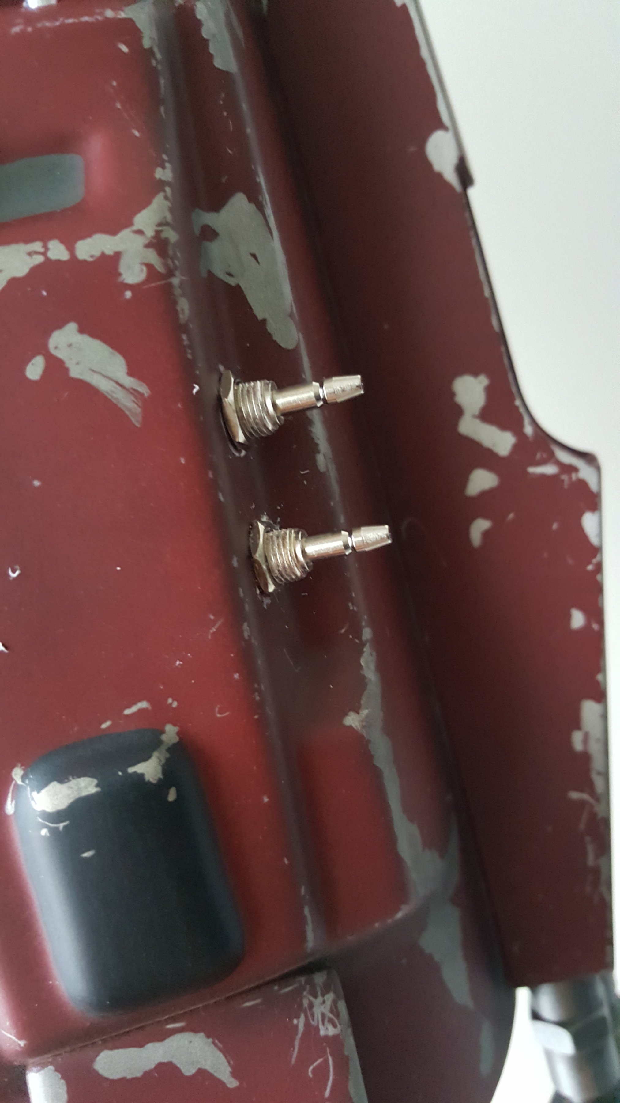

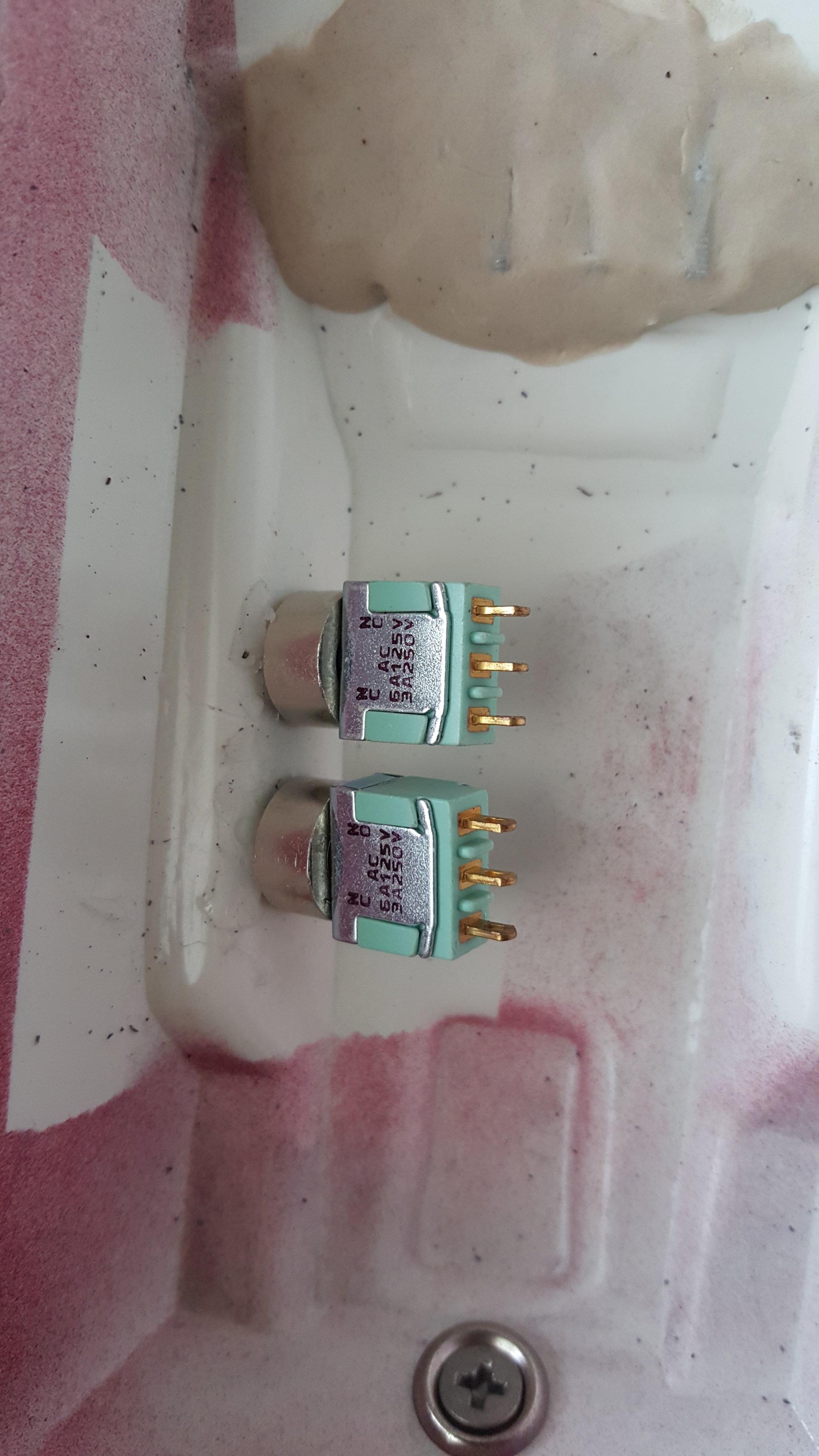

Daz's gauntlets come installed with toggle switches that I swapped with the accurate Alco push switches that came with Jc27's servo kit.

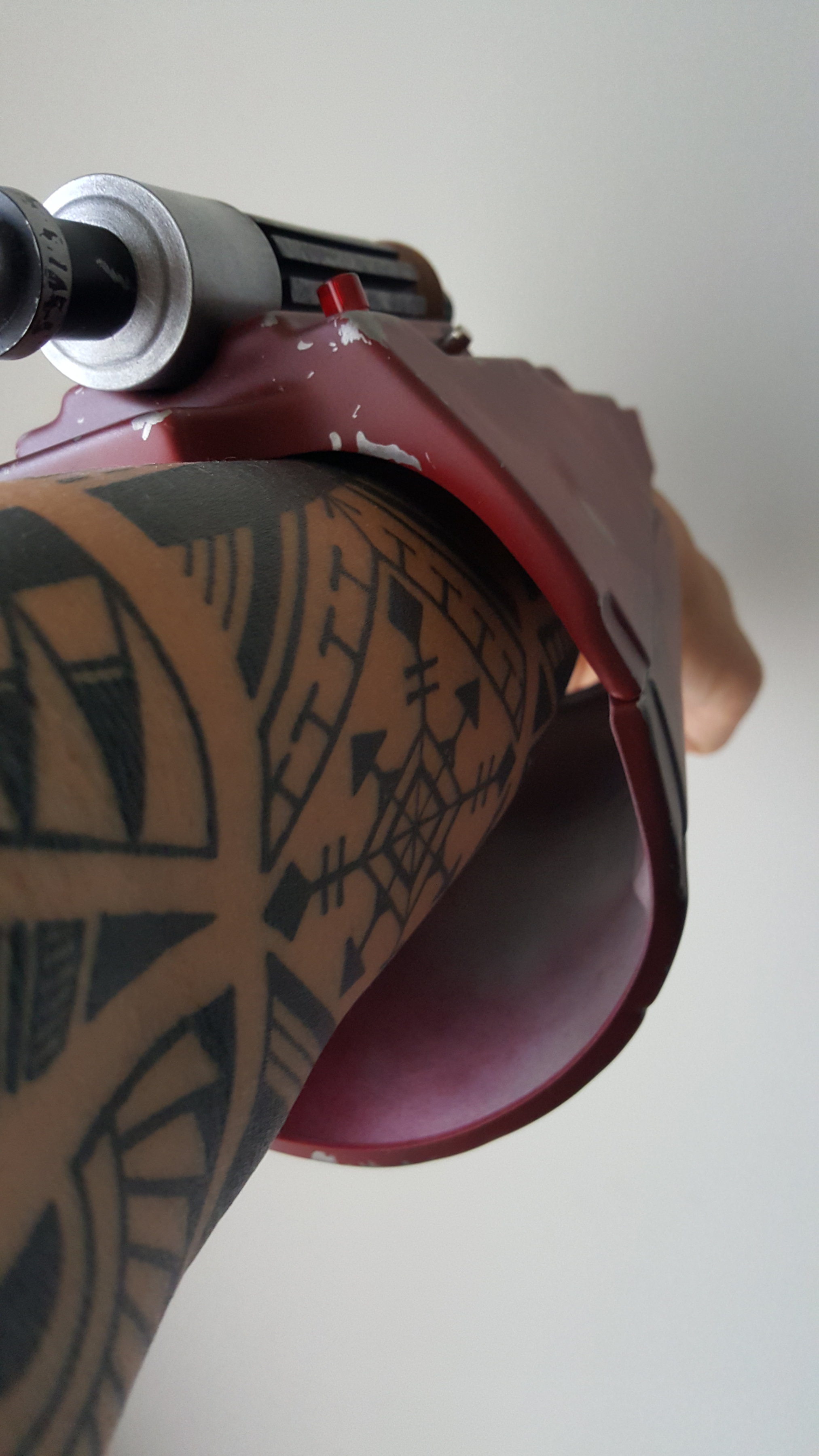

My forearms are puny so there was way too much room!

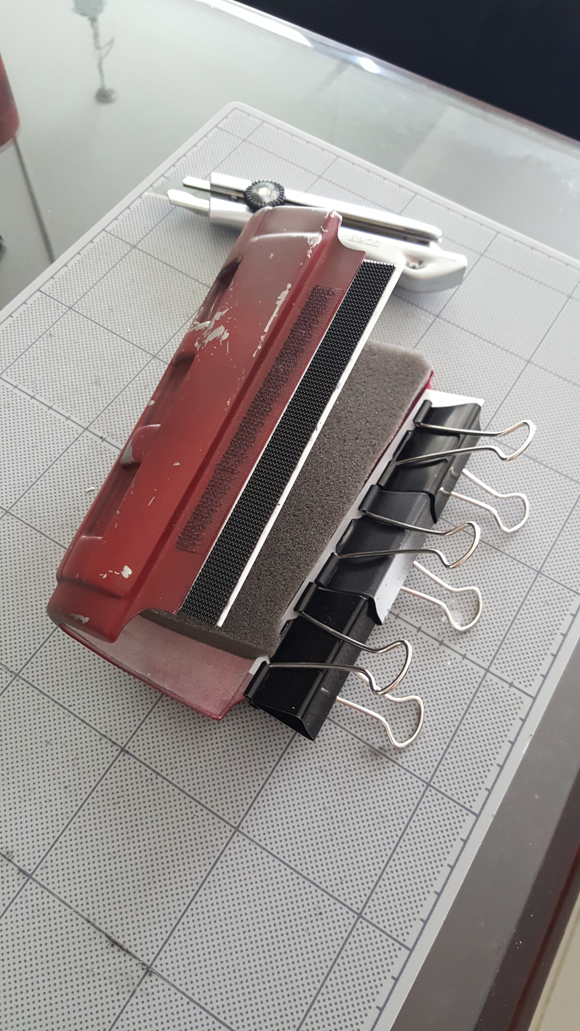

Stuffed some foam in there and all's well again. Each gauntlet is enclosed via thin strips of velcro and tend to pop open when I flex my arms. So I extended the attachment strips with styrene sheets and stuck some industrial velcro on. Now the gauntlets remain firmly closed but are possible to open with a little effort.

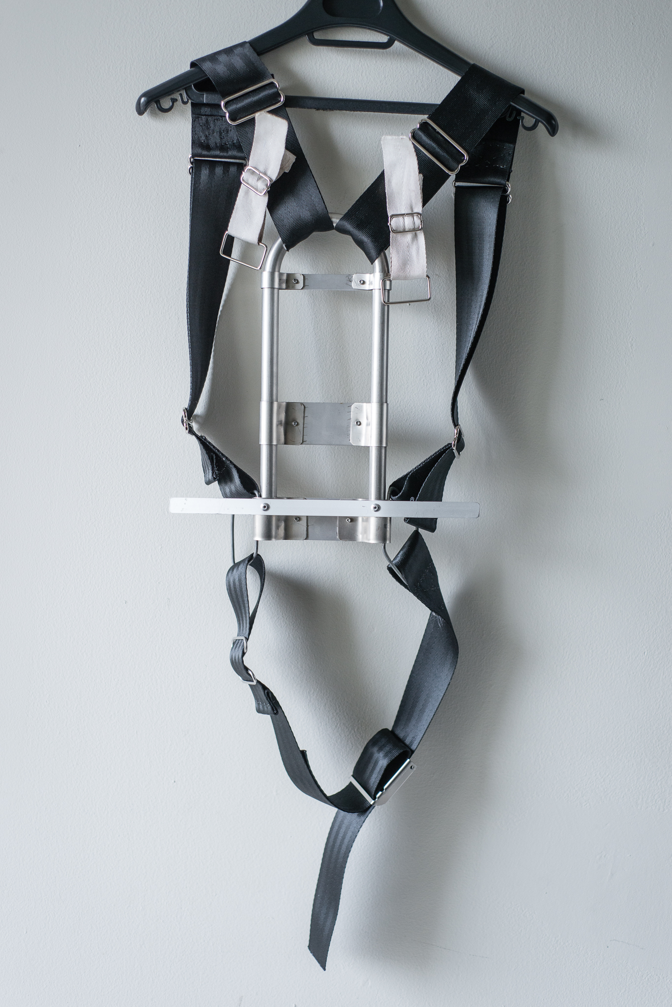

Yesterday I got some much needed help with the jetpack and harness alignment, and boy was it a nightmare! The straight harness bar made some serious scratches on the back of the jetpack due to its curvature. The obvious thing (or so I thought) to do was to bend the bar so it curves along the jetpack and the clip can sit on the bar, but this resulted in the back armor being scratched too. Does anyone have similar issues and how do you resolve them?

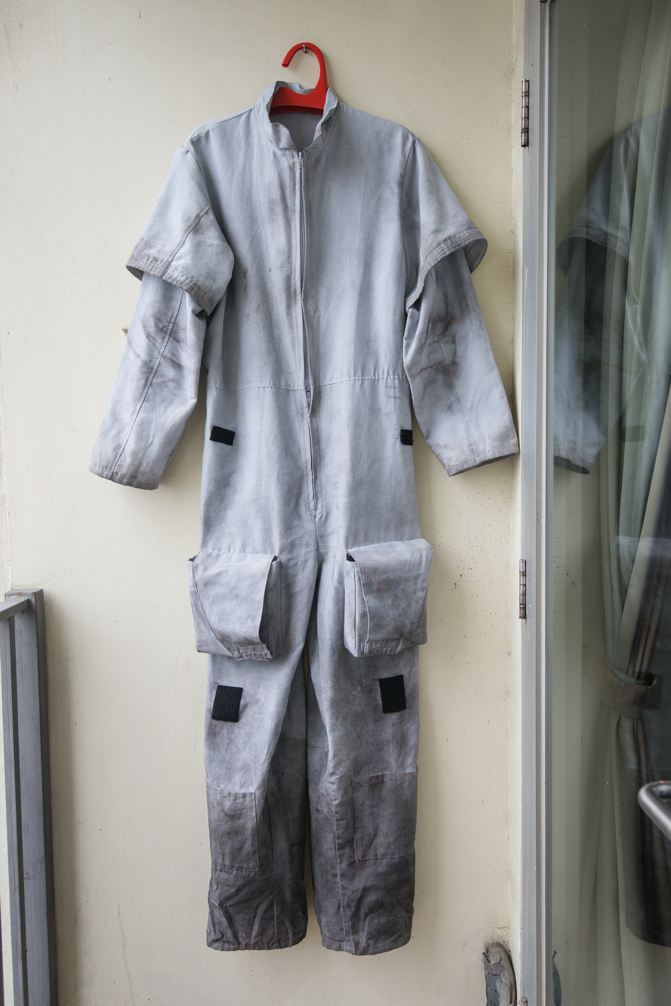

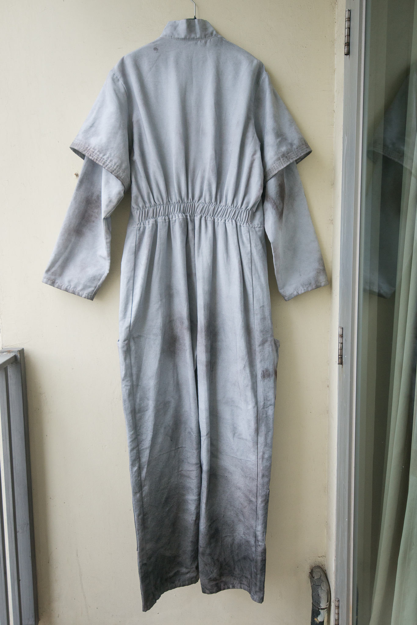

Flight suit (Bobamaker)

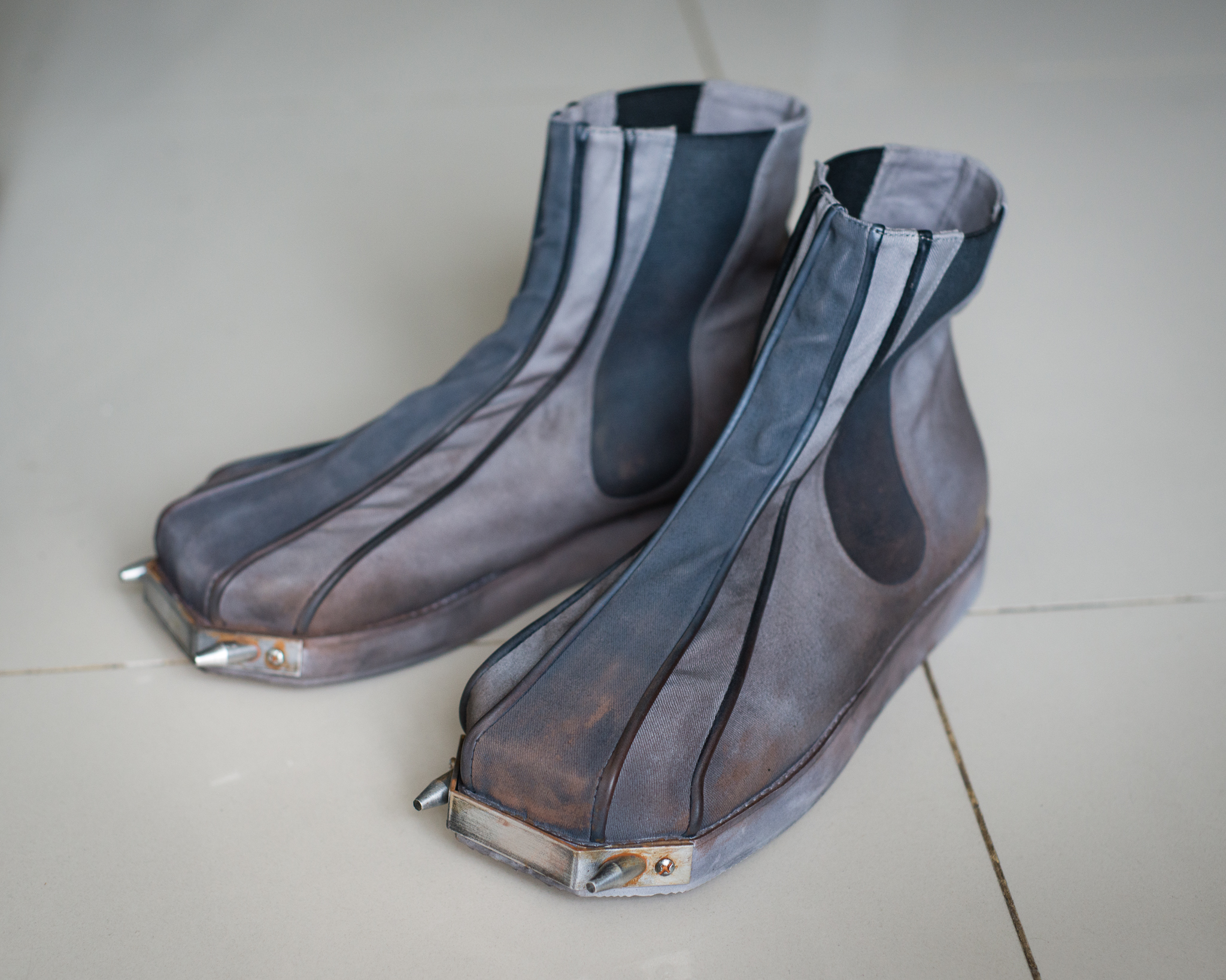

Boots (Bobamaker)

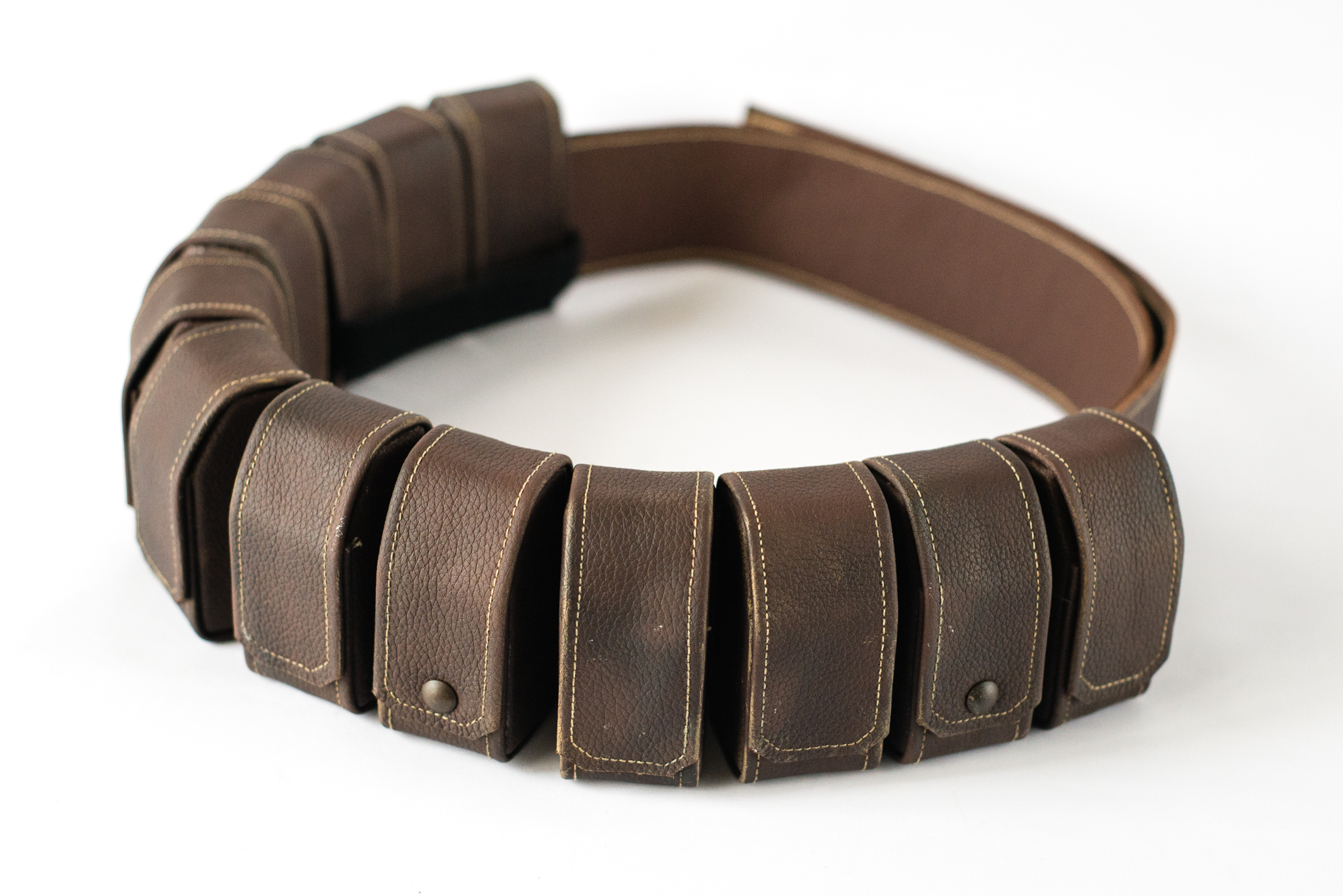

Ammo belt (Bobamaker)

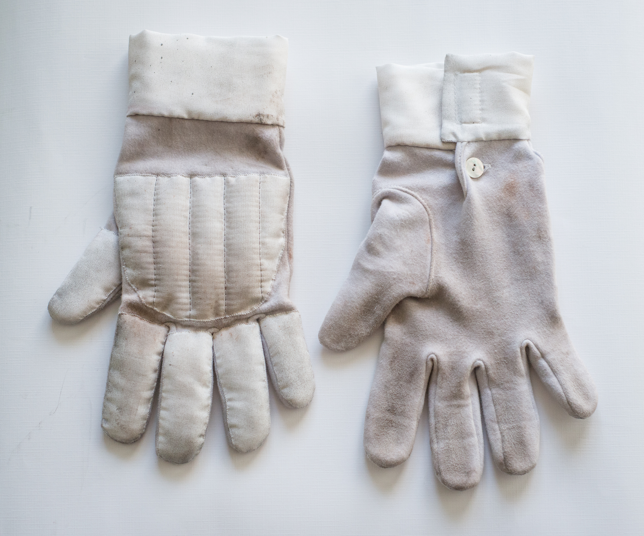

Gloves (Major)

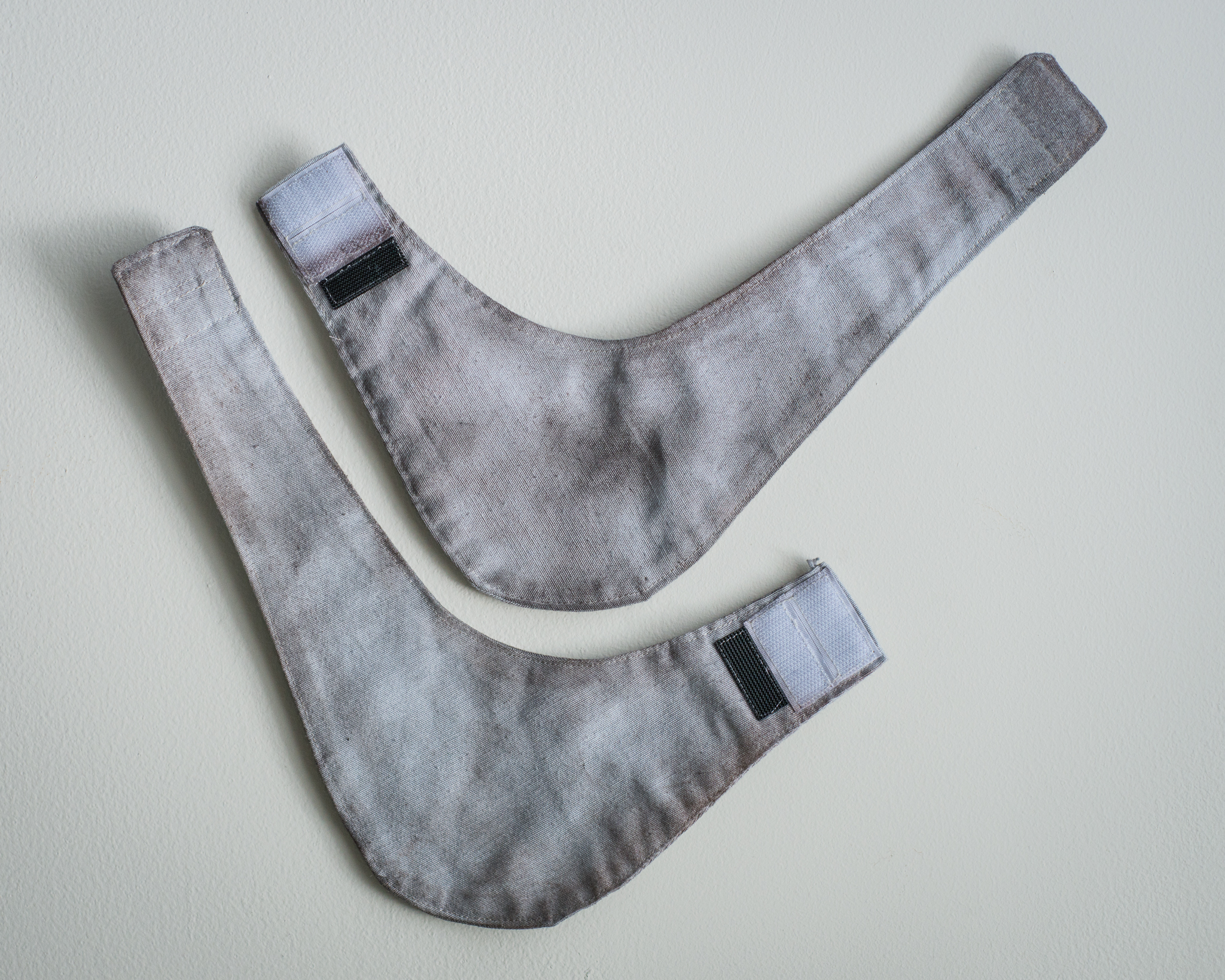

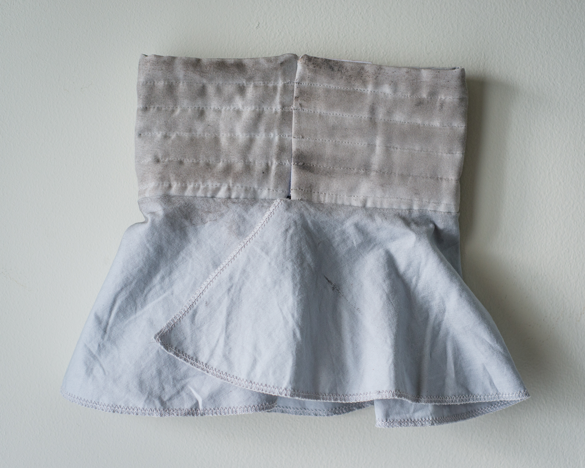

Neck seal (Arkady)

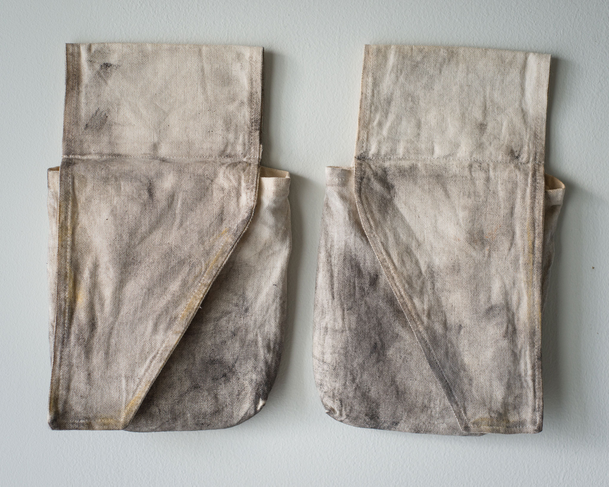

Hip Pouches (Arkady)

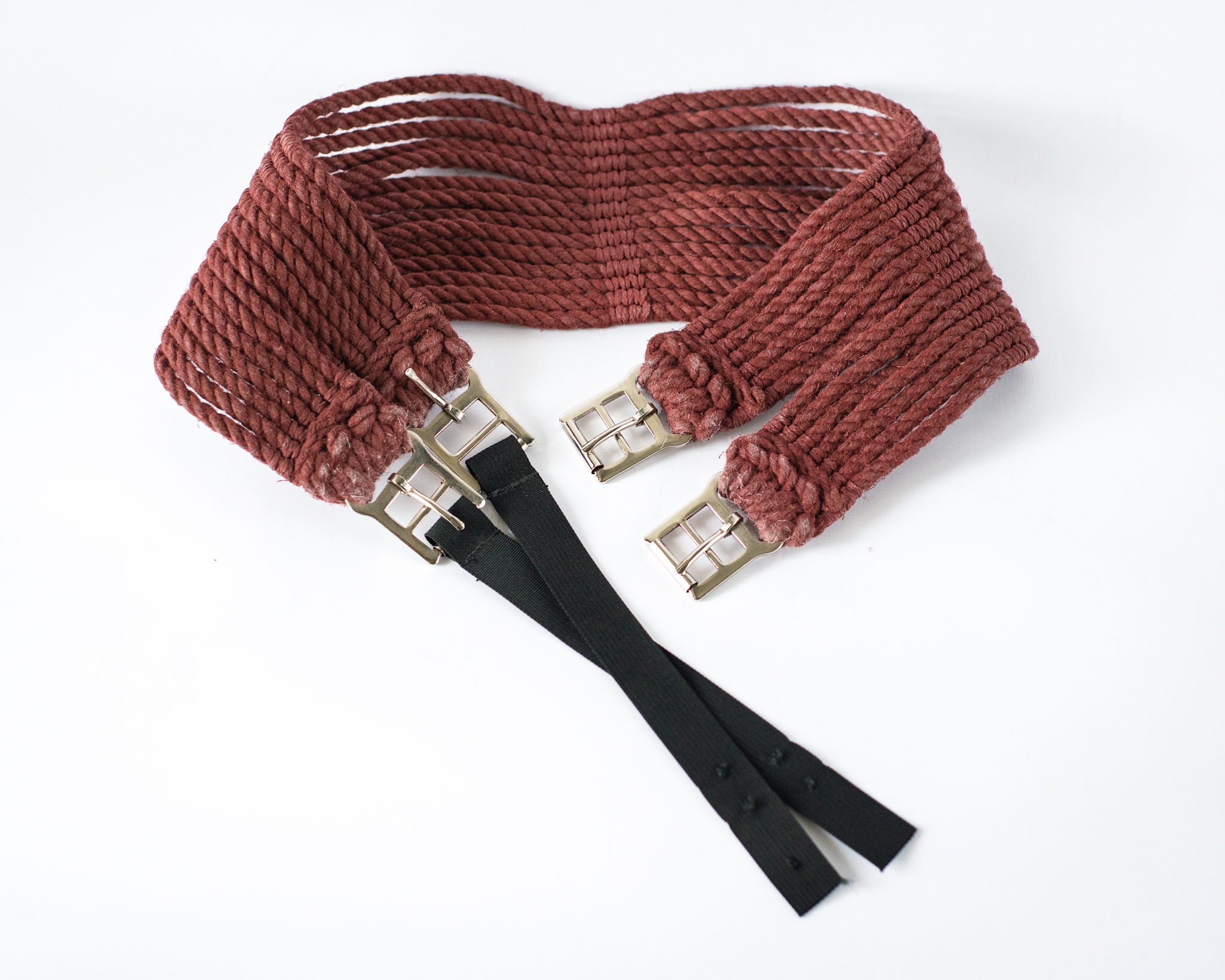

Girth belt (Woodman)

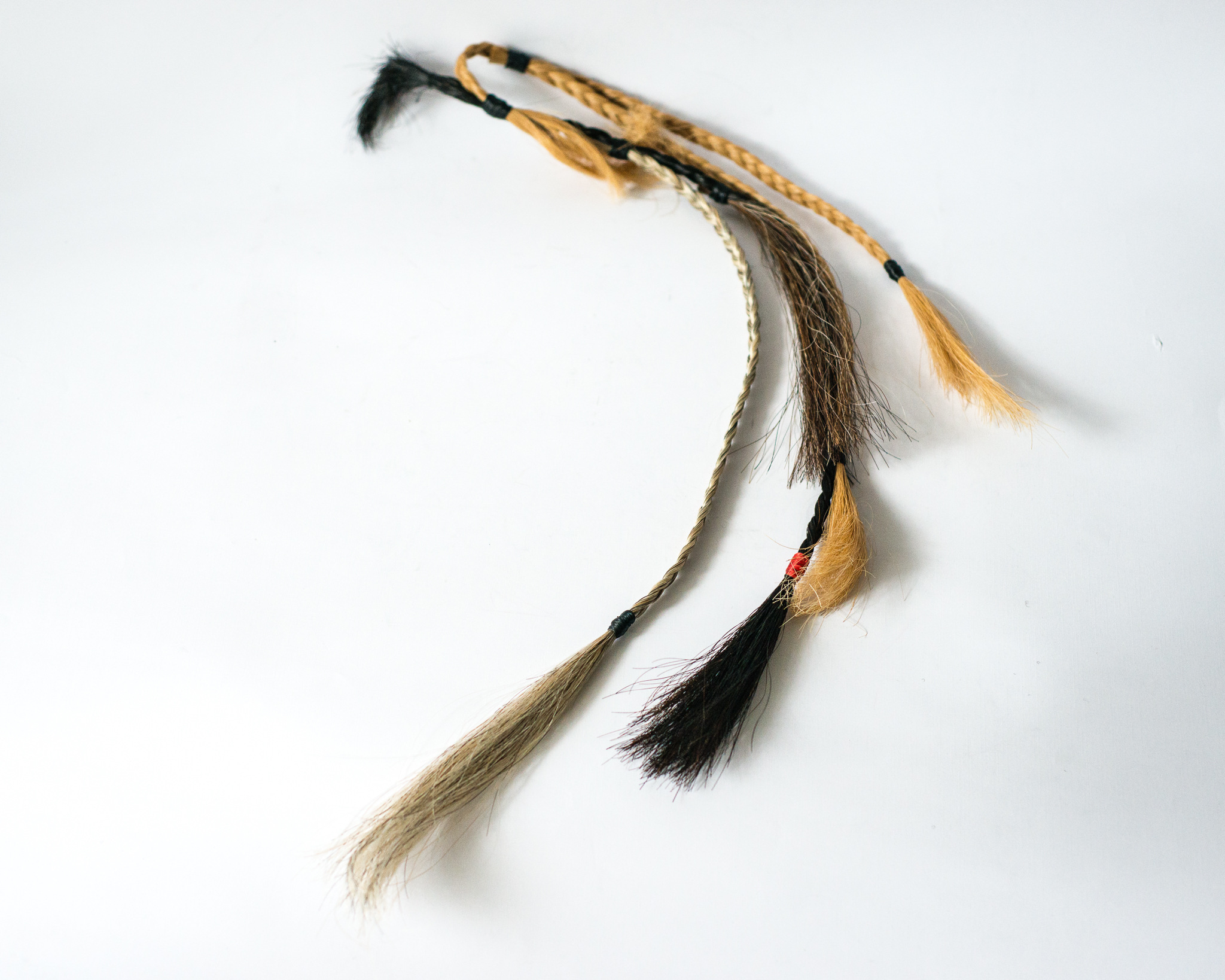

Wookie braid (horse hair - Woodman)

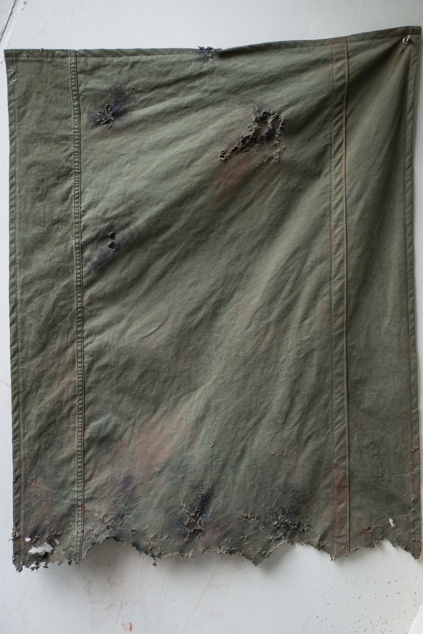

Cape (Woodman)

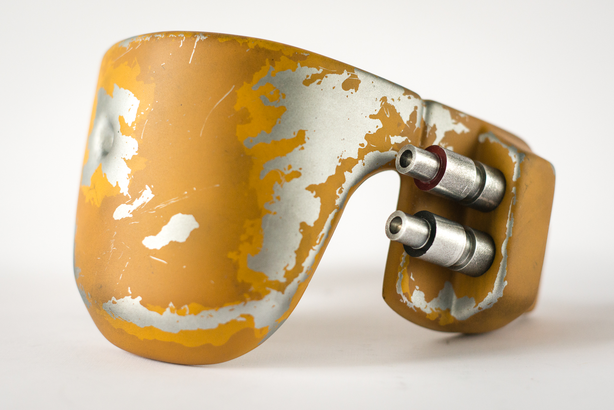

Right gauntlet (Bobamaker)

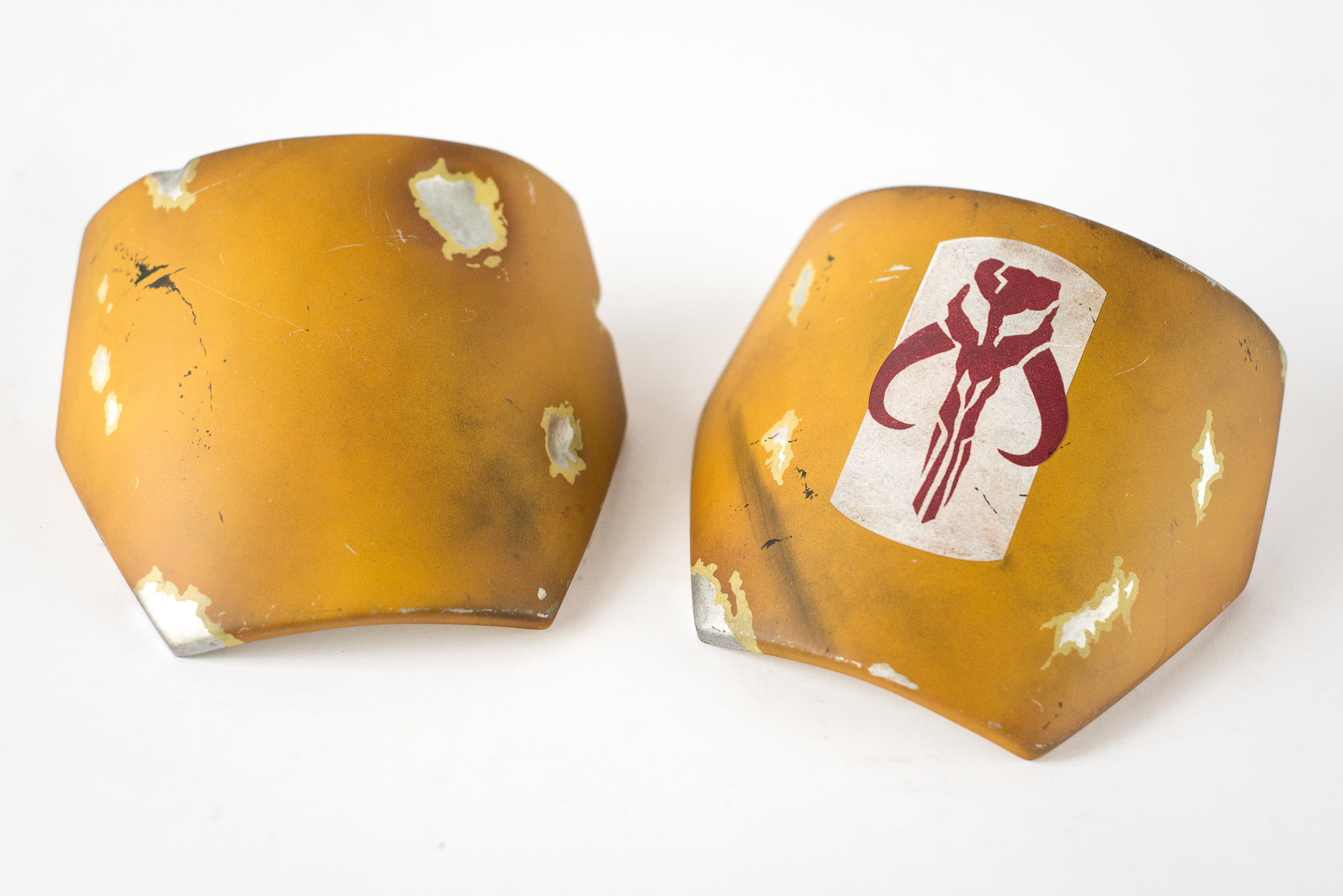

Shoulder armor (Bobamaker)

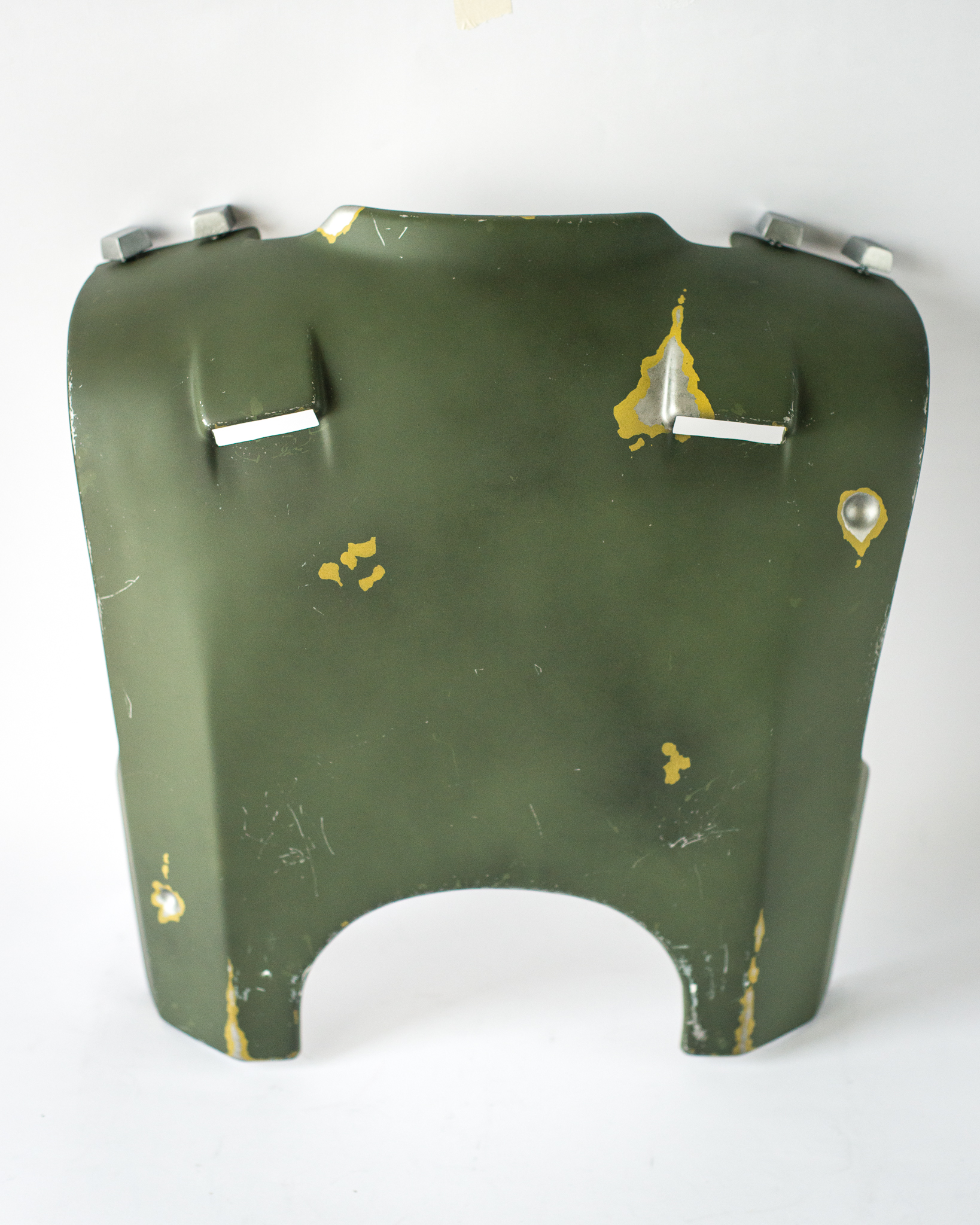

Back armor (Bobamaker)

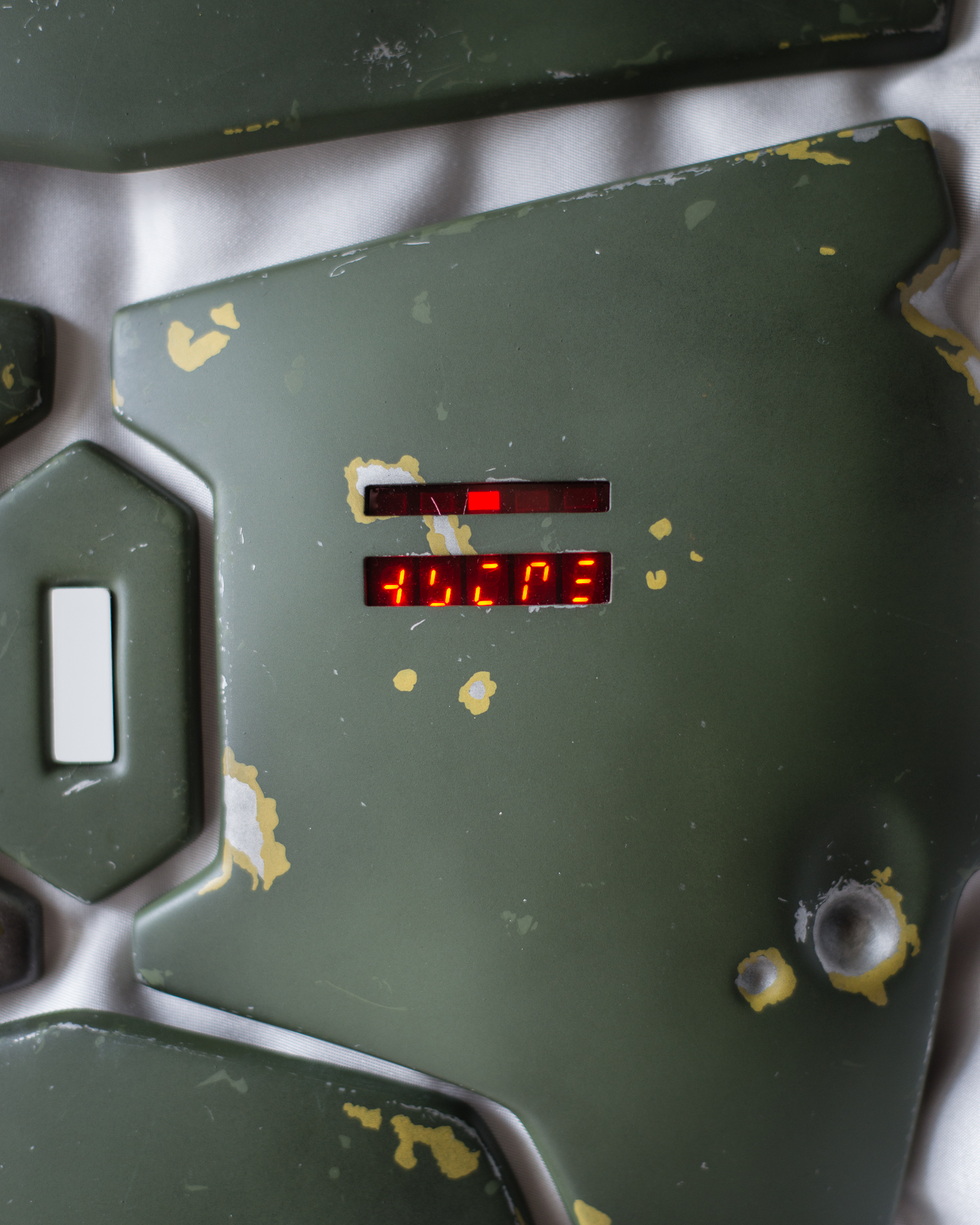

Codpiece and kidney plate (Bobamaker)

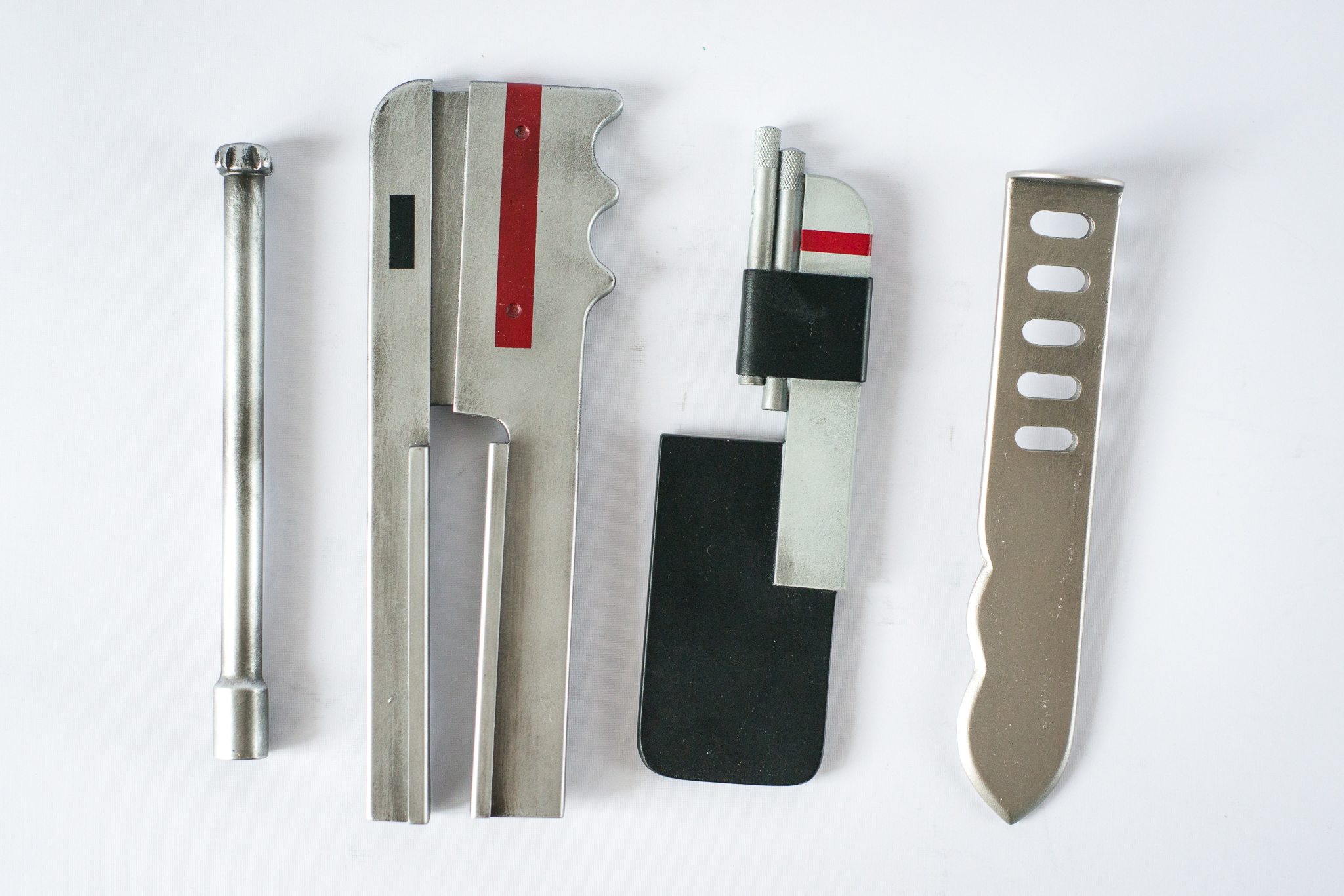

Shin tools (Bobamaker)

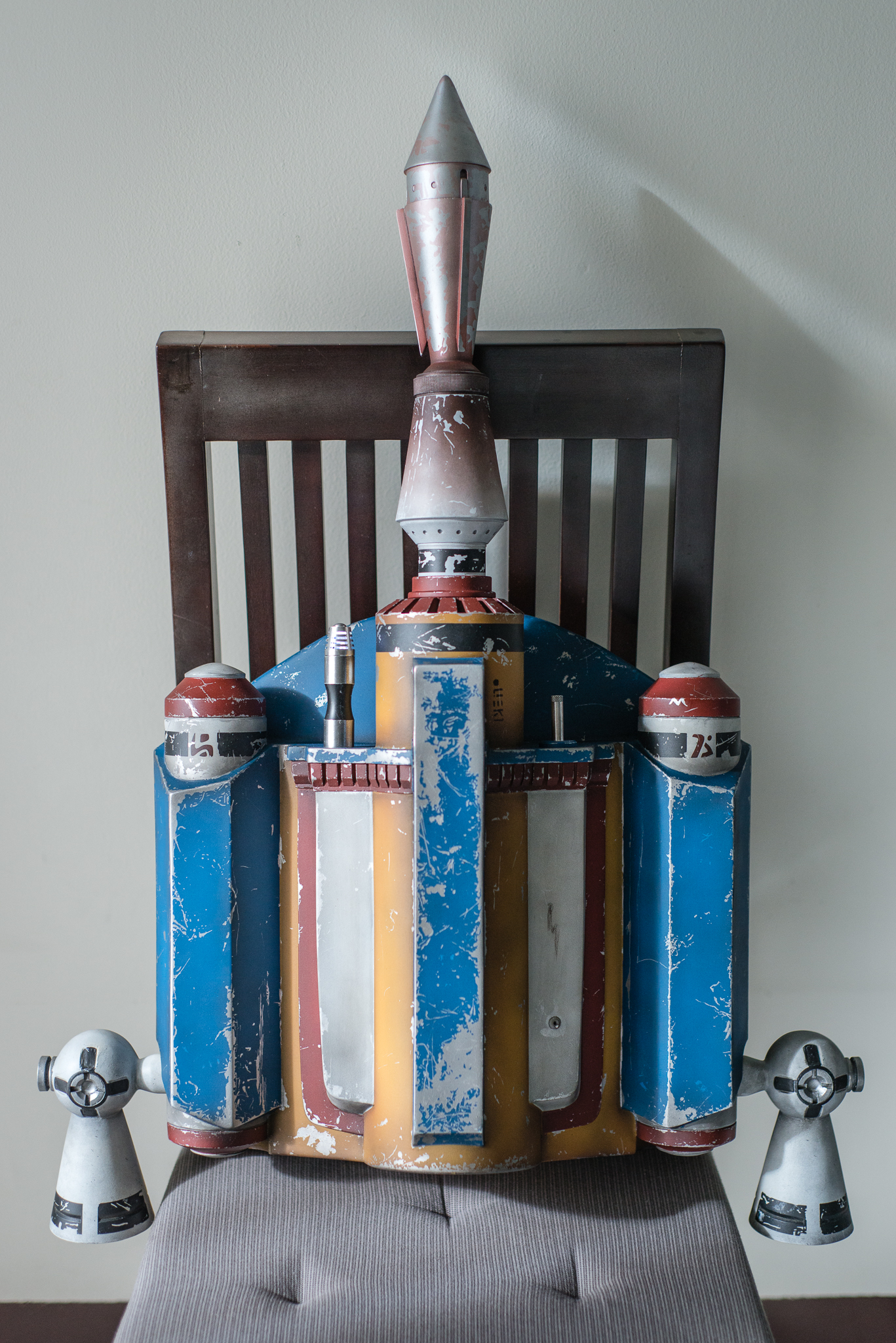

Jetpack (Bobamaker)
Jetpack harness (Bigdane)

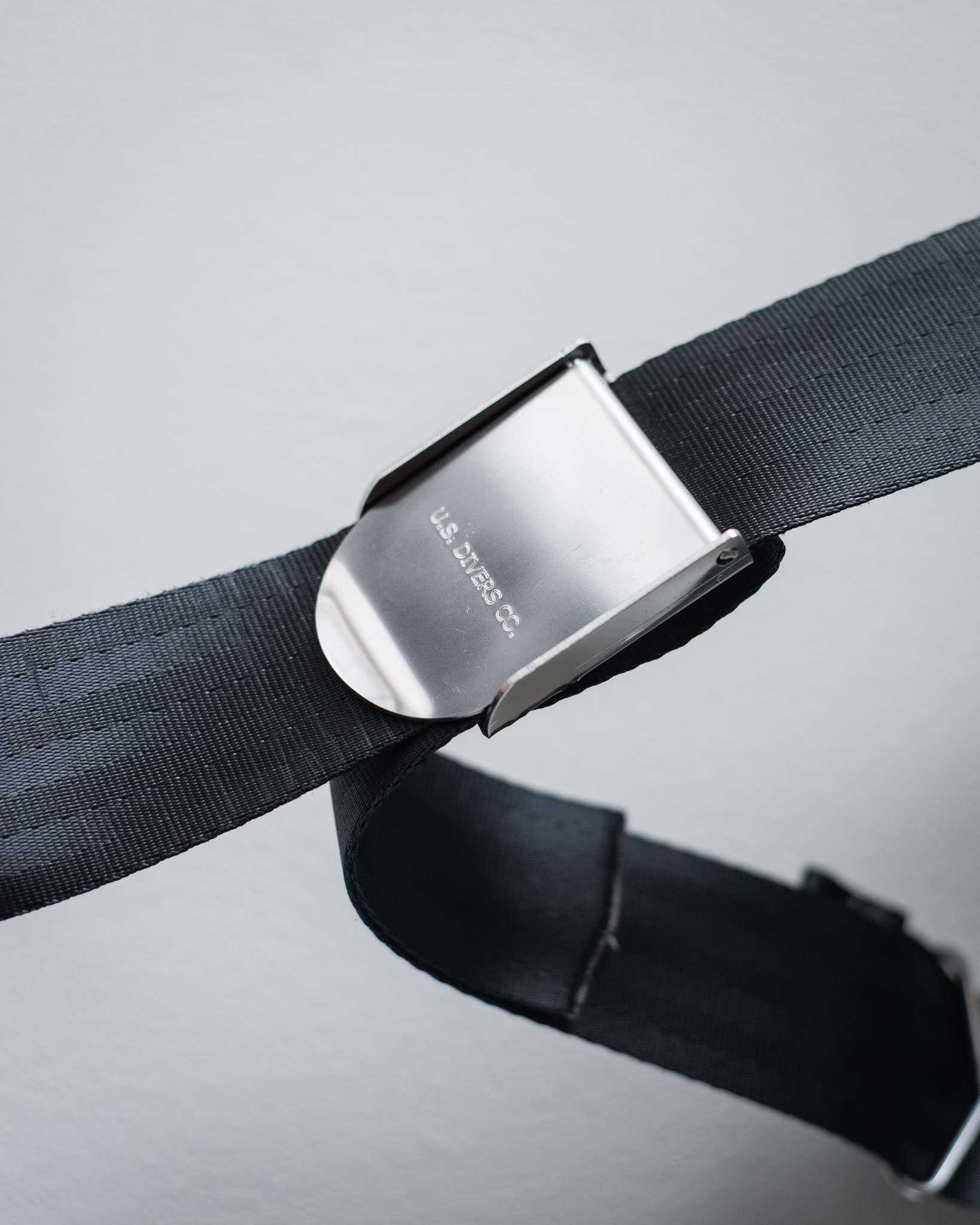

US Divers belt buckle replica (full metal fett)

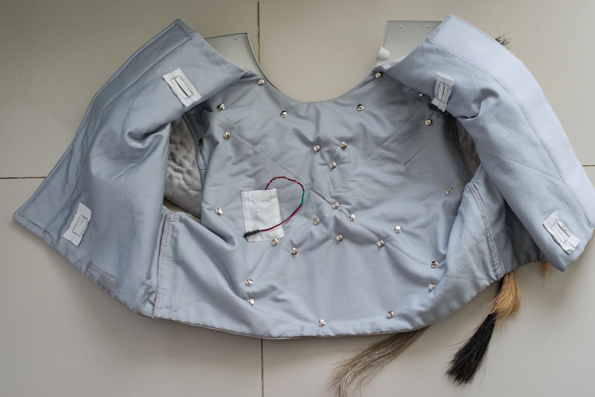

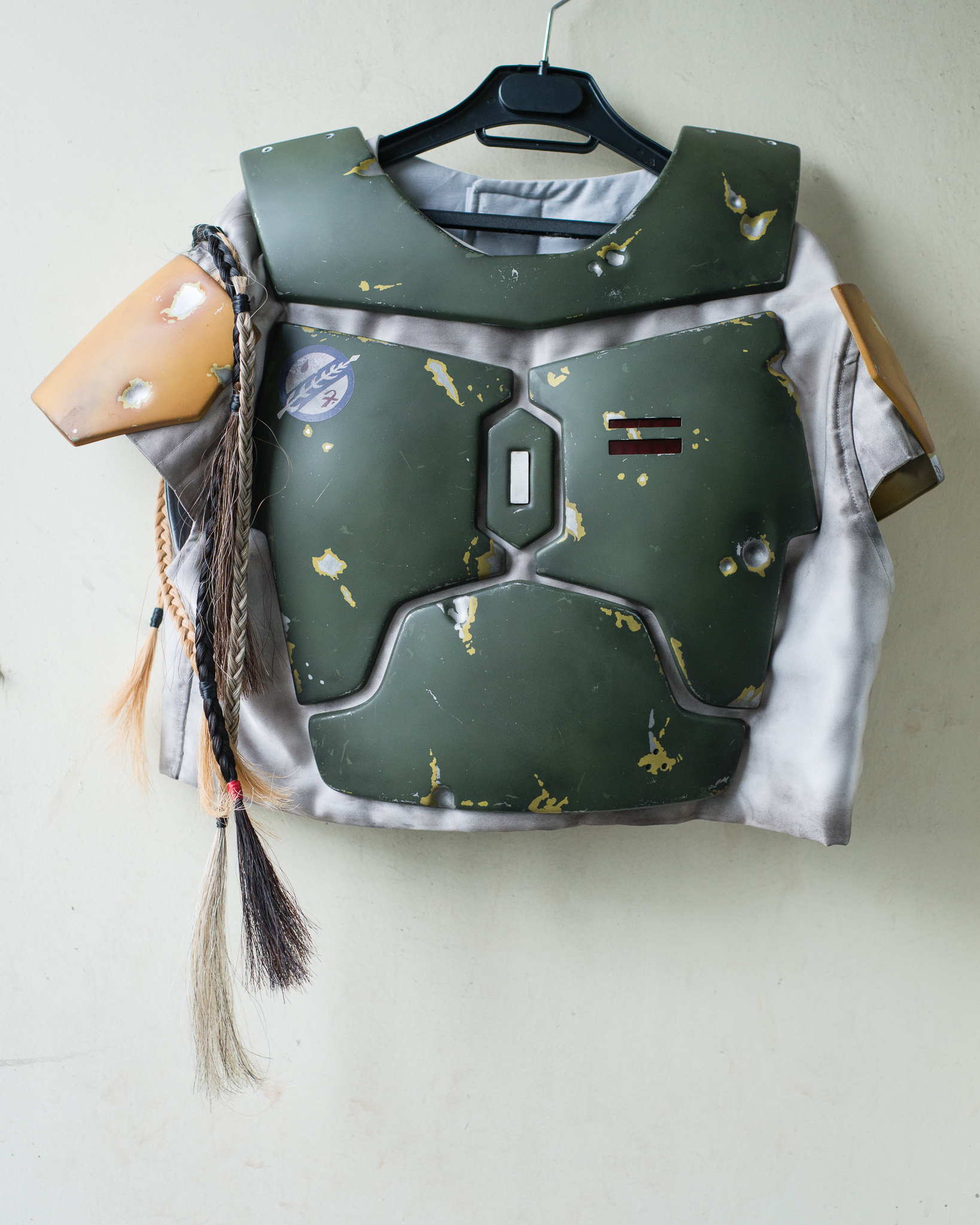

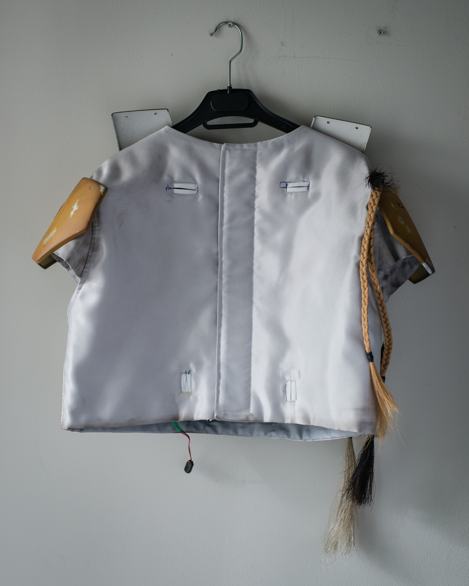

Got my vest back and spent all of last night attaching the armor plates and sewed on the wookiee braid. This was made more complicated by the fact that I had to eyeball the placement on my own, attach the armor and braid in their general positions, then make micro adjustments until I got them to where I think looks right. I get that this should really be judged with the vest worn on me, but I was too tired to figure out how to take selfies by the time I was done.
Vest by Arkady, braids by Woodman, chest display by TK409 and armor plates by Bobamaker
The tailor did a fantastic job with the slits for jetpack harness bar and straps.
Inside of the vest

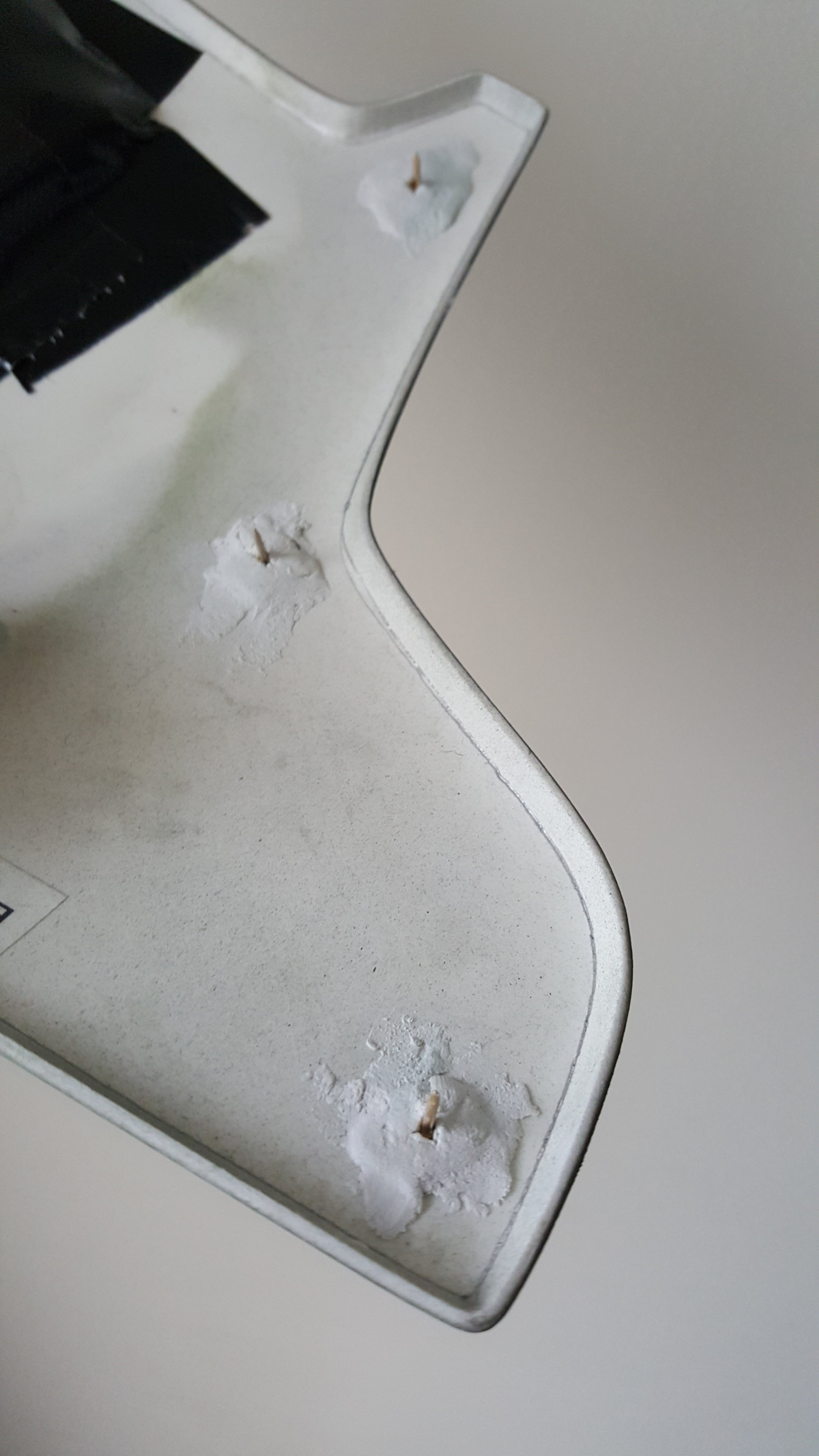

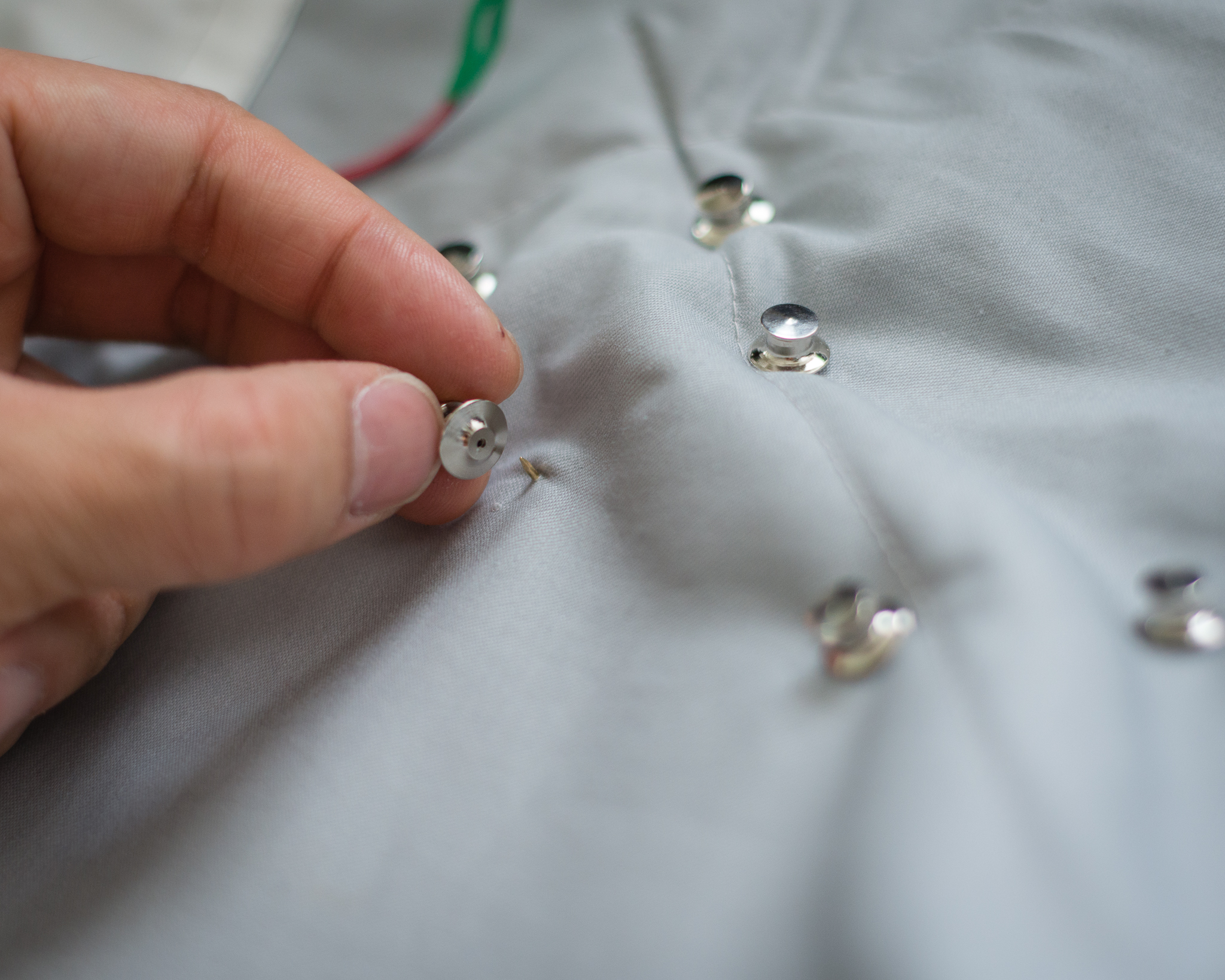

Flat top pins were glued and reinforced with epoxy putty on the armor plates.
I got the locking pin backs from here: 50 Locking Pin Backs for Disney pins Best Avail! A+ Since 2006 USA seller | eBay They lock on to the pins firmly and only release when you pull the back, which technically cannot be achieved accidentally since they are between your vest and flight suit. This method allows for removal and reinstallation if necessary, so I would recommend you mark out the pin positions on the vest.

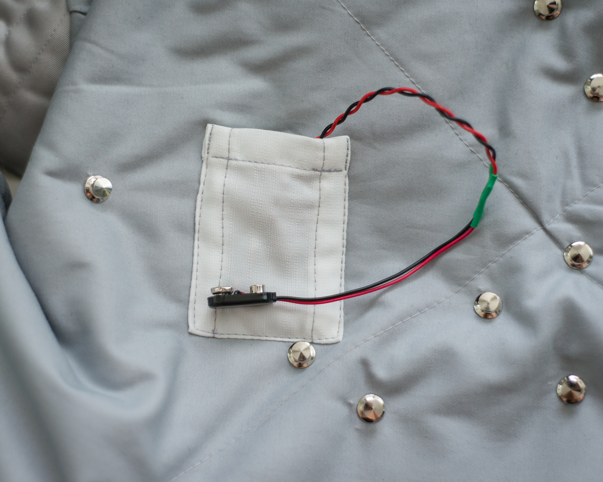

Pocket for a 9V battery to power up the chest lights.

Now to address the jetpack issue.
The order of assembly.
As you can see, it is tremendously difficult for the clips on the curve jetpack to fit onto the straight bar. Is this the same for you guys?
I never see what's going on back there, but whoever is putting on the jetpack seems to get through it alright. I think they connect the hooks first and then go for the bar.
It looks to me like you may need to move the bottom clips a little further apart from the screws if that's what they're hitting. Because the back armor just 'hangs' off your shoulder studs, the clips should lock onto the bar by pushing in the back armor a little when clipping on. You cannot do this yourself. It's definitely a two person job.
Thanks for your reply Aaron. I will be moving the clips apart a little, although in reality, they do clear the screws. My buddy who assisted me with the rigging said the ends of the bar would meet the jetpack and this obstructs the clips from even reaching the bar due to the curve of the jetpack. I'll push on and figure it out eventually...
To take this further, realize that you don't have the vest factored into this scenario (at lest I don't see it). It will change things.
You will need to bend the bar of the harness to coincide with the bend of the jetpack. The hooks attached to the jetpack with push the back plate inward, and all should fit at that point. The vest, harness, and jetpack clips/hooks are a two man job, from the placement and building of it, and of course, the suiting up portion as well...
Not sure I helped, but keep it up!

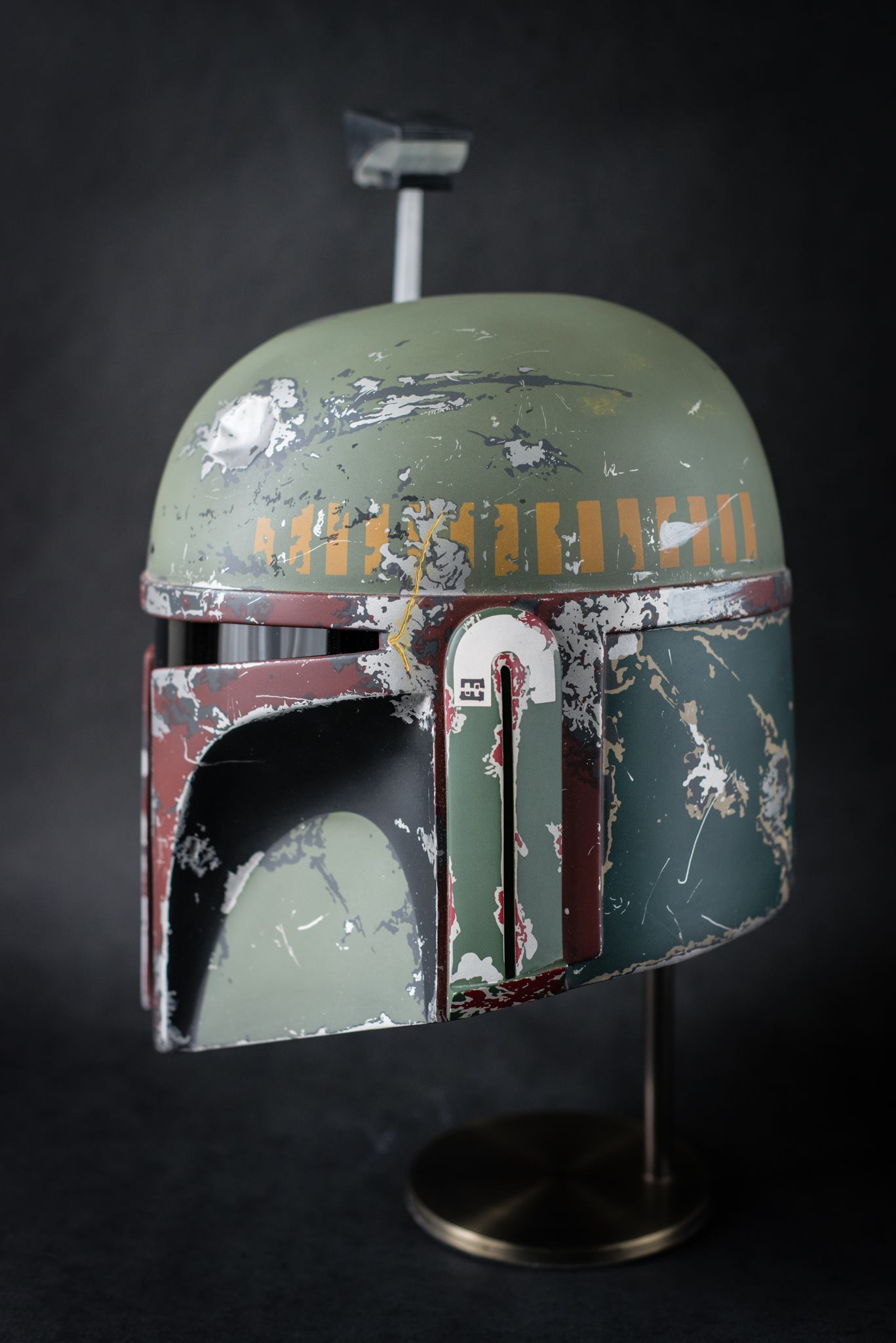

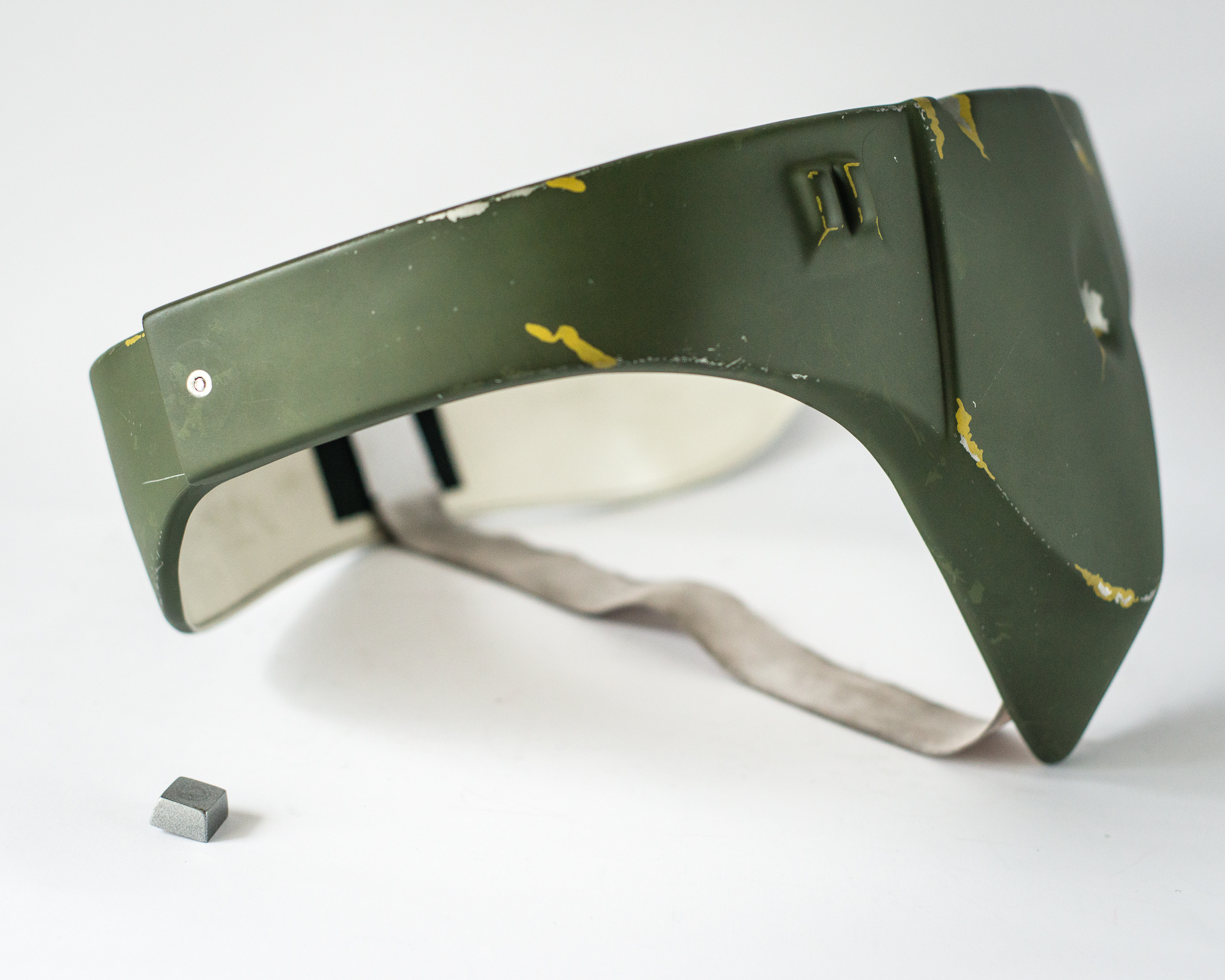

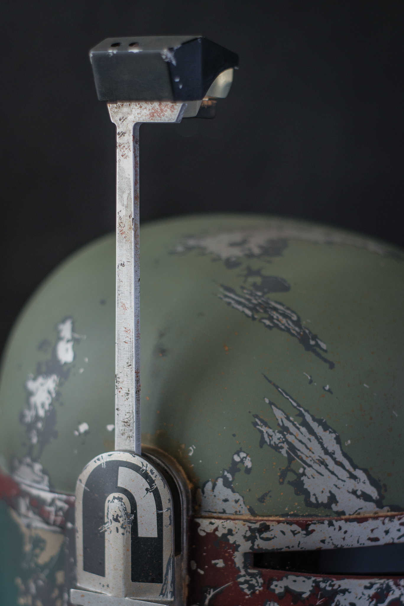

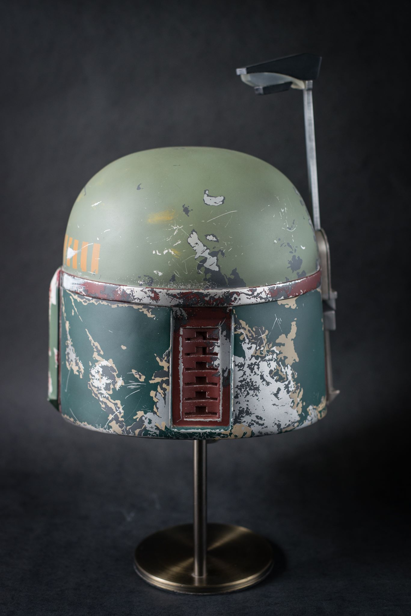

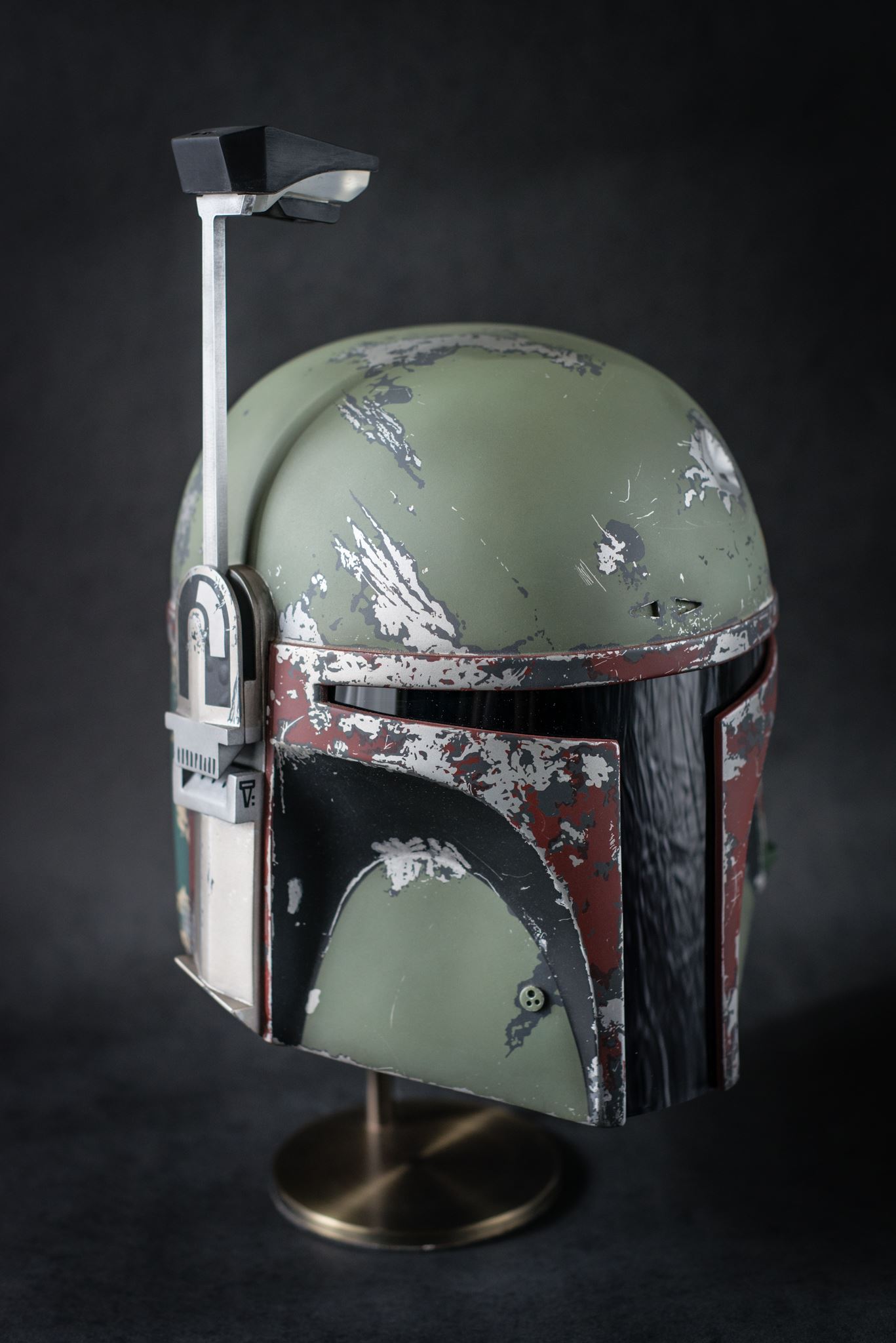

I love Daz's work. I really do. But I couldn't help but notice a few pristine parts that needed aging. So here goes;
Rust spots on the rangefinder stalk and splatter fall-off on the right ear and right side of the helmet.

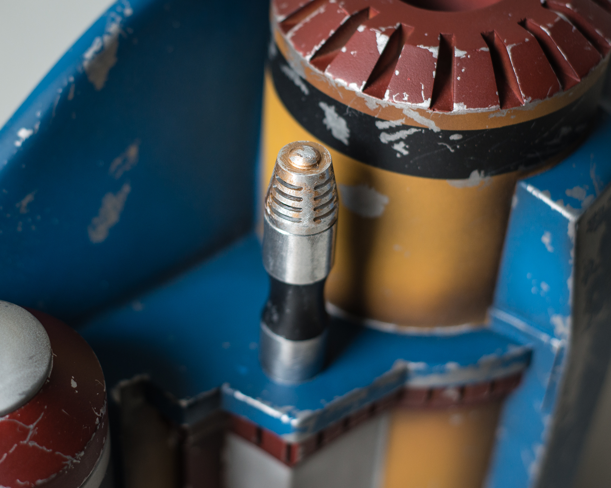

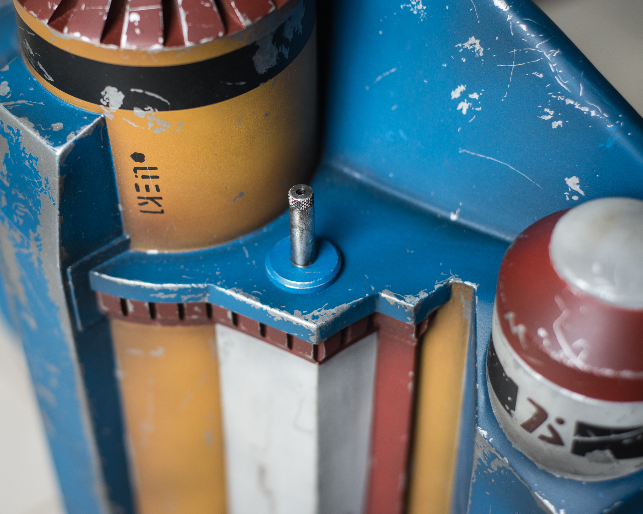

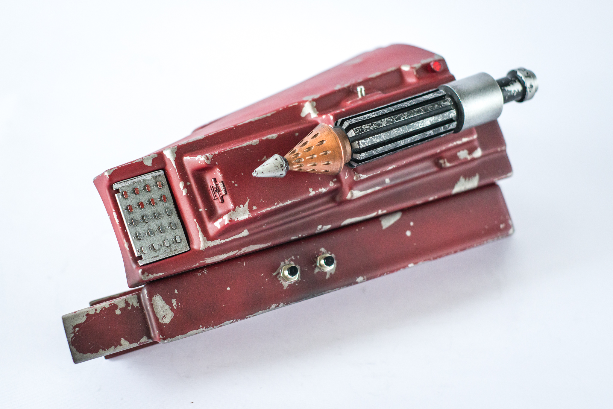

Major clarified the weathered brass tip of the jetpack beacon is acceptable against the silver base as per RafalFett's templates.
While I was working on the beacon, I might as well age the stabilizer and the bottom plug greeblies.
