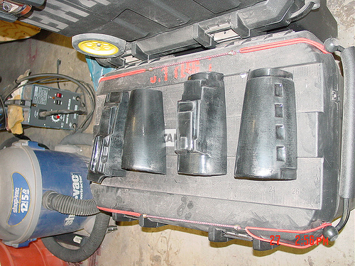

OK everyone, I've got some more progress pics for you all. I went to the plastic supply place today and picked up the new plastic that I am looking at and I have to tell you that this stuff is AWESOME!!!! I love the way it forms and it is baby smooth. I pulled the set below out of .090 and it worked like a dream! The only downside to this plastic is that it gives off some really nasty fumes so I'll need to make sure I start wearing my respirator.
At first I was expecting it to droop the same way as the ABS, and at first it did. Then I left the room and came back only to find that it had actually flattened back out! I was thinking, "What the...?" So naturally I turned up the heat and put it closer to the heating element...still no major droop. I touched it a few times to do a bounce test and it was definitely pretty bouncy. I let it droop some more and then decided to pull it. Needless to say, I'm very happy with the results. This plastic has little to no droop but the flexibility on it is fantastic!...what does that mean to a vacuumforming guy?? Well, the less the droop and more stretch means not only better pulls but also I can now do much deeper, larger pulls on a small table and my webbing woes are all but nil...anyway, enough of that boring stuff. On to the pics: Let me know your thoughts

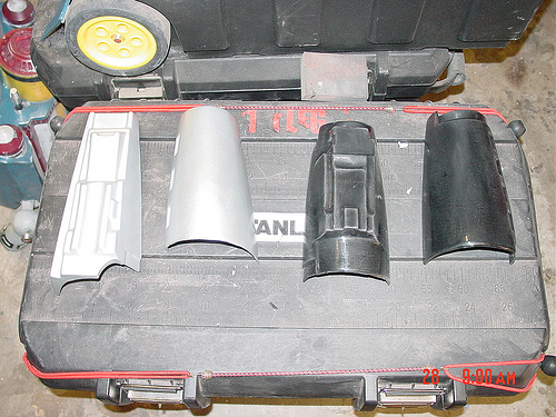

So the plastic trims up much like ABS, producing quite a bit of dust, that inevitably sticks to every **** thing it touches...
And after some tack cloth and primer...
DSC00110 by darth_who, on Flickr
The new material takes primer very well filling any small imperfections in the plastic to make a really nice, smooth surface to paint.

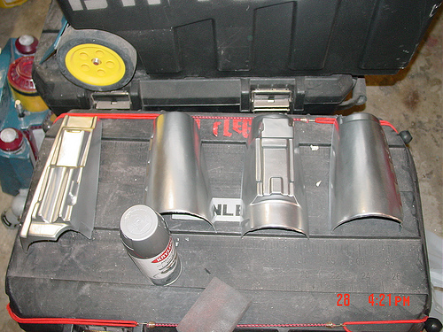

Now on to some Krylon aluminum matte and some duplicolor automotive high gloss
DSC00111 by darth_who, on Flickr
Nice and shiny :icon_wink:
After they were dry I took each piece and bent, flexed and twisted them (much more than would be expected of a normal troop), and no cracking, flaking or peeling of the paint or clear coat. Tomorrow I'll start the tedious task of masking (anyone that's worked a Fett knows of my pain) and then on to more paint on Monday (if it doesn't rain, again...). At this point in the testing I can say a few things; Will has done his homework. I've owned three set of gaunts since I started costuming as Boba from low end to high, and these are slowly becoming my favorite based on accuracy of the sculpt, ease of work and overall sturdiness and lack of weight of the product. I'm interested to see how the flamethrowers box and hose details are tackled but I assume they will be as good as the shells.
