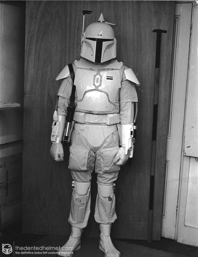

All the Pre-Pro #2 images were made for promotional purposes (especially for Kenner and the Star Wars - The Holiday Special TV Show) and the suit was put in a hurry, in regard of accuracy. The gauntlet hoses should go under the sleeve and then connected to the Jetpack. The SuperTrooper is an excellent reference in some (if not most) of the suit parts:

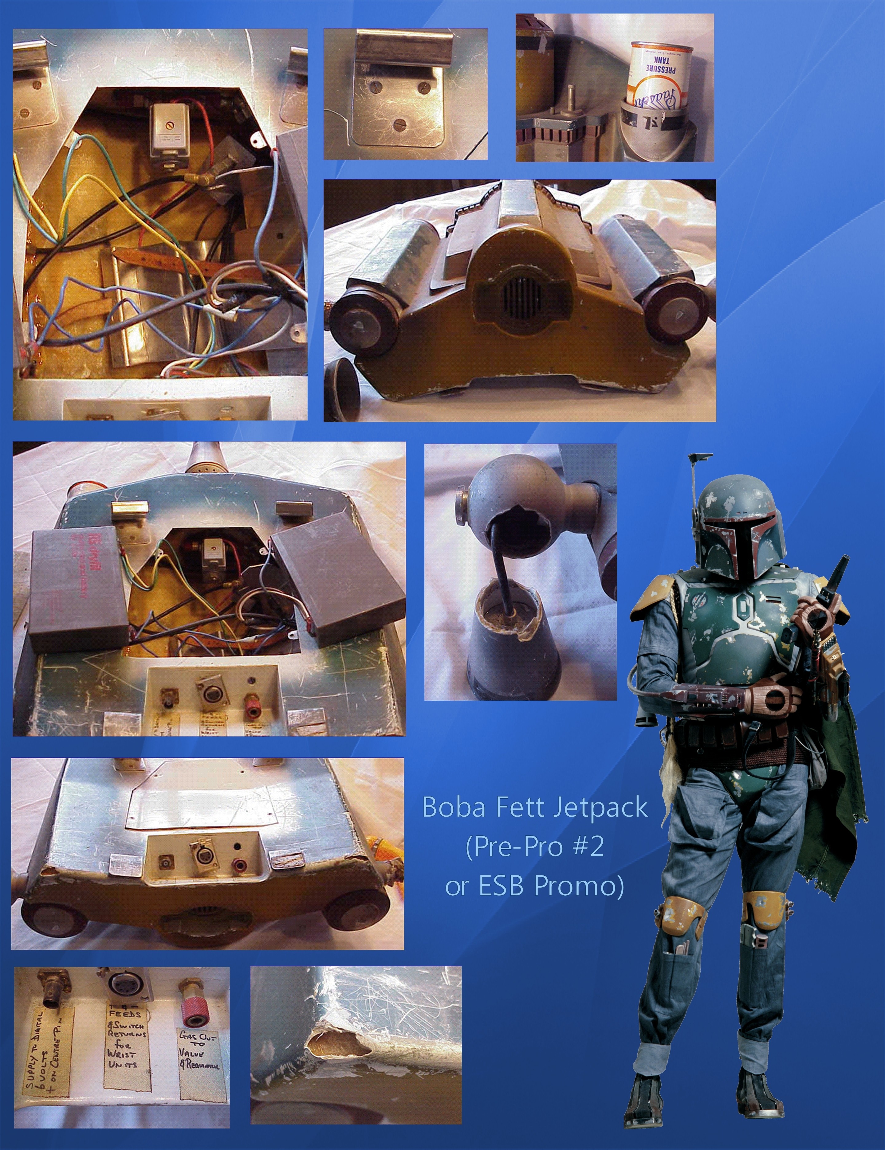

And here is an image (I modified the image composition a bit) with the stolen Pre-Pro #2 Jetpack which shows all the connectors from the inner bottom part:
The left lower image shows a close-up of the connectors: the left connector is for the chest display, the center connector is for the right gauntlet hose, while the other two (one is missing) are for the left gauntlet hoses.

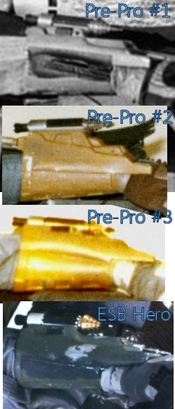

Other thing you should take in consideration is that the Sandy type left gauntlets (Pre-Pro #2, Promo #1 - with ROTJ helmet and Promo #2 - with Sandy helmet) were different in shape:
This is a quick mock-up. The Pre-Pro #3 suit used the Pre-Pro #1 gauntles and Jetpack, and the ESB Hero is the same, only noticable difference is the flamthrower and the color. You can clearly see that the Pre-Pro #2 gauntlet form is different, and it was modified mainly because of the different flamethrower unit. Altough the ROTJ Hero gauntlet is missing from this image, is also a slightly different in form from the Pre-Pro #1 and ESB Hero.
