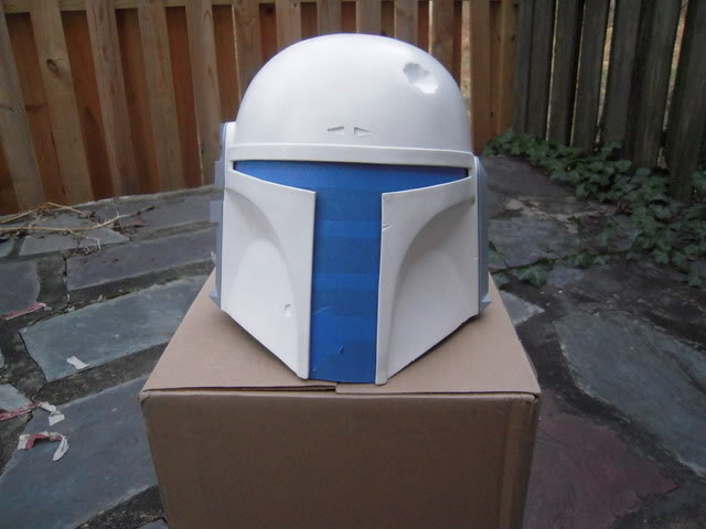

Here we have the kit, ready for visor trimming and paint prep:
Using my trust Dremel rotary tool, I neatly cut out the visor area and installed the visor using Chicago screws:

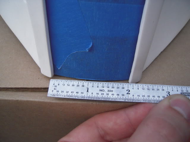

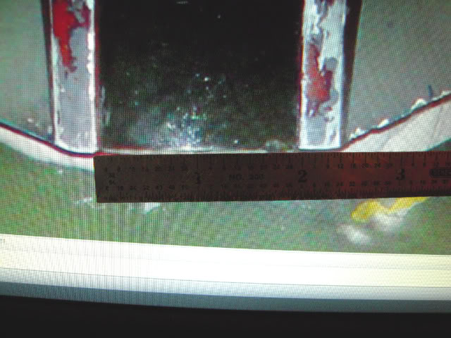

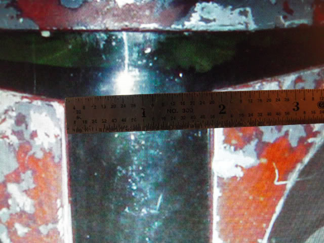

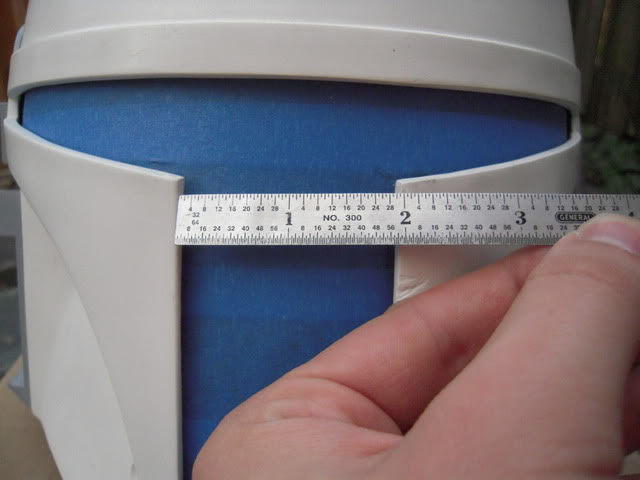

A big thing that I noticed was that the visor on the original ESB hero widens out towards the bottom, and I wanted to replicate that flare to the tee. I used a thin steel ruler that we at the Old Guard use to measure medals and insignia on our uniforms. I scaled the AOSW pictures to what my helmet measured out to be, and proceeded to get accurate measurements of the distance between mandible trims:
And with some patience (and possibly luck) I nailed the measurements exactly when the visor was installed:

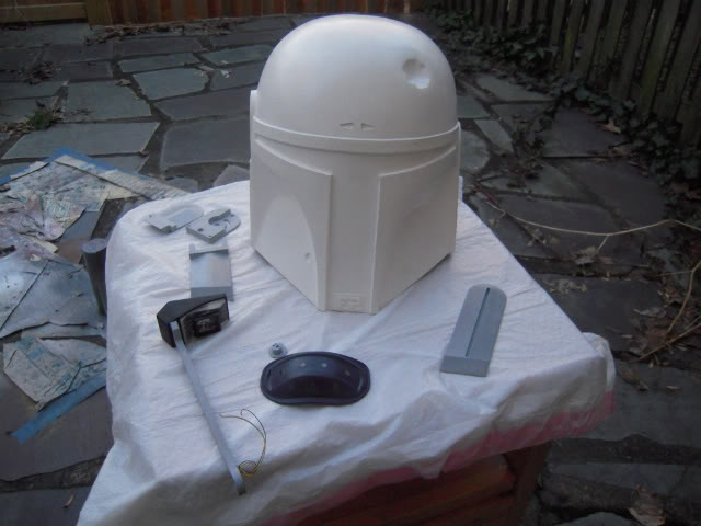

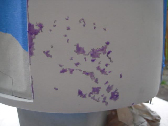

Up next came the physical damage that's seen on the AOSW helmet. And of course, being as anal as I am with details, I measured out exactly where the damage would be placed on the helmet:
I then drilled out the holes for the earcaps (sorry I don't have photos for that step) and coated my helmet using Tamiya Fine Surface Primer. I swear by this primer, as it's honestly the best out there for this type of hobby work. Not only does it coat evenly, but the fine particles fill in any minute scratches, giving it a smooth surface.

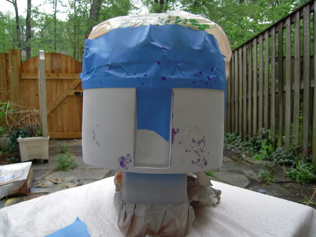

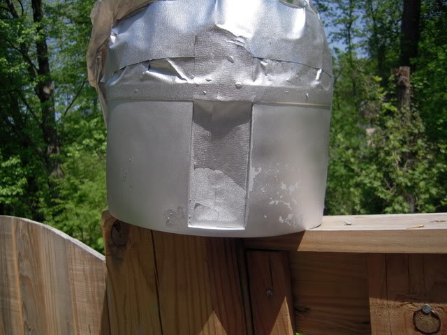

The Light Gray is then masked:
Humbrol no. 11 Silver is then sprayed over:

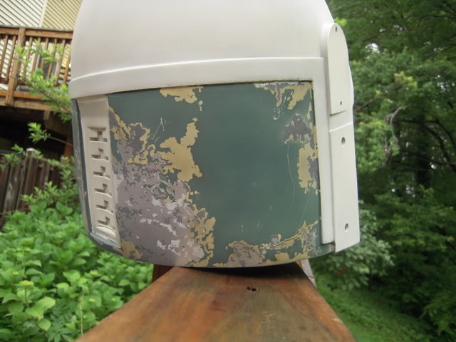

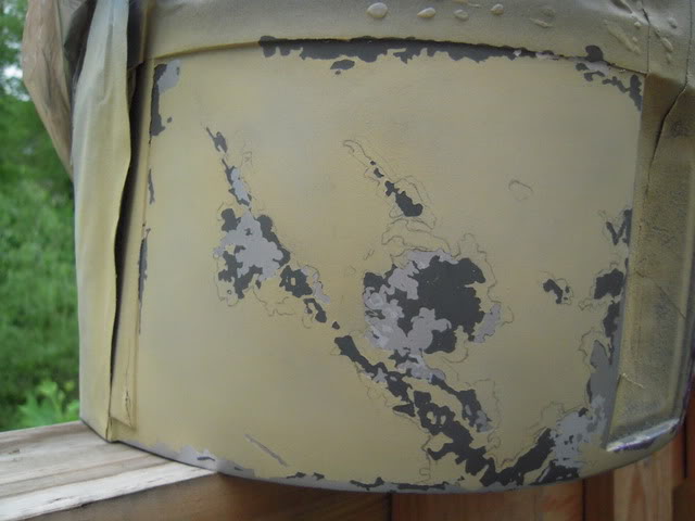

After masking the silver and light gray damage, I sprayed Humbrol 79 and honestly, it's WAY too dark in my opinion, and that's the color you see in the next photo:
It should be Reefer Gray, or at the time a combination of SP Lark Dark Gray lightened up with Light Gray that I mixed. Later on, I used a brush to paint the lightened gray mix over the Humbrol 79.
After the light gray, silver, and gray were masked I sprayed Humbrol 28 followed by a misting of Humbrol 103. I think in the future, I'll use Testors Concrete.
Once the light gray, silver, gray, and beige are masked, I sprayed Humbrol 76 and 96 mixed together at ABOUT a 1:3 ratio. I felt that the 1:1 ratio came out far too green, so I added the 96 blue a drops at a time until I got the desired color.

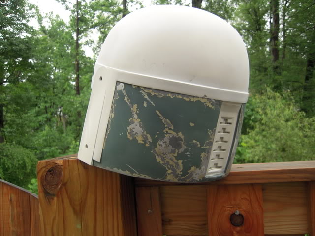

And here's the final result with some of the fine scratches added in:

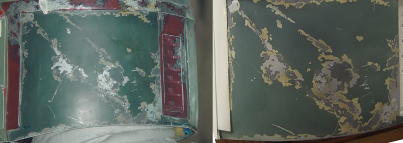

Here are a few comparison pics to the AOSW ESB helmet:
I was VERY happy with how the back panels turned out. I still need to implement a few scratches here and there (including the check-mark found of the left panel) and some pigment weathering.

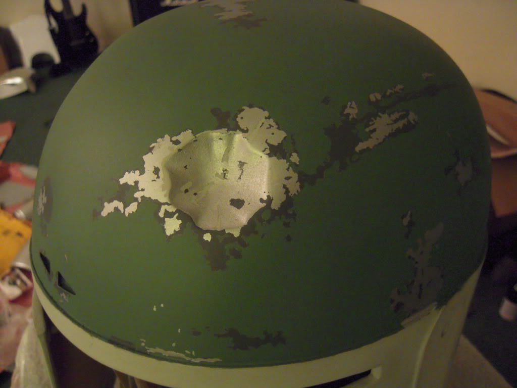

Finally got the dome and lower cheek main colors done, as well as the upper cheek/mandibles done! In order to get the gray color that surrounds the silver damage, I had to make my own special mixtures. Looking at numerous AOSW photos, the gray used on those areas compared to the visor trim is slightly different, so I used reefer gray as my base mixture and added in small quantities of SP Lark Dark Gray until I thought the colors were just right. Being some of the most defined areas of the helmet, I made sure to get every little detail correct. Here are a few side by side shots :D:
And for a few more photos of various areas:
For the main dome/lower cheek colors I used Humbrol no. 78, which is a dead ringer over the POG Green, wasn't a big fan of it. Big thanks to Terminal Fett. for nailing this color :thumbsup:. The upper cheeks were painted with PRR Green, which looks a lot better than straight up black. Highly recommended :thumbsup:
*NOTE*: For the areas of the cat scratch and dent, use Chrome Silver instead of Bright Silver (the rest of the helmet). For some reason those areas have a more metallic brilliance when looking at the AOSW photos. Unfortunately, you're going to later on have to dull down that brilliance with a 0000 wire wool pad, as you can clearly see a lot of the silver is worn/dulled on the screen used helmet. :(
