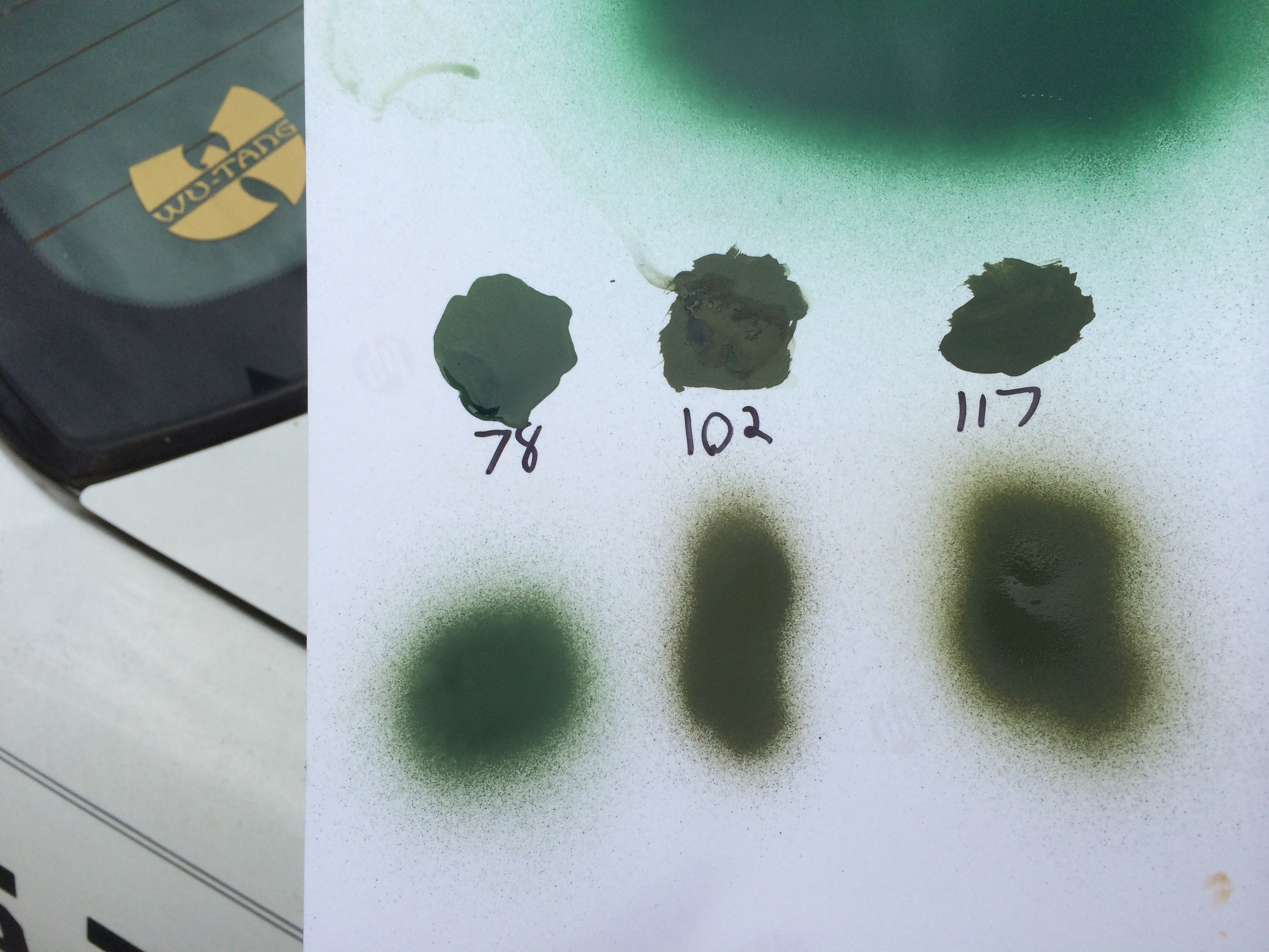

I am in the middle of painting my ESb Fett armor and there is one thing that just doesn't seem right to me. Green #78 is a pretty light green, but all the images show it being used as the darker green weathering shading. here are some green samples I did and Green 78 just seems way too light. the green at the top is a random rattle can I had. just my 2 cents. anyone had any luck with another humbrol green?
You can't really tell by looking at each color individually. The way the colors interact with each other is the key. The #78 looks light but as the other colors come into play it will begin to look right. You have to trust the process.
