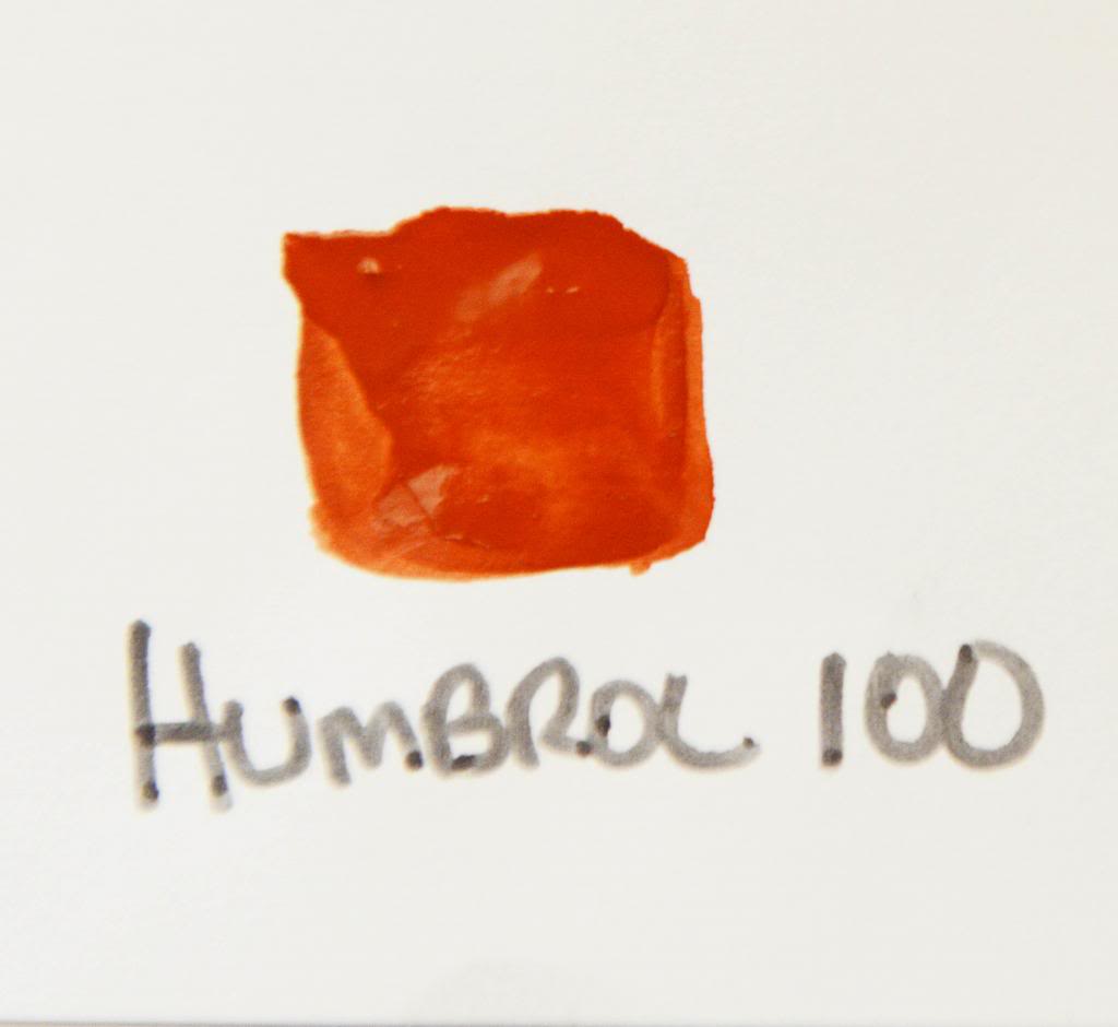

You can get most of the ROTJ Humbrols from my thread bud, the only issue is the back panel green. I virtually tried every combination of humbrol greens, and could never get the correct hue and vibrancy I was able to achieve with the Floquils. As for the mandible Red, I actually think Floquil Caboose is the colour that was used on the real helmet, and still the best option. But if it has to be Humbrol, the closest colour to the Caboose, is actually Humbrol 100 (Red/Brown). It may not appear so in the image paint chart or tin lid, but when sprayed, it is the closest to caboose you will get in the Humbrol range. Anyone who wants to go this way will still want to colour test it for themselves, but it was an option I thought about going with earlier in the piece, when I was having some trouble locating the caboose.. :)

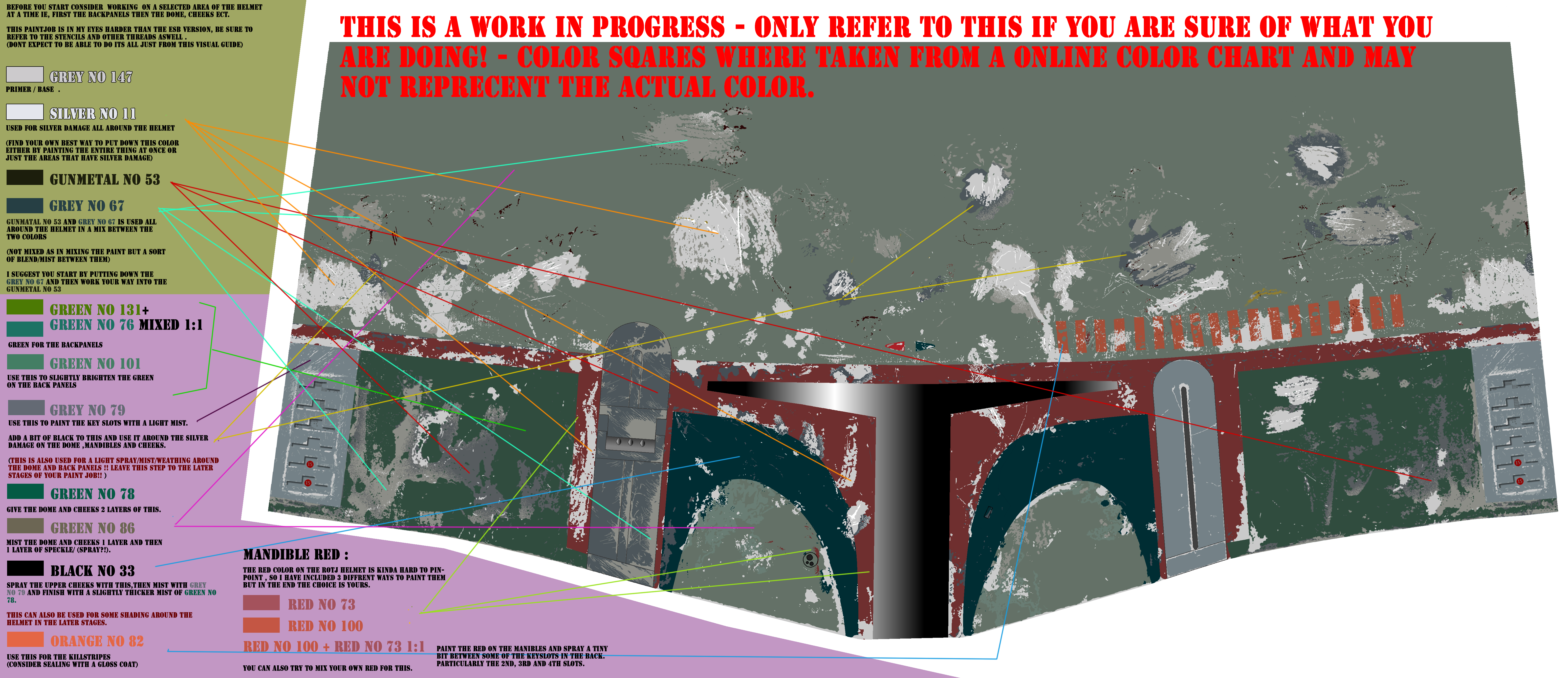

Okay so here is a WORK IN PROGRESS of the ROTJ version.
(Still need to figure out the ears and triangle colors + some of the scratches ect.)
This was compiled using colors from two lists :
Jayvee's ROTJ paintup www.thedentedhelmet.com/f23/update-2013-wip-jayvees-lil-chunk-rotj-love-paint-up-45306/
and
Terminal Fettlers List here http://www.thedentedhelmet.com/f23/rotj-paint-colours-uk-34267/#post460709
As always i have used RafalFett's stencils http://www.thedentedhelmet.com/f23/boba-fett-rotj-helmet-stencils-42184/
Personally i find the ROTJ paint scheme is a lot more challenging than ESB and i would really like if people would leave some feedback on this,
maybe you will notice something i didn't
http://www.jigglenomicon.com/img/ROTJ-PBN.png
Nice work man.
I too am very curious about the mandibles as I believe them to be the same colour as the ROTJ gauntlets. I've been looking for alternatives for Floquils because EvilBay wants a boatload for shipping to Canada.
We may want to look into humbrol 133: brown satin as well as a mix?
I will test Jayvee's red 100 out of the tin and see what happens when it dries.
Word of caution death proof - never go by a colour chart sample - they often vary considerably to the colour in person, and particularly once it is sprayed through an airbrush..:thumbsup:
Overall, a nice Humbrol collection. I would Highly recommend going with my Humbrol mix for the Dome and lower cheeks though, and if you don't want to mix anything, then even Humbrol 31 alone is a better representation of the ROTJ than 78. 78 is great for ESB though..
I would also still be careful using black and mists for the upper cheeks. Garrett is extremely talented and colour knowledgeable, so can make it work. But I think this may be tricky for everyone to pull off, and have the cheeks look the way they should. Again, even though its not Humbrol, I still like the tamiya sea blue mix, and found no real great alternative in the Humbrol line alone - and trust me when I say I colour tested extensively for those suckers! :)
