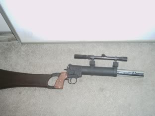

Ok, here it is. A few things that I know need reworking, the scope mounts: made my own, they're WAY too large. Where can i get some MATE-N-LOKs? anyone got an exact catalog link? The other problem is the length of the PVC barrel, I'll need to chop a few inches off of that.
The handle/stock connection is secure, but it doesnt look too great. has anyone come up with a good, cheap way to replicate this?
as always, spare no criticism.
Big, Honkin, Webley! Man, that is big. I know a guy that plans to make an aluminum brace for use between the pistol grip and stock. What was your pistol base gun?
That blaster is great as-is after you shrink the scope mount. What is the chrome tube? Is it one of those chrome-plated plumber's P-trap extenders? How did you cut it and add holes???

Thanks man.
The chrome tube is actually a flash-gun tube, the same model that was used on the film-prop. I got lucky on this one, I've got a buddy that owns a used camera store.
The pistol base was a marksman airguns .357 replica which I found to work out nicely. If your friend is making a brace, I am sure I can find a way to attatch one of his to the pistol grip on mine. With a dremel and some epoxy, the possibilities are endless!
shoot me a PM regarding your friend making the brace. ;)

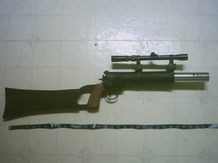

Can someone provide me with some measurments off their Webley or kit? I need the actual barrel length (starting with the trigger guard). And seperately: the length of chrome barrel projection.
any info helps, thanks.
maybe this will help, save the pic and blow it up to see the measuring tape, if not then remember each square on the floor is 4 1/2 inches
