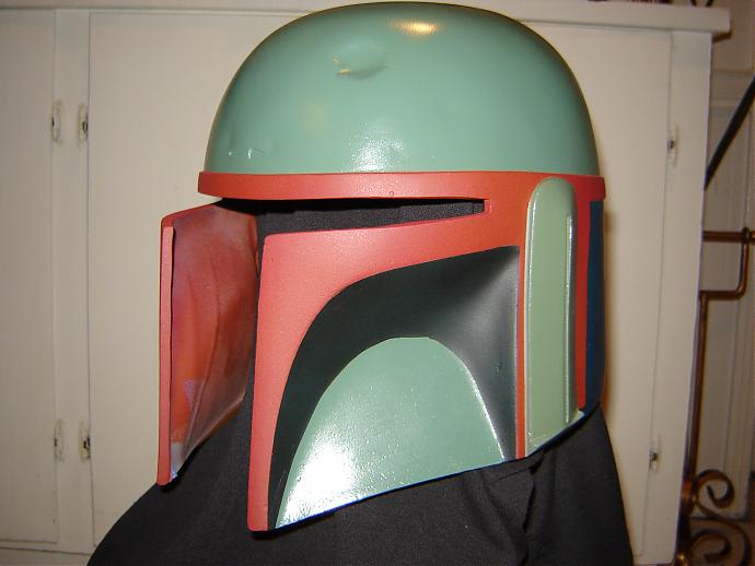

ok pics...try one and see if I need to resize it
egads that's brilliant! hot water + gravity = round dome! few more pics
and yes I have the earcap and RF...which is horrible casting by the way...pics soon

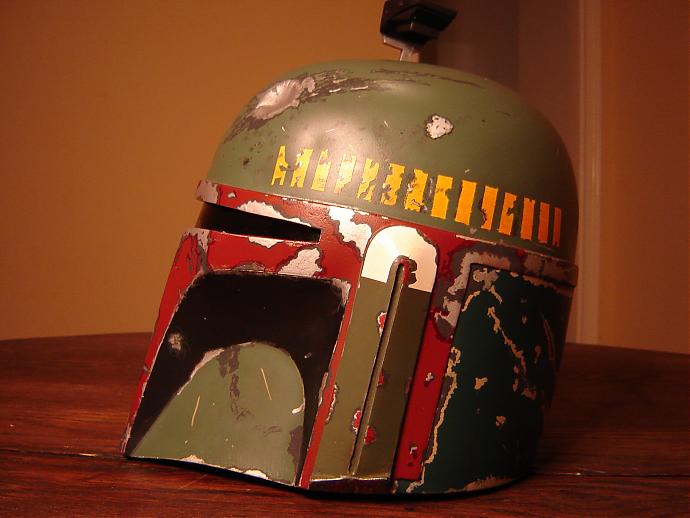

You can see in the last picture why I brought the hoop all the way around to control the mandibles.

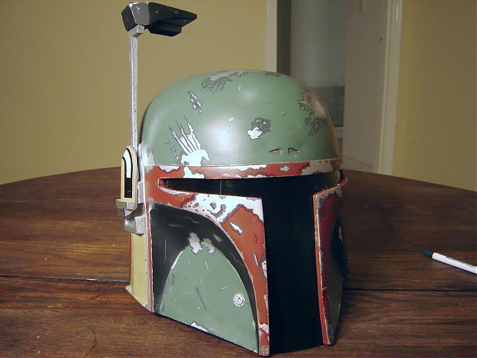

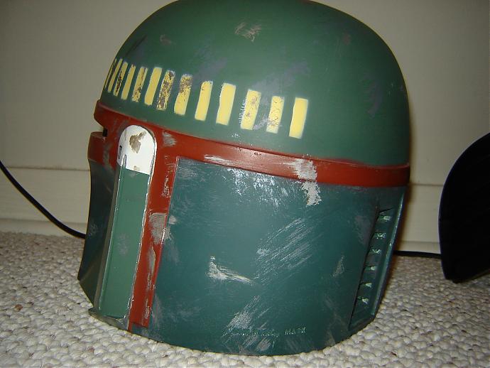

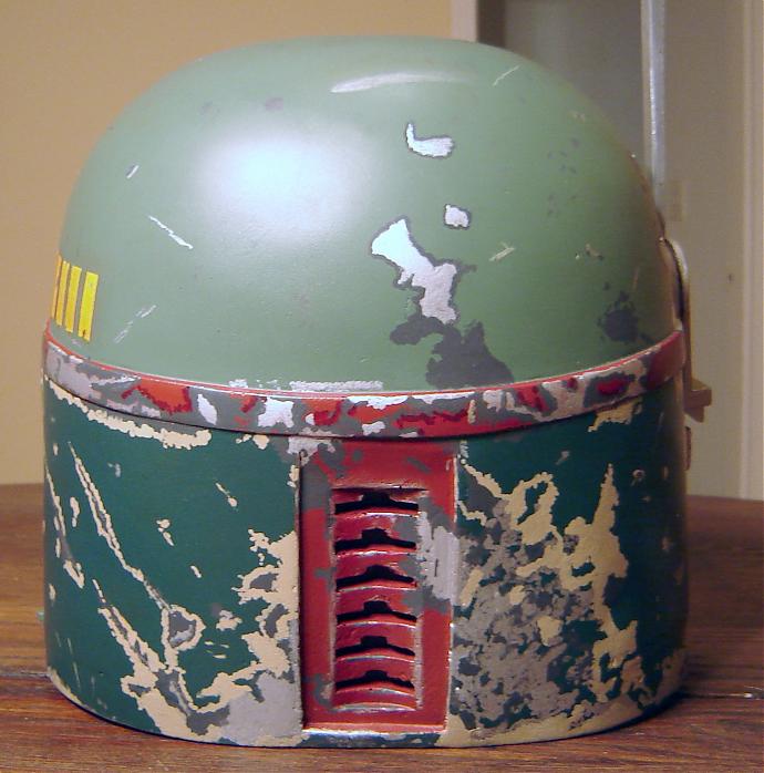

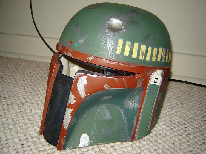

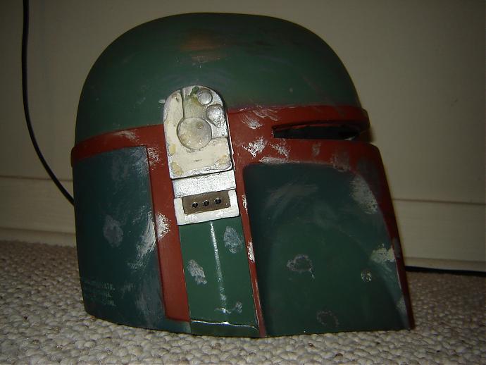

OK almost a month later and I'm finally done ('cept for the markings on the ears)...been spending what little free time I've had working on the bucket instead of taking pictures to put on the internet lol...and I went from base colors to finished product with no pics in between. I'm happy with the way it turned out and I learned a LOT in the process...this one is all freehand but with the help of the stencils on here and the experience gained I am ready to take on the Bobamaker bucket I should have by Christmas! I tried pics with and without the flash and neither really accurately shows the colors...they really "pop" in the pics but are less vivid in person. Also I remember reading a post about camera focal length distorting the shape and I think that is the case here as the bucket looks taller and narrower than it does in person. Many thanks to all who helped especially Bubba Fett (great looking DP 95 I might add!)
