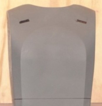

My 20 lb. back armor!
CGClone, yeah I know what you mean.
Foxbatkllr, that's also a good idea.
The curvature on the side flaps will be placed based on the accurate sizing as well. So the side flaps will be a little longer for anyone that does not trim the back.

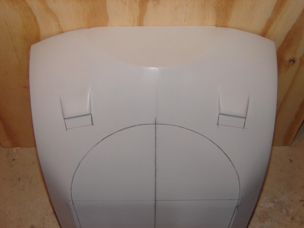

Today after work I'll shave down the insides of the collar area a tad to flatten out some of that height, taper the sides a tad where the side flap is, and adjust the bottom part of the lines for the inner circle so that is matches the blue lines on the overlay pic a little more, and bring up the jp strap areas a bit.
I'll post update pics later tonight.(y)

Hey Cruzer, one other question I have for you, what's the distance currently between the bottom of portion of the neck curve and the line the black line you have drawn?
THX
:cheers
Sorry guys I didn't post much in specifics, I just wanted to post the pic real quick before getting off to work.:)
Here's some of the dimensions:
  • neck hole: same diameter as BKBT collar (complete coincidence & not planned...seriously...so worked out perfect!)
  • shoulder width: 14.5"
  • from the top of the outside of the shoulder to the black cut line: 14.5"
  • taper from front to back 85 degrees
GBH, so I would approximate that the distance you asked for is about 14.5", but I can measure it later today.
hope that helps,(y)

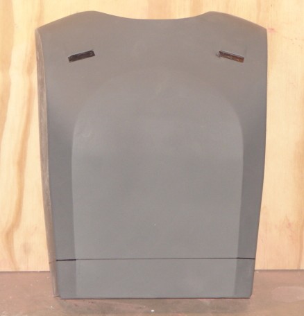

Looks like I need to decrease the dimensions of the center plateau area a bit, move over and higher the jp strap overhangs, and I still don't like how that right side looks.
I also noticed how the back of the neck line is low compared to the ref. pic. The shoulder area will need to be trimmed back and the backplate is sitting a tad wrong for the pic, but I'll check that too.
Anything else, let me know.

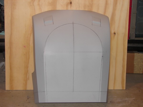

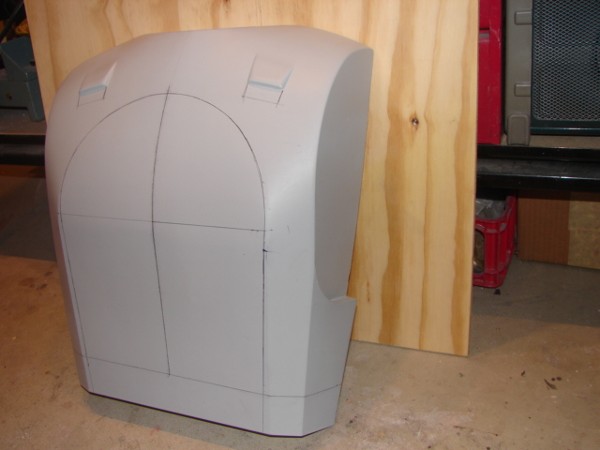

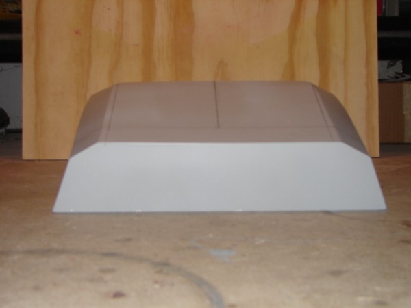

Hey guys, here's the latest. After giving it a coat of professional auto primer (non-rattle can type), I see there are still a few more adjustments I'd like to make.(y)
later,
Cruzer
Thanks bro.
Speaking of sucking, I made the left side flap 1/4" shorter than the right side:confused, so I gotta fix that too now:lol:...must'a been all those bondo fumes (right asok?).:)
I'm also waiting for my MLC V2 classic to arrive. Once it does, I'll check the fitting between the two to make sure the jp rests good against the shape of the backplate, before I make the mold. Right now, I'm anticipating towards the end of the month to make just a very few copies available.(y)
