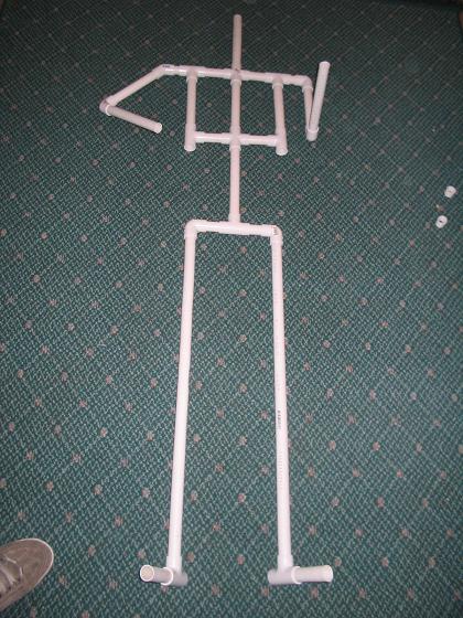

1.5 inch PVC pipe skeleton covered in foam padding/old pillows/crumbled newspapers/whatever and then wrapped in duct tape. Since PVC pipe connectors come in different angles, you can have your mannequin pose as you want. Also, It's good to be able to remove the arms on your mannequin when dressing it.

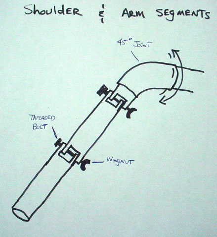

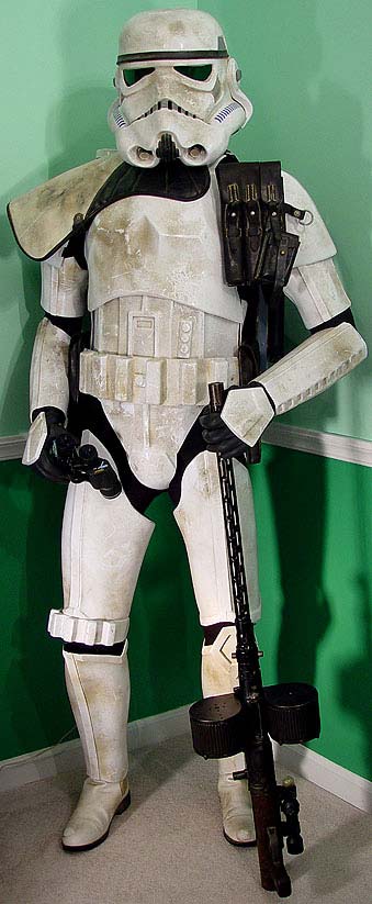

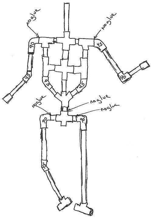

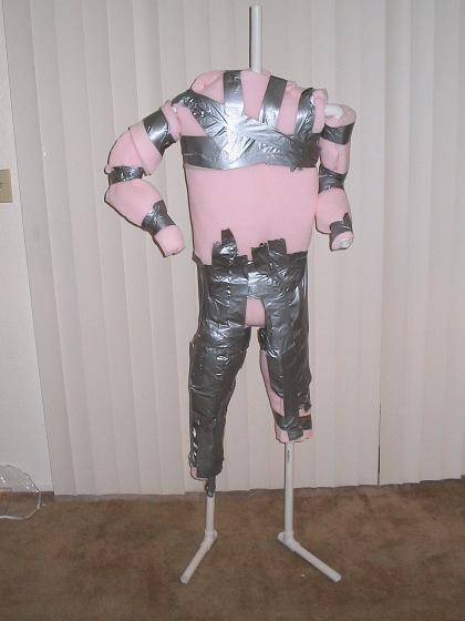

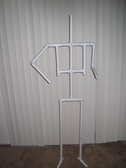

I went the PVC route too. here is the skeleton plan, and after that is what my sandtrooper looks like on the final, filled out mannequinn.
very informative. This certainly looks like the plan. I'll hit up Home Depot on the way home tonight, and post my results in the next few weeks (still working on the armor).
is that gun your holding even a star wars weapon?!?!?
Kissker
its an assault rifle, it wasnt seen a whole lot.. though its been years since ive watched the movies,, could be wrong on the "not used much" part.. but i know its star wars.
Star Wars Chick
Sr Hunter
That is a REAL MG15 and with all the REAL scopes that were on the MG15 used in the movie. Yes, it is a Star Wars weapon and a beautiful, very heavy, and VERY expensive one at that :D
hansoloway
Ok Braks, If that's a real MG15, you don't take it out to the back 40 and go full auto on old TV sets and washing machines do you?
