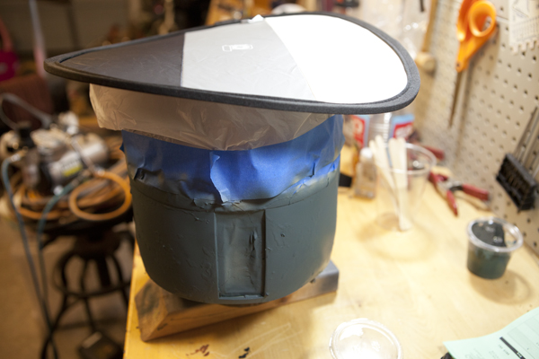

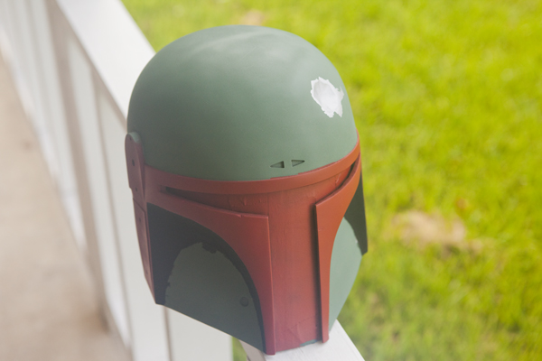

Took an outdoor pic while I was masking today. I used a grey card and corrected color in RAW on these pics and I feel like they're pretty accurate to what I see with the naked eye. The concrete is Model Master Concrete.
Got the green sprayed on... It was a custom mix. I bought some Tamiya acrylics that online, looked like a good match for the back panel green. However, on arrival neither were suitable. SO, I mixed them about 1:1, added some bright blue, and some black and I'm pretty happy with the way it turned out.

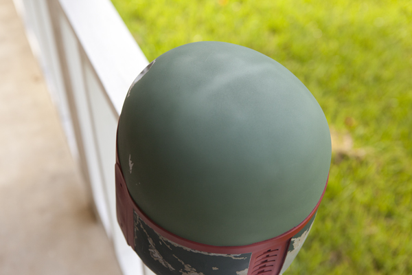

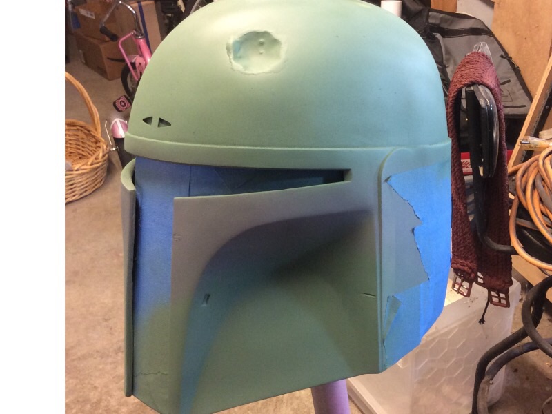

Got some green on the dome. I haven't finished the back panels yet, but I just couldn't stand it. I had to get some green on there!
Once again, the colors look a little off to me, so I may take it outside tomorrow and shoot it in the sunlight and do some white balancing on it.

I completely understand the anticipation, but you gotta make sure you pace yourself, don't rush it, and force yourself to step back once in awhile. It helps to keep you from having to redo things 2 and 3 times.

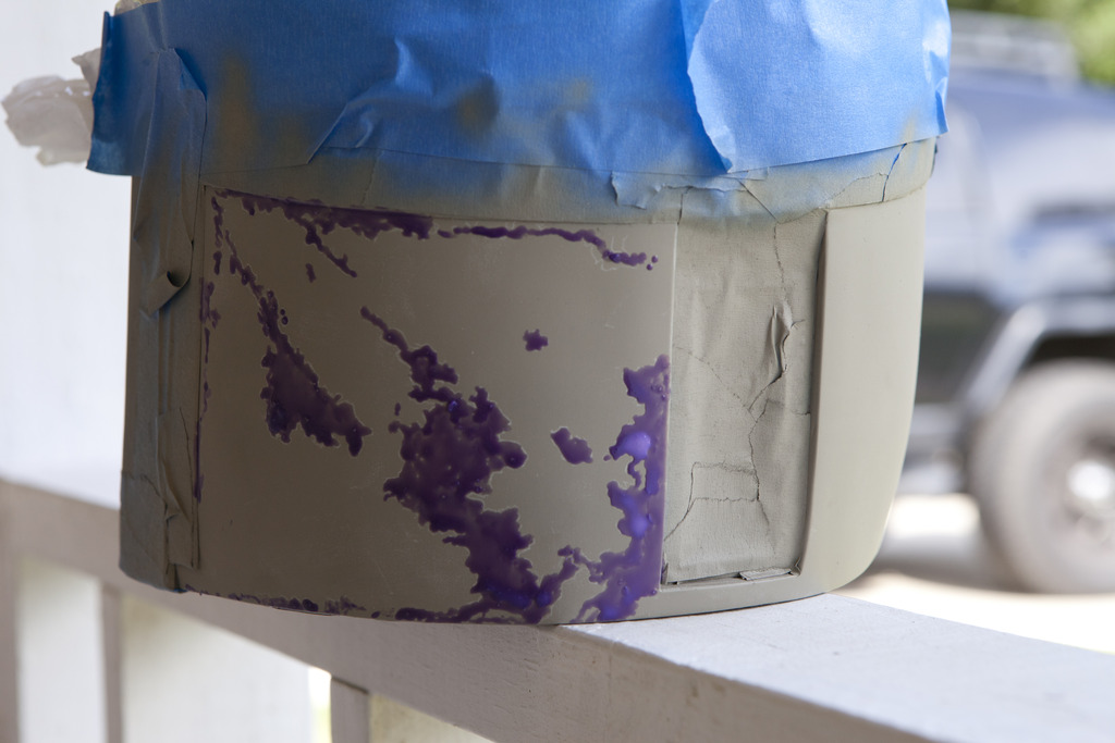

Looking good so far! Is there some masking fluid in the dent?
There is, I was trying a color I had in stock and I wanted to compare it to the green, so I sprayed testors aluminum down first, masked it and then did my green. My thought was that if I didn't like I can go in with my Humbrol 11 and redo it topically. Which may happen, I need to take it outside and evaluate it.

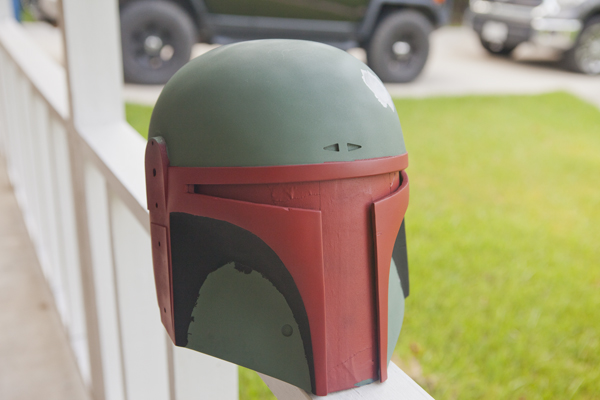

Looking great so far! Did you end up using the POG for the main green?
I did, but I lightened it a little per ToEleven's suggestion. I thought it looked pretty good. My goal for this helmet is to have fun and learn some painting techniques. I'm going for accuracy as best I can, but I'm not going to obsess over it. That being said, so far I'm pretty happy with my progress. I painted my upper cheeks black with a brush like SuperJedi, however, I thought my brush strokes looked a little too "prominent" and pretty amateurish, so I sanded lightly and airbrushed it on. BUT my brushed black was a little heavy on the brush and I had some seepage under my masking on my lower cheek. So, more masking and more POG on the lower cheeks. I wouldn't have had this problem if I had sprayed the uppers from the start! Probably more info than you needed! LOL
Looking good! I've been hitting the lower cheek along with the dome and then mask the lower cheek line with that thin tamiya tape with thicker over it and do a few light passes of black to keep the bleed down. I don't know how superjedi does it with a brush...must be tapping into the dark side of the force.

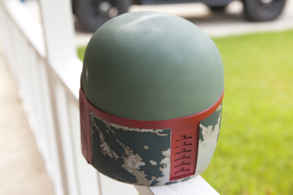

Those back panels look pretty nice!
Where are you located again? I know the humidity does weird things to paint!

thanks buddy! I'm a little north of Houston, East Texas is renowned for it's wonderful, sauna-like climate!
