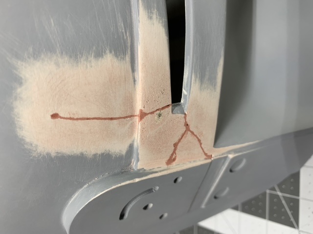

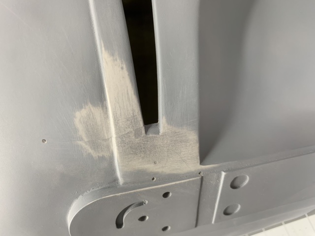

I received this Boba Maker v4 Helmet from Irongladiator earlier this year. In fact he generously gave, yes gave me this helmet.

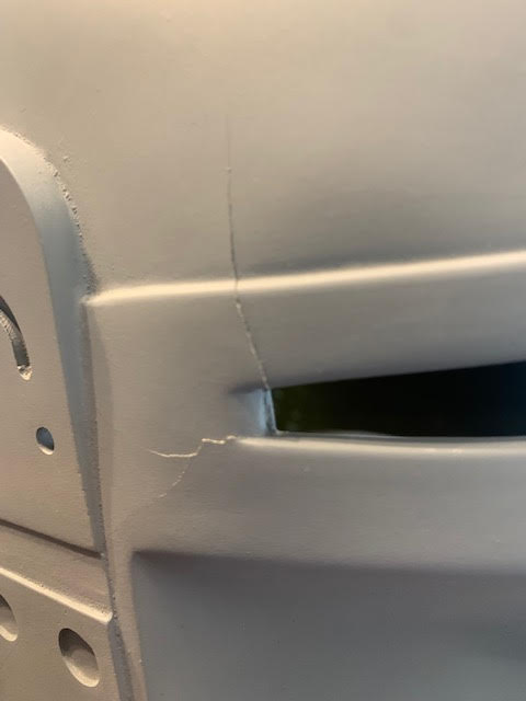

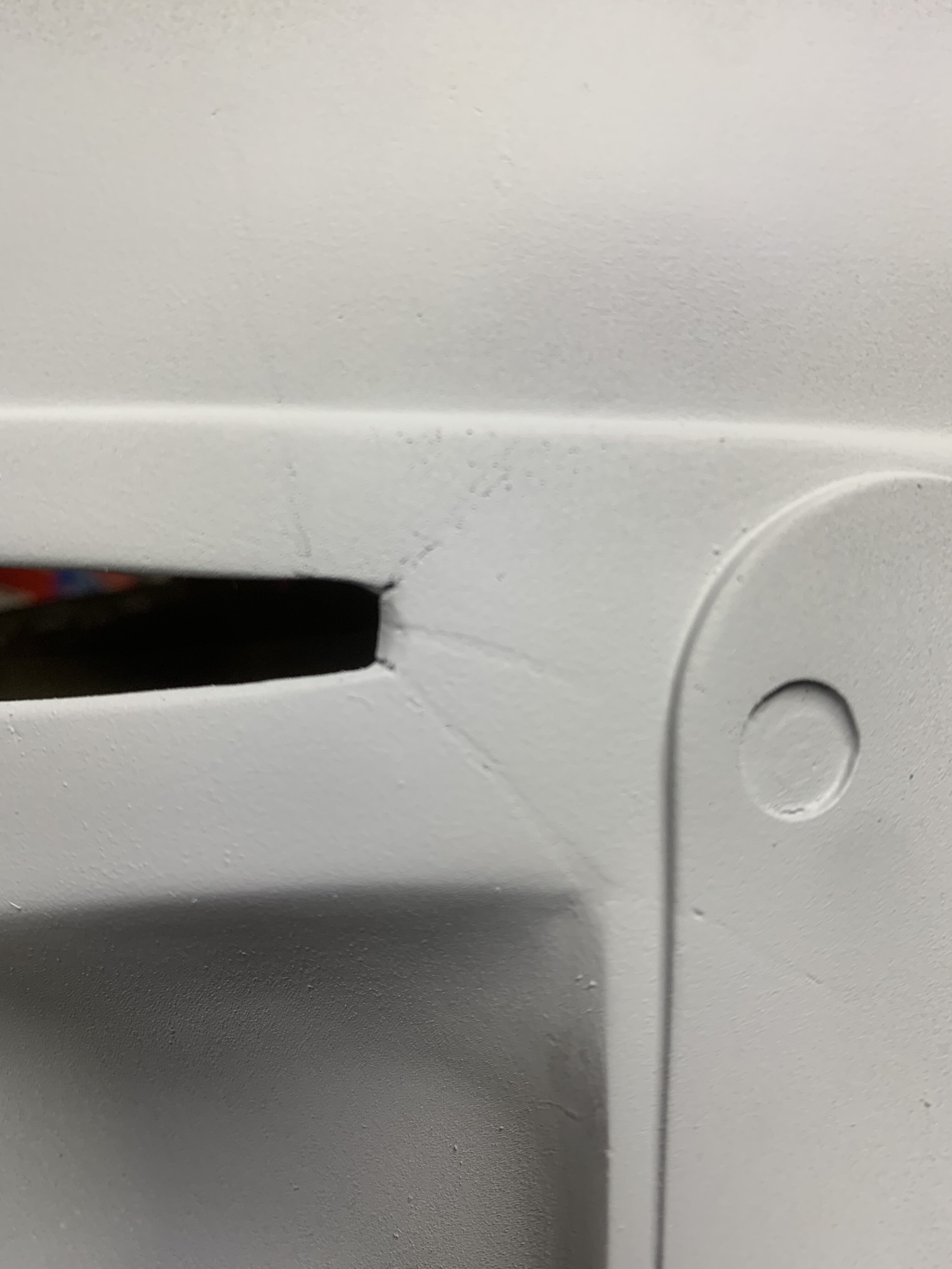

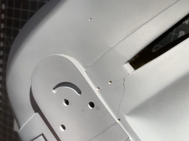

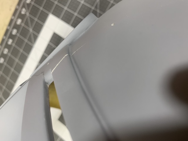

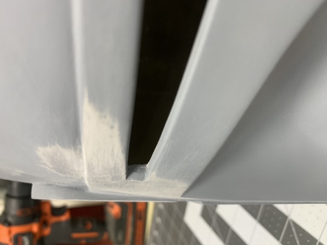

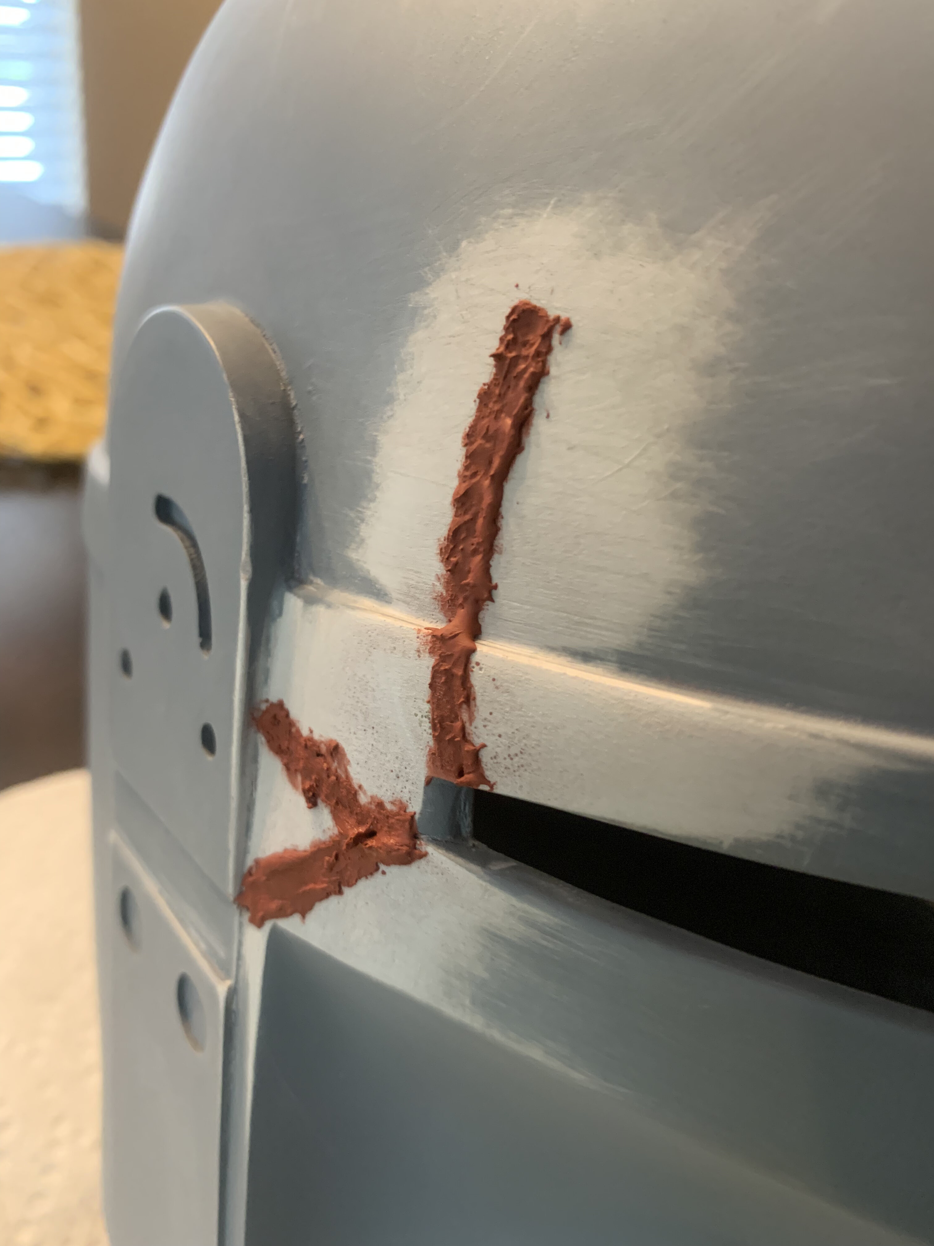

It apparently had a rough trip from Daz in Portugal and has some cracking around the temple areas.

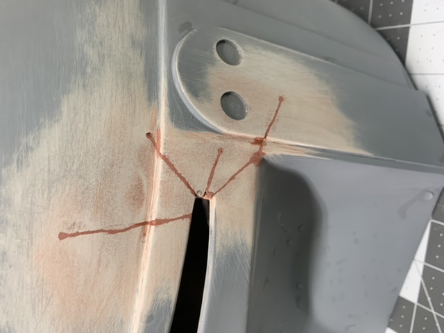

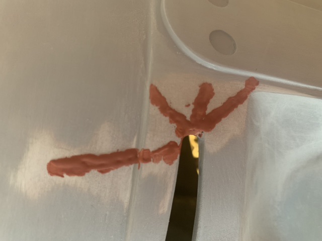

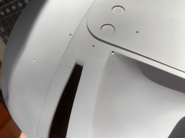

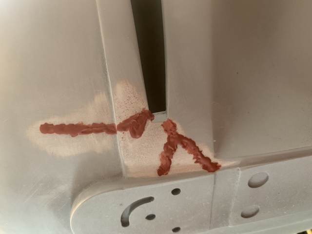

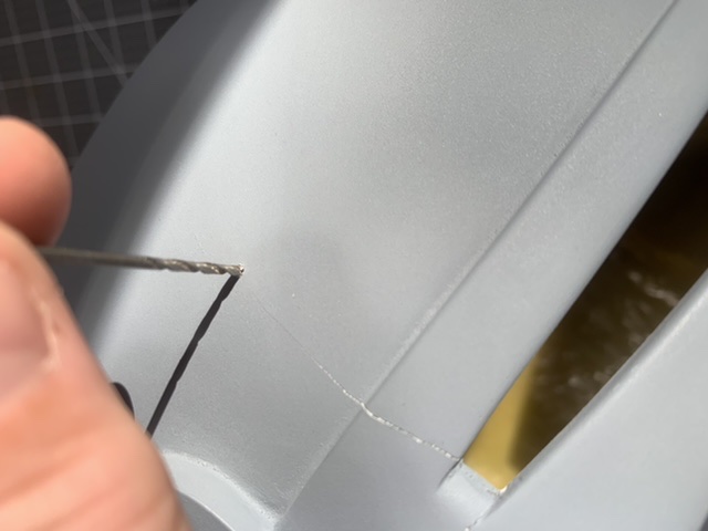

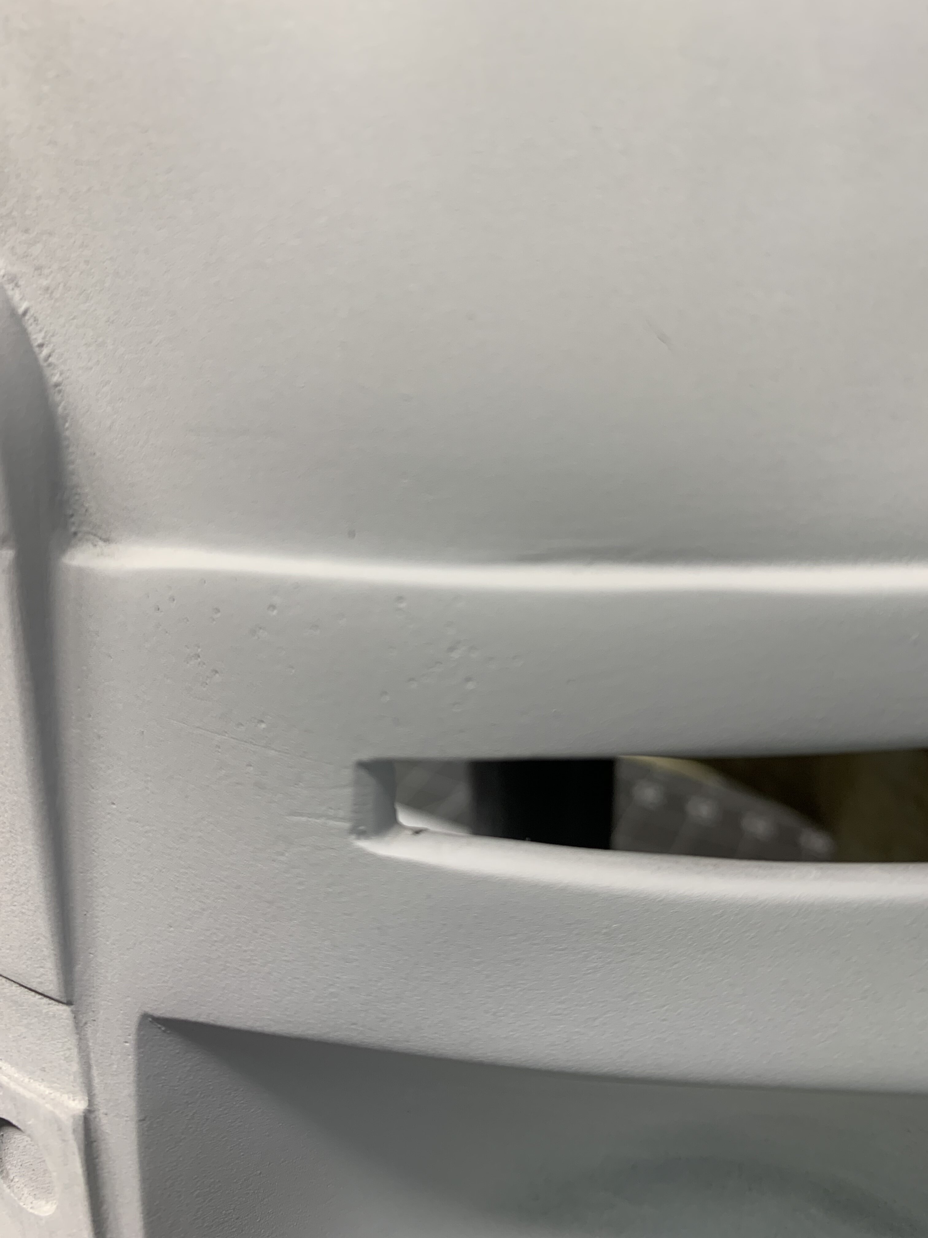

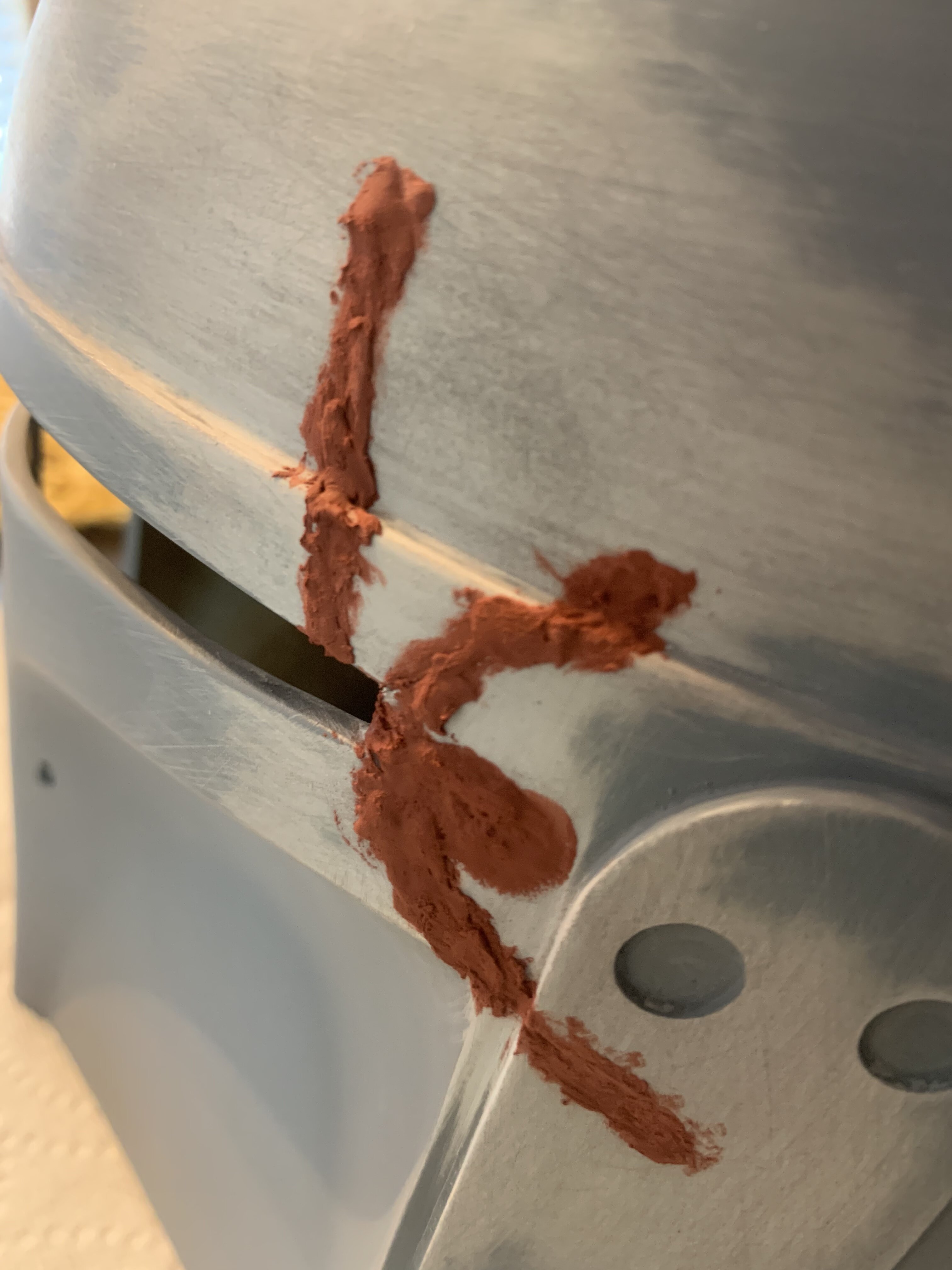

I got some advice from boba87fett on how to approach this repair. He did something similar in his ROTJ SE to ESB Hero conversion. So I will be using some Bondo glazing putty to fill the cracks. followed by sanding, wet sanding, priming to see where i messed up, rinse and repeat.
Once repaired, I will be adding the physical ROTJ damage follow by a ROTJ paint job. My intent is to have my 15 YO son assist me in this repair/paint-up and to give it to him afterwards. Although, depending on how well it turns out, I may just hand down my current ToEleven ROTJ helmet and keep this one.
Anyway, there will be more to come...
