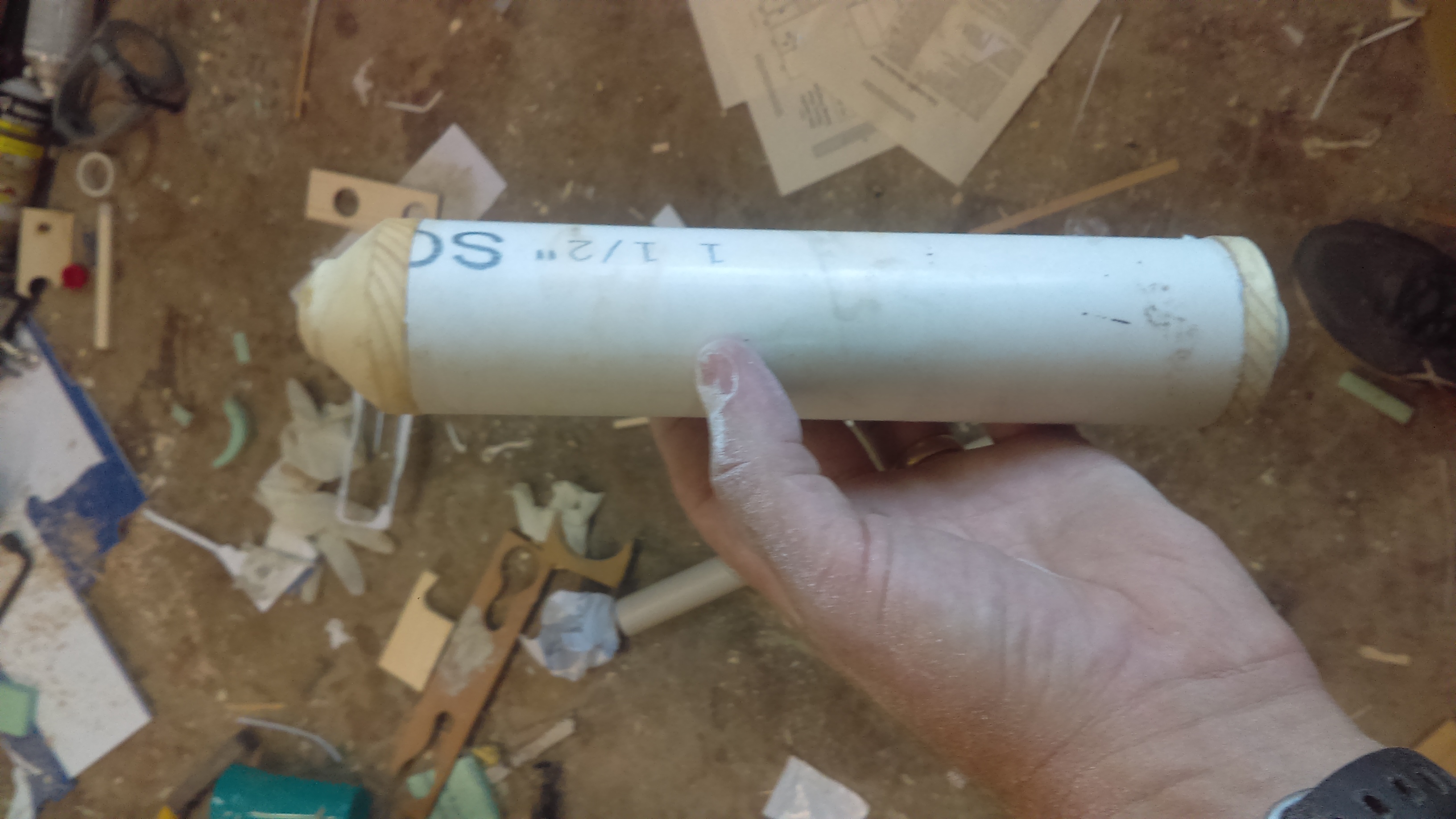

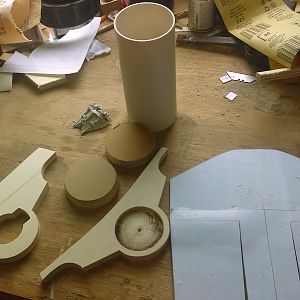

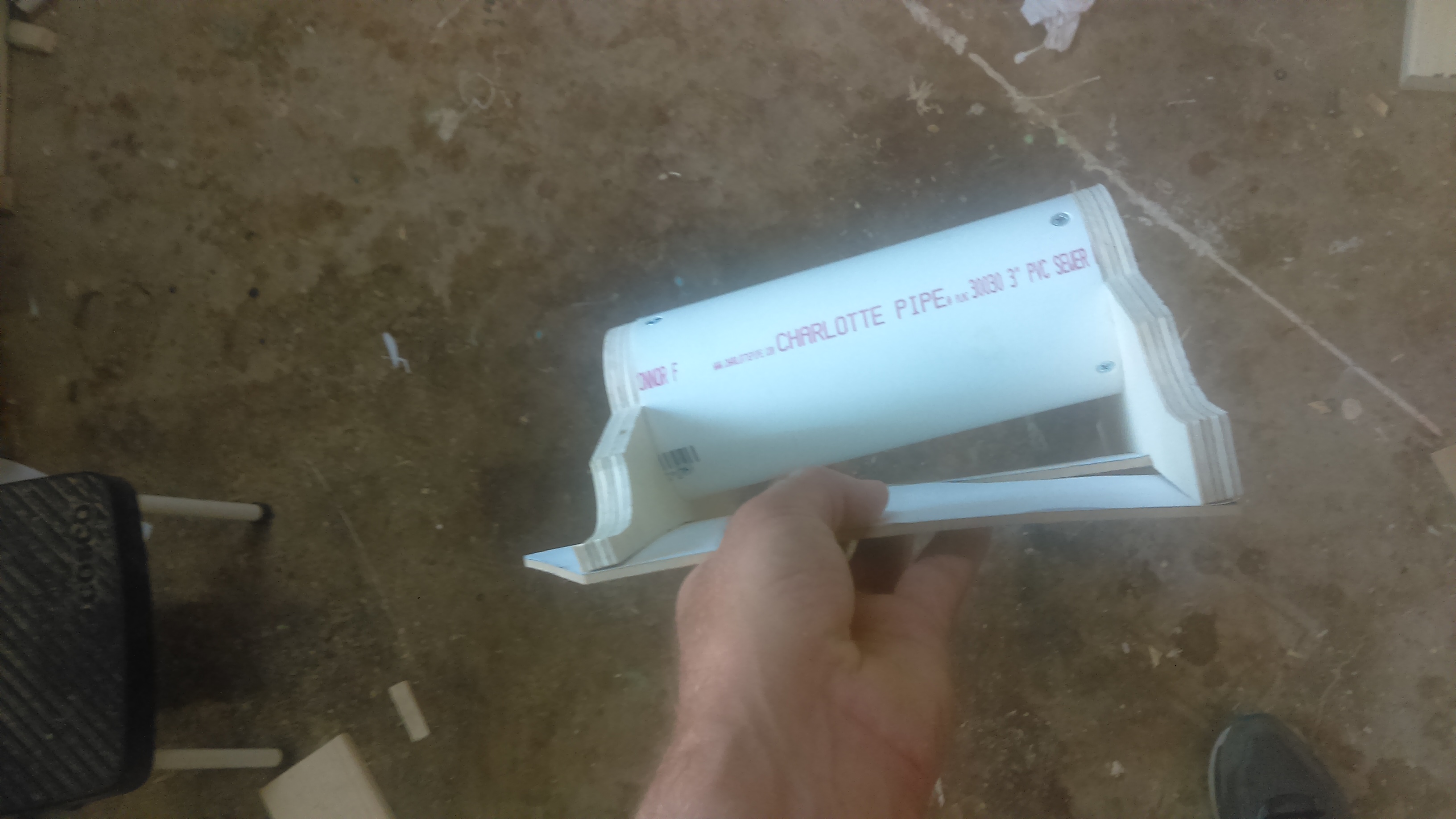

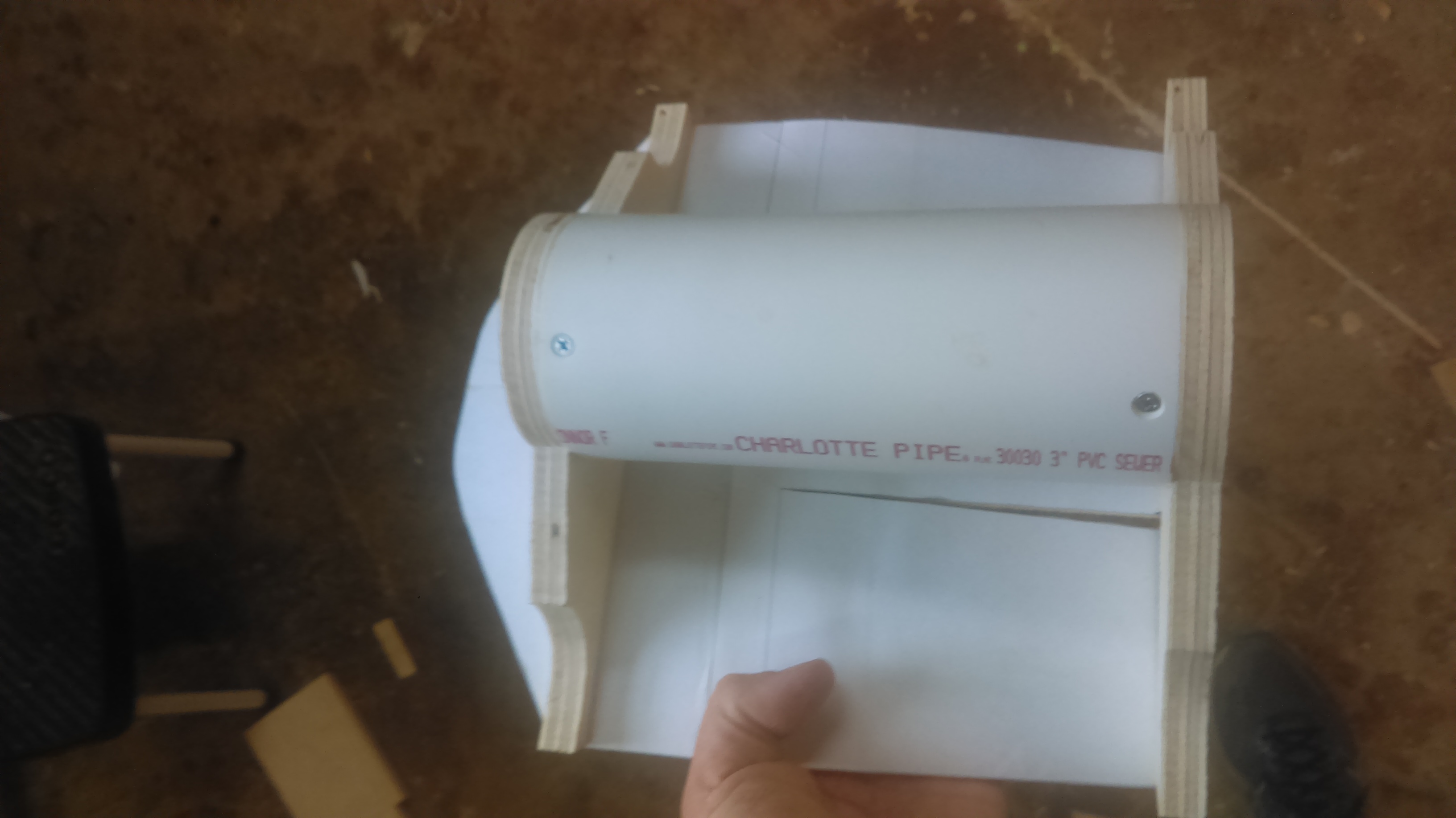

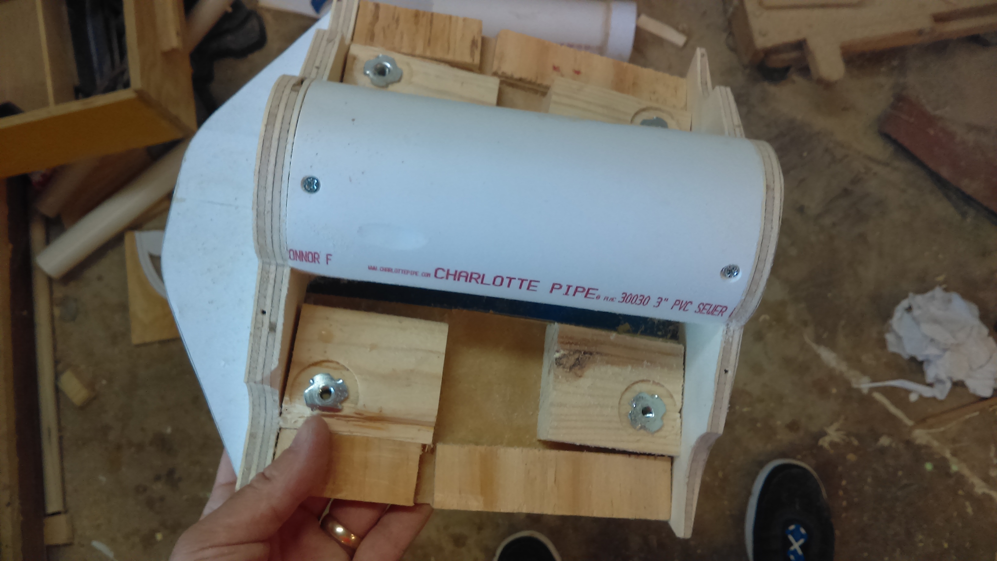

And now for the jetpack. I sized a full scale pattern down a bit to fit my son. The final width came out at around 10". I started with the main tube and top and bottom panels. Since I wanted to make a bit bulletproof or a 9 yo I used some 1/2" plywood for the top/bottom, a 3" thin wall PVC pipe for the main tube, and an 1/8" think piece of mdf for the back. That will give me a solid base to build on top of with foam core board and other hard foam pieces.
The two plywood circles are for the interior of the PVC tube.

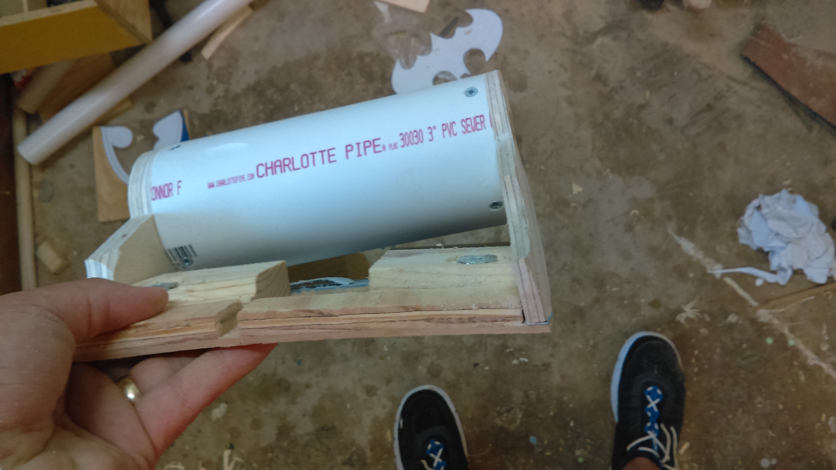

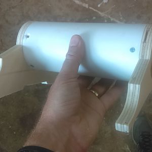

After inserting the plugs int eh PVC I screwed them to the top and bottom plates.
Then attached this to the backer board.
1/8" MDF bends pretty easily so I could form it to the curve I needed.
Thinking ahead I put some blocks with tee nuts in them for attaching whatever harness I come up with.

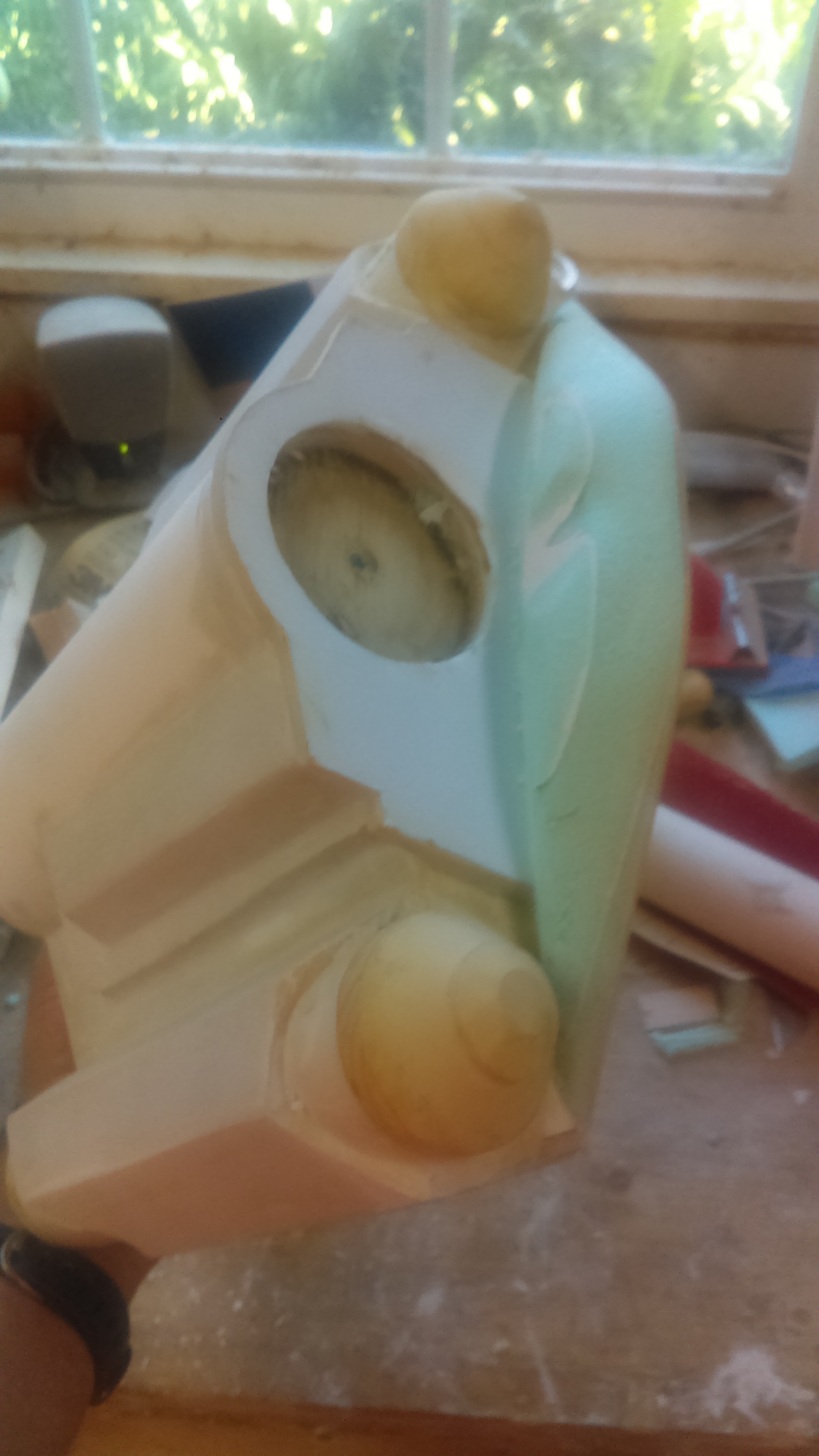

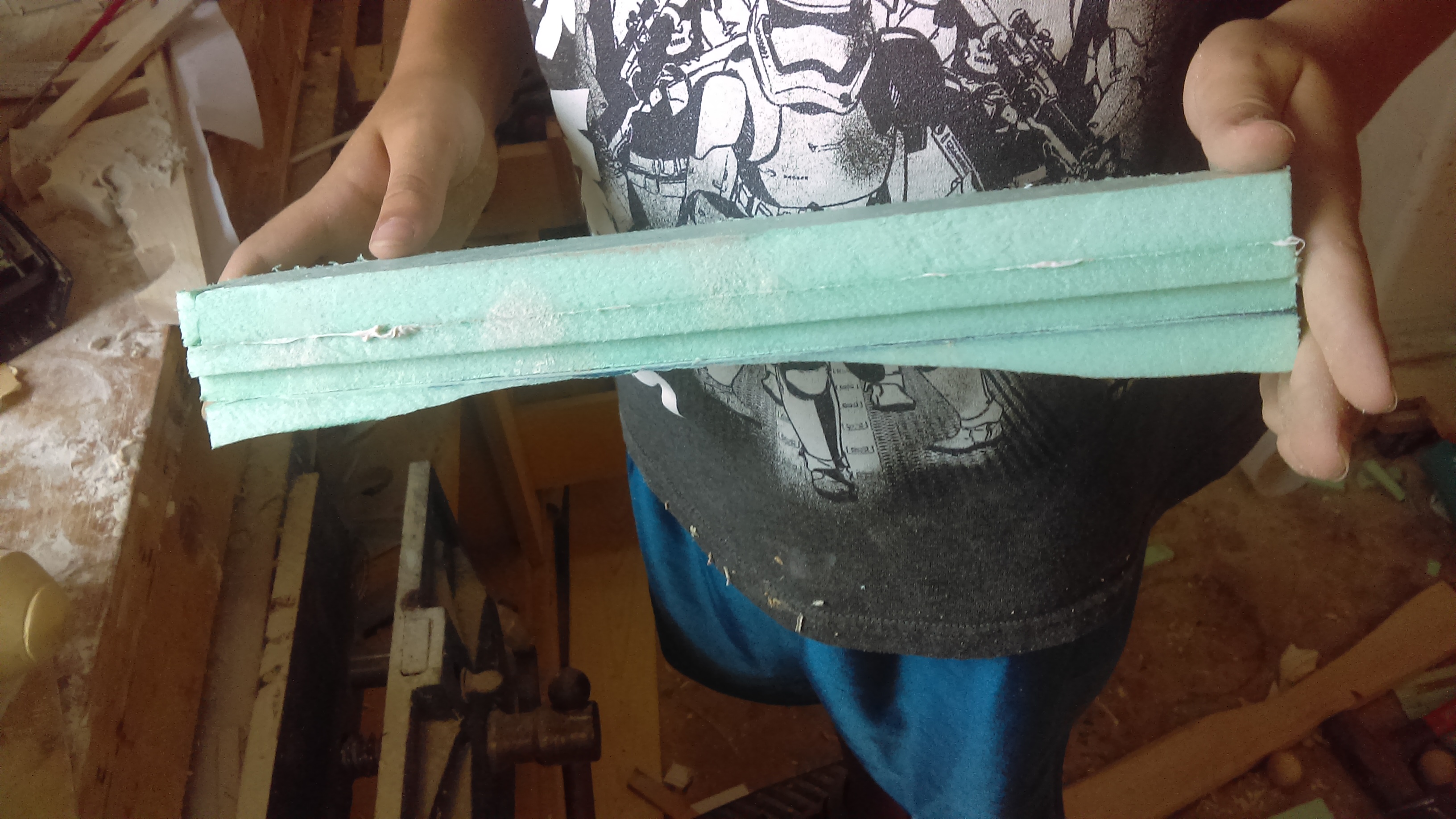

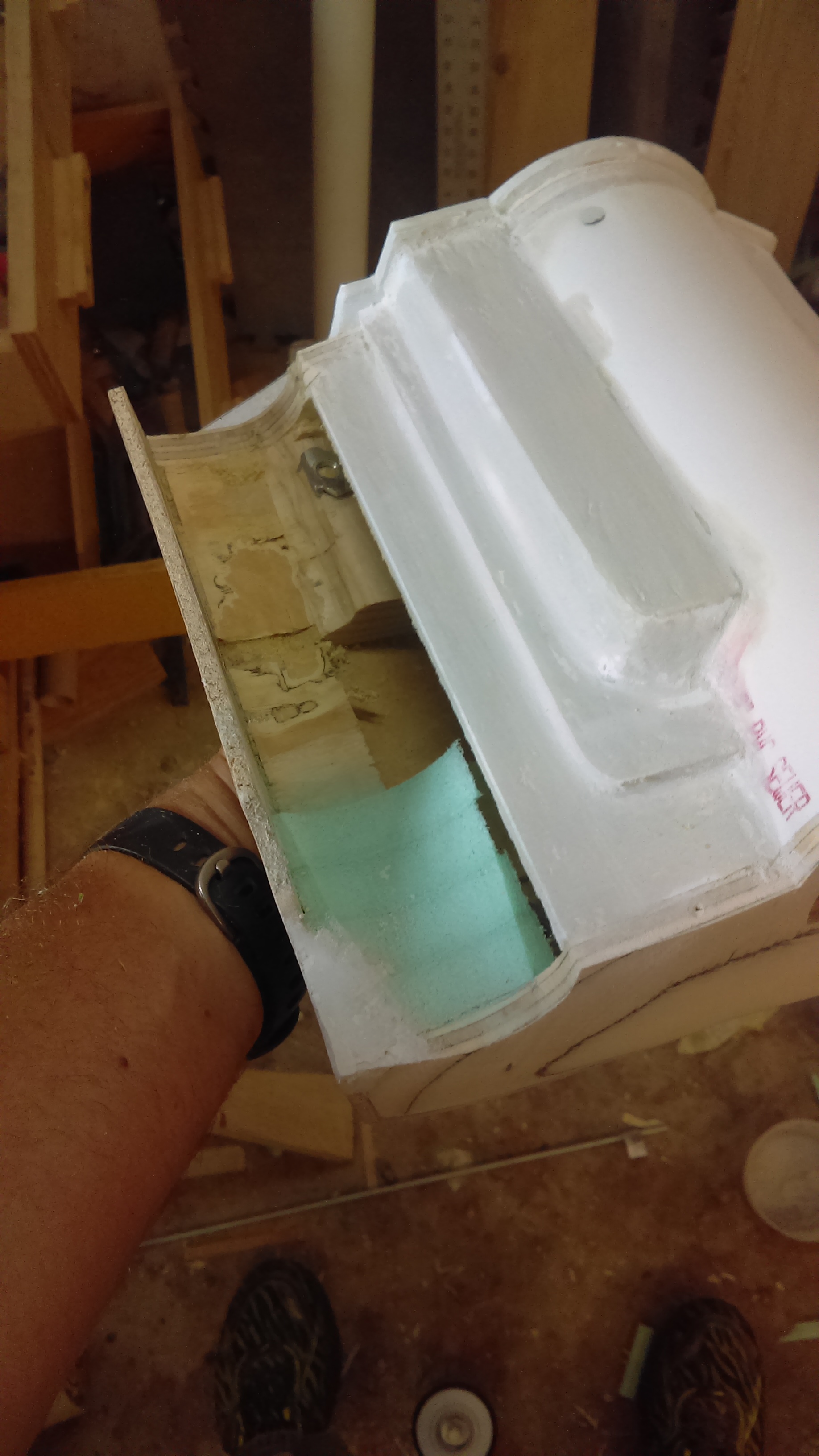

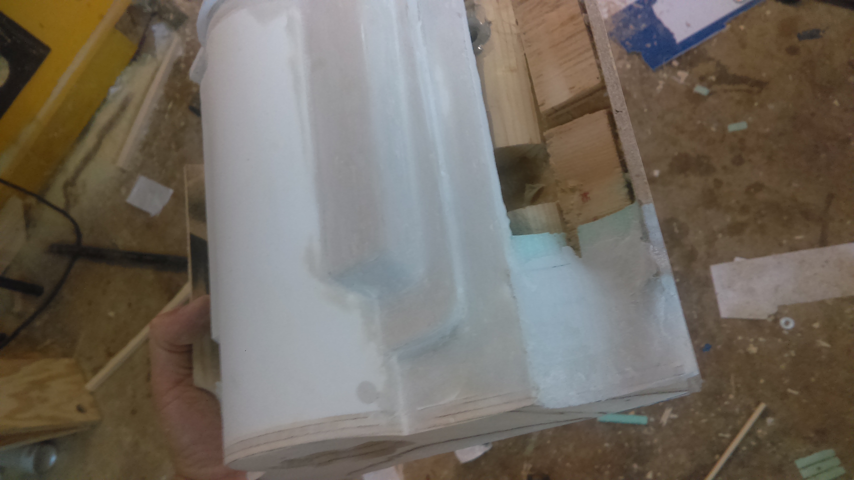

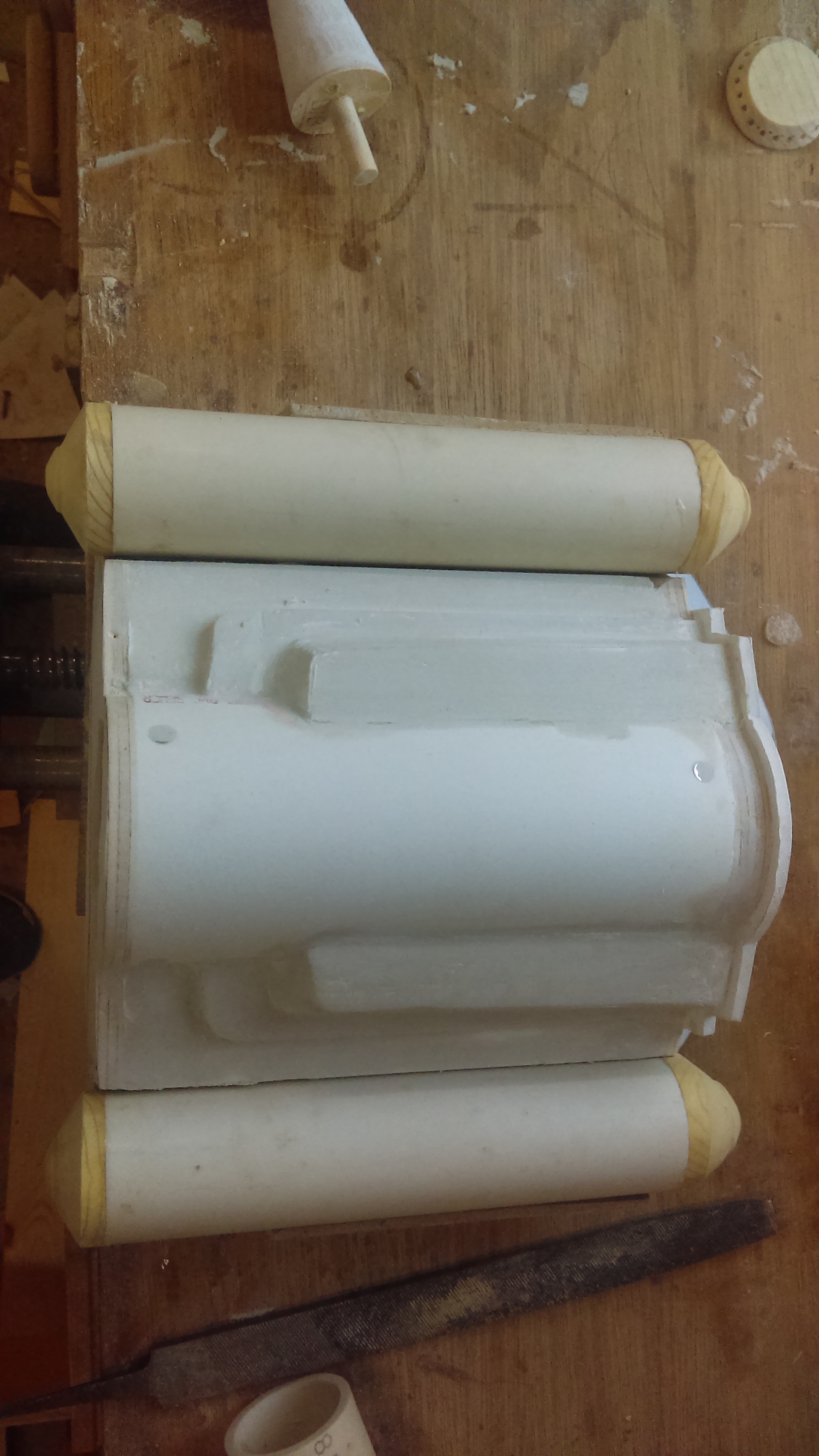

More progress. Made a part of the panels that cover the side tanks.and attached them to the pack and installed some foam to help support the side tanks. I've got foam core board cut and ready to go over the tanks once they are in place.
Add a little bondo over the foam and sand it down, ready for the tanks.

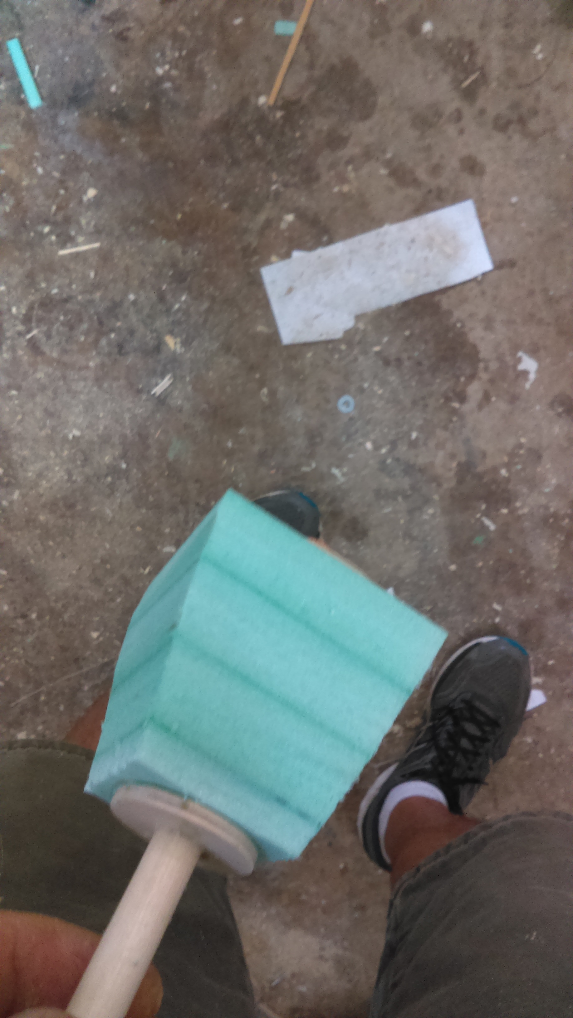

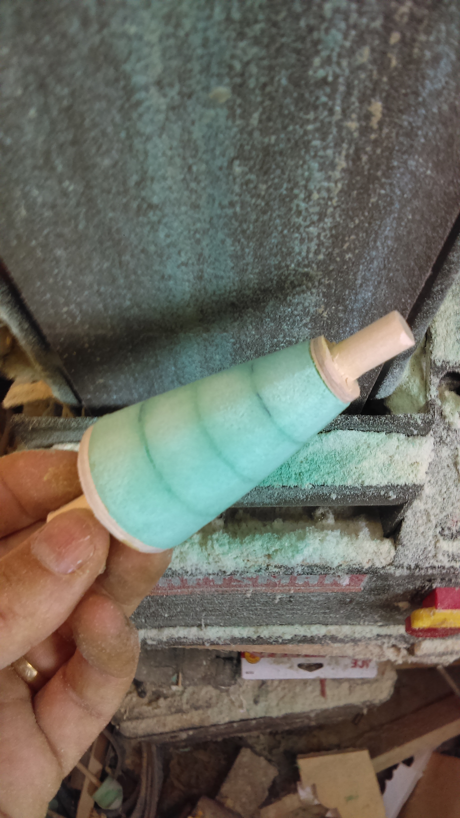

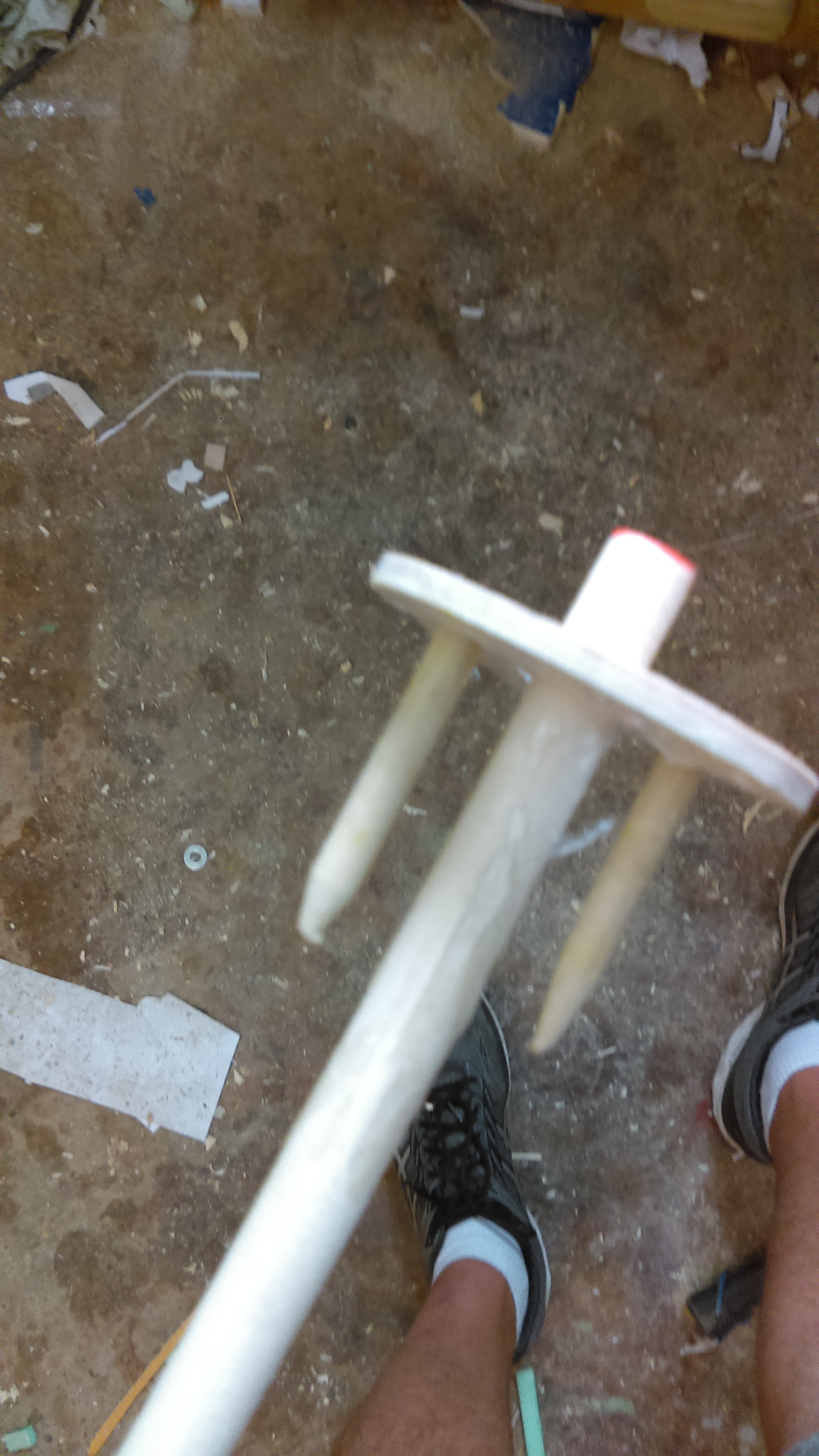

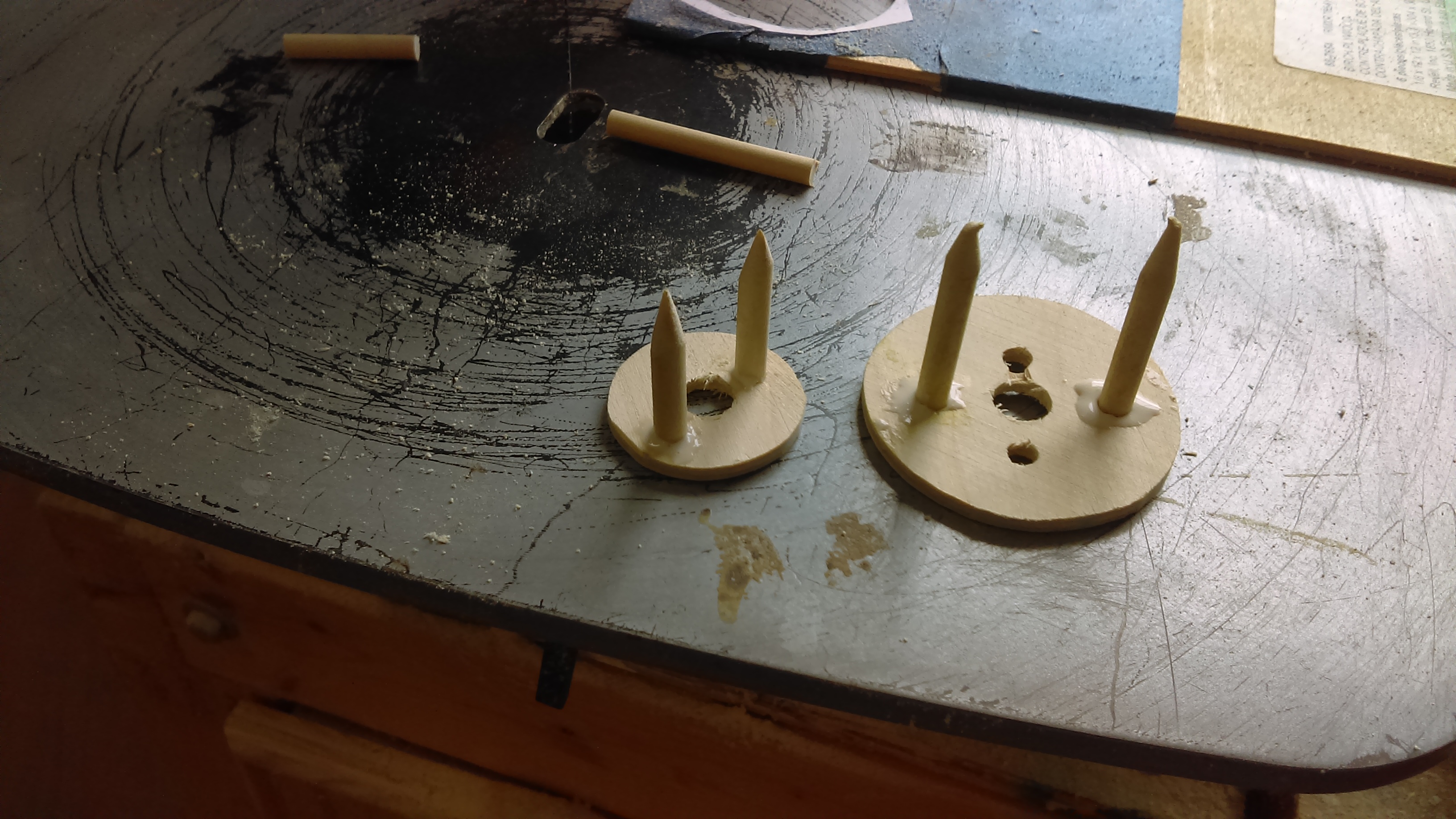

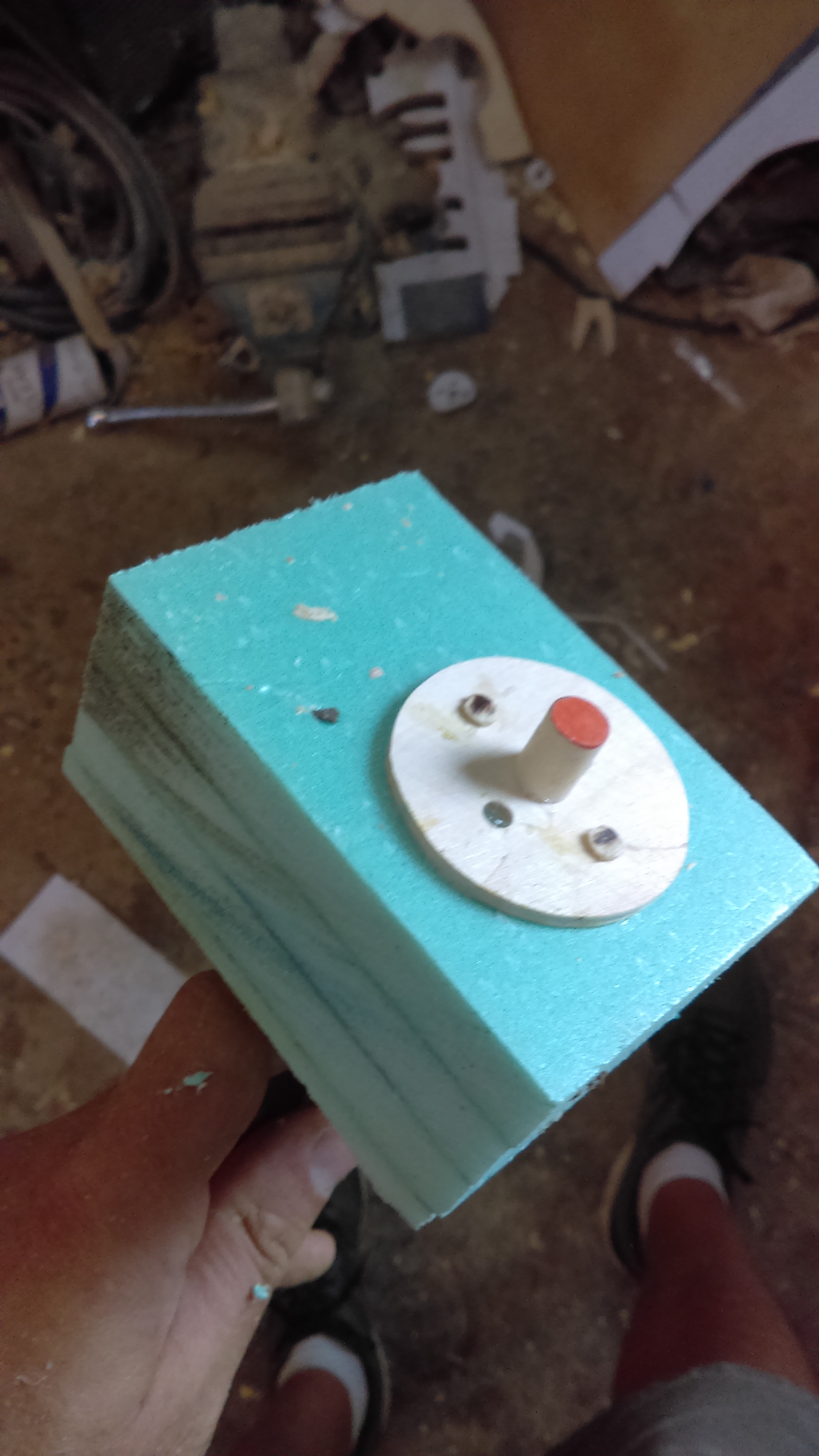

Moving onto the top of the pack I made some parts for the top of the jet pack. This time I used the same technique from the nose of the blaster with foam and bondo and it worked pretty well. I made 1/8'" caps corresponding to the top and bottom diameters of each of the larger parts from WOFs prints. I put two small dowels in each disk to help hold the foam in place as I turned it on the drill press with sandpaper. The 3/8" dowel is instereted in the foam and then the drill press so I can sand the round shape.
Here it is glued in place
A little shaping on the bandsaw
and the onto the belt sander
Then I chucked it in the drill press and used a wood block with sandpaper to sand it to final shape.

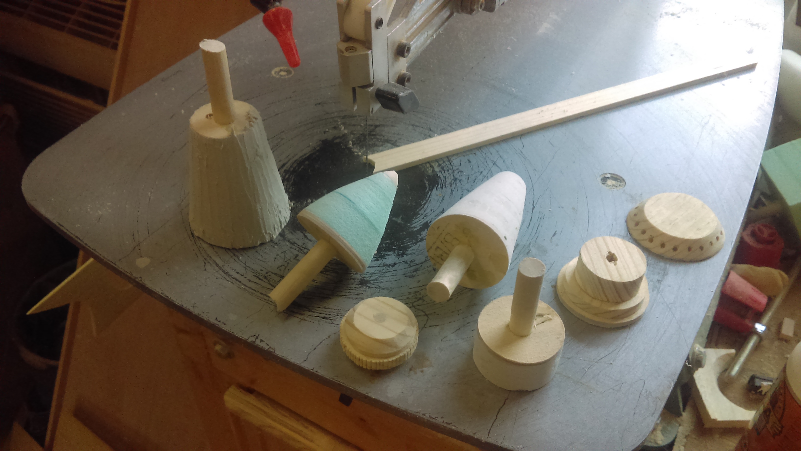

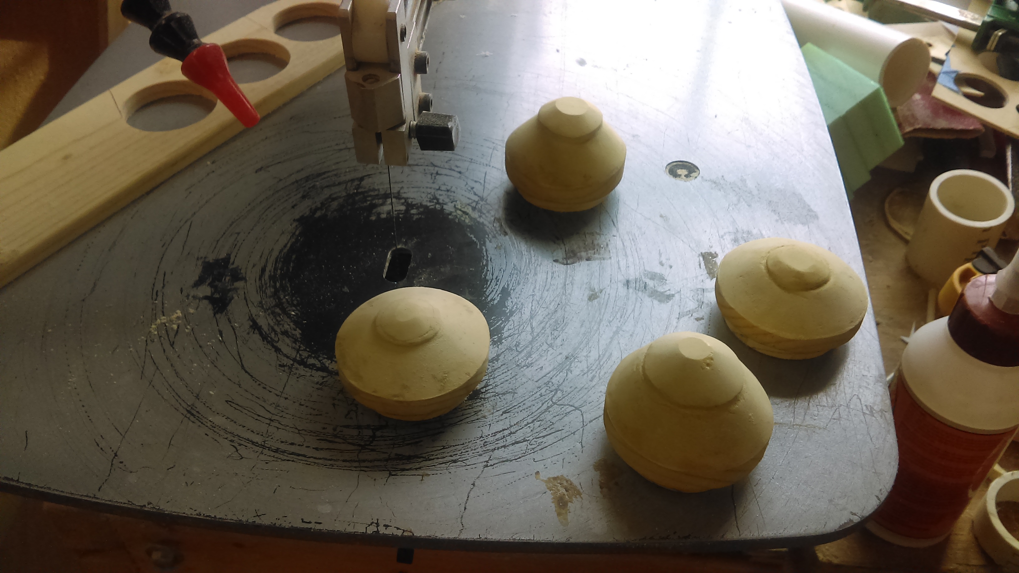

Some more time at the scroll was and I made some of the smaller parts out of wood and glued them together. Here's all the parts of the top missile assembly. Some already have bondo on them and need to be sanded. After that some smoothing with sandpaper and then cut the dowel protrusions off and glue it together.
Next up is the base of the missile at the top and the side thrusters and it's almost complete.

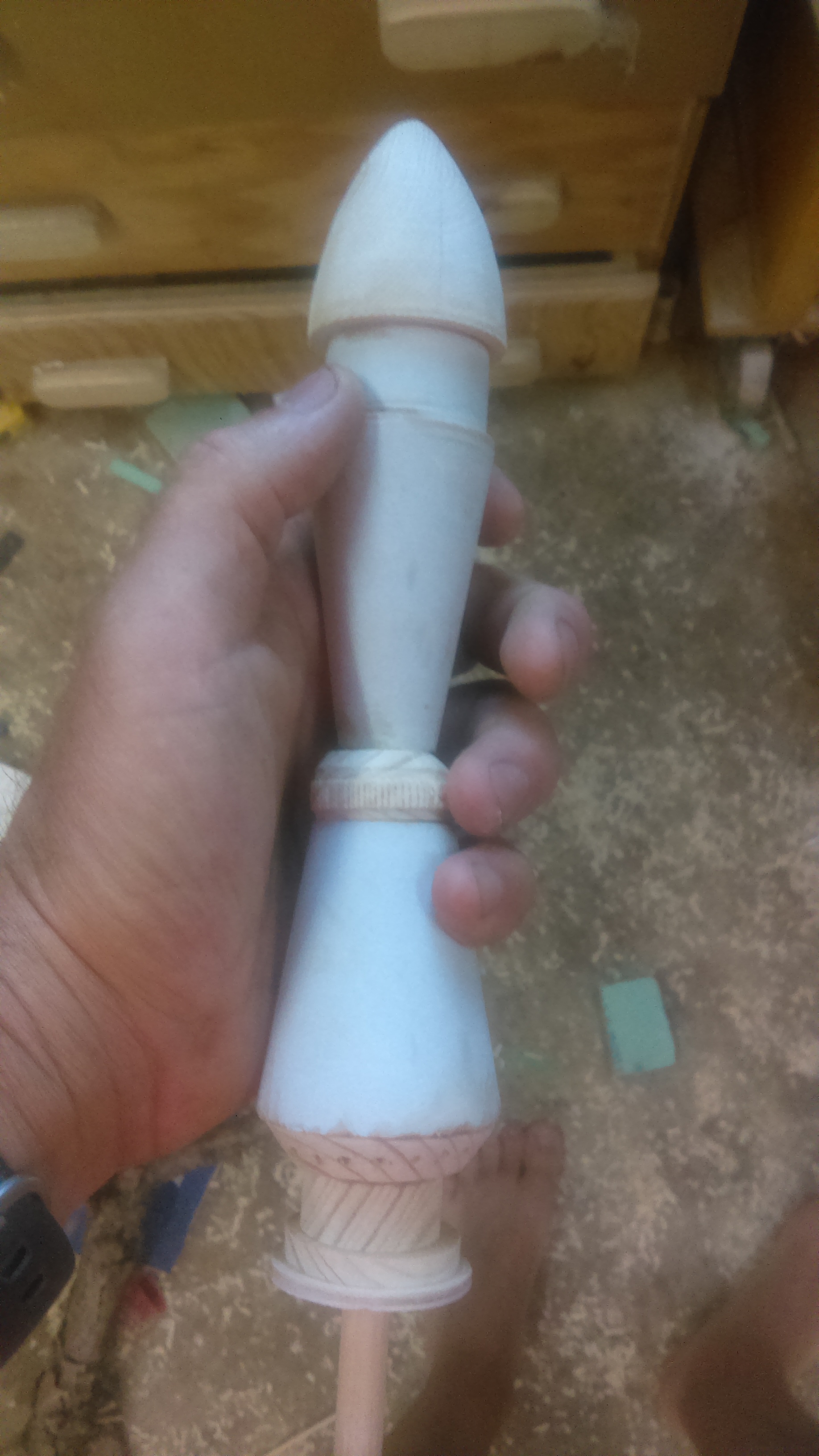

Started shaping the armor and I'm almost done with jetpack. I got the missile assembly completed and glued together.IMAG3357.jpg

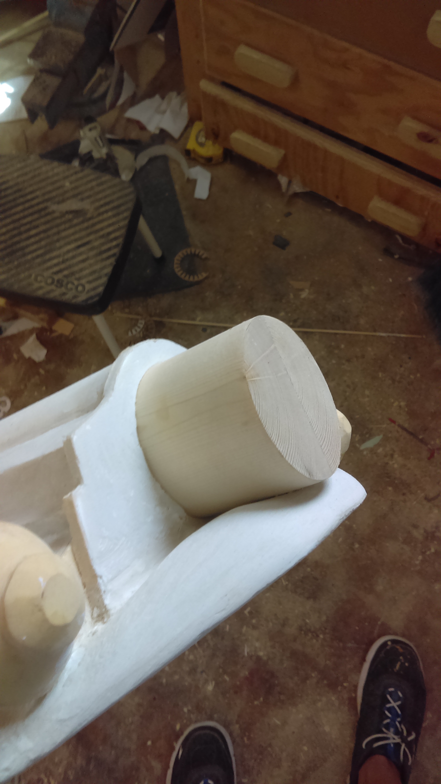

For the base I took two 2x4 pieces and turned them down on the lathe to the diameter needed to fit the top. I'll drill a hole in it and the missile will set in that. IMAG3384.jpg IMAG3353.jpg IMAG3358.jpg

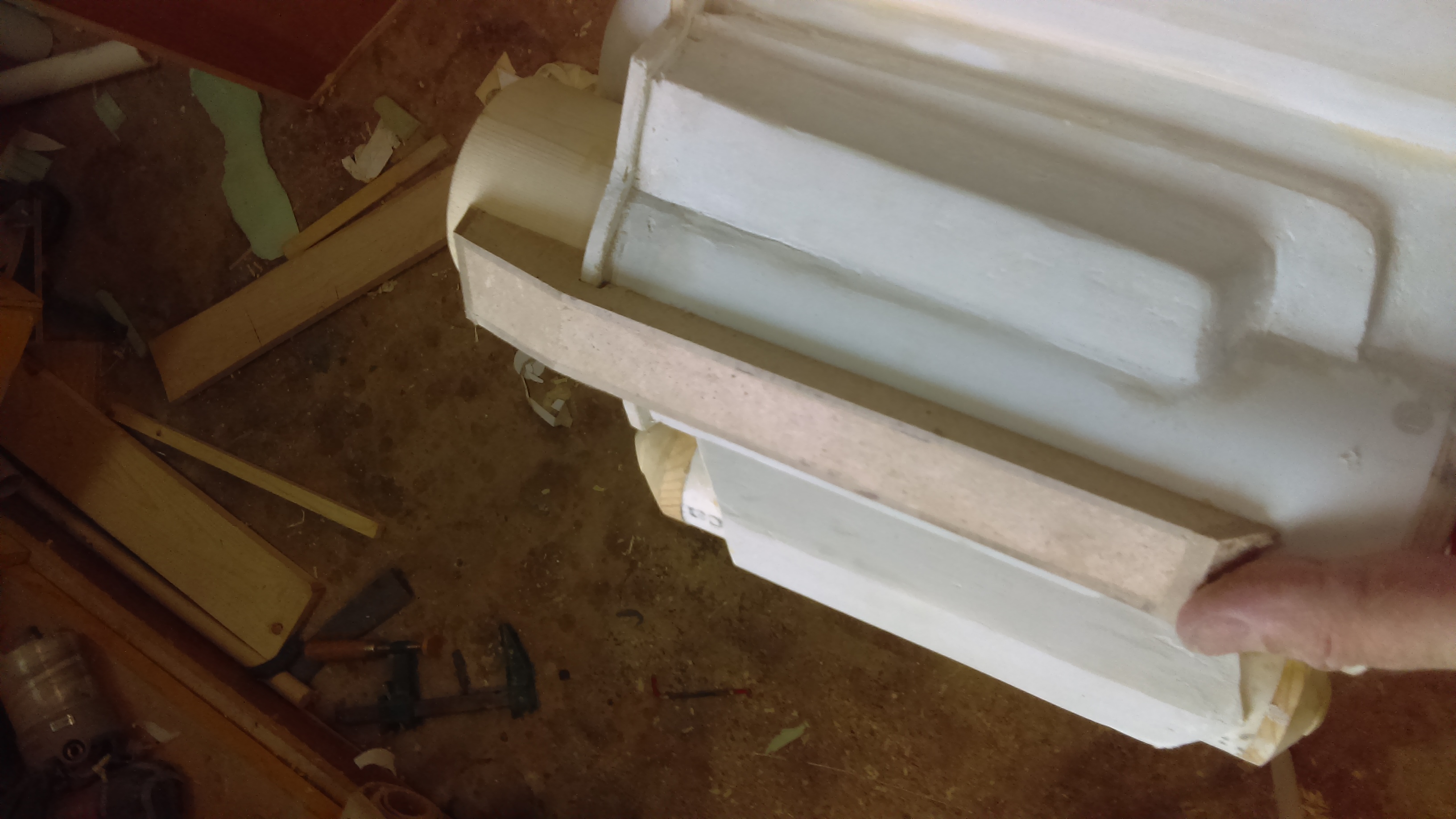

I made the piece that straddles the main tank and the base of the missile from some 1/8" hardboard and sanded it smooth and to match the contour of the tank.IMAG3386.jpg

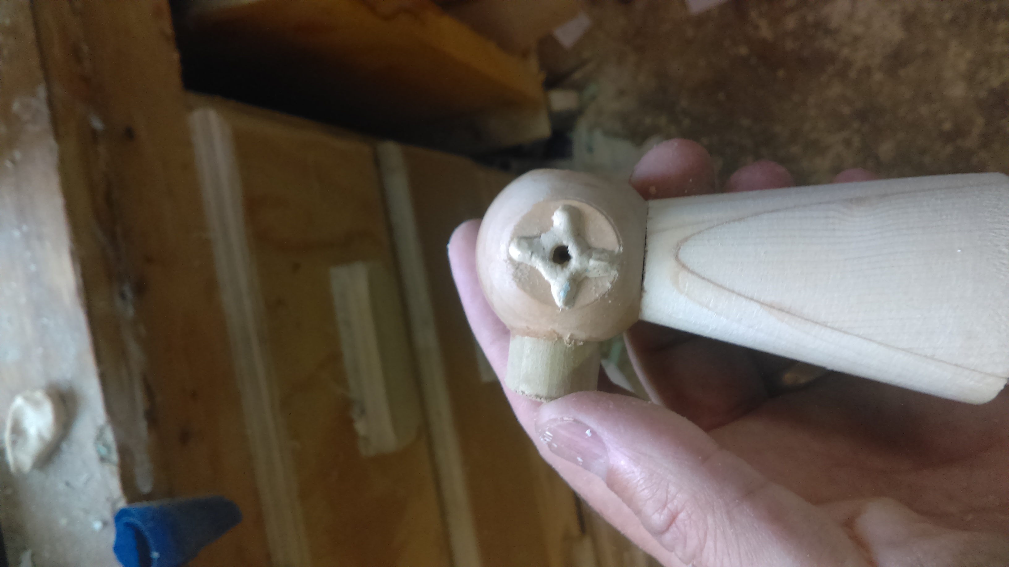

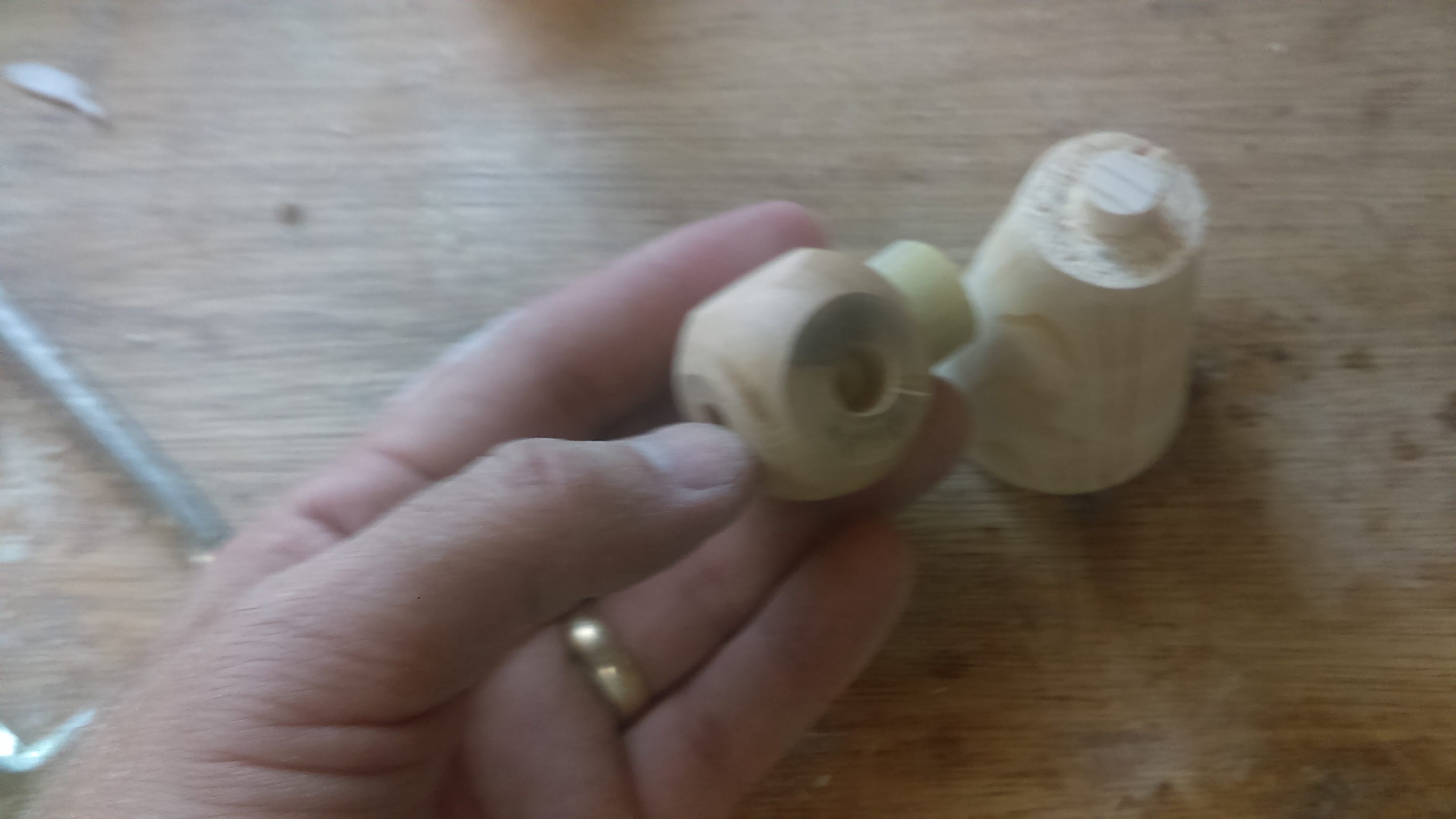

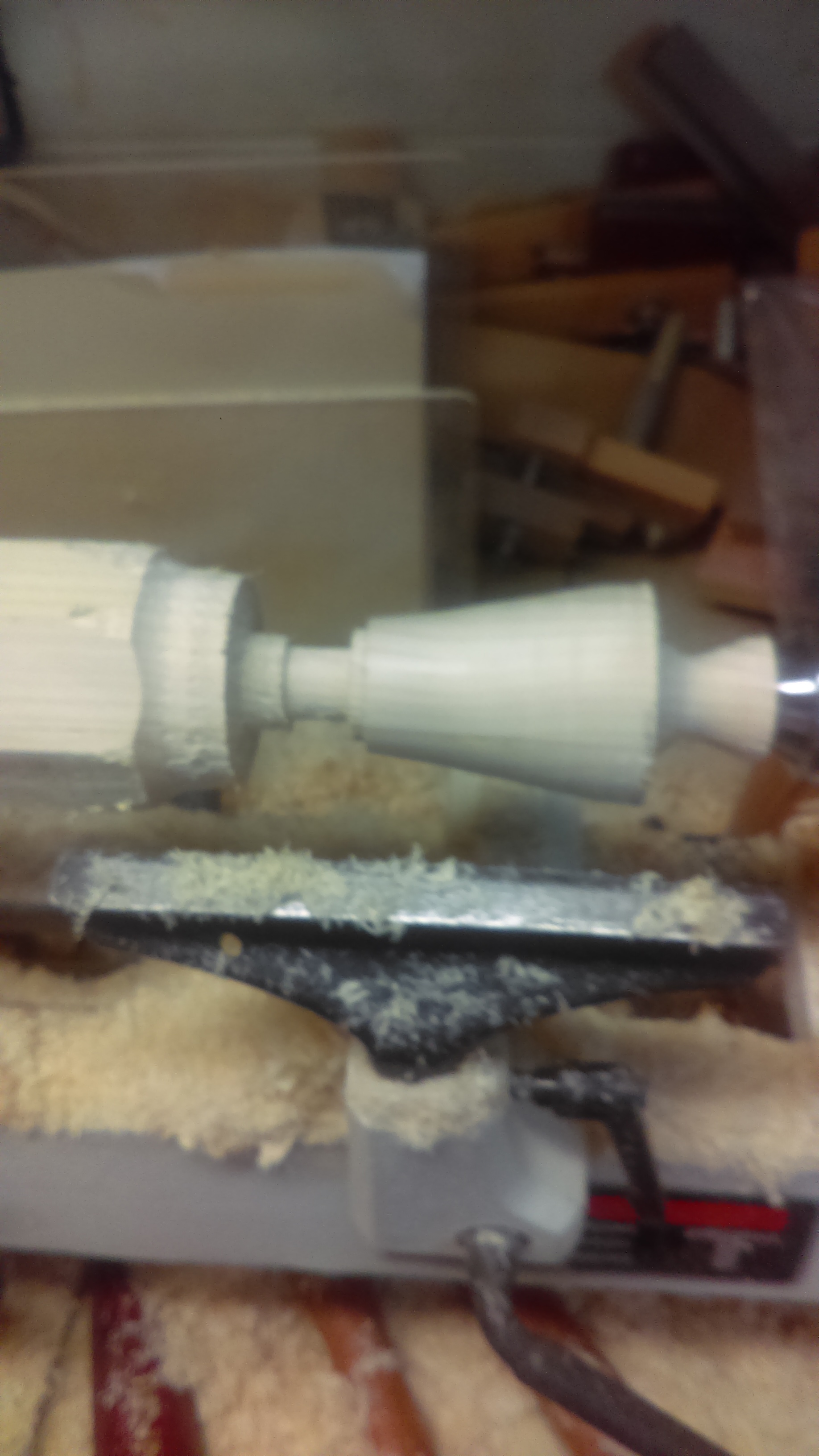

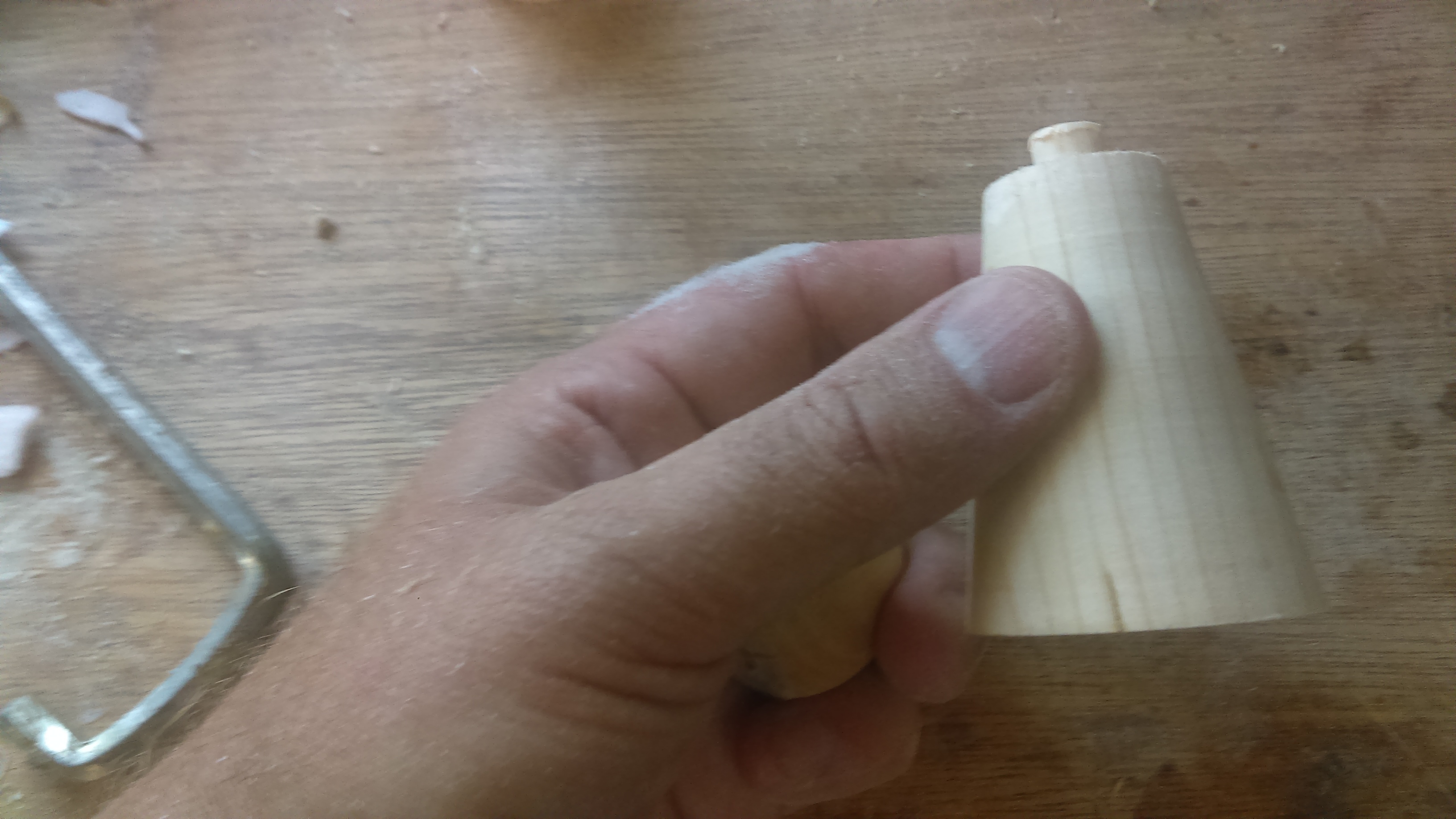

Next up are the jets at the sides of the pack. I turned the cones on a lathe.

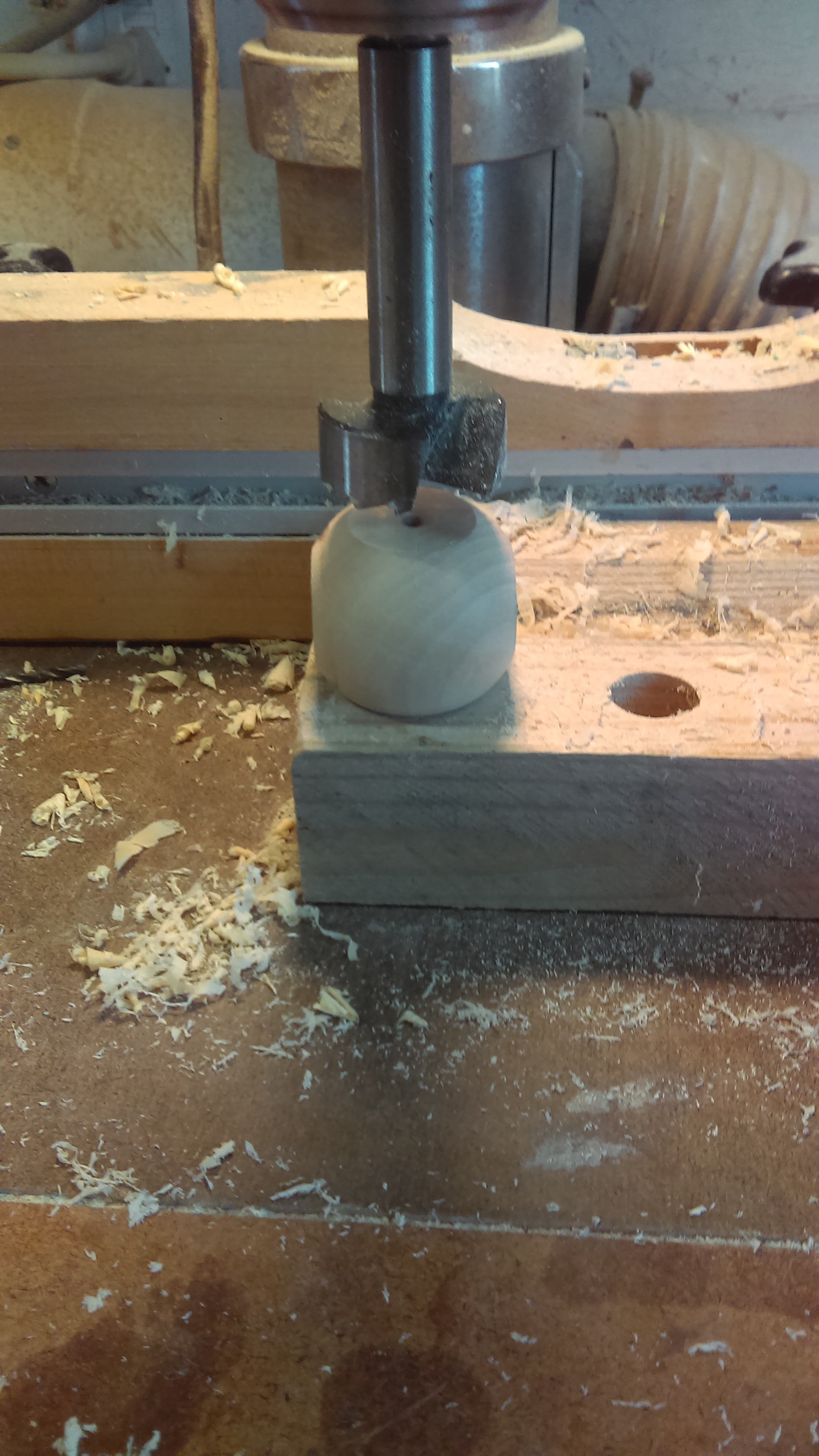

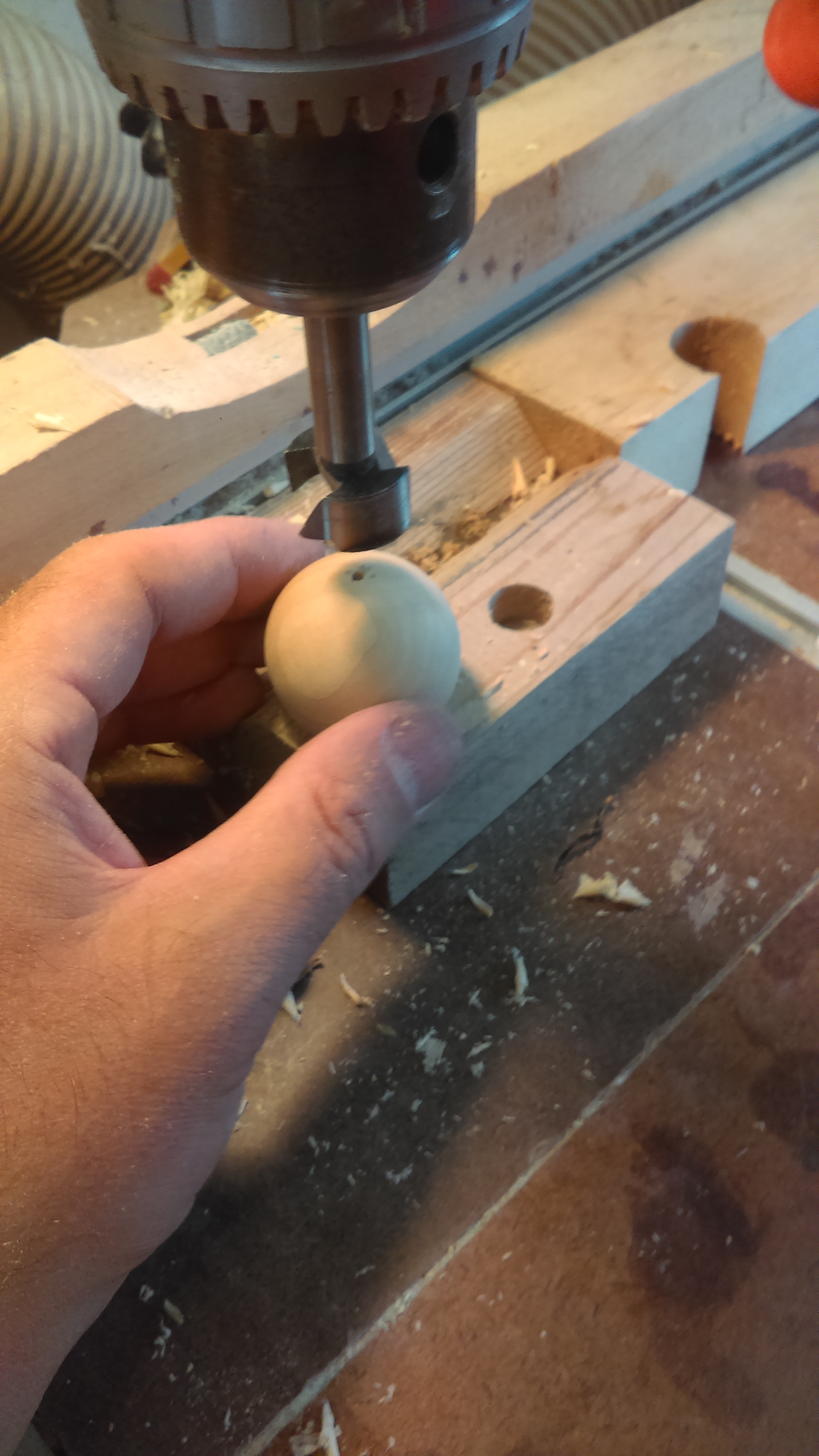

for the ball section I bought some 1.5" round balls from the hobby shop and drilled flats in the proper spots using various size forstner bits to get the shape I wanted then drilled a through hole for a 1/4" bolt so I can attach it to the side tanks later. The stand offs on the balls are made from 3/4" dowel that I glued to a flat on the ball and then shaped to fit the contour of the side tankIMAG3349.jpg IMAG3351.jpg IMAG3346.jpg IMAG3346.jpg IMAG3350.jpg

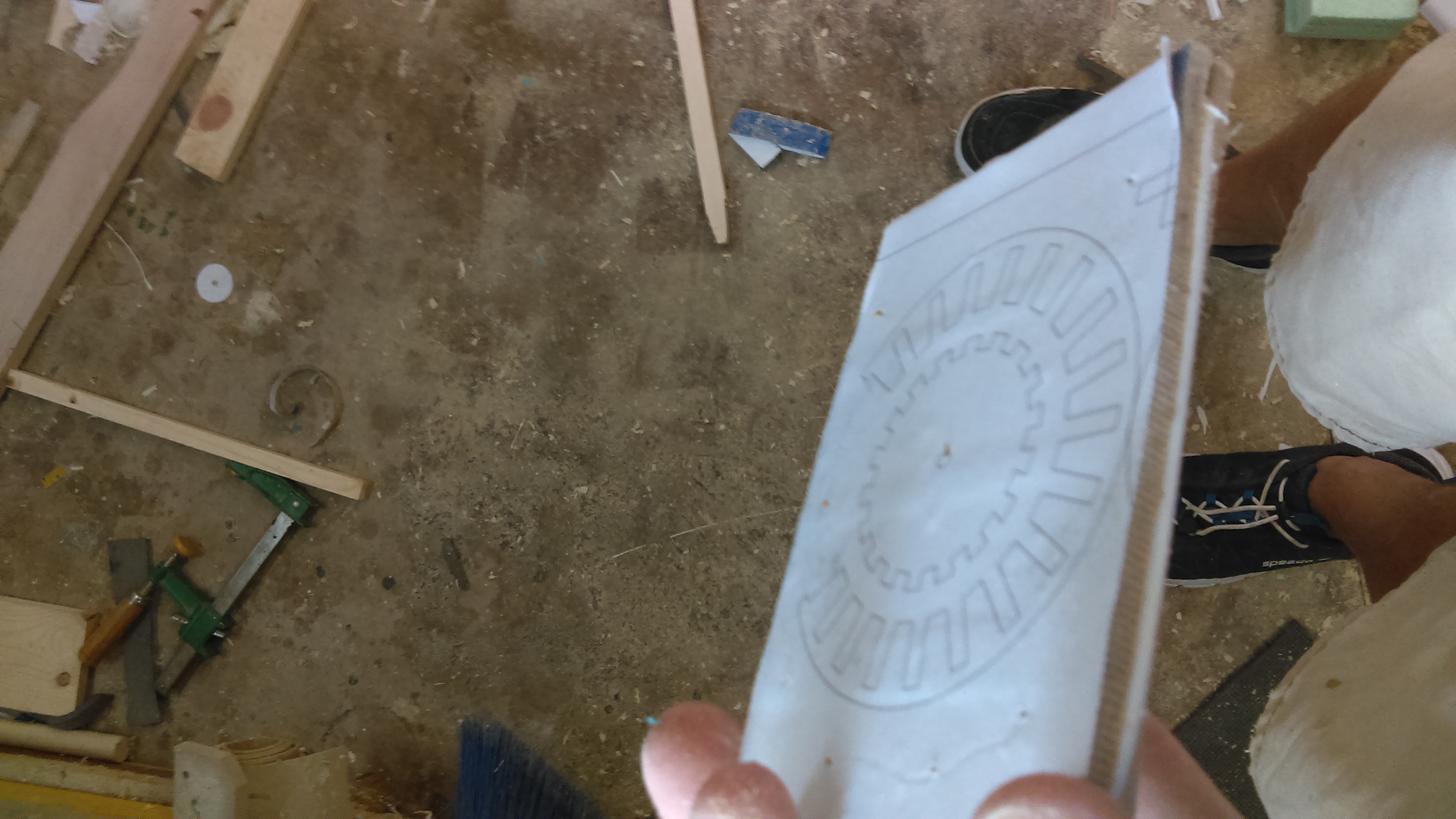

I used some more wood putty to make the cross design on the front of each jet. Now they're ready for paining. IMAG3365.jpg
