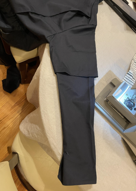

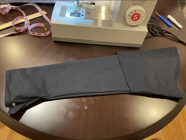

Carefully remove both the long sleeves off the flight suit and the short sleeves off the extra shirt, picking apart the seams with a seam ripper and once they are off you can add the cosmetic stitching around the short sleeves and any other tailoring you need to do. Then you will have to sew the short sleeve on to the long sleeves and then re-attach them both to the coveralls.

I made my own flightsuit, I made a tutorial for doing the sleeves: Flightsuit Sleeve Tutorial
The suit was pretty difficult, I highly recommend getting some experience with a machine if you haven't used one before. I used the vest pattern for the top, and a pants pattern I bought for the bottom. You'll also want to take your own measurements into account so it fits you well, hope that all helps and good luck!
