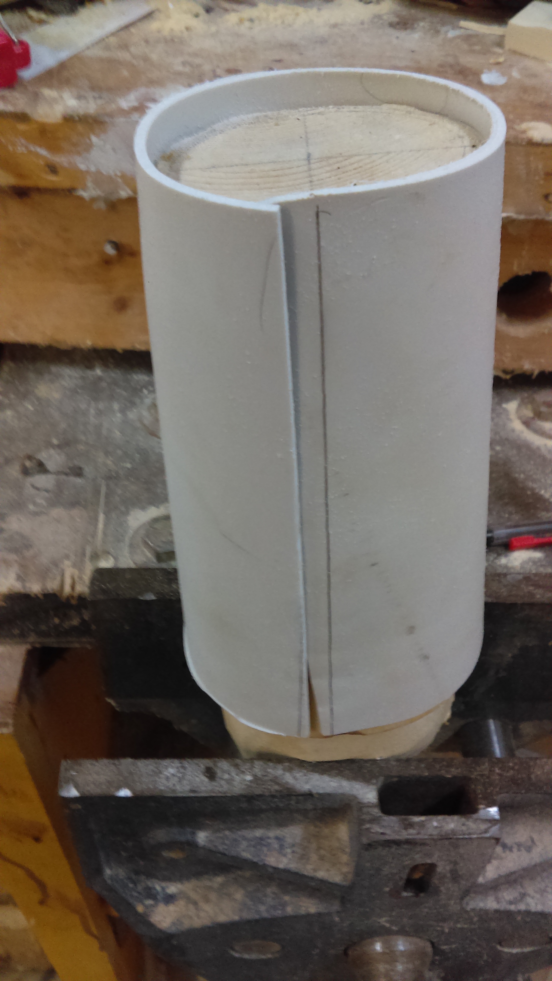

I screwed a block to the bottom to clamp it in the vice and I'm good to go. IMAG3426.jpg

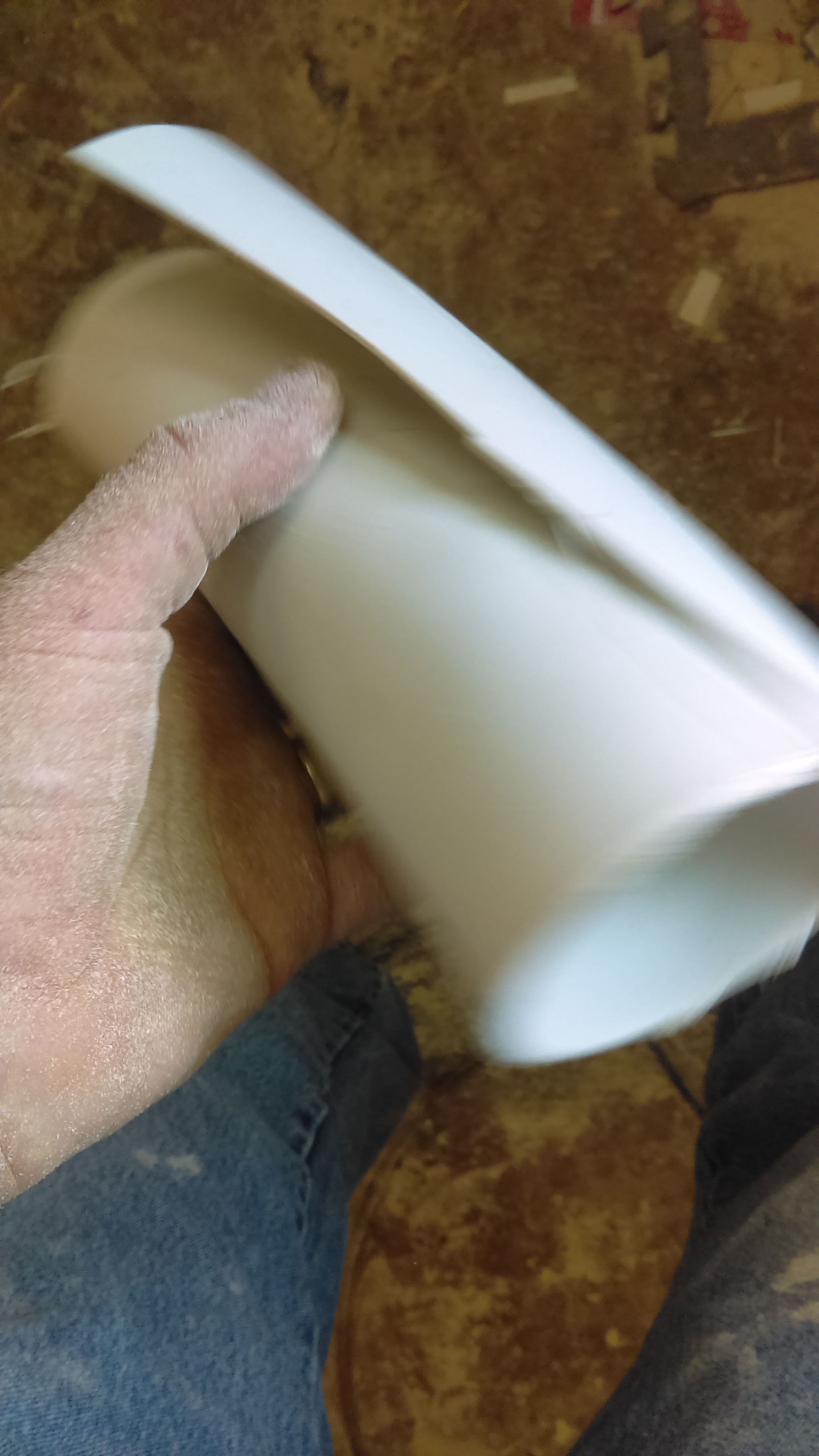

For the gauntlet I used some thin wall PVC pipe, 4". I cut a piece about 8" long (longer than I needed), and cut about an inch out of it to make forming it easier with a heat gun.IMAG3429.jpg
After heating it up to make it pliable I wrapped it around the form and held it there until it set (about half a minute) I used the wife's hot pads so I didn't burn my hands while holding the hot PVC (She doesn't know, don;t say anything. ;) )
It was easiest to work half the cuff at a time. When I was done I had a rough cone like thisIMAG3433.jpg
here it is on the form.IMAG3435.jpg Once to this point I used my Rockwell Soniccrafter (If you don;t have one of these you really need one for making costumes. It's awesome) to trim it up a bit before the next step.

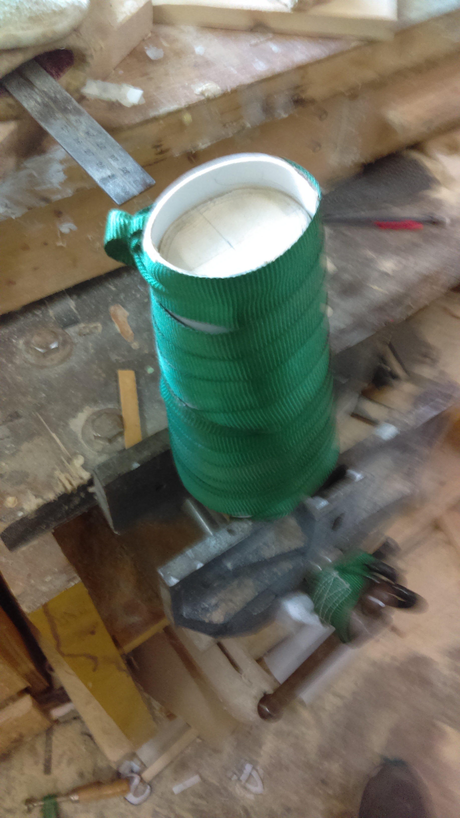

With a lot of the excess cut off I needed to get a better fit around the form so I heated it up again and used a tie down strap to wrap around the mold and PVC to get a nice tight fit.IMAG3436.jpg

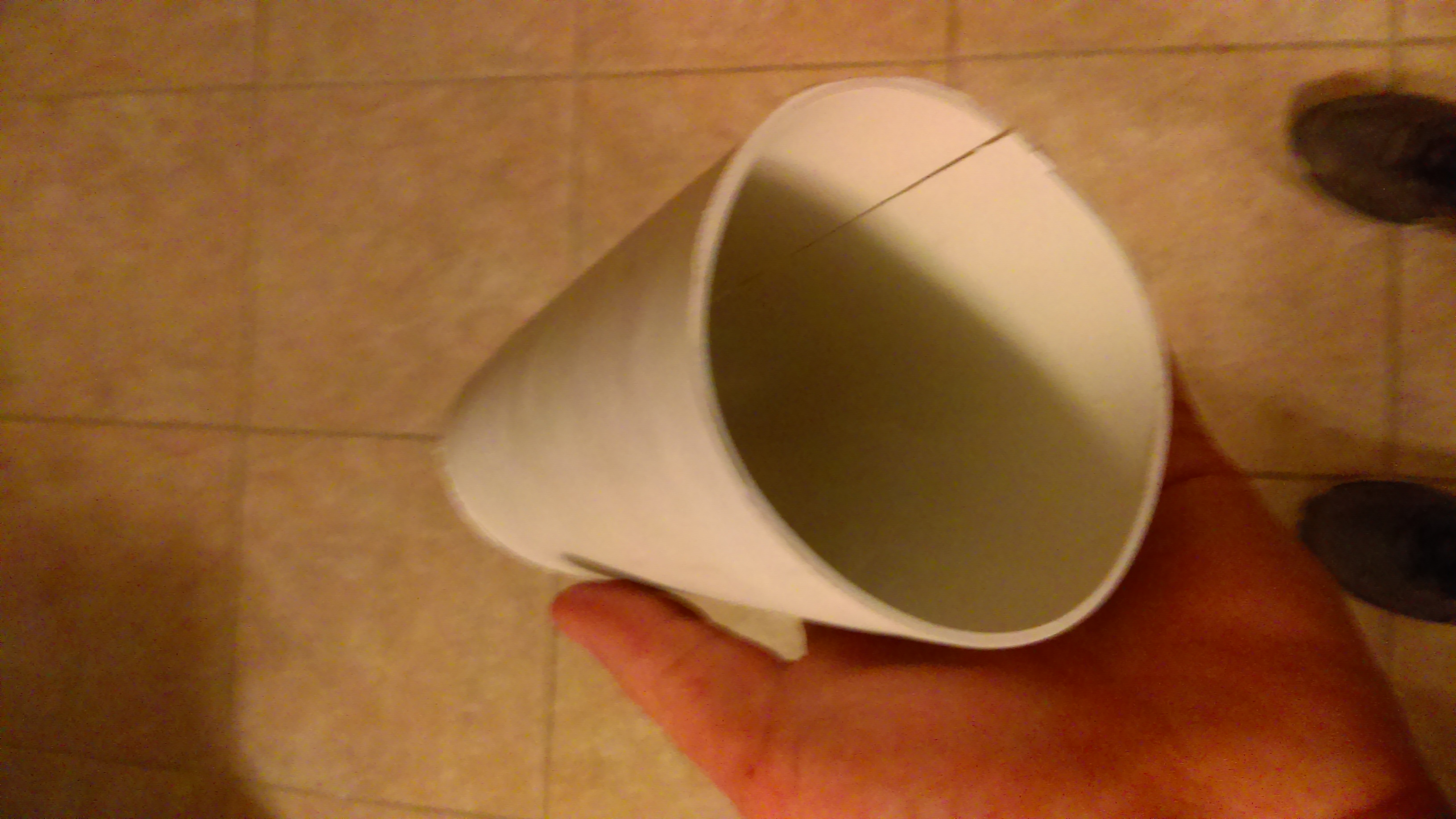

I let this sit for a half hour to make sure it was nice and cool before doing the final trimming. Here it is out of the moldIMAG3437.jpg.

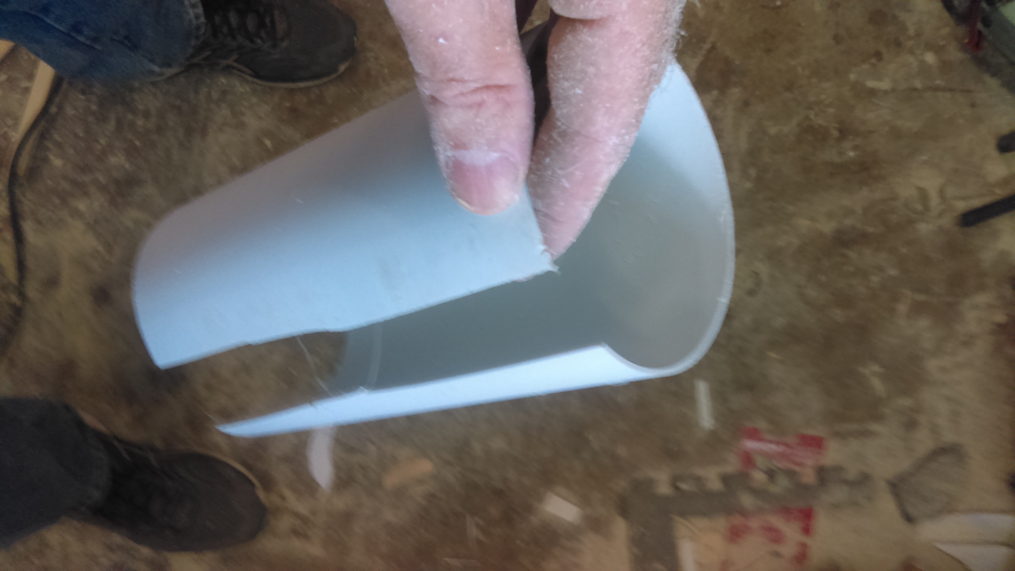

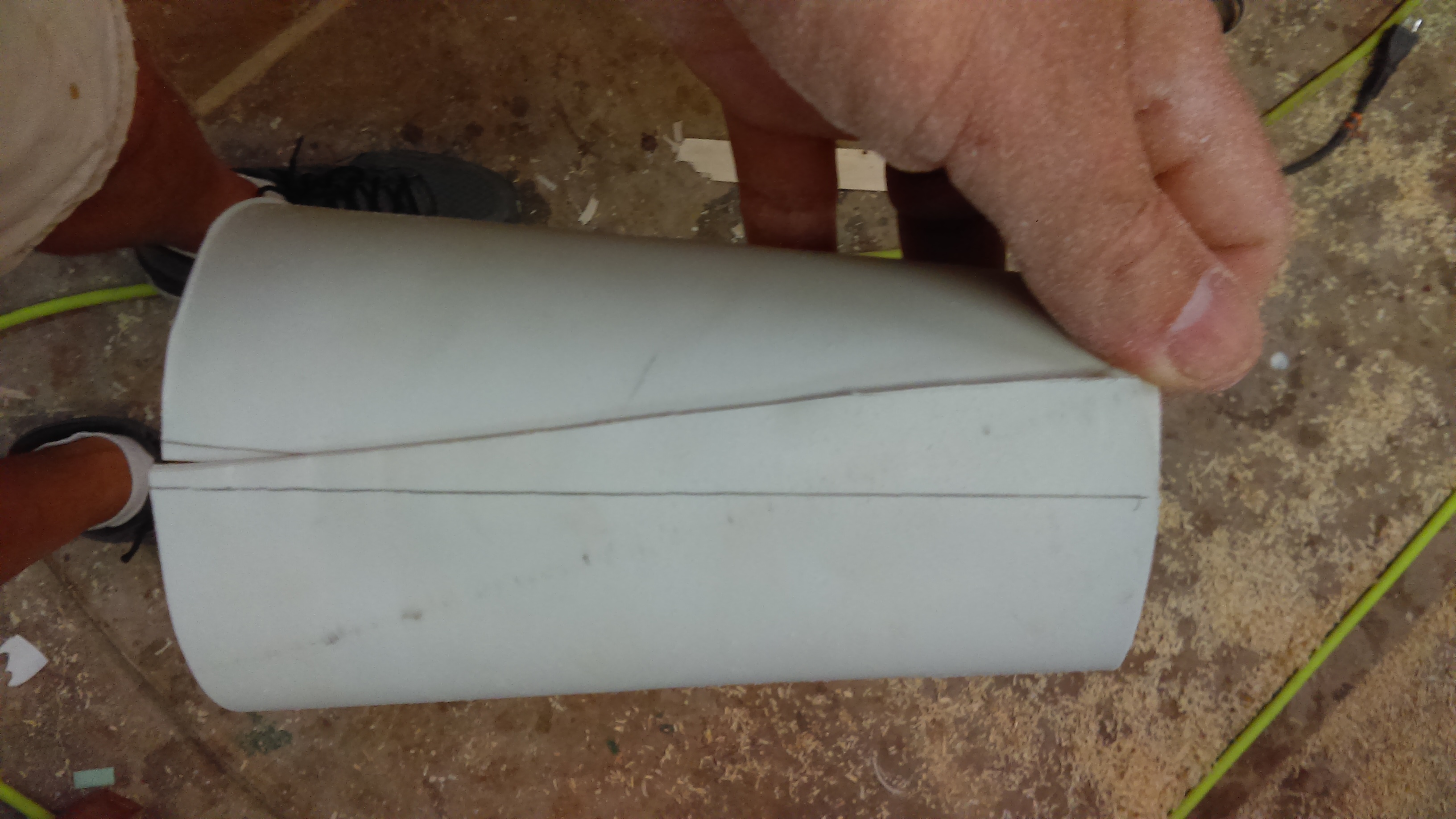

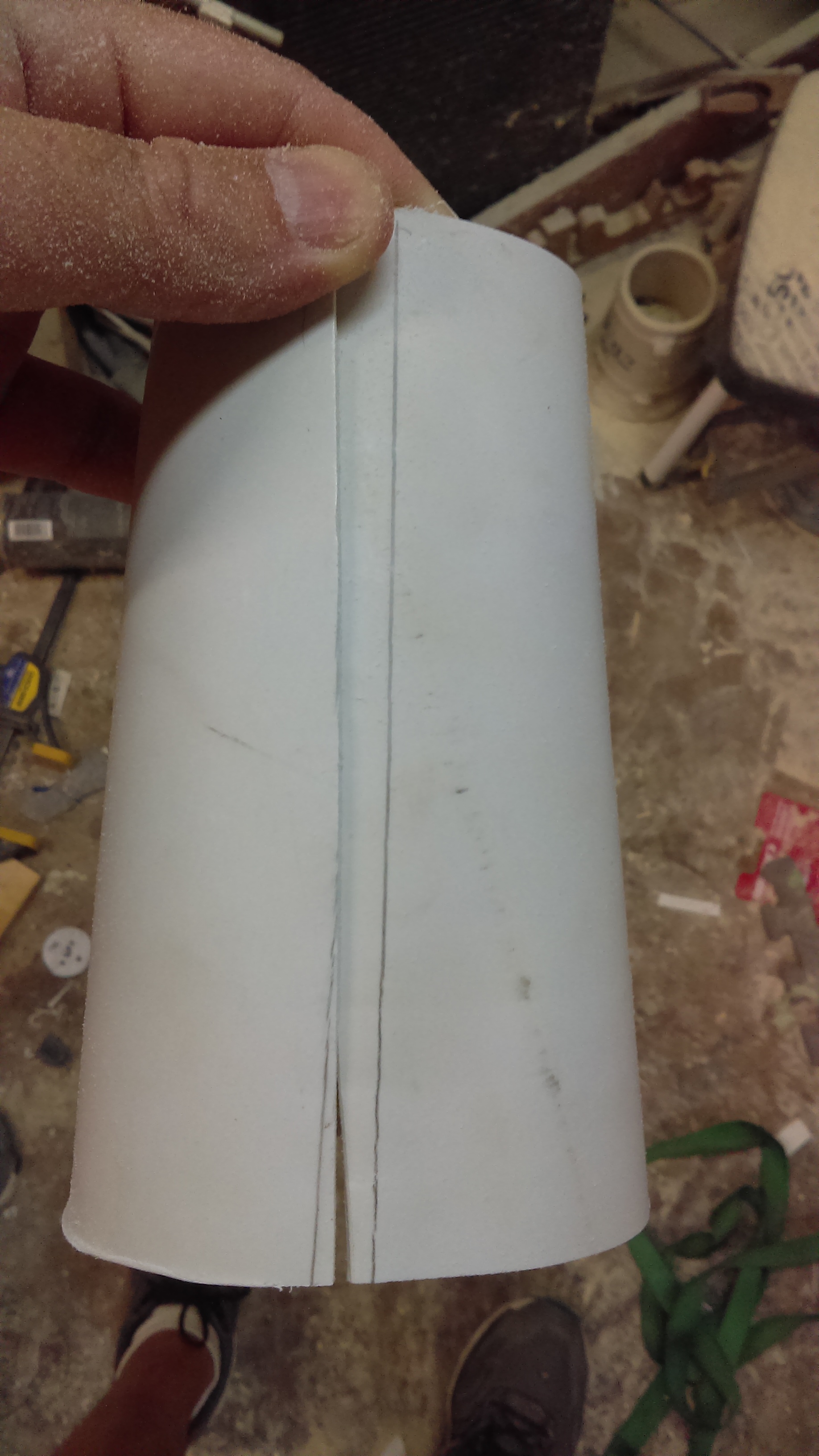

I drew a straight reference line on the overlapping section so I knew where to cut again. Here you can see the overlap that was tucked inside.
I used the sonicrafter to slice down that line so I had a nice mating between the two sides and then heated it up on last time and put it on the mold to form it with the tie down. Now I've got a cuff with a seam at the bottom that I cam pull apart enough for him to slide his hand and arm through with some foam padding in to keep it snug. (It's a good thing he's got skinny arms like me)IMAG3440.jpg
It works well enough for him to be able to get them off and on easily and the seam, once painted especially on the bottom won't be very noticeable

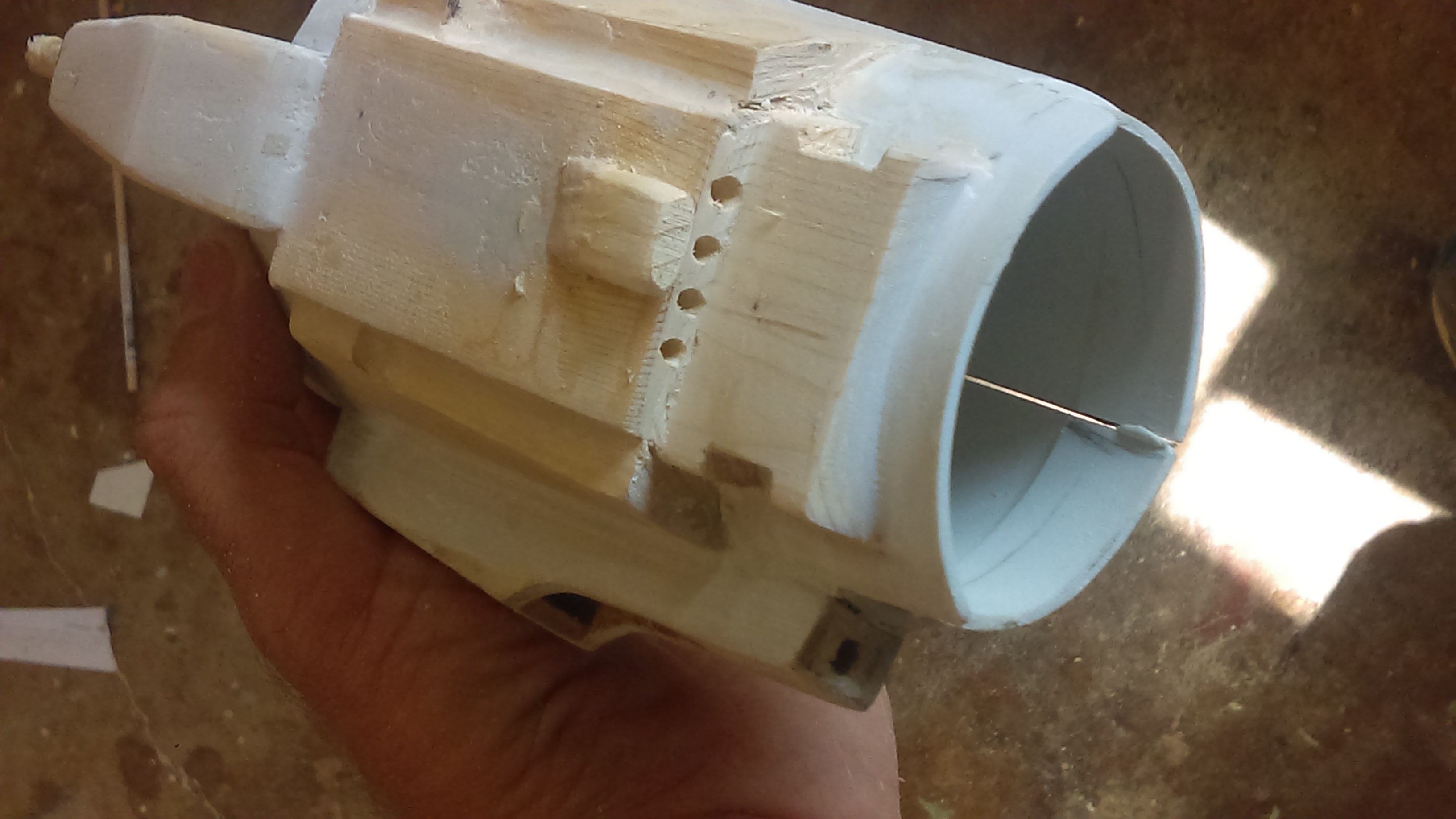

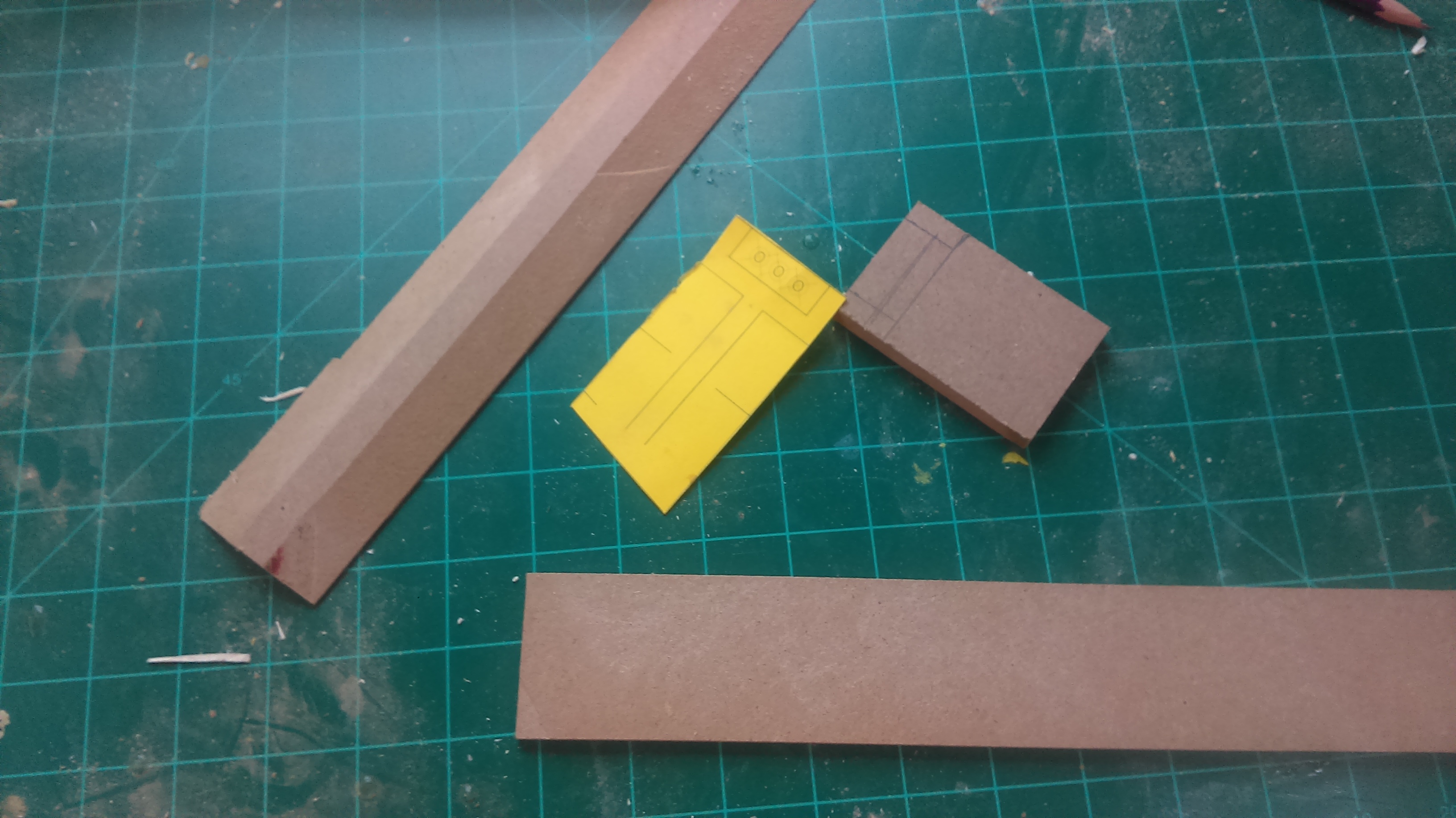

Updates, updates, update. The gauntlets are done and ready for a paint job. With the cuffs complete I started on the right one. I trued doing it with foamboard and PVC but with the scale being smaller It wasn't working out to sell so I opted for hardboard and wood. I made the curved piece at the back out of PVC. The flame thrower attachment on the side was hardboard, and the top piece I opted or using my carving skills and made it from a small piece of pine. The four holes in the front are or the little darts. Once I get it painted I'm going to glue in some pop rivet shafts for those.

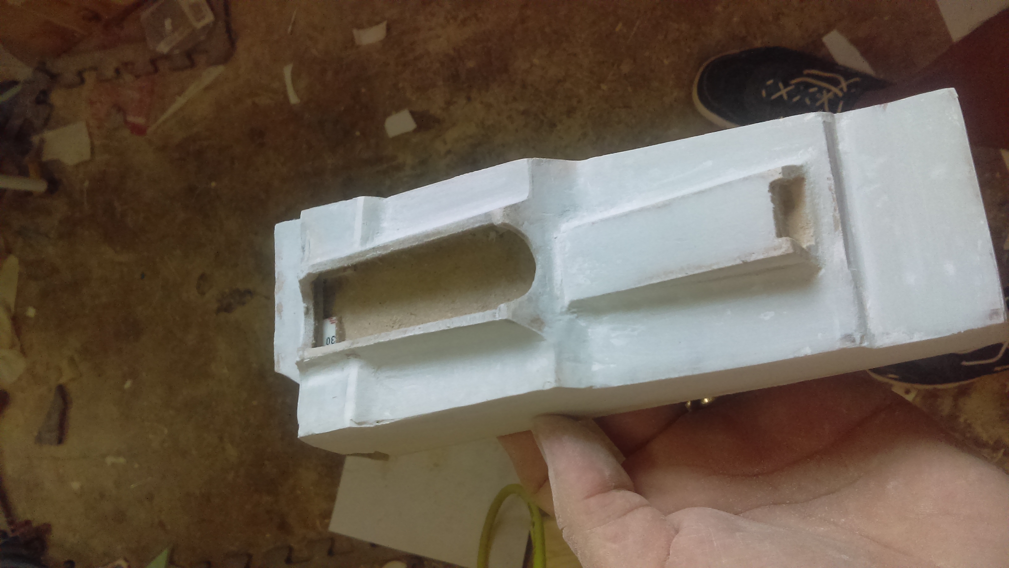

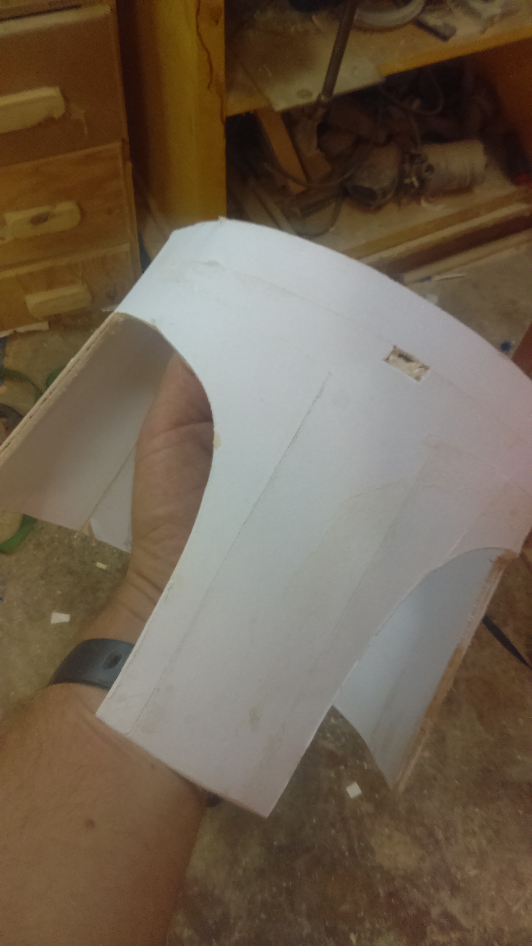

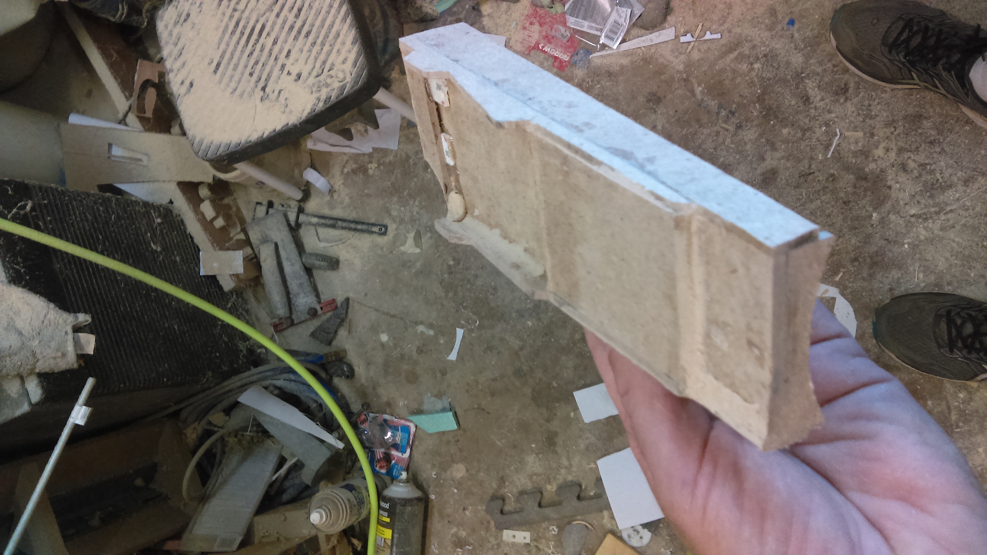

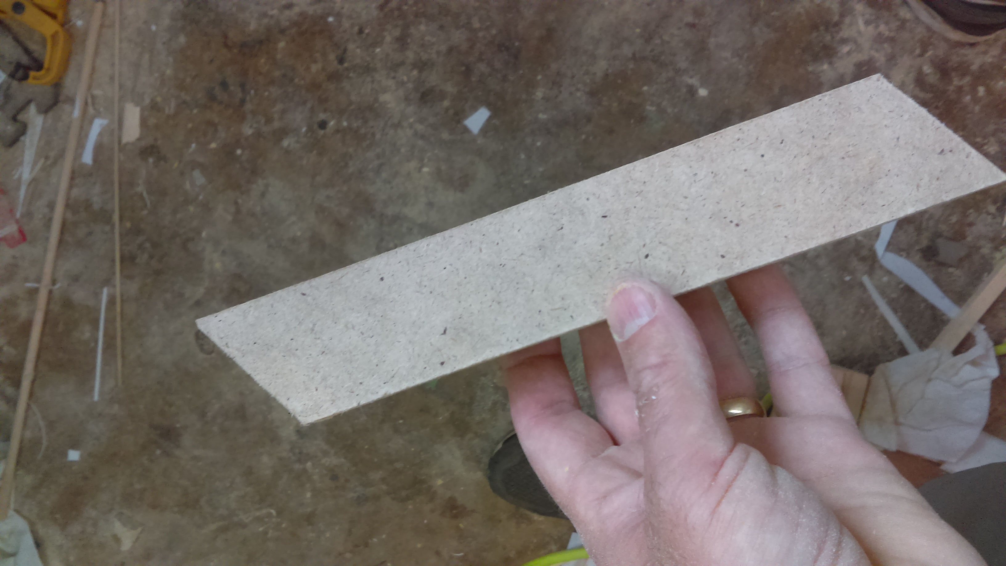

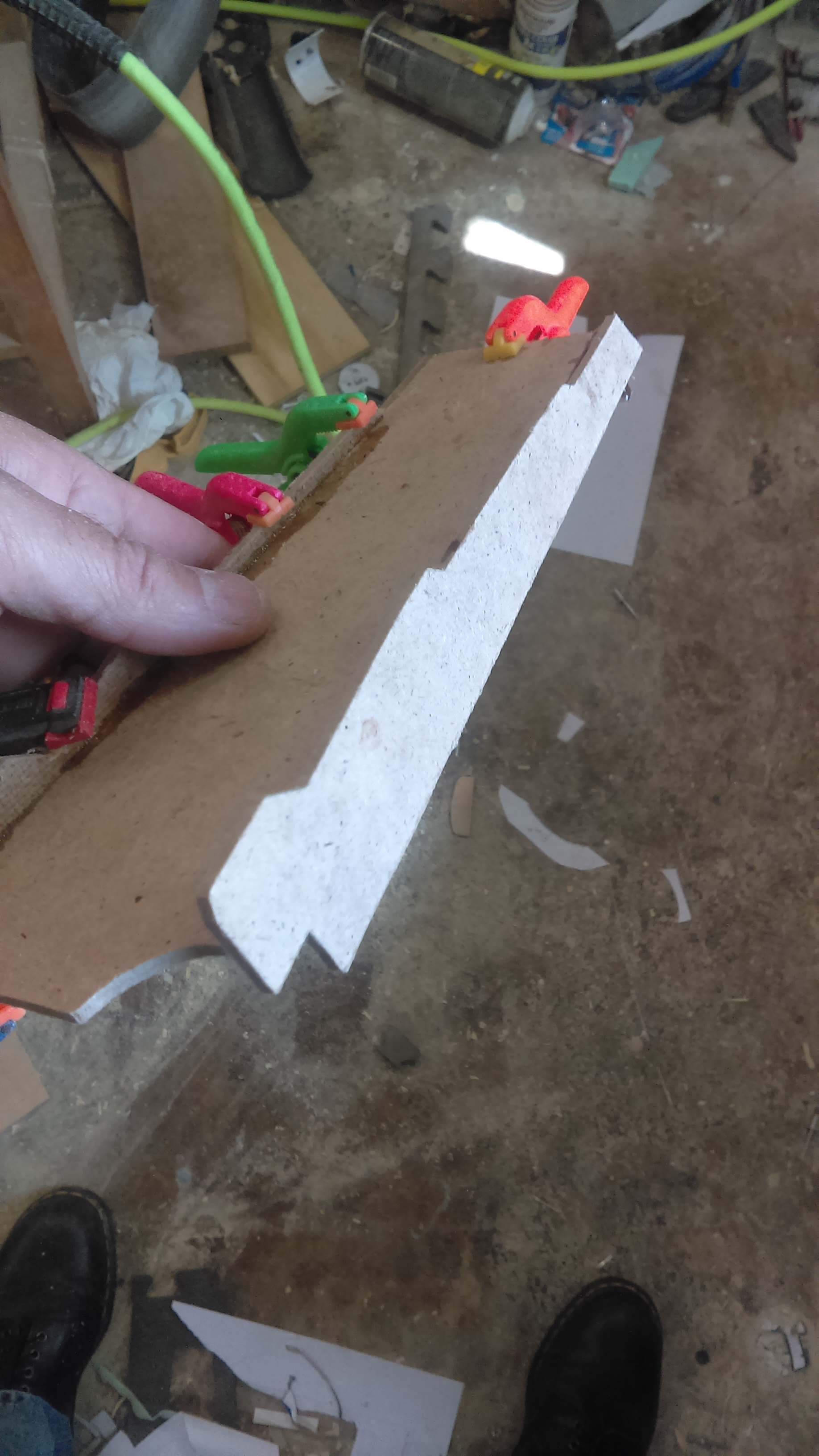

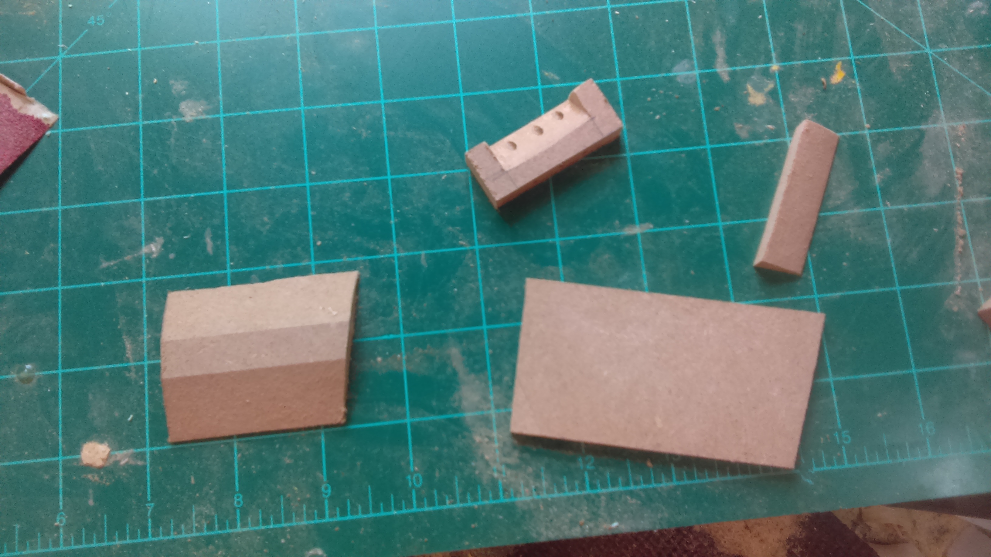

The left gauntlet was actually a bit easier. The platform and patterns from WOF when sized were easy to cut out of PVC and hardboard. I started with the base and sides. A little glue and some JB weld wood putty got things set up nicelyIMAG3452.jpg IMAG3454.jpg IMAG3455.jpg
A little more cutting on the patterns and and some filler and I'm ready to make the missile and flame thrower on the side.I coated the wholt thing with bondo and sanded it to seal the hardboard. When it comes to paining that stuff it needs to be sealed with a something like bondo or a 50/50 water/glue mix or it just soaks up paint like a sponge.IMAG3457.jpg

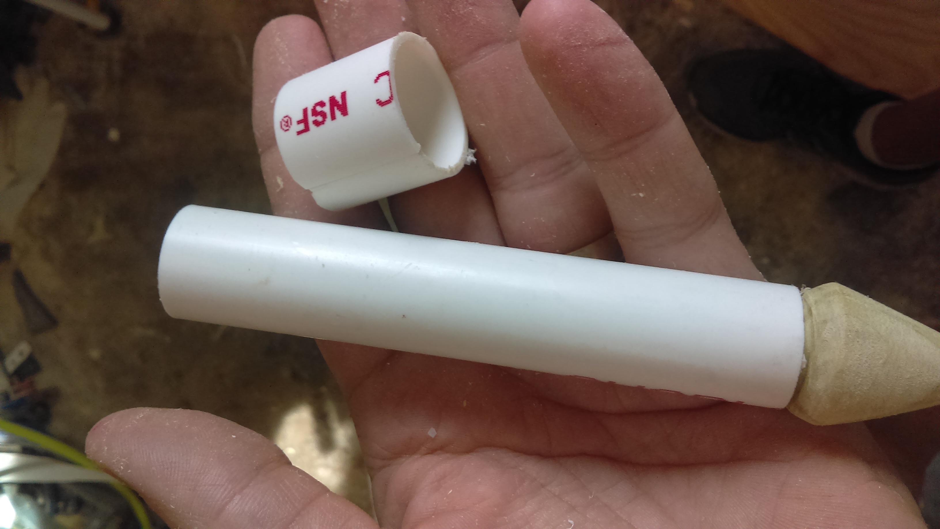

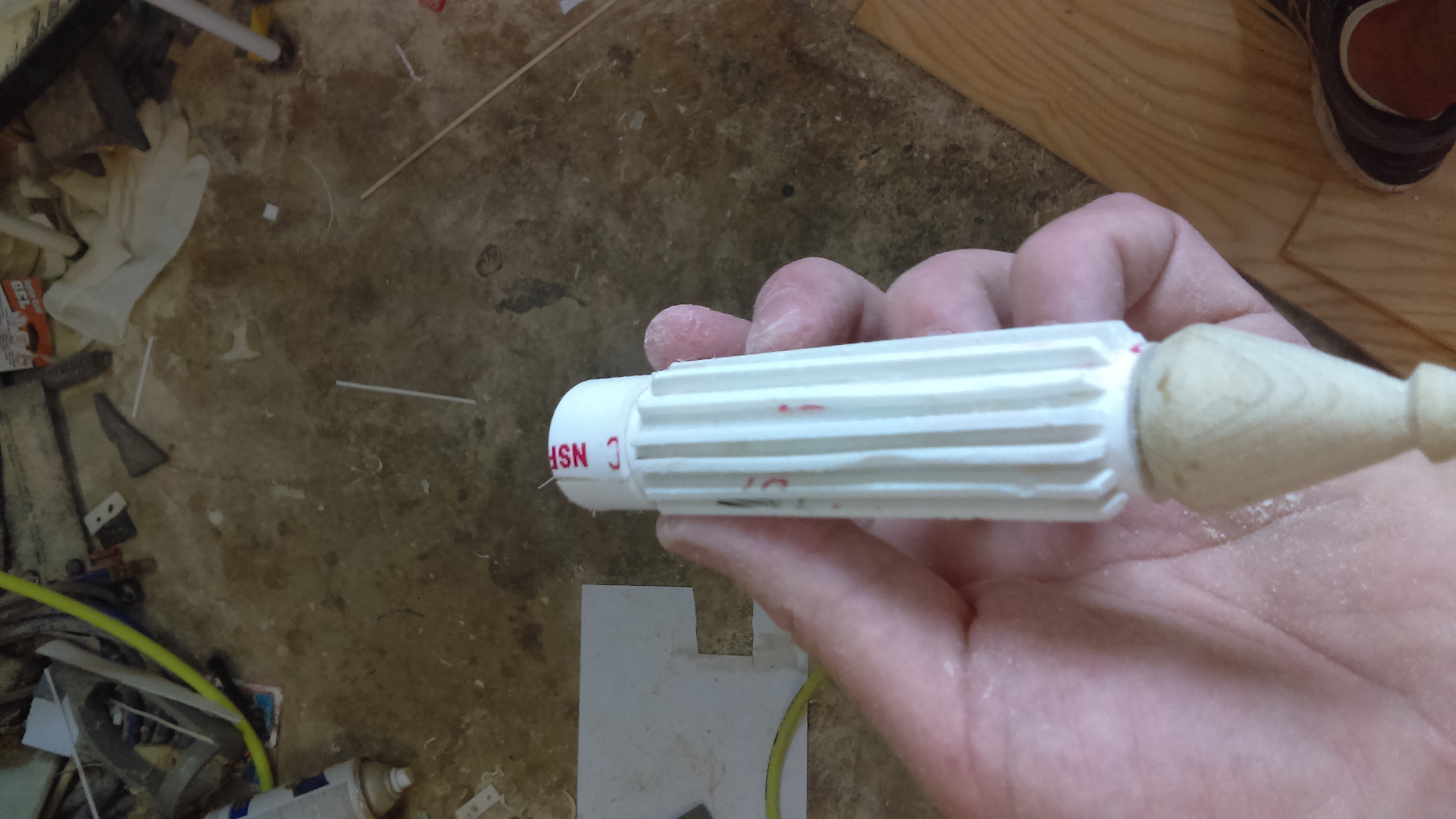

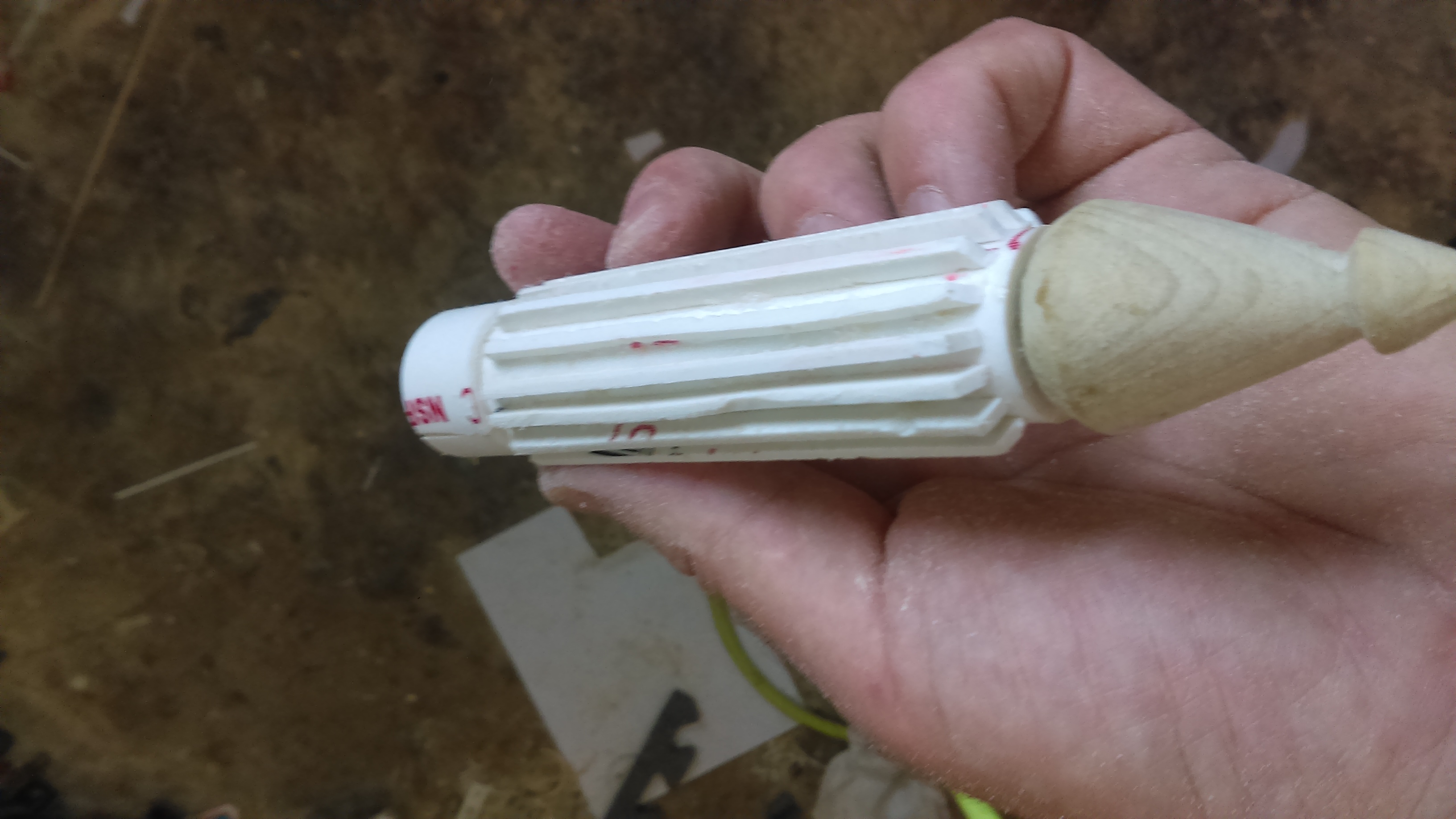

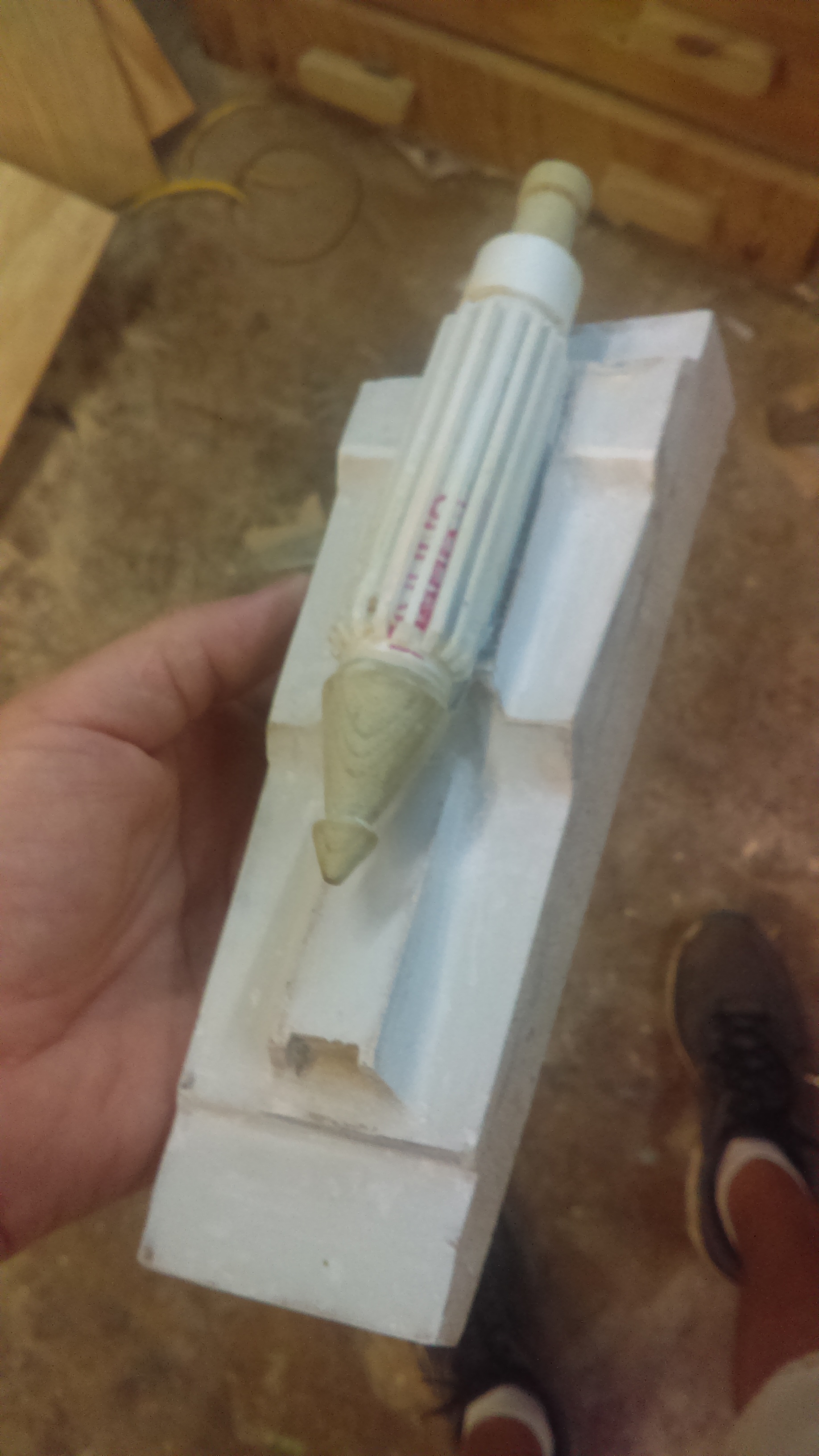

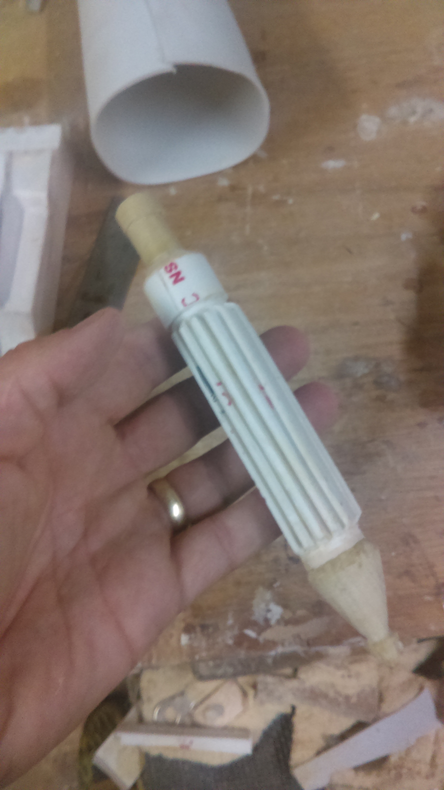

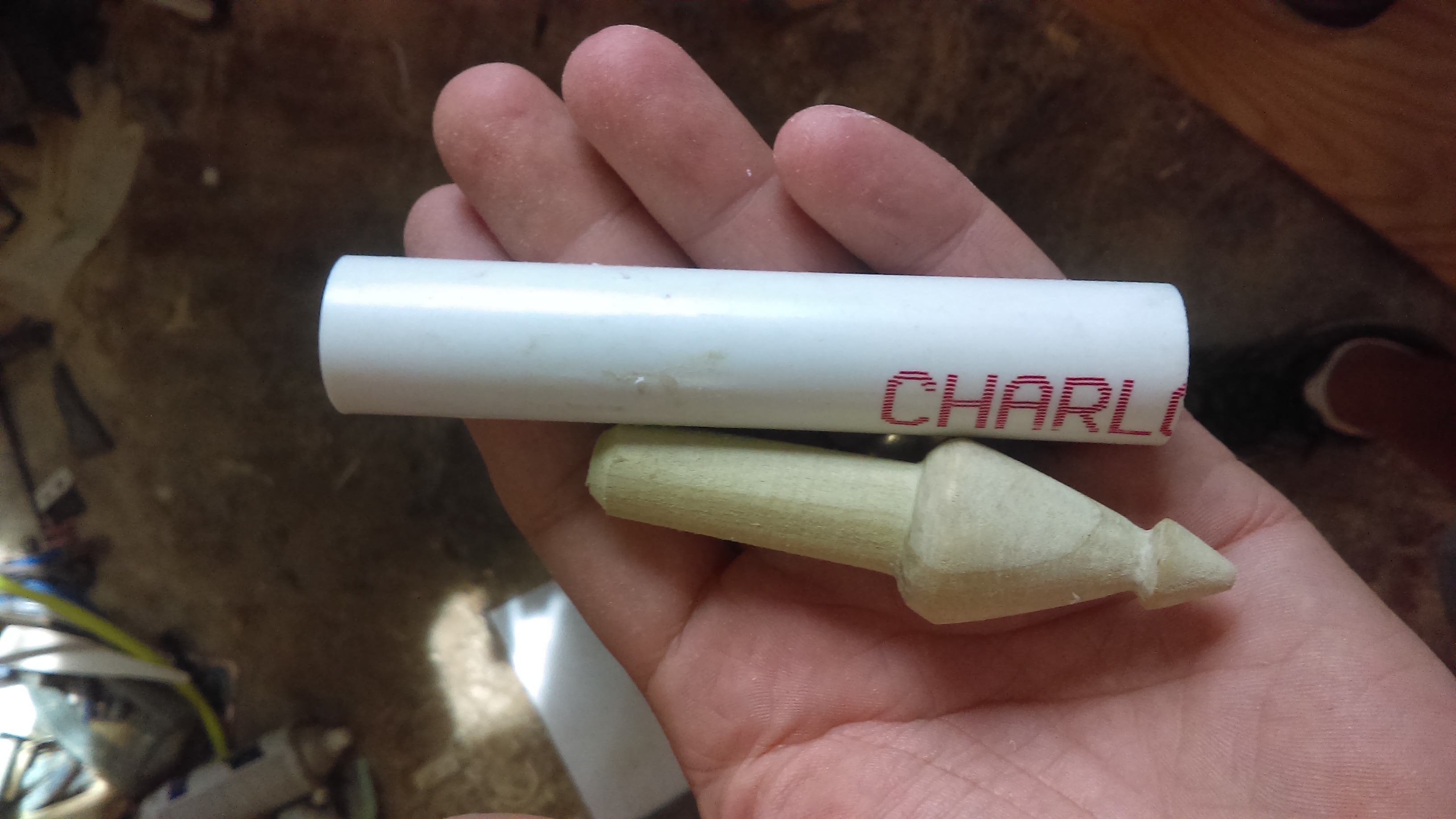

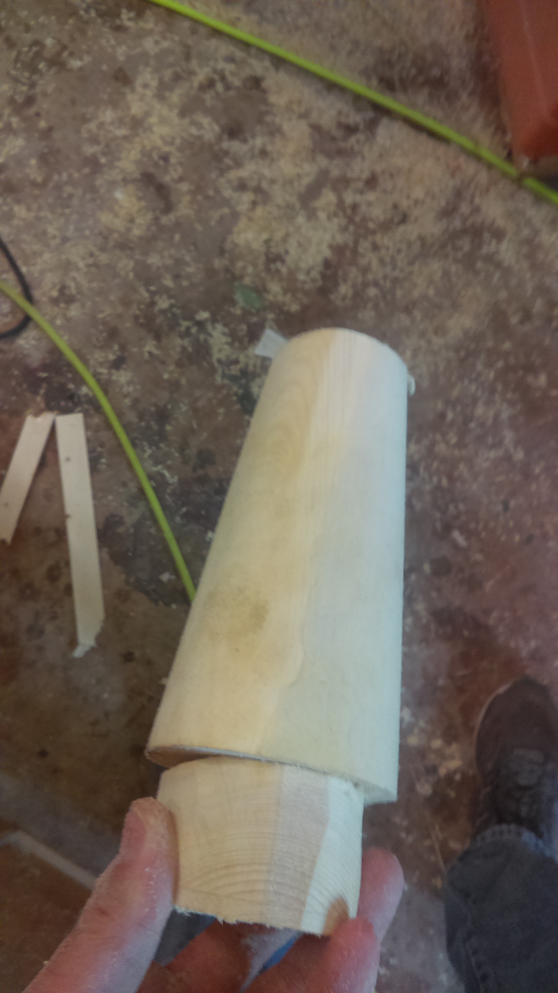

Now for the missile. I used a piece of PVC pipe the fit perfectly in the spot and cut it to size. For the tip I took a dowel and sanded it to shape on the belt sander and drill press. To make the raised section in the rear I took some thin wall PVC just a bit larger than the missile body and heated it to fit.IMAG3458.jpg IMAG3459.jpg IMAG3460.jpg
To make the fins I cut some thin strips of flattened thin wall PVC, cut them to length and glued them around part of the circumference of the missile. I wasn't sure if they went all the way around because of the way it sits in the cradle on the gauntlet. All the screen pics I found or other source material didn't say So I just went with what could be seen.IMAG3461.jpg IMAG3462.jpg

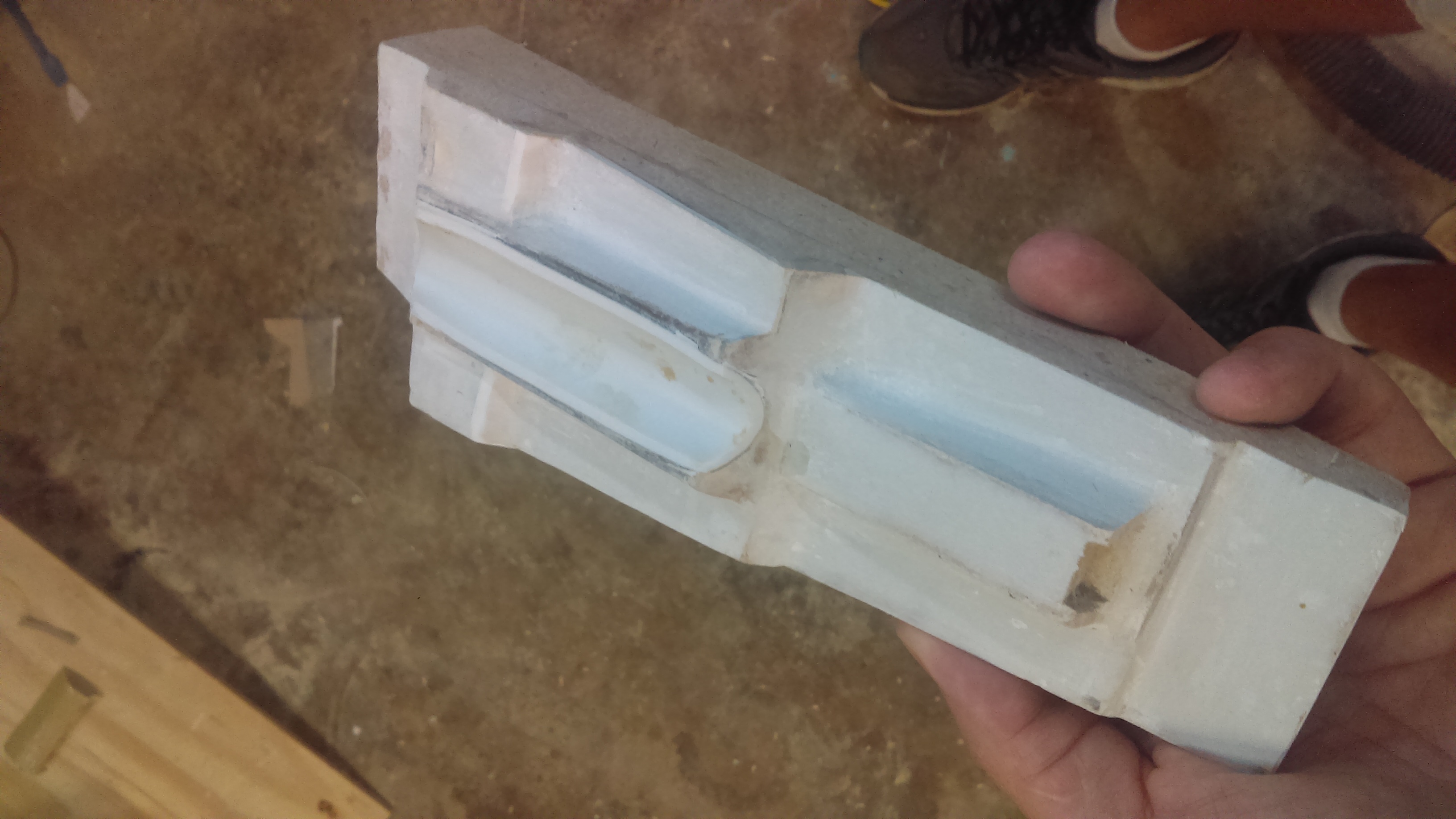

To make the cradle on the gauntlet I took another piece of thin wall PVC, heated it up and used the missile to mold it right in place and then glued it up.

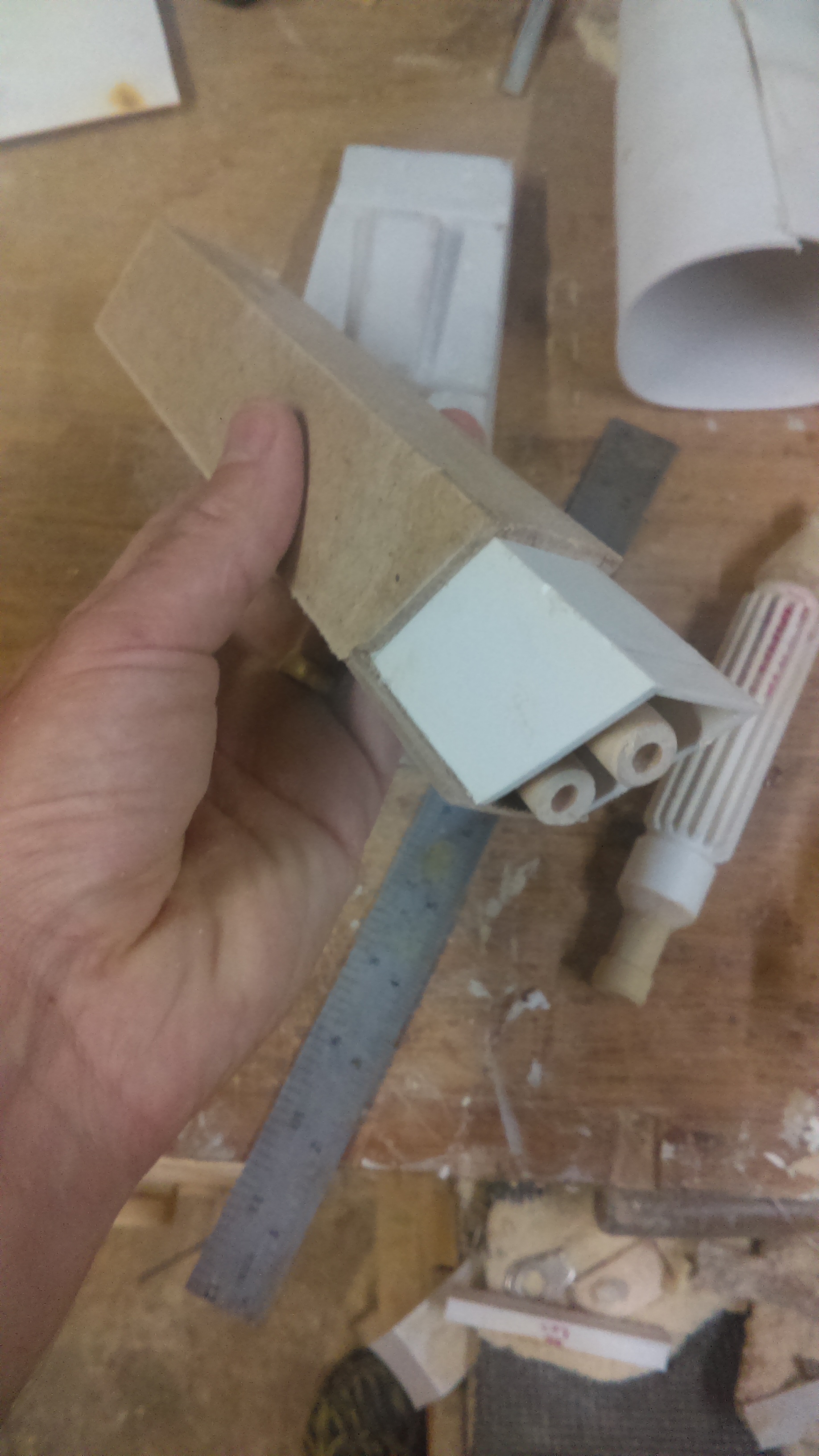

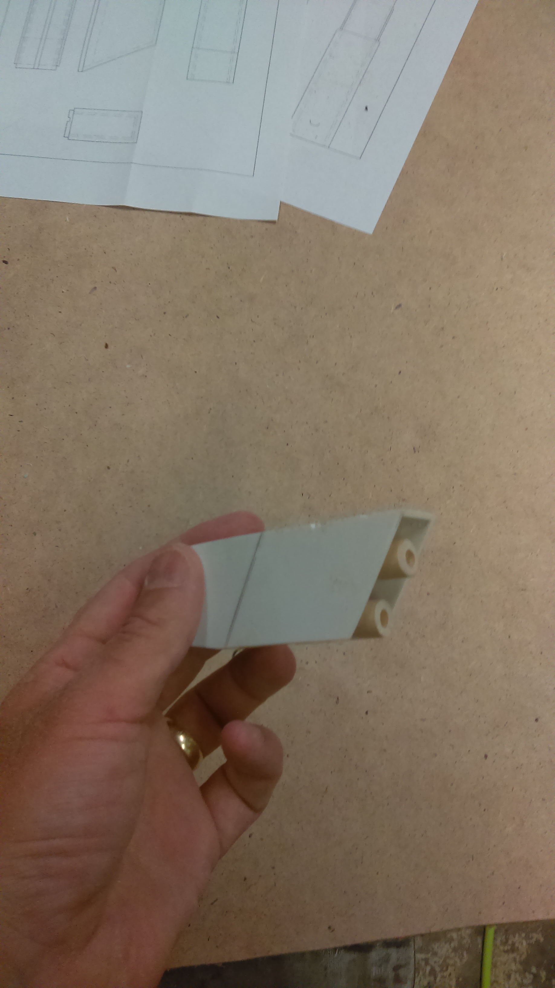

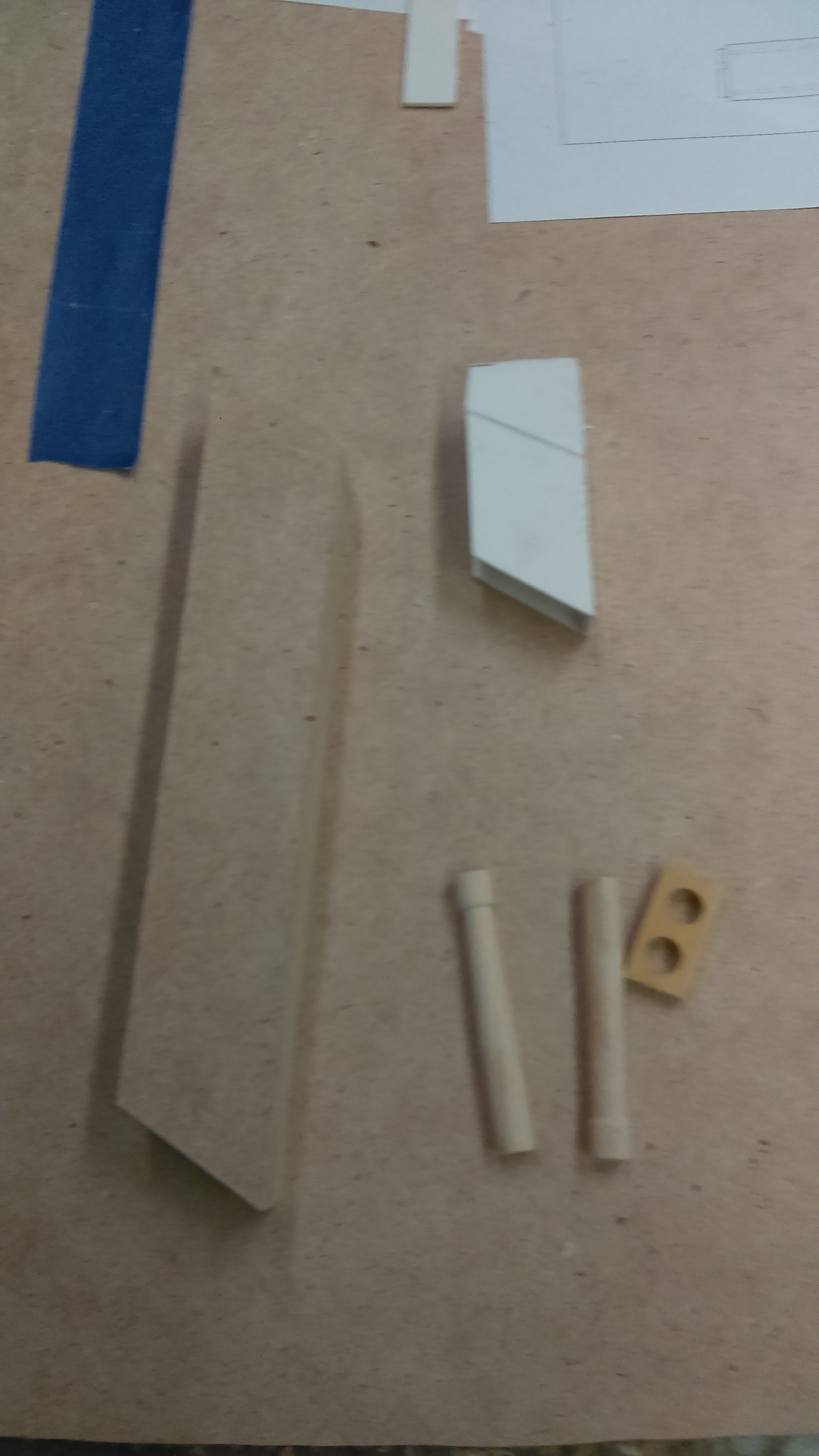

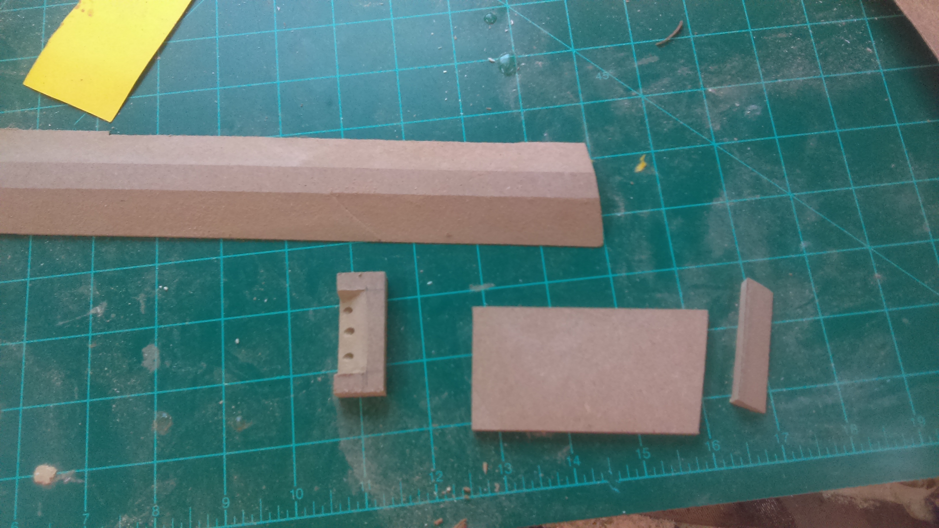

The flamethrower box was pretty straightforward. Some PVC and hardboard for the basic box and insert.IMAG3463.jpg

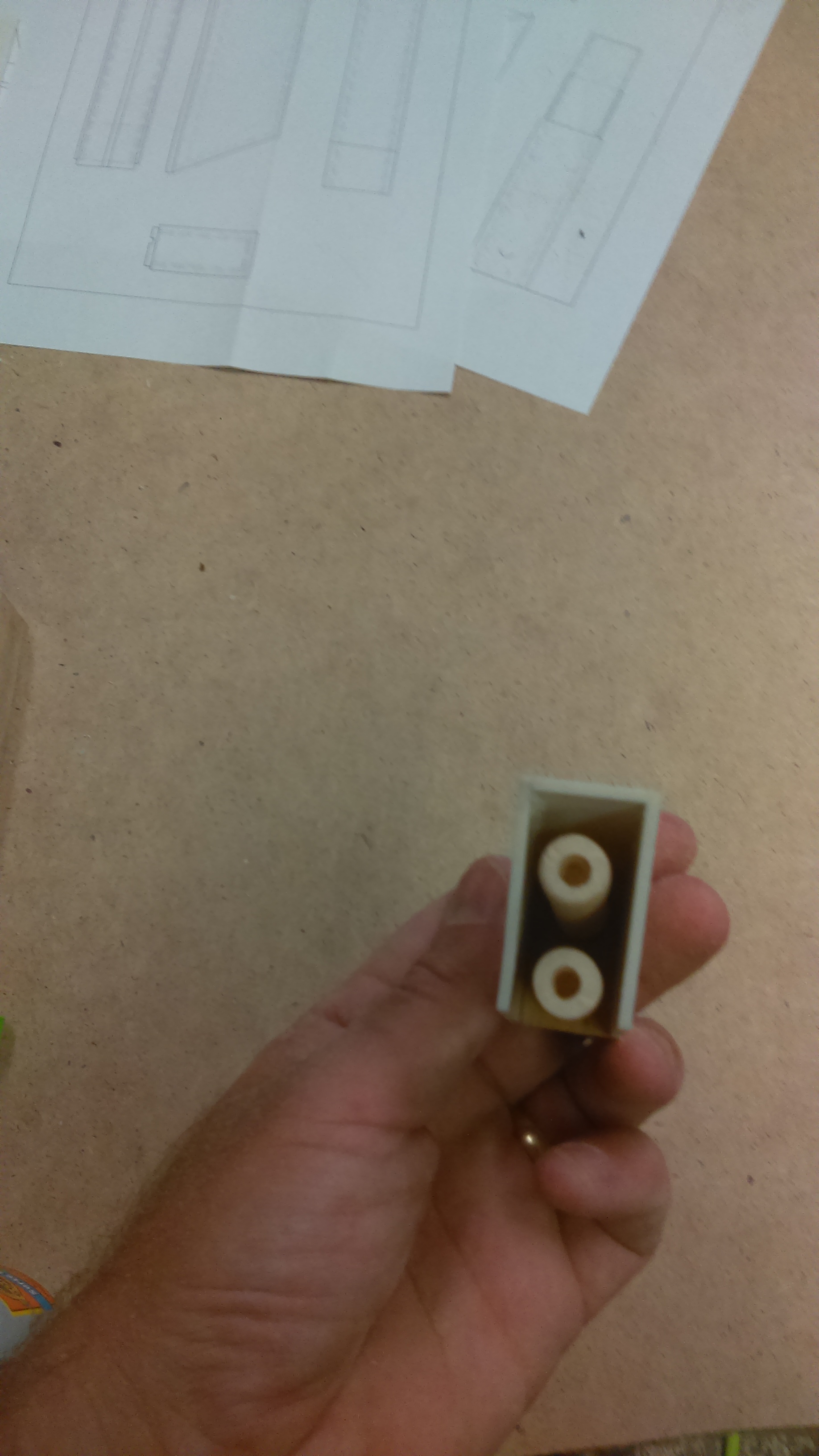

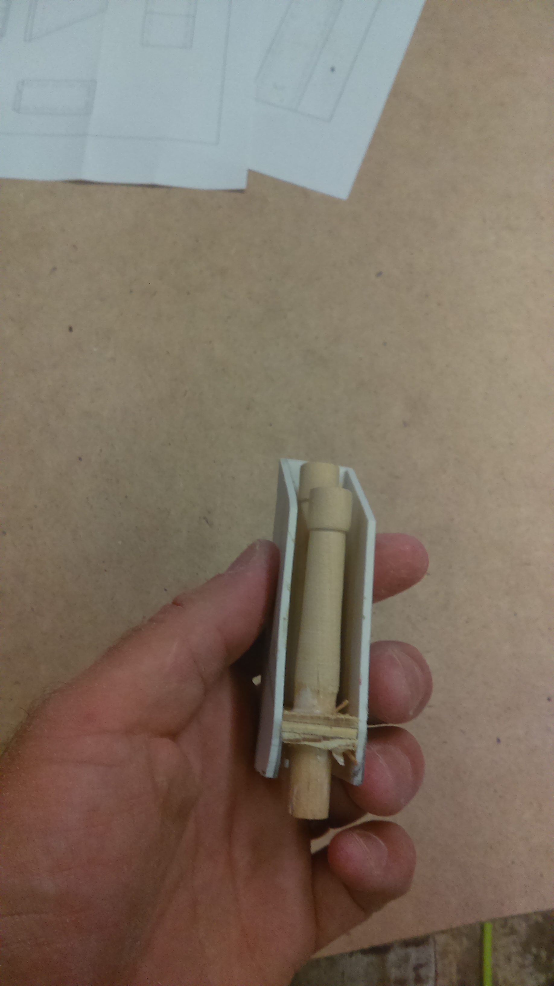

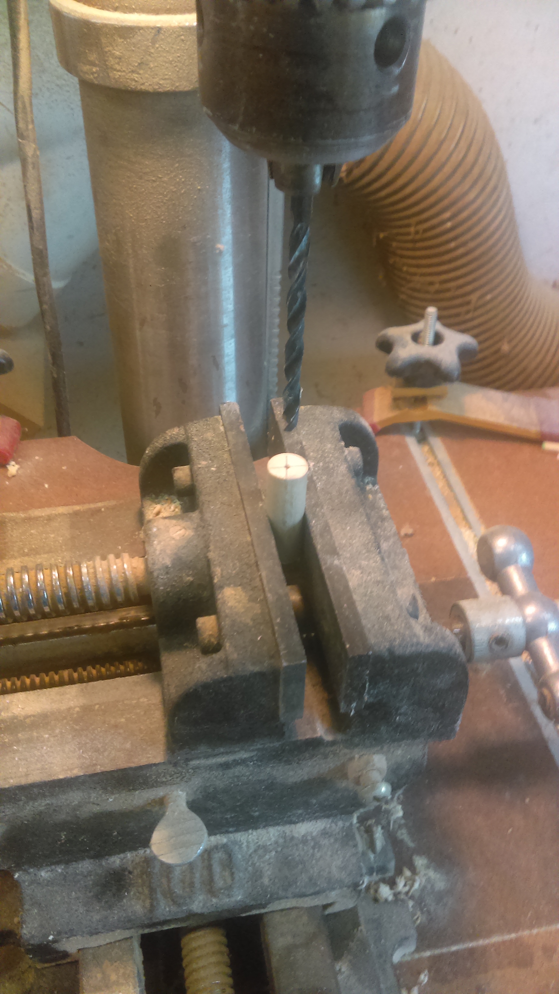

I made the nozzles out of dowel that I sanded down to get the right shape. They will go in the piece of plywood with the two holes. And that in turn will go in the PVC sleeve.IMAG3465.jpg Here's the finished sleeve. IMAG3466.jpg IMAG3467.jpg IMAG3468.jpg

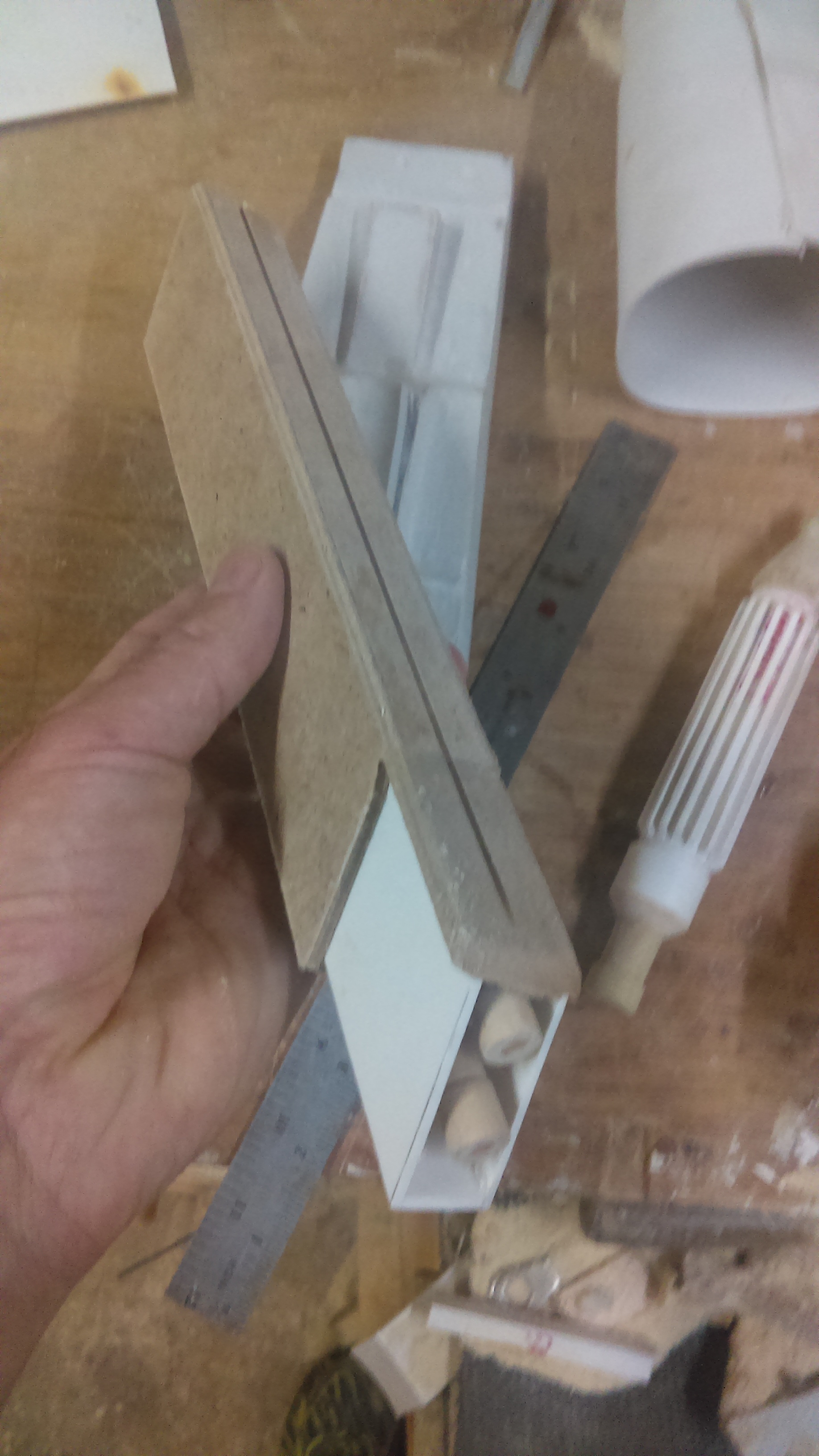

And there's the finished assembly. I got the grooves int he bottom on the table saw. Just set the blade to peek out on the table and ran the box through .IMAG3471.jpg IMAG3470.jpg

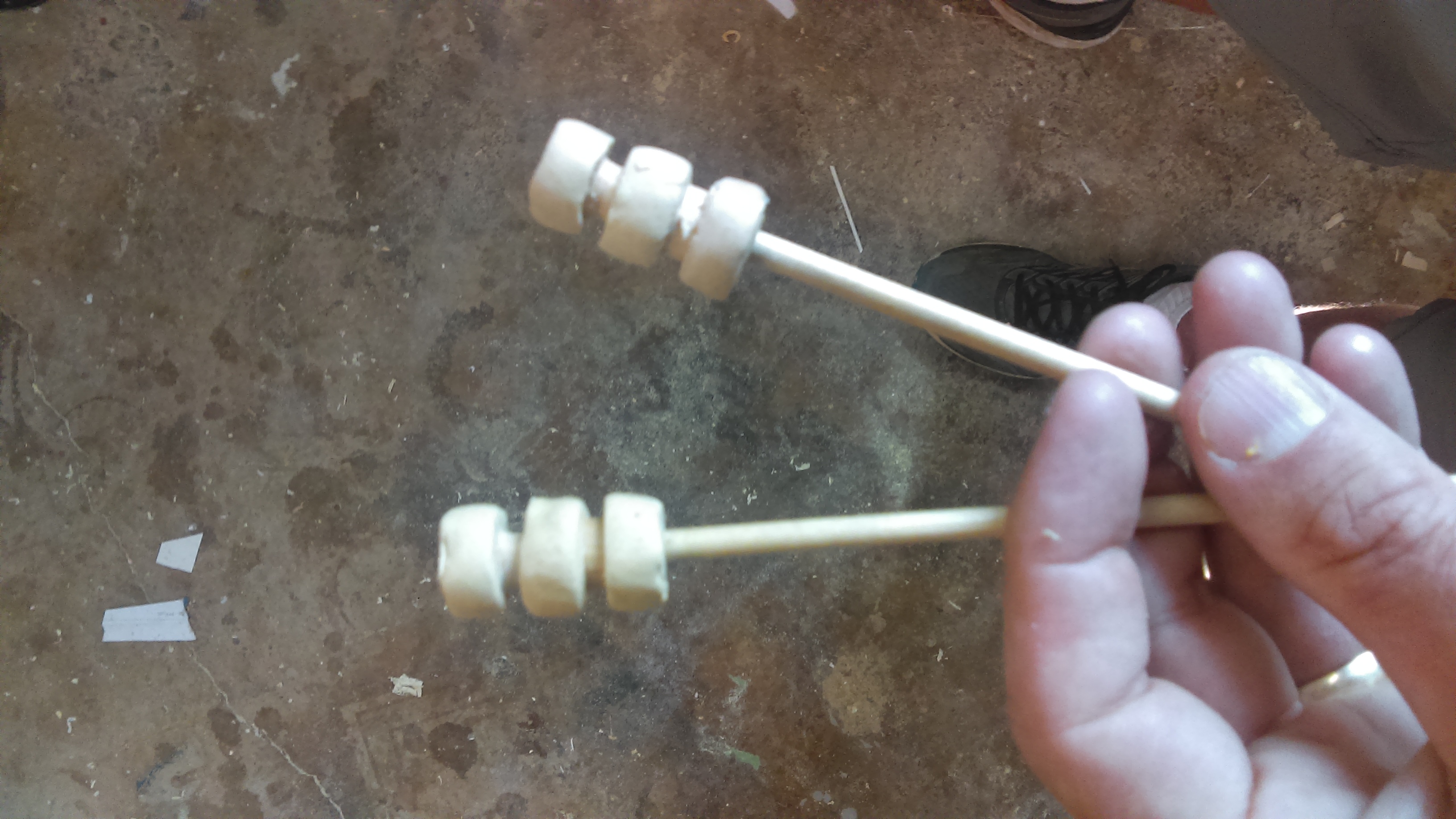

Almost forgot the two nozzles on the right gauntlet. I made them from two different sized dowels and a little JB Weld wood putty. I shaped the putty to roughly look like the nuts on the ends of the nozzles. When it dries I'll sand them to a better shape. I'll paint these before gluing them into place too.IMAG3479.jpg IMAG3478.jpg

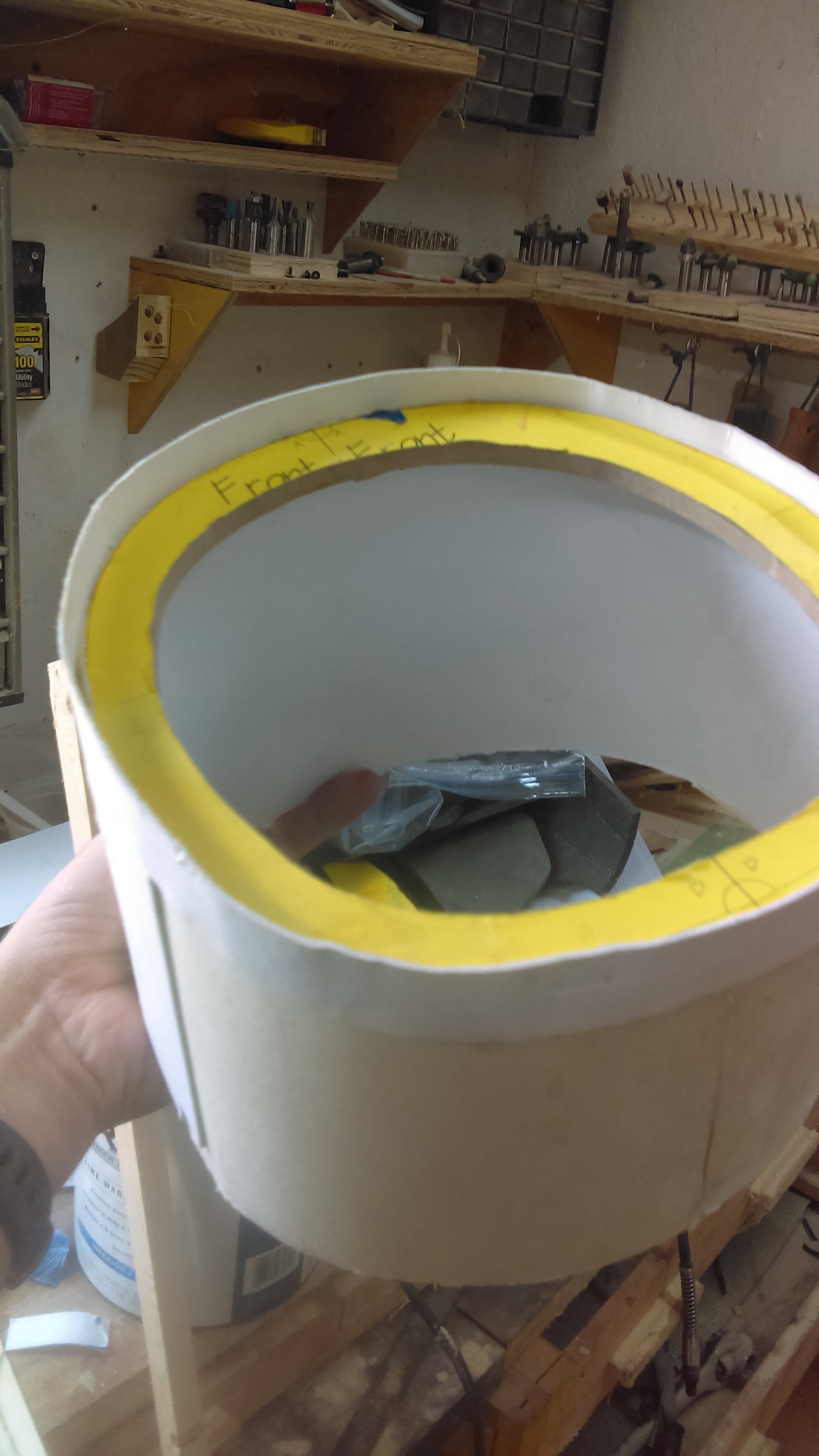

Now I'm onto the brain bucket. Trial and error got me to a size that fit my kids head and he could see out of.Man does it look big on his head. Here's the dome base ring with a cardboard mock up to check fit and sight before I go further. Success!

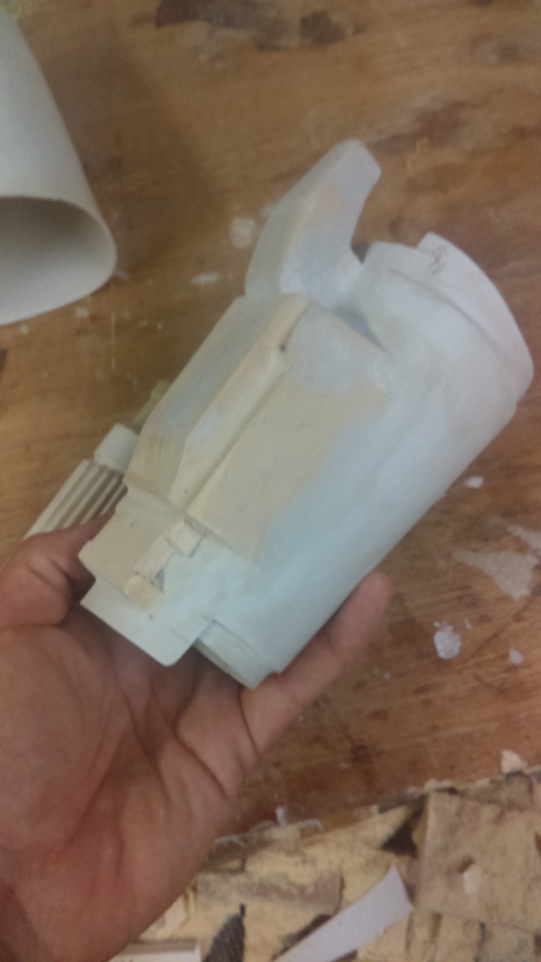

I got the gauntlets completed. A little bondo on them and they were ready to paint.

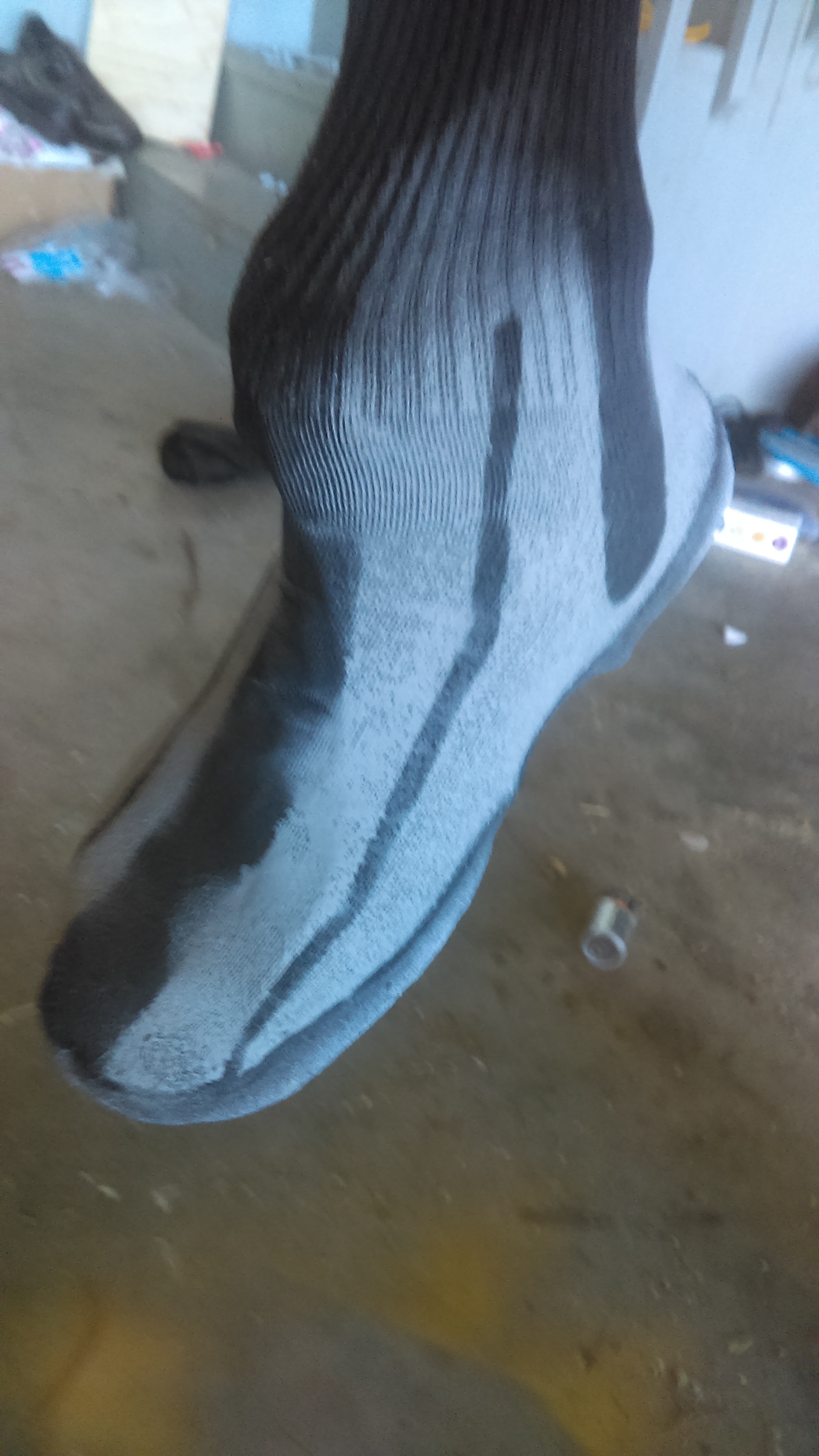

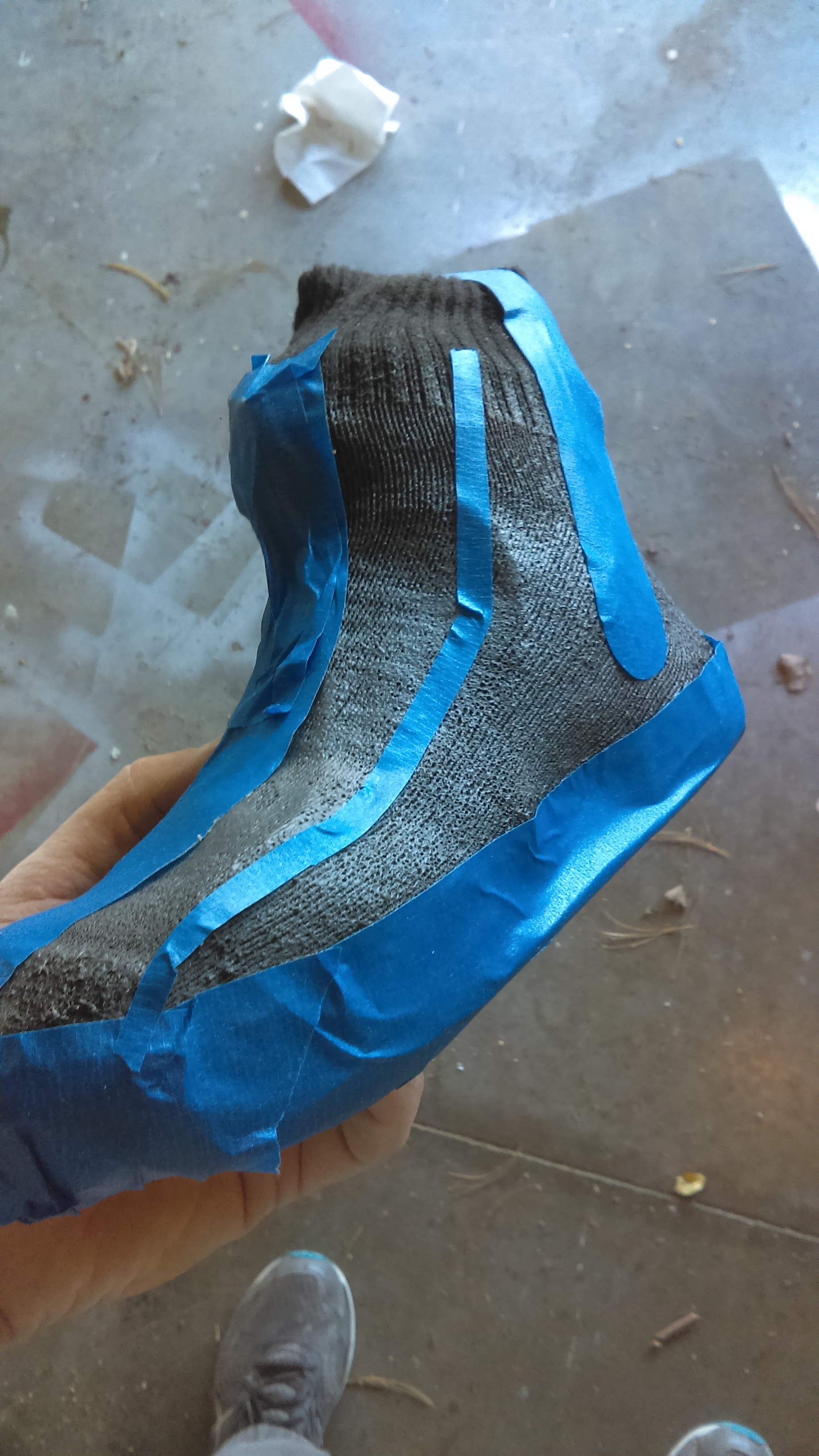

Once those were complete I moved on to the boots. Since this is a costume on the cheap I decided to take an old pair of socks and slip his boots into ziplock bags and then into the socks. I sprayed a couple of coats of grey and smoke plasti-dip on them for a base/sealer. Once that was done I masked it the best I could and hit it with a combination of white and gray spray paint to get close to the colors i needed. The one thing I didn't get a chance to do was get the two foot spikes in the toe.
Now all he has to do is slip his boots on and then pull these over it and he's got a pretty good approximation of Fett's boots.

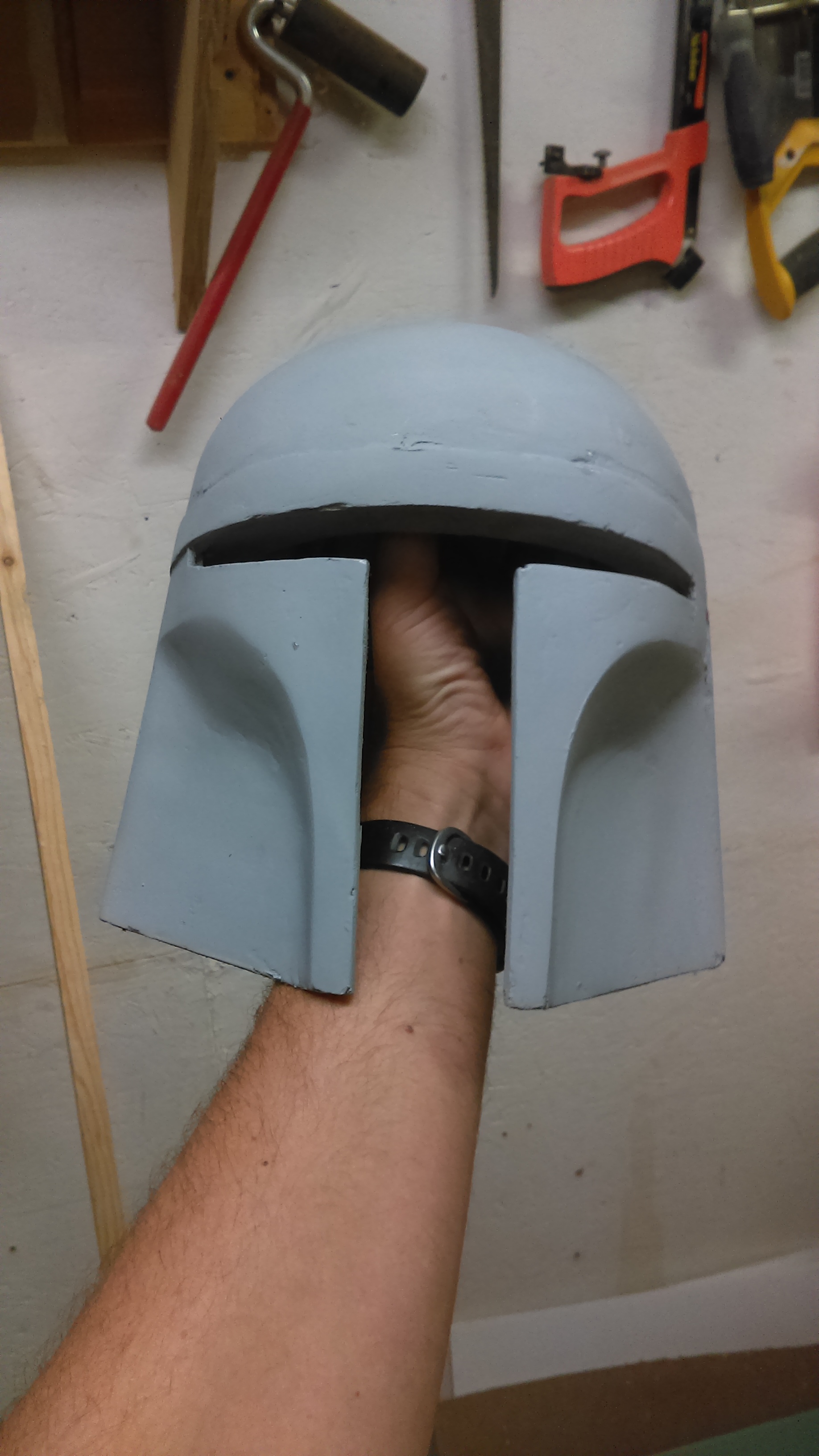

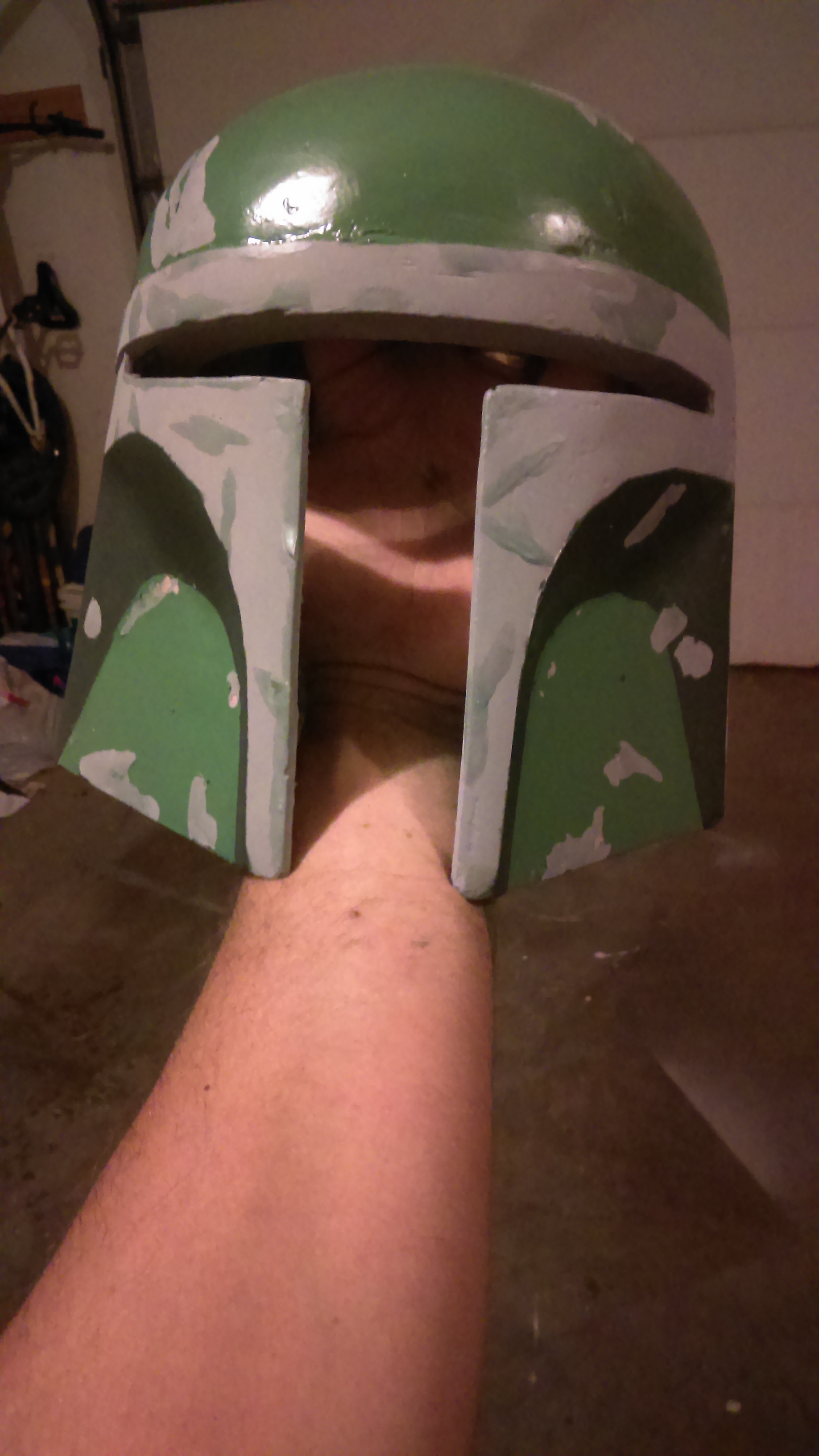

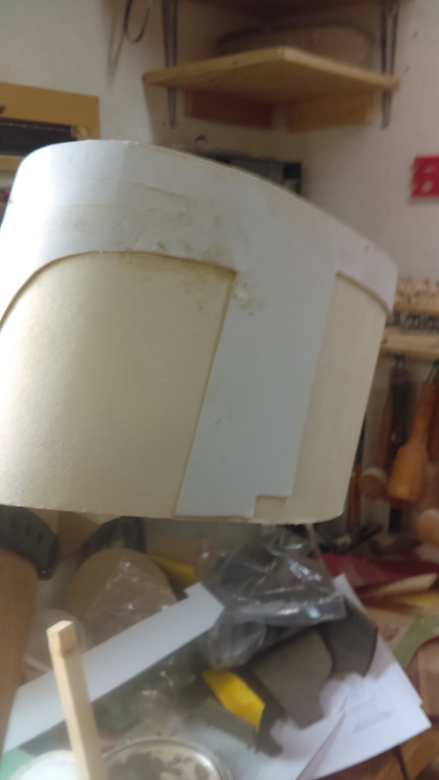

Next up the helmet. I used WOF's patterns and Antman's cardboard tutorial for building it. One thing I found beneficial was to use 1/4" MDF for the inner ring and dome supports, gives more surface area to glue to. The other thing I did, but forgot to get a pic of it, was to reinforce the top of the dome where the cross members come together. I glued wood blocks in each quadrant at the top and sanded them to shape to give me more surface to glue the dome pieces to at the top.
