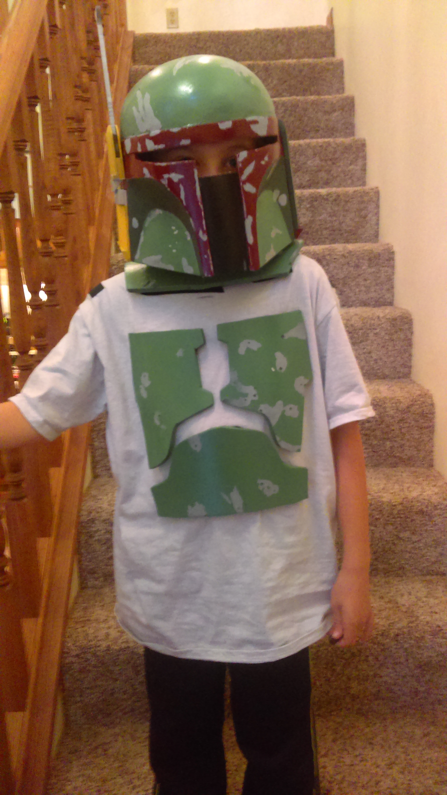

Here he is with some of the armor on him and the helmet with it's paint job. For the visor area I went with a piece of PVC molded to the mask and painted gloss black. I was going to put some stretched fishnet stocking cross the top so he could see out of it but after a test fit he decided to go with it open so he could see better since we'll be doing all the trick or treat events at night/dusk. It still looks bad ass for a first try.
The armor I made from 3/8" foam exercise mat that I had in the shop. I cut it to shape using WOF's plans and then molded them with a heat gun.
To paint them I sealed them with some plasti-dip and then put a top coat of rustoleum spray paint

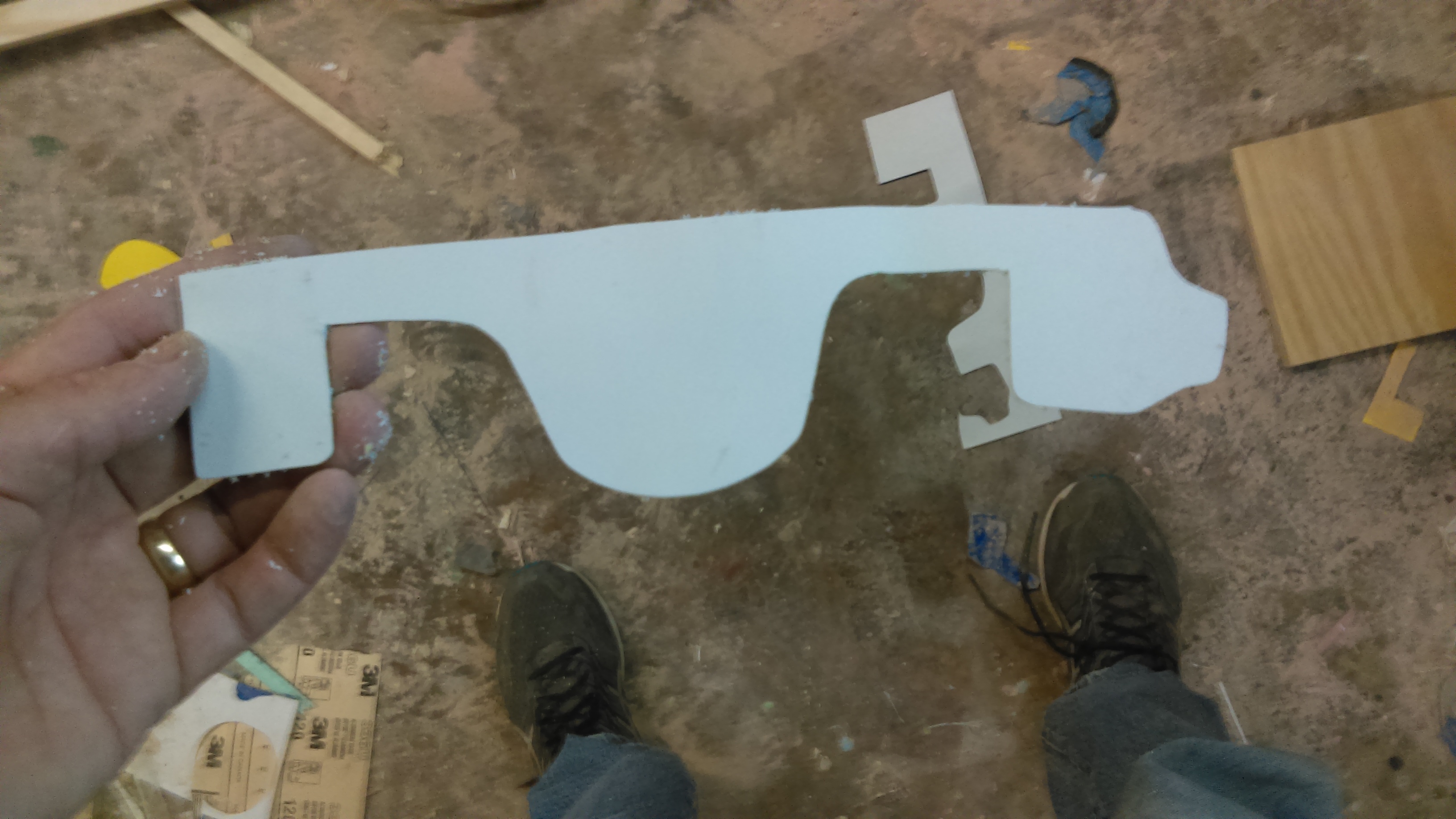

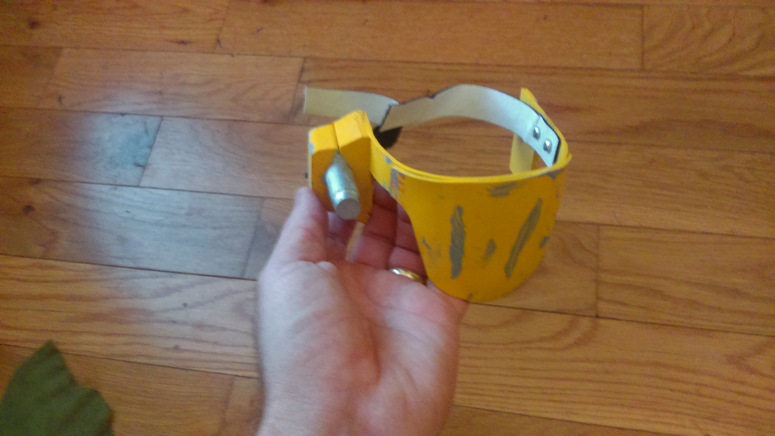

I got lucky with the knee pads. I had my son stand up and I cut a cardboard template that I fit around his knees. Kept cutting away until I had a good fit while he was wearing the pants for the costume. Then I measured that perimeter and made a form from 2x4 scrap to fit that shape.IMAG3599.jpg
Thin wall PVC is pretty forgiving so when it's formed if it's still a bit wide it will bend and cinch tight with velcro straps for mounting. They looked big when I finished them but when he tried them on after school they fit perfectly.

More pics. Here's the quickie knee pads I did.

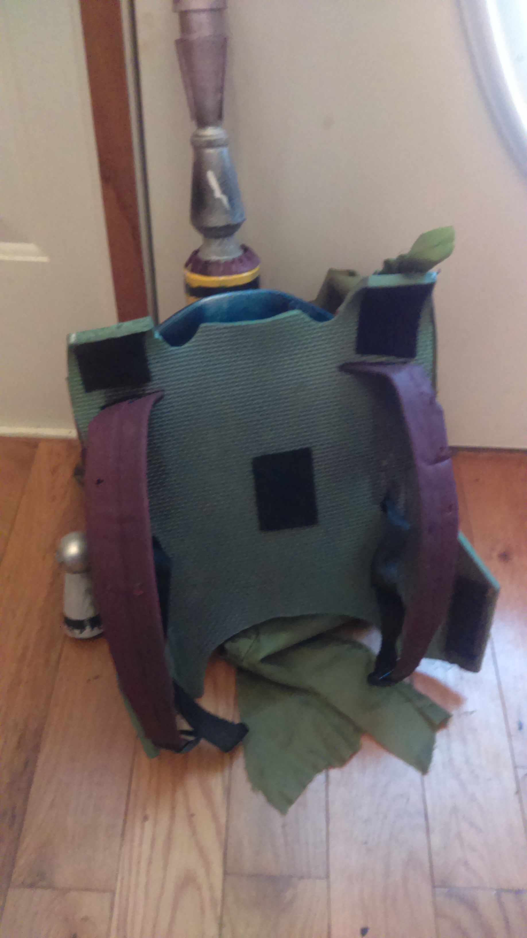

Another pic of the jet pack and the back. I used an old backpack for the straps and they are bolted to his pack. There are slits in the grey short sleeve shirt so I can hide the straps under it. The cape is a sack for an old camp chair that dies a few weeks ago. Fortuitous for me. It's pretty close to the right color. So I velcroed it to the back armor.

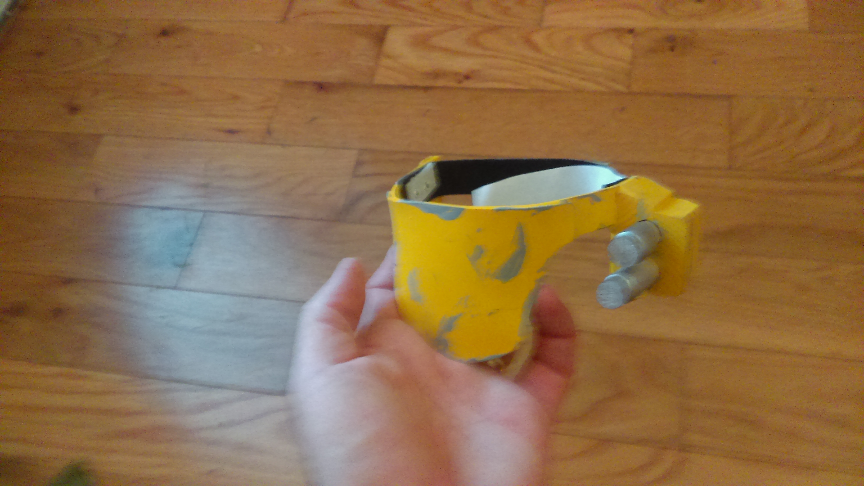

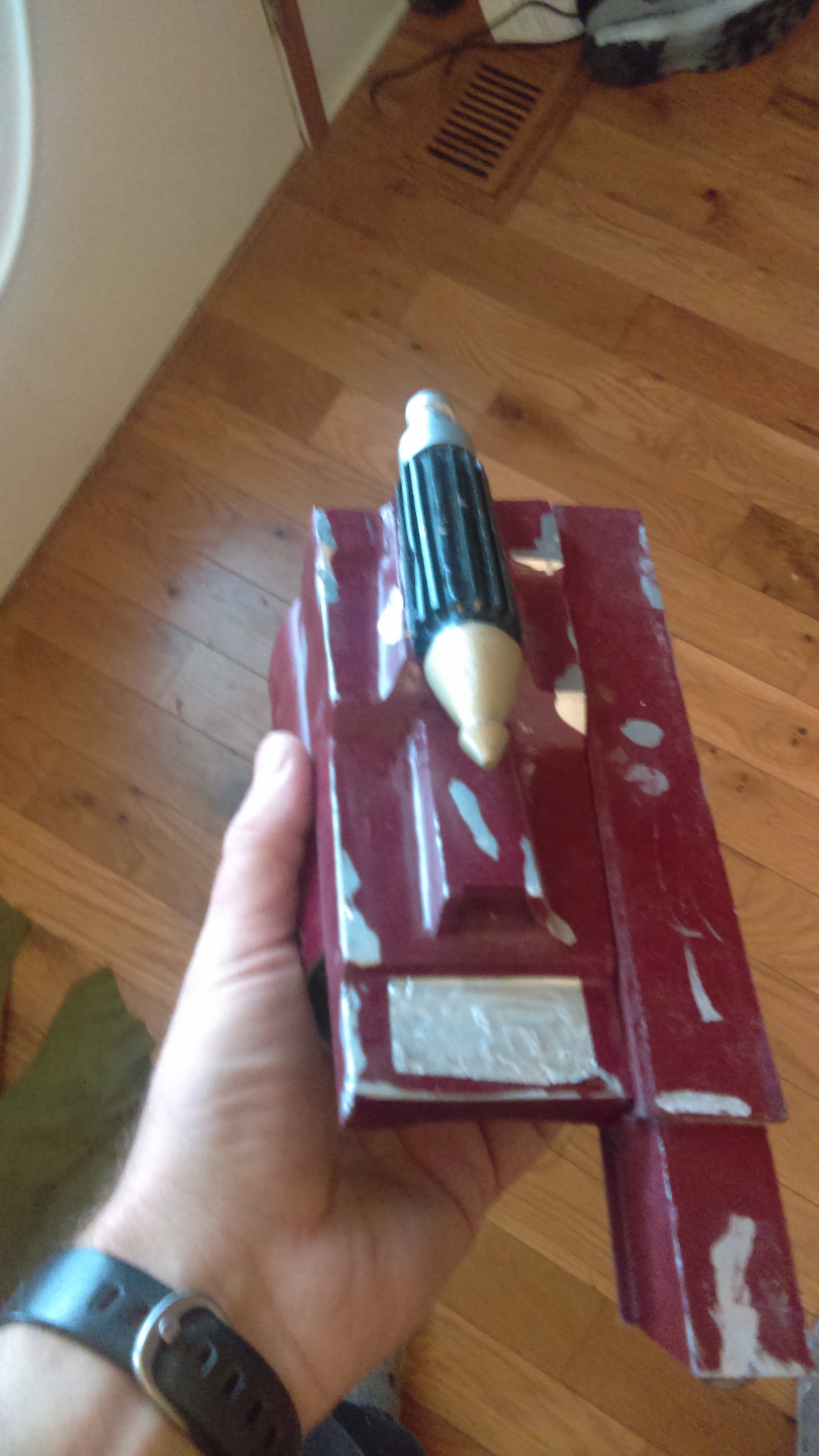

Here's the gauntlets. These turned out great. Wood, MDF, PVC, and JB Weld for wood. The darts are rivets that I cut off and superglued into holes. Unortunatley I didn't have a remote to butcher for the keypad so I faked it with some tinfoil.

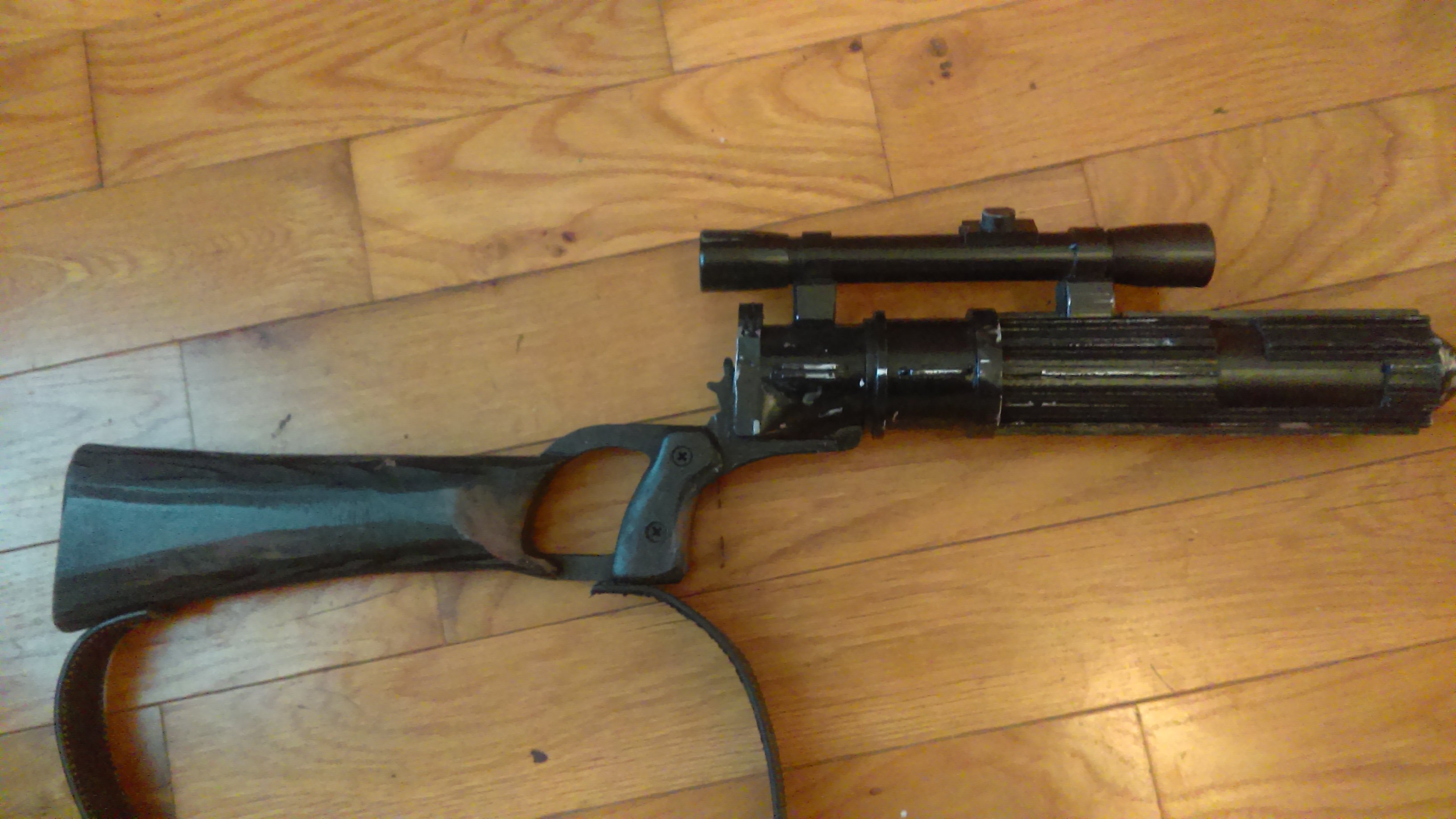

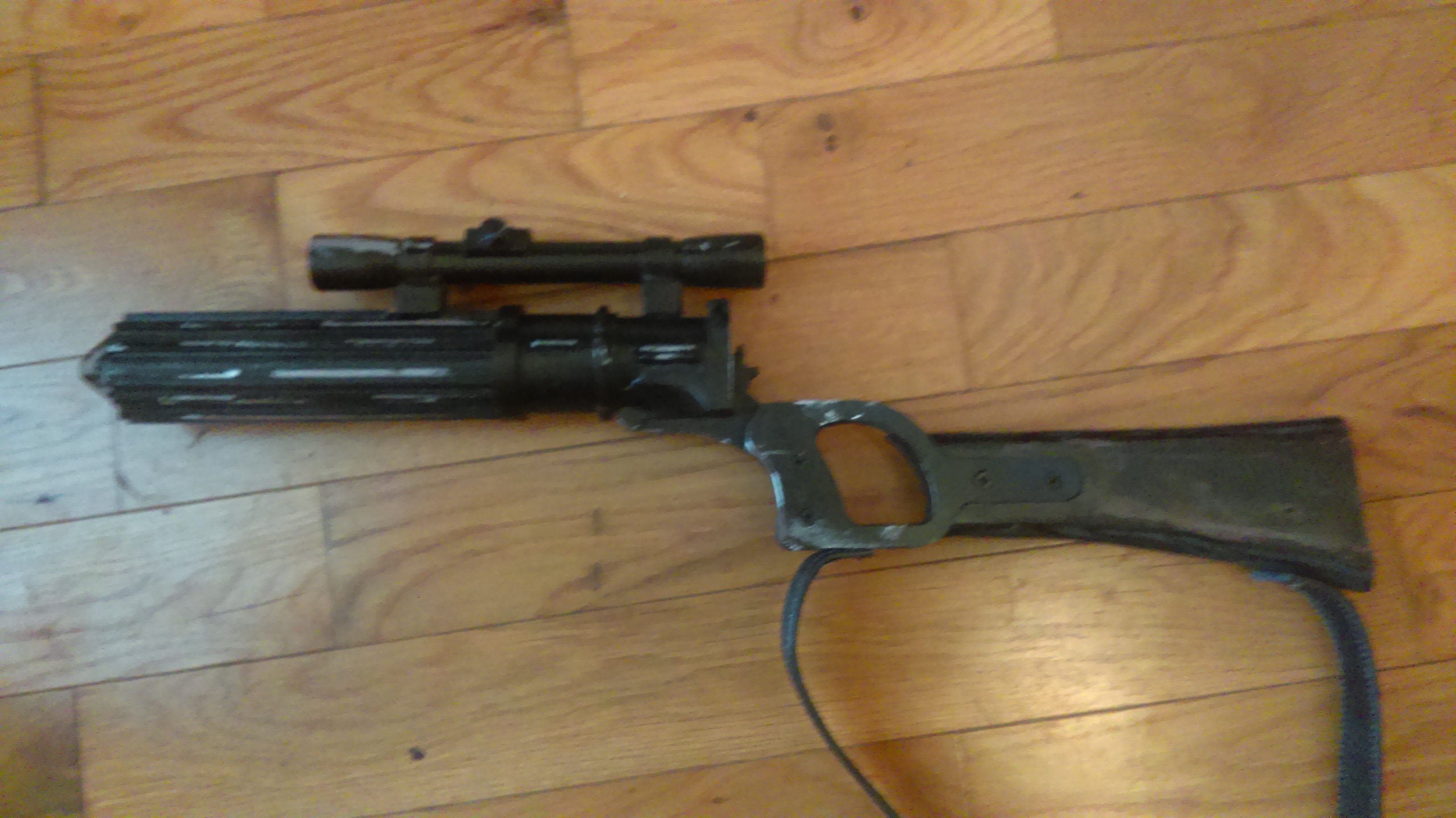

And finally the blaster. This thing turned out great. I showed it to a buddy of mine who is a cosplayer, has a couple of Jedi Temple Knight outfits (that are awesome) and does custom leatherwork for other cosplayers and he loved it.

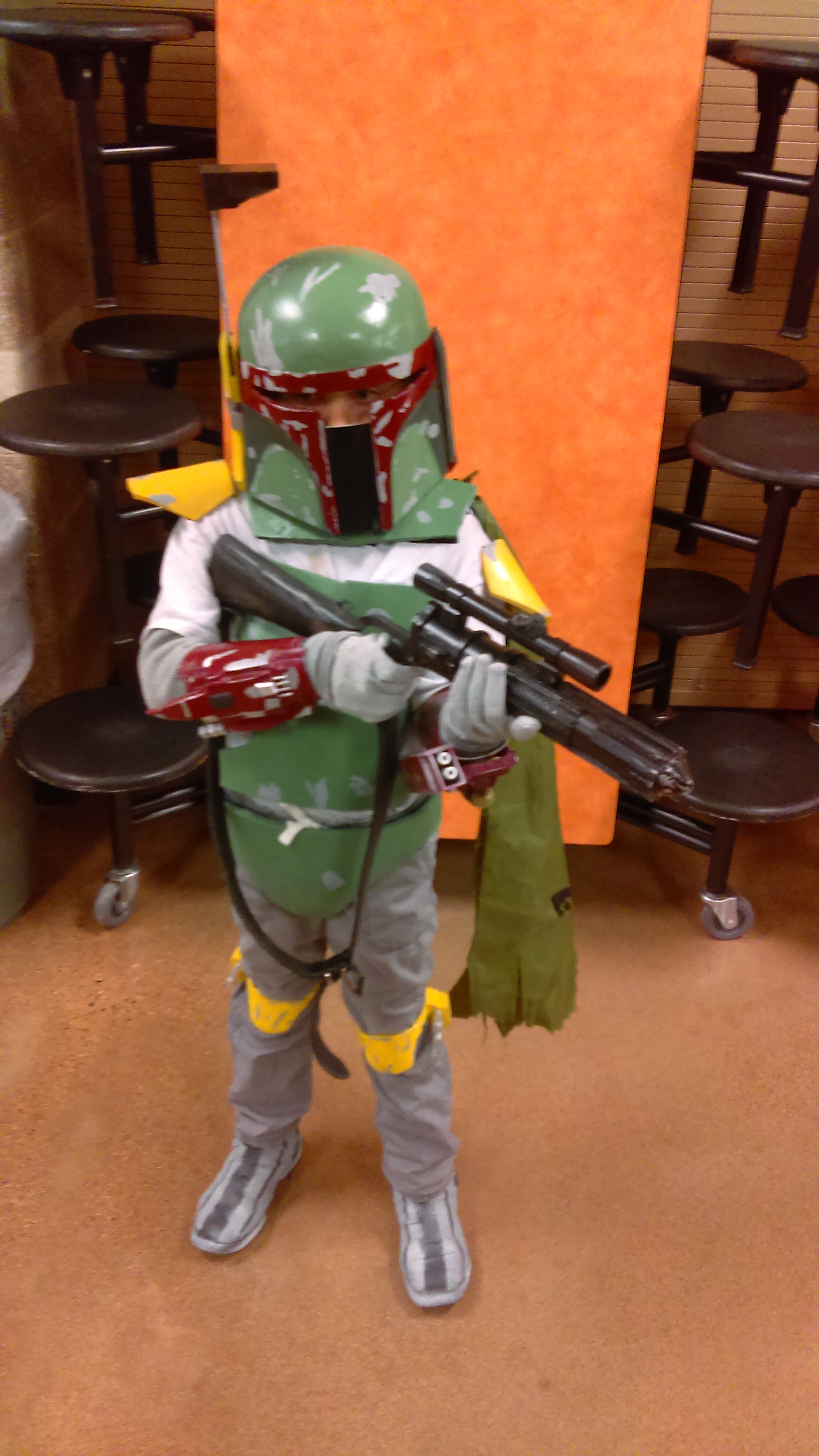

Here's the full outfit on him. I used velcro on the shirt Goethe armor and an old cub scout belt with velcro to hold on the cod piece. Those "boots" I made turned out great for a quick and cheap solution.
