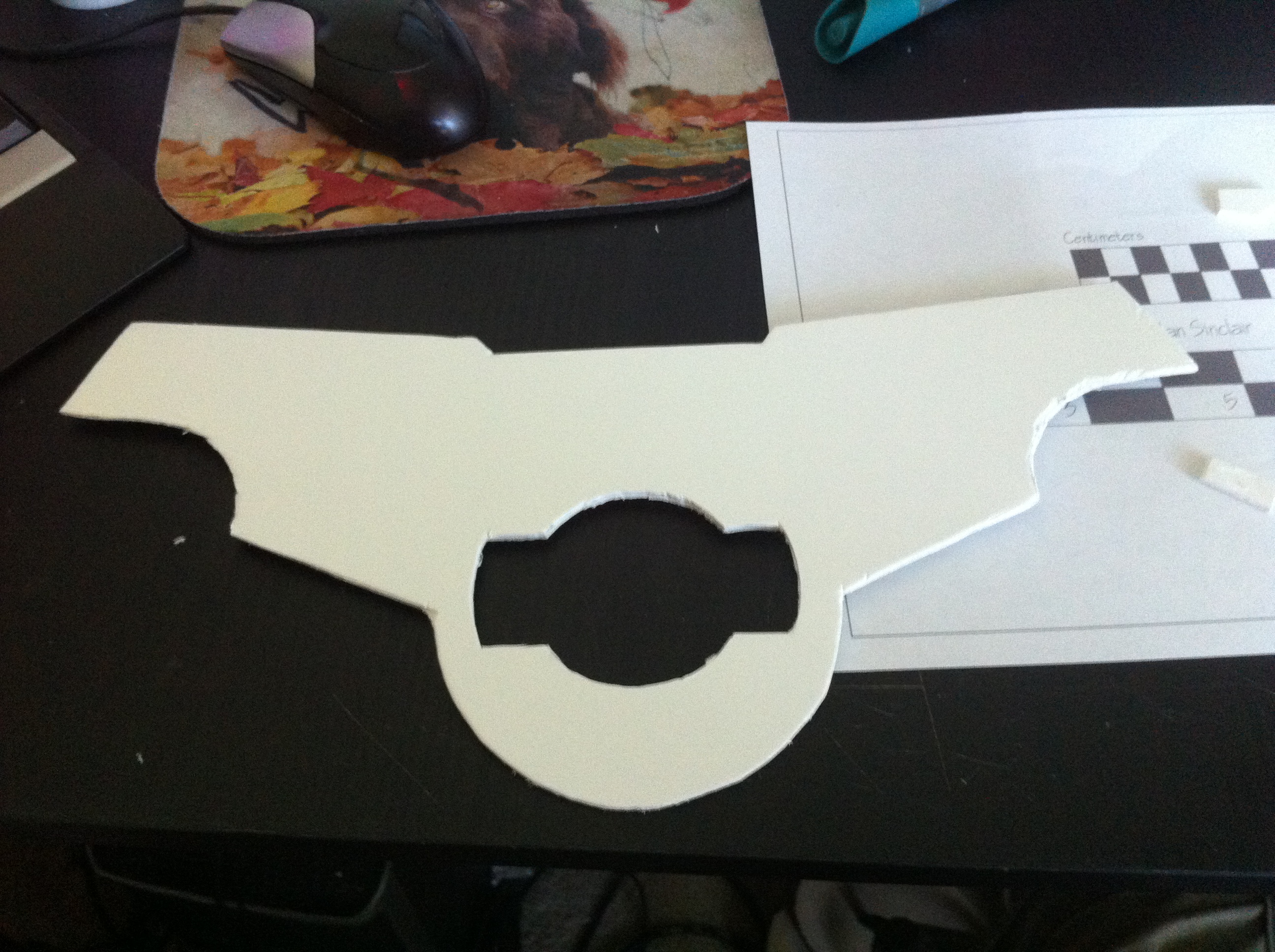

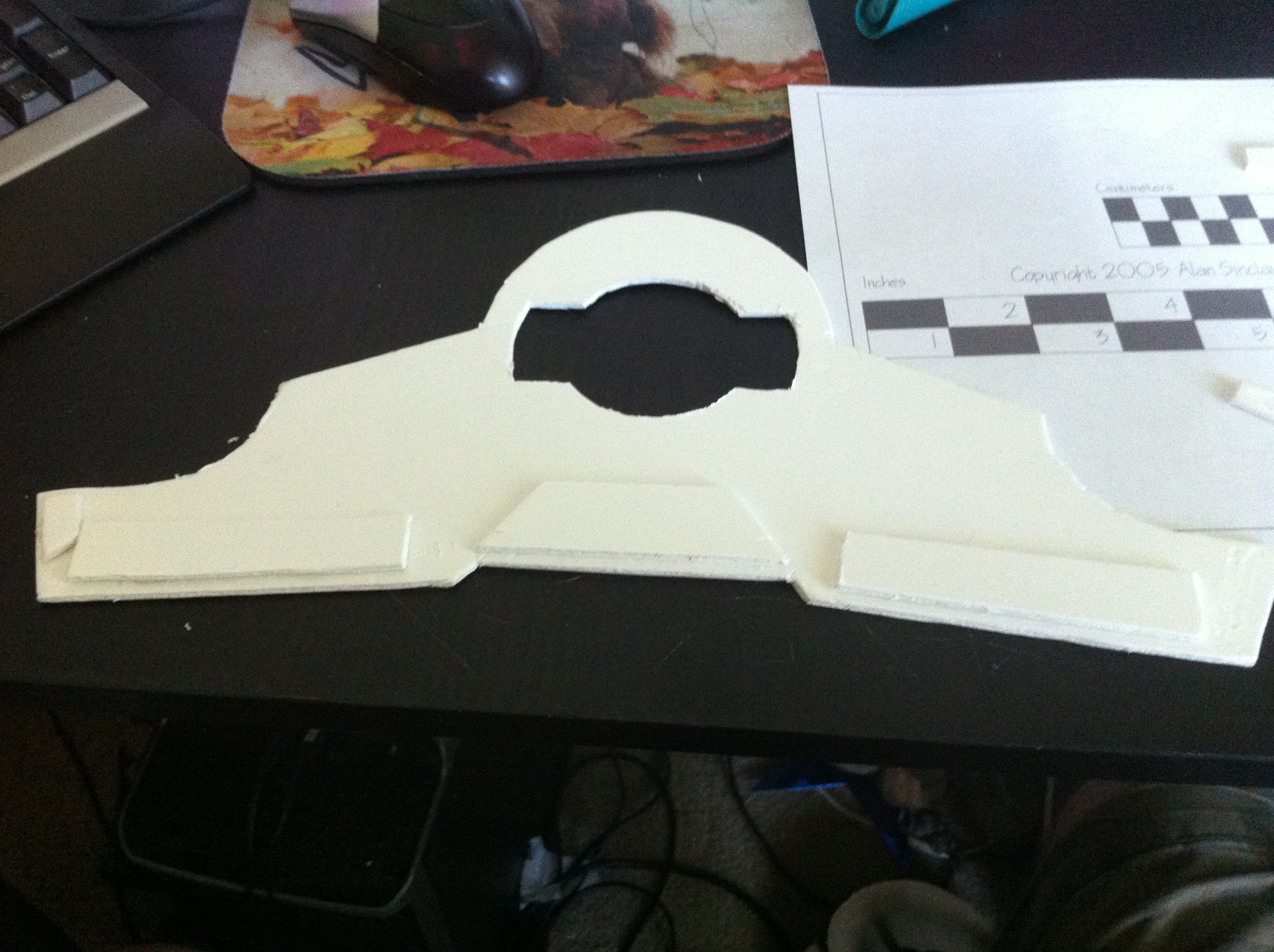

Printed out the WOF templates and laid them on the Celtec. Cut out the pieces and mixed up some Plastic Epoxy...

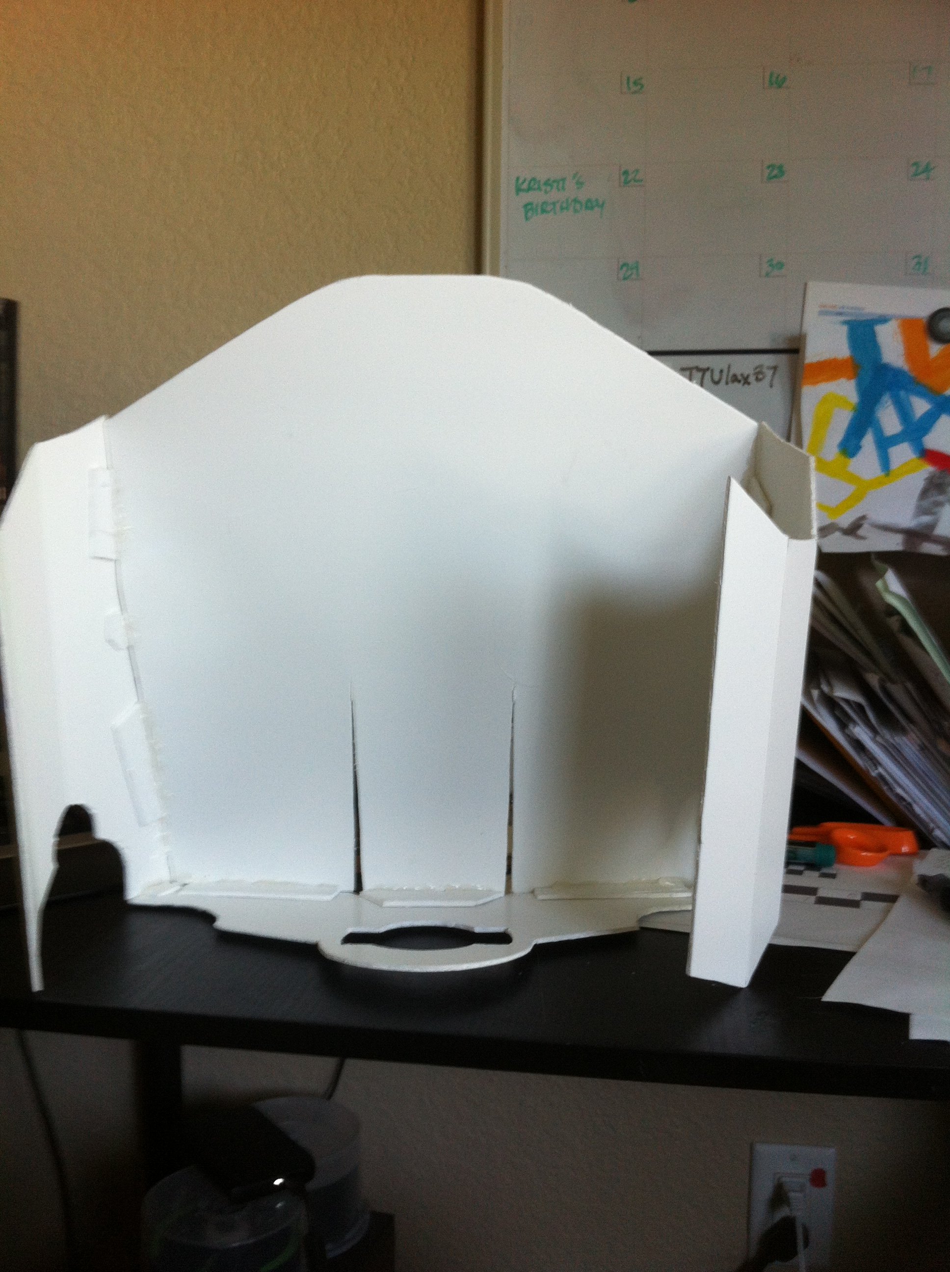

Thanks guys! I really appreciate the kind works and support! There has been a learning curve, but not too bad. I've been experimenting with how to make the round parts. I think I will tape it together, hot glue the joint, light heat with heat gun to hold shape, and then epoxy to strengthen the joint. I'm open to thoughts or easier methods... :)

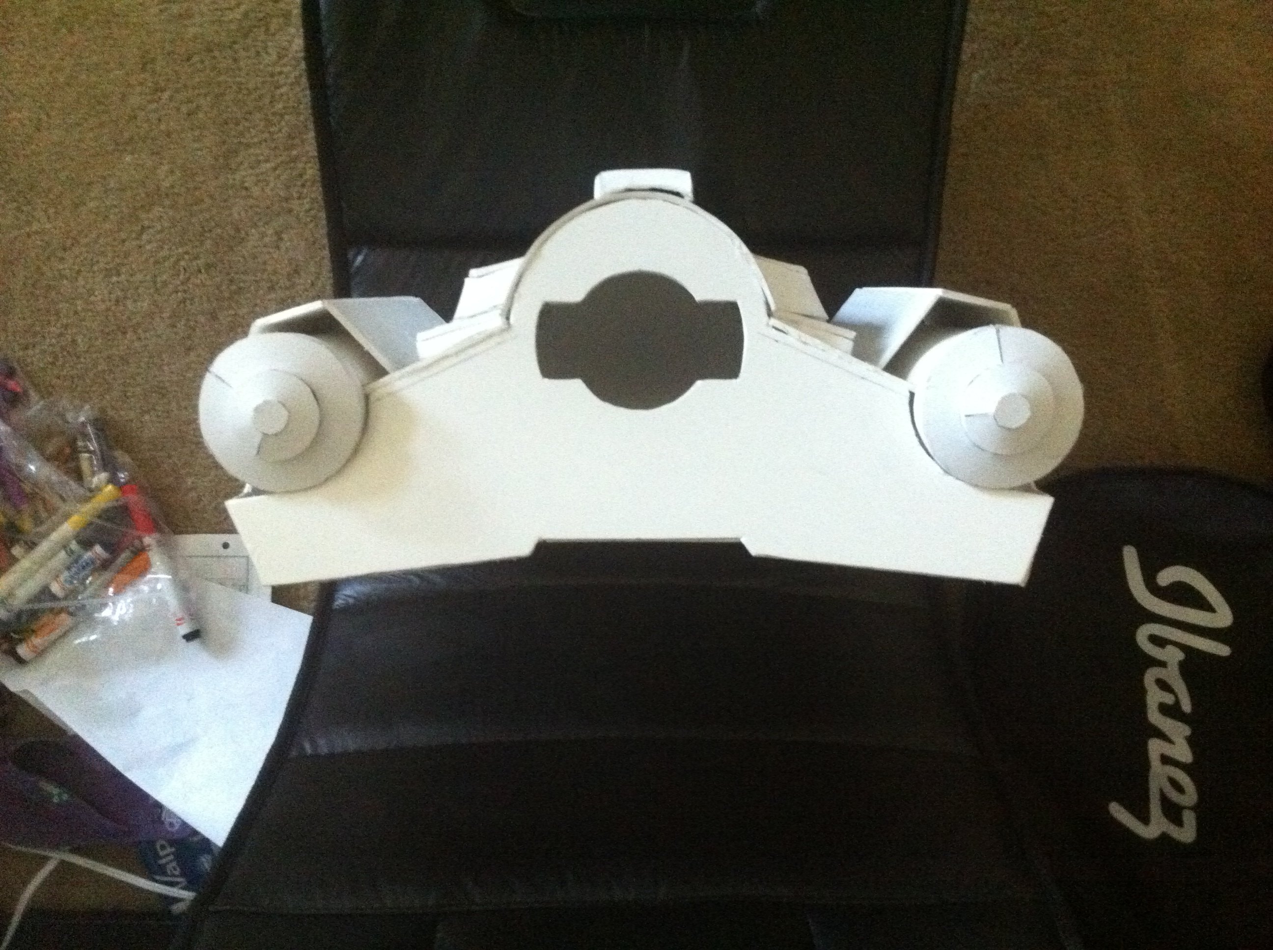

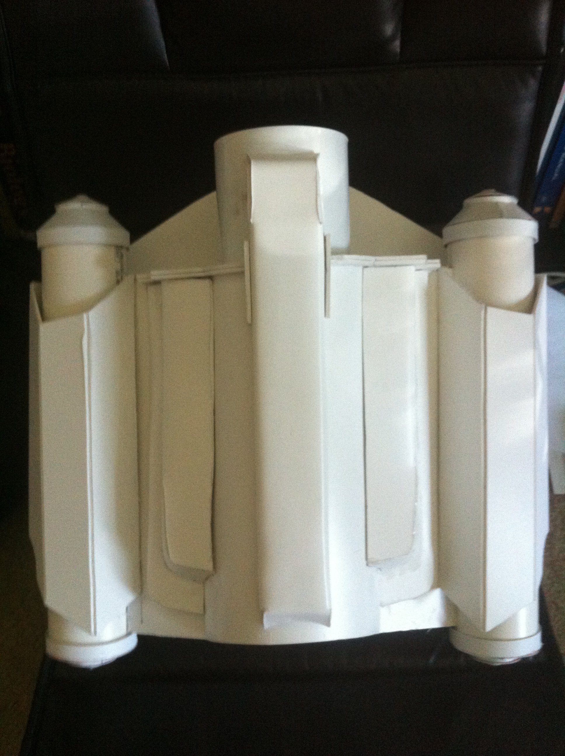

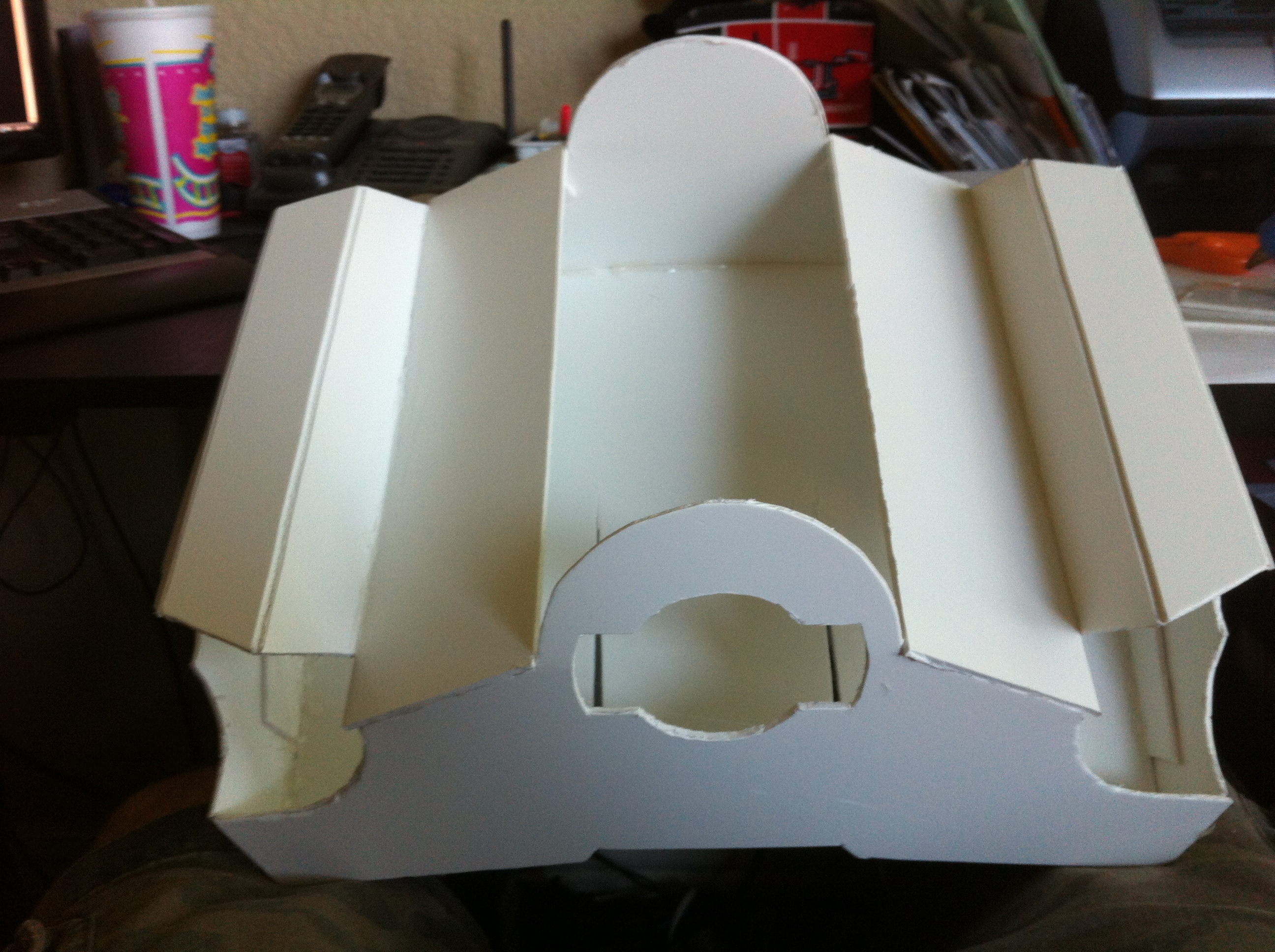

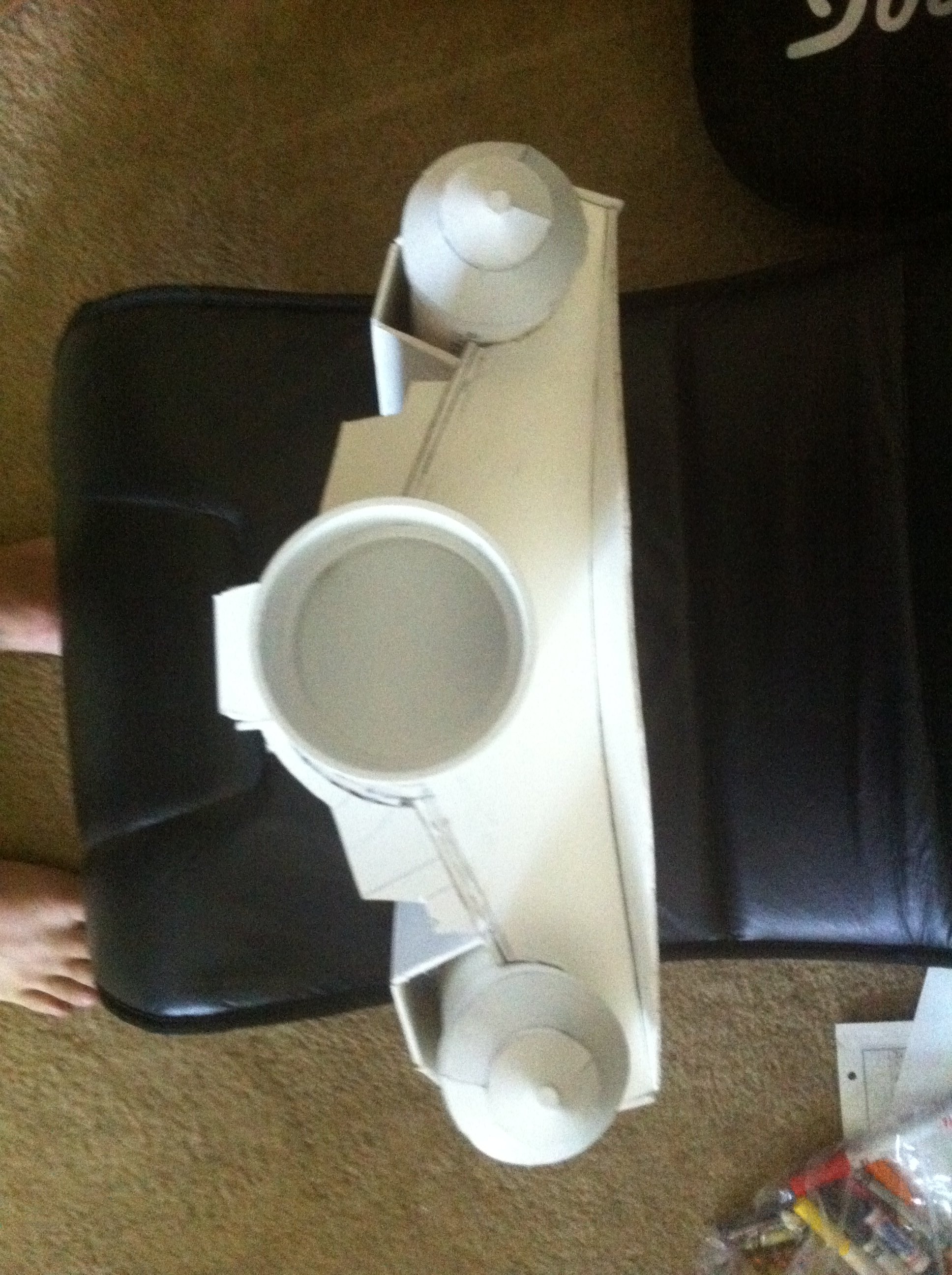

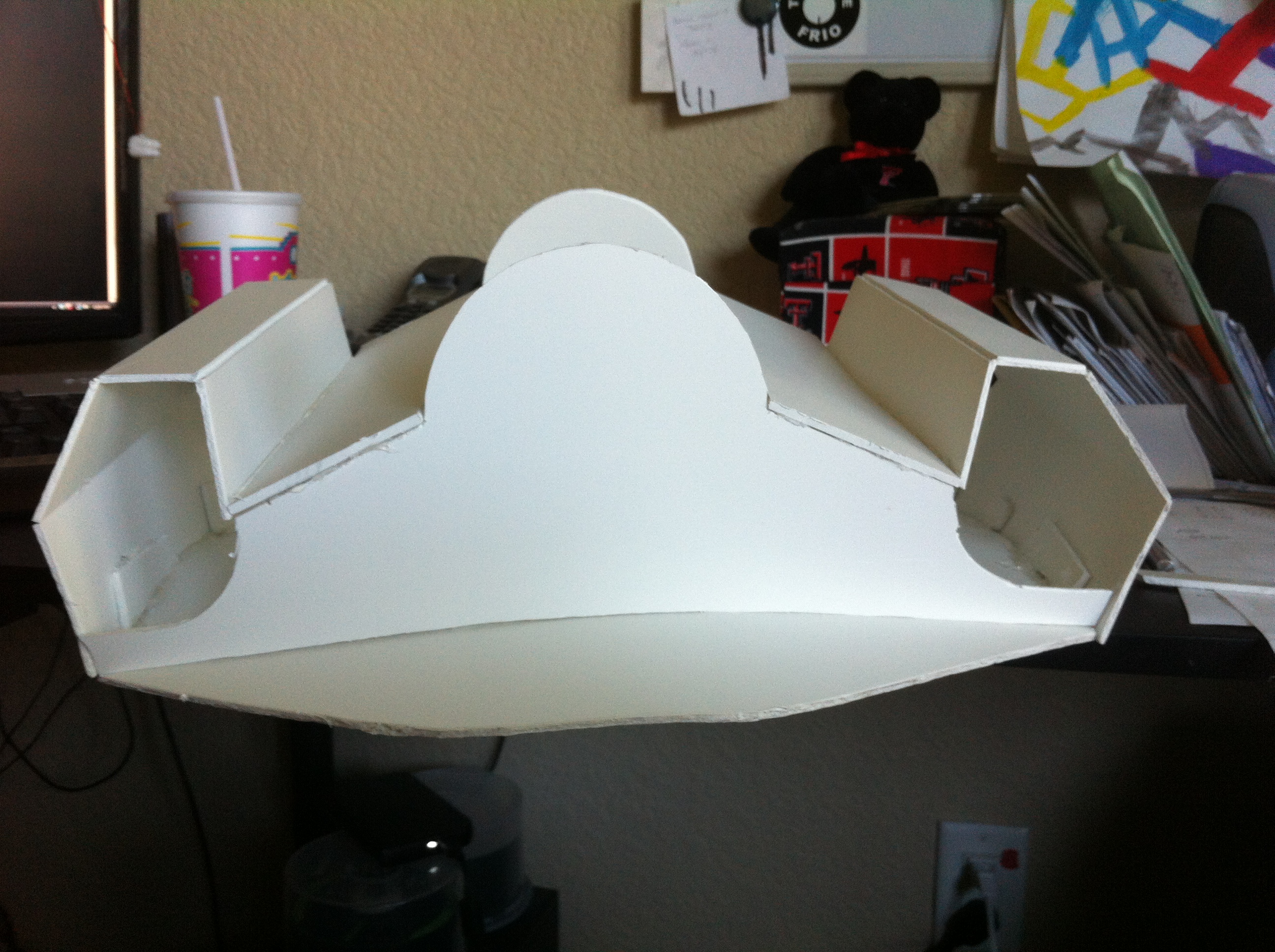

After some thought I decided to redo a couple things. I really want this to turn out nice, so I want to take my time on it and not rush, rush, rush... So here's where I am as of this morning.
I didn't like the way the 1/8" celtec was coming together for the deail pieces. It's just to thick. So I only used it for the main shell. I have found that you can make a relatively sharp bend with the celtec if you heat it and use a ruler or scale to bend with. For all the detail pieces I decided to use some "for sale" signs I picked up for $.98... :D I love cheap build stuff you can make look nice! For the boosters, I used 2" PVC and a 3" PVC coupling for the main rocket's neck. Once I get the main exhaust vent in the bottom, I will start filling with bondo and sand, sand, sand! Let me know what you think.

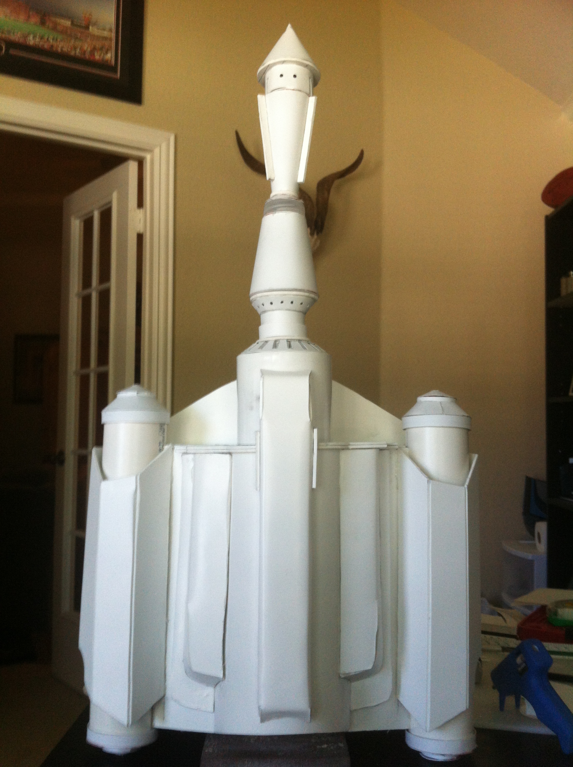

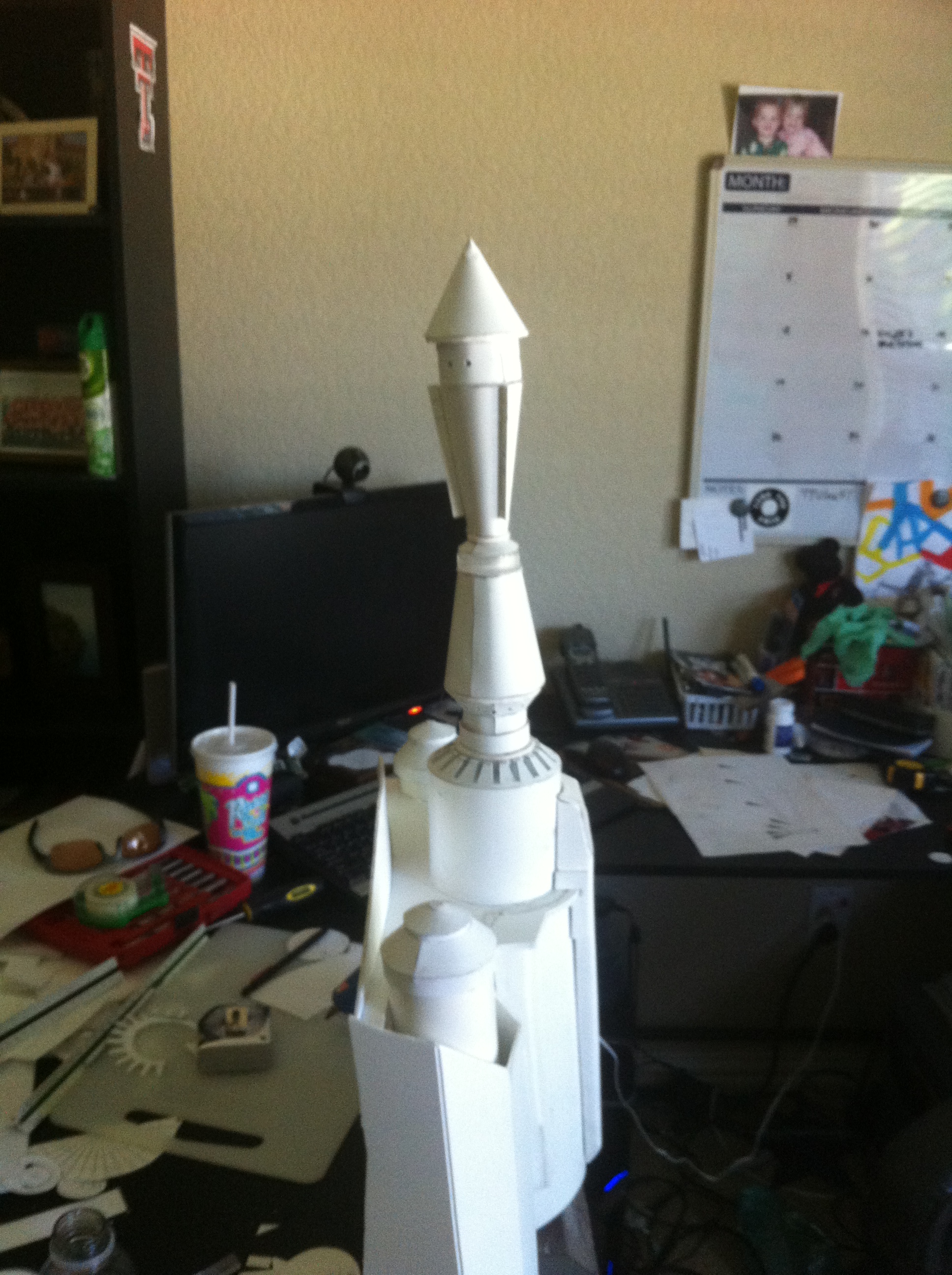

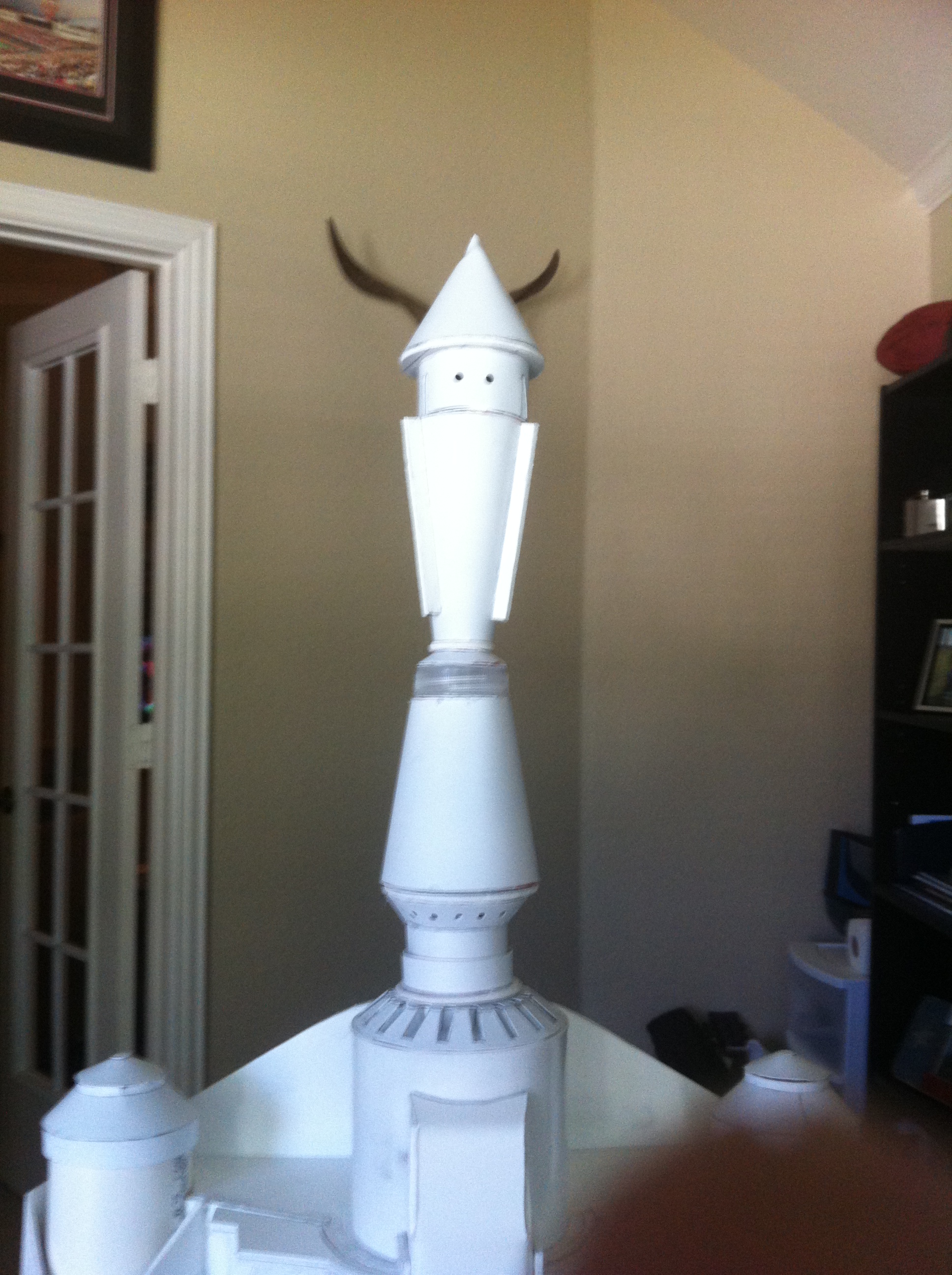

I got the missile/rocket finshed up today :lol: ! I'm going to use 12 earth magnets to hold it in place, 6 on the pack and 6 on the missile/ rocket. Let me know what yall think.
