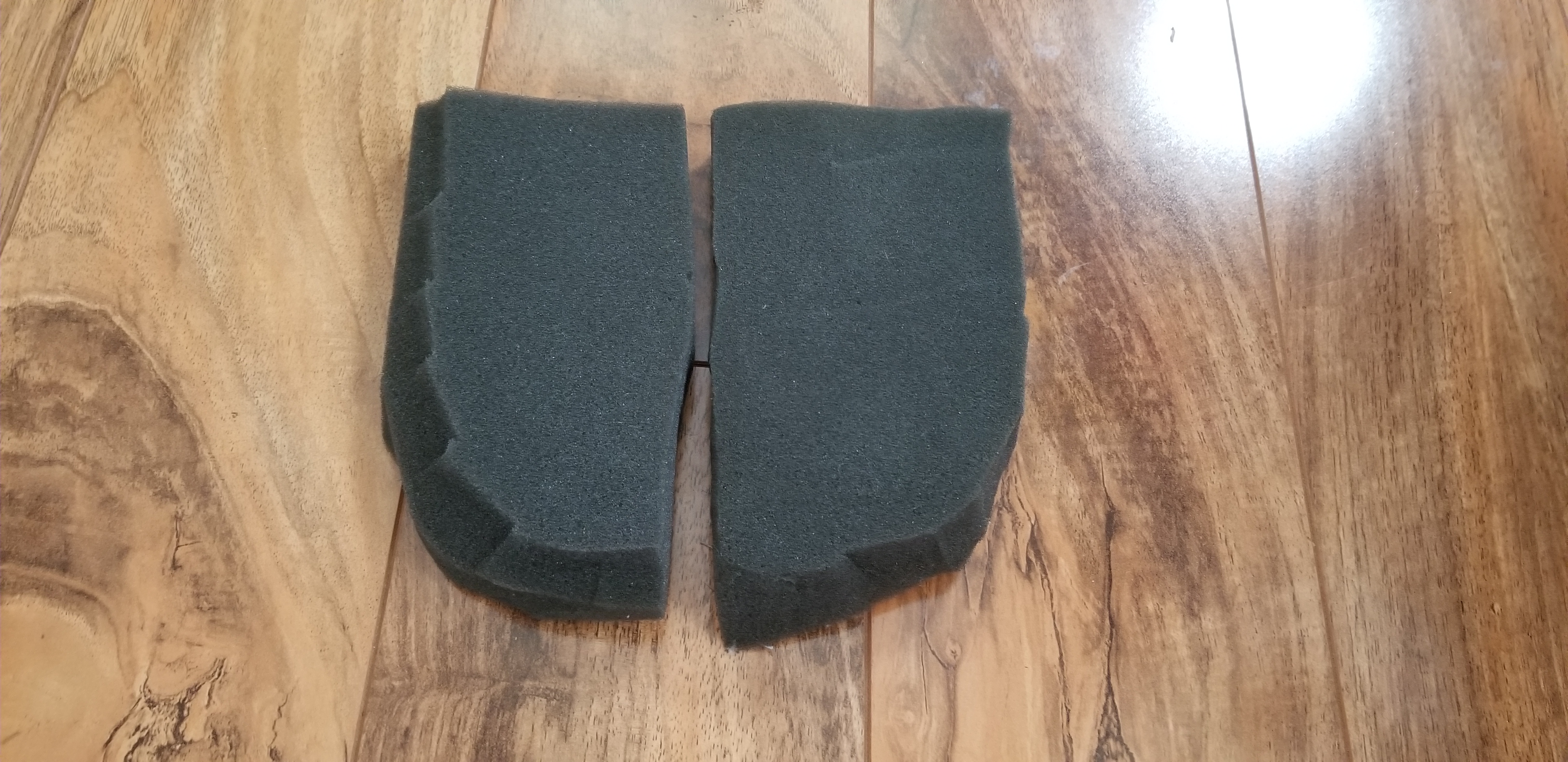

Here is what I did for my thigh pockets. I split them down the middle to allow them to form to my leg better. Super light weight and gives the look I was after. The hip pouches use the same foam but one piece and I added a 1" x 1" down the center to give it a little more bulk. All easily removed if I want to carry a cell phone or other items.

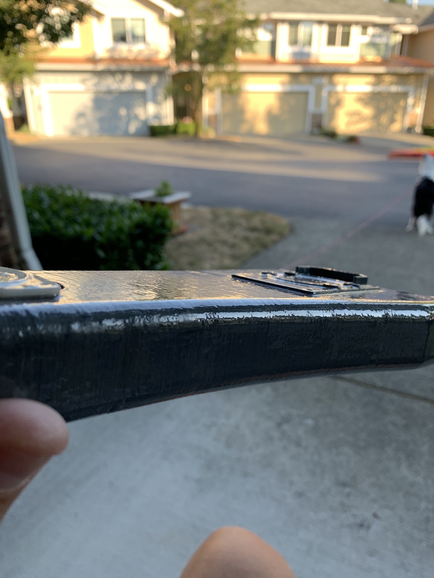

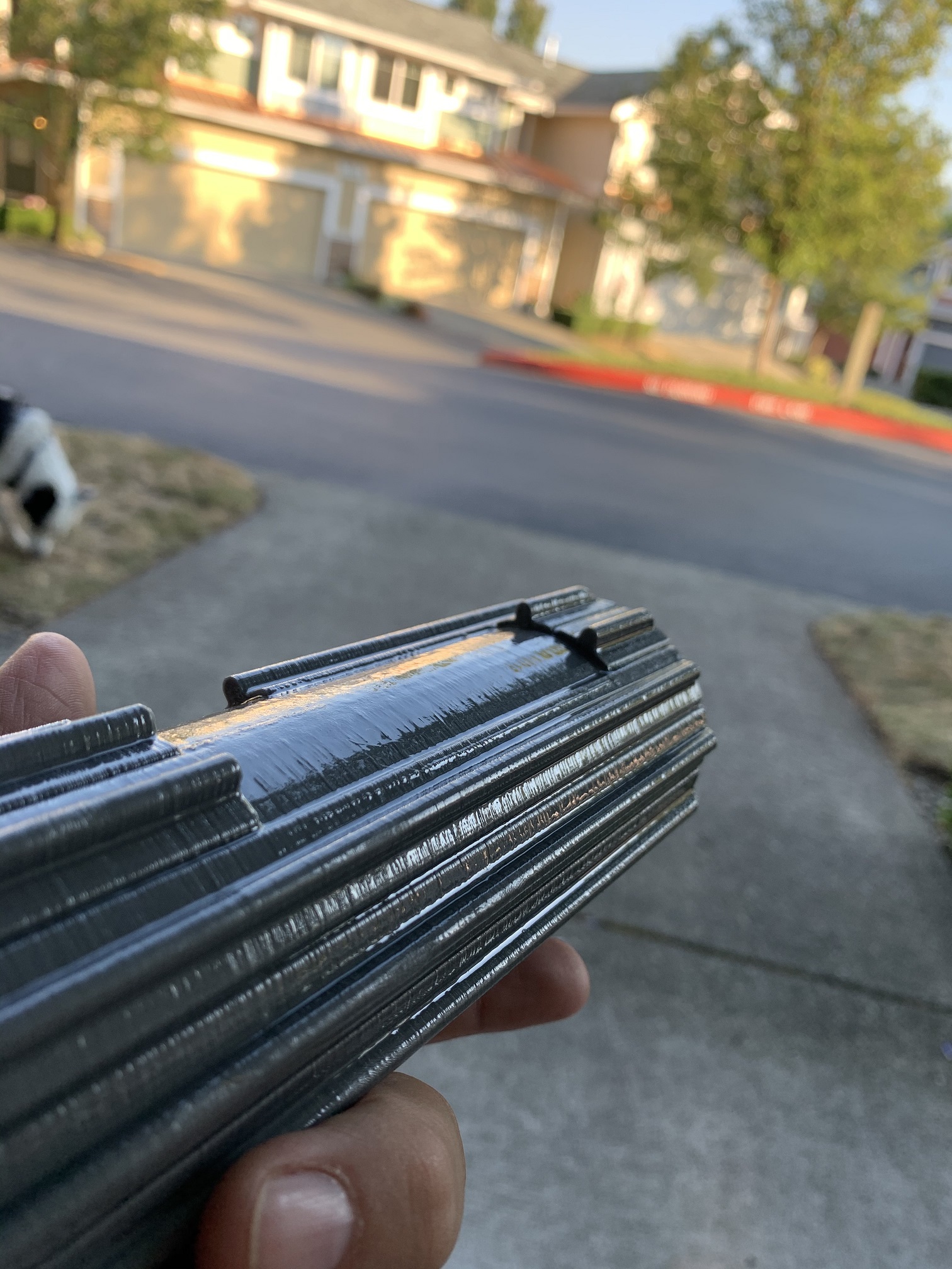

This one's for you! It is hard to tell from these pics but the coating process with the XTC-3D solution went on great. It dries on Clear and glossy. So you can still see the Print Lines, but feel them.....you cannot. (y)

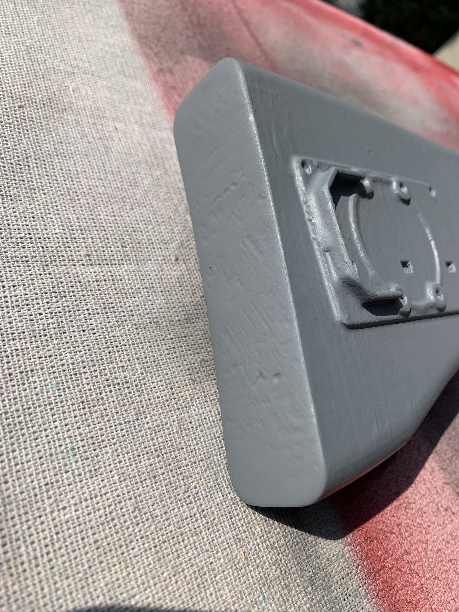

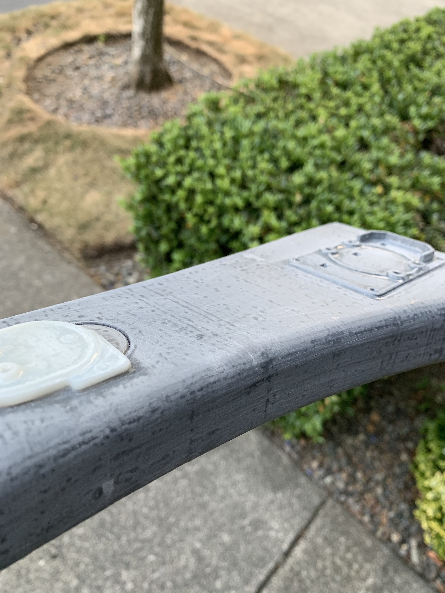

I inspected it all it it came out great! There were a few bumps were the XTC-3D stuff kinda ppoled in an area and then dried. but it came off pretty quick with some 220 grit sand paper. I took 30 mins and sanded it all down. It was baby smooth at this point.
I'm just gonna give it a wipe down in the morning with a wet wipe and let it dry in the sun (Should be in the 90's here tomorrow) then once dry, hit it with some Primer and then really look it over for them pesky lines. I suspect if I see any lines or imperfections whatsoever they'll be tiny and in places and hopefully be hidden by painting. But we shouldn't see any lines in the major areas. Overall I'm quite satisfied with the product and have no issues recommending it to others.(y) More pics to follow!

Thanks for the pictures. I always wondered about that stuff. Was it difficult to sand? If you only spent 30 minutes it must not be too difficult.
Of coarse you know you will need to continue posting pics as you go. I want to see after a coat of primer now.
And yes more Sunny pictures and side walk art are a must.
Lazerjock
Was not difficult at all. Just trying to hit all the nooks and crannies was really the only difficult part. The scope rings and trigger guard are still some what tacky. I think I'm just gonna hit those with some XTC-3D (correctly mixed). If I wasn't such a perfectionist I'd say screw it and throw some primer on there.

Hip pouches look great! Stealing that idea :lol:
mattman1138
I'm actually gonna do foam for my pouches. Lazerjock kinda talked me into it. ;) I also felt like they were a bit too square and as Lazerjock put it...."Too Perfect". I bought a sheet of 1.5" thick foam a bit ago that I'm going to be using for my Gauntlets. And now it seems for my pouches as well. (y)
-Iron
Ahh the Unicorn had me floored! They are wonderful dogs, mine was a cross lab/collie and lived until she was 14. Thanks for the pics and smiles :)
Fett, I've also used the buckshee foam from the gauntlets. I used a piece and also piece(s). Still not sure which I like more, the pieces looks more natural. So maybe try some off cuts you end up with.

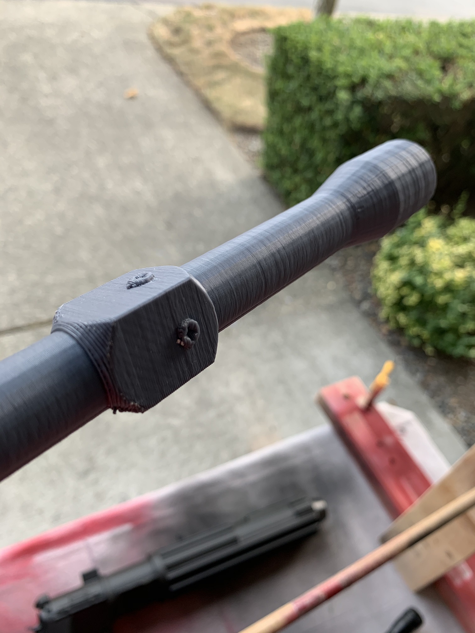

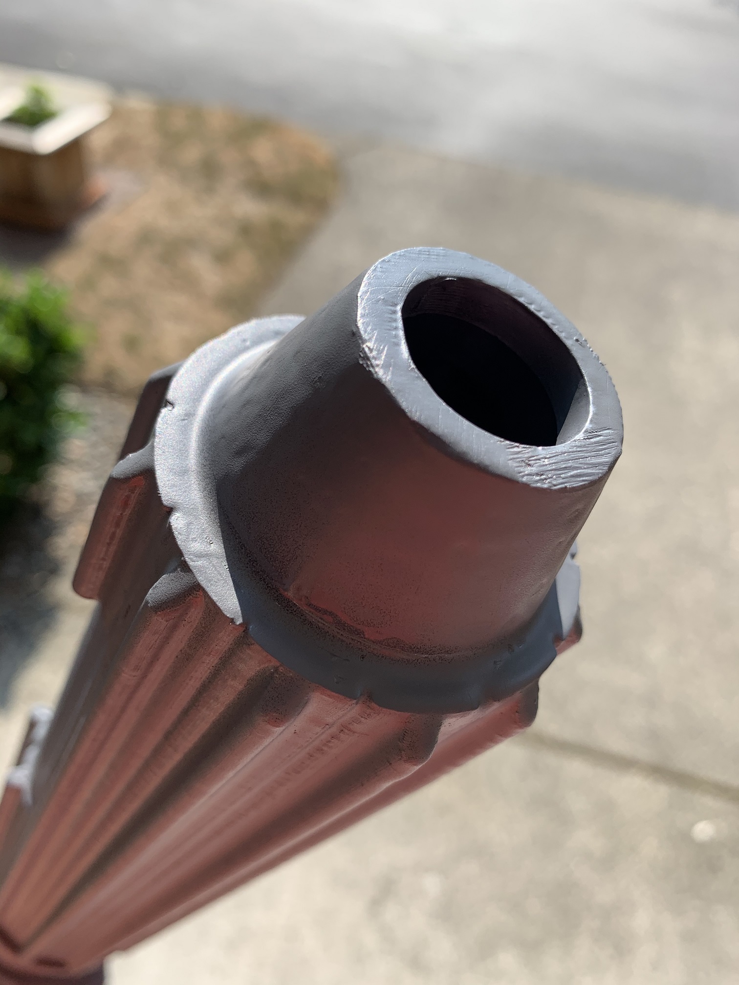

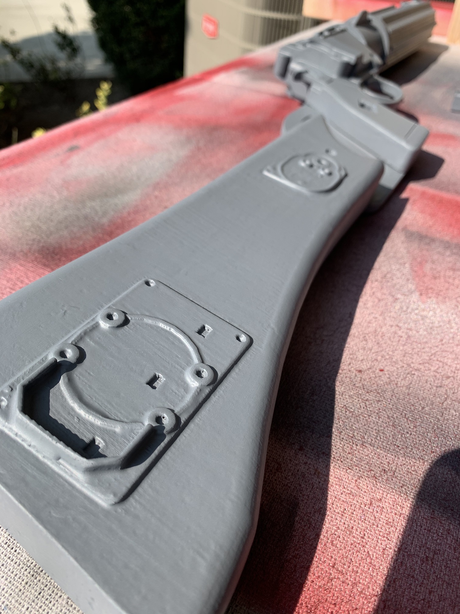

Update on EE-3
It is still incomplete, but here are some updated pictures of it primed and my base coat of flat black paint on it....
As you recall this EE-3 that I got from AprilStormProps off of Etsy was a kit that was 3D printed with commercial machines in ABS. I used the stuff known as XTC-3D to get rid of those 3D print lines. Here is an example of those 3D Print lines on the scope that I will not be using, as I have purchased a real scope to use instead.
Here some pics of it primed (Post XTC-3D).....

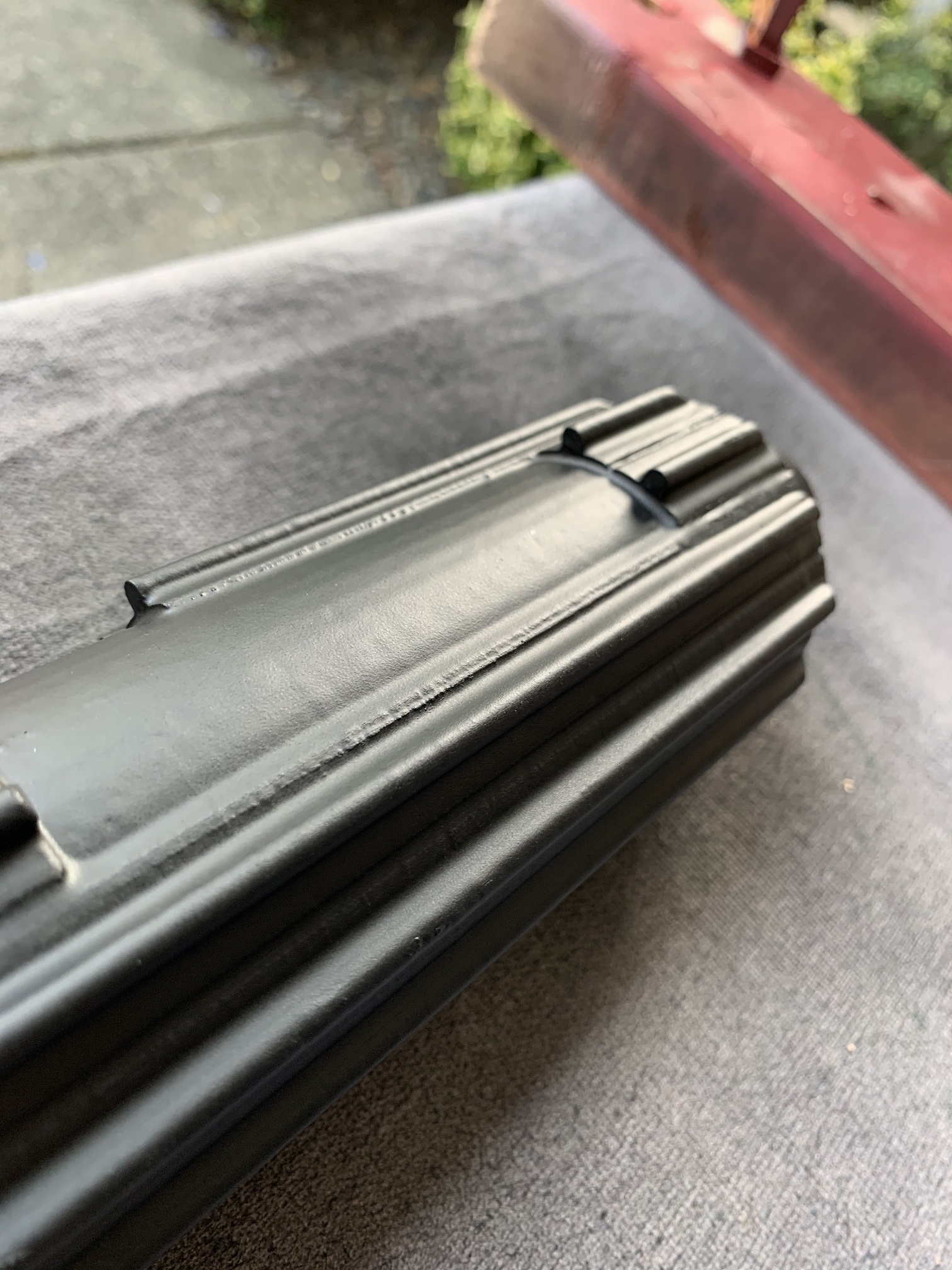

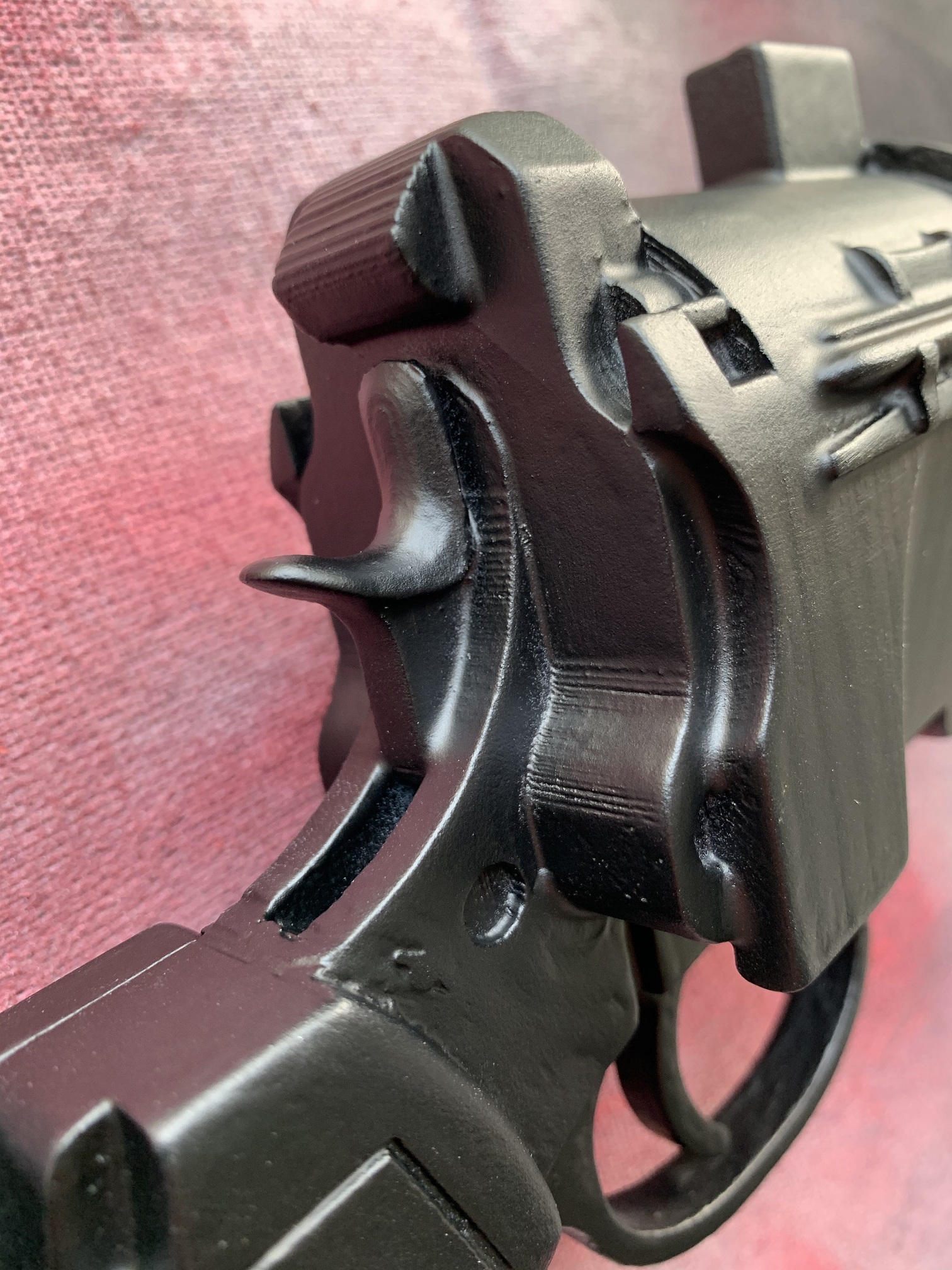

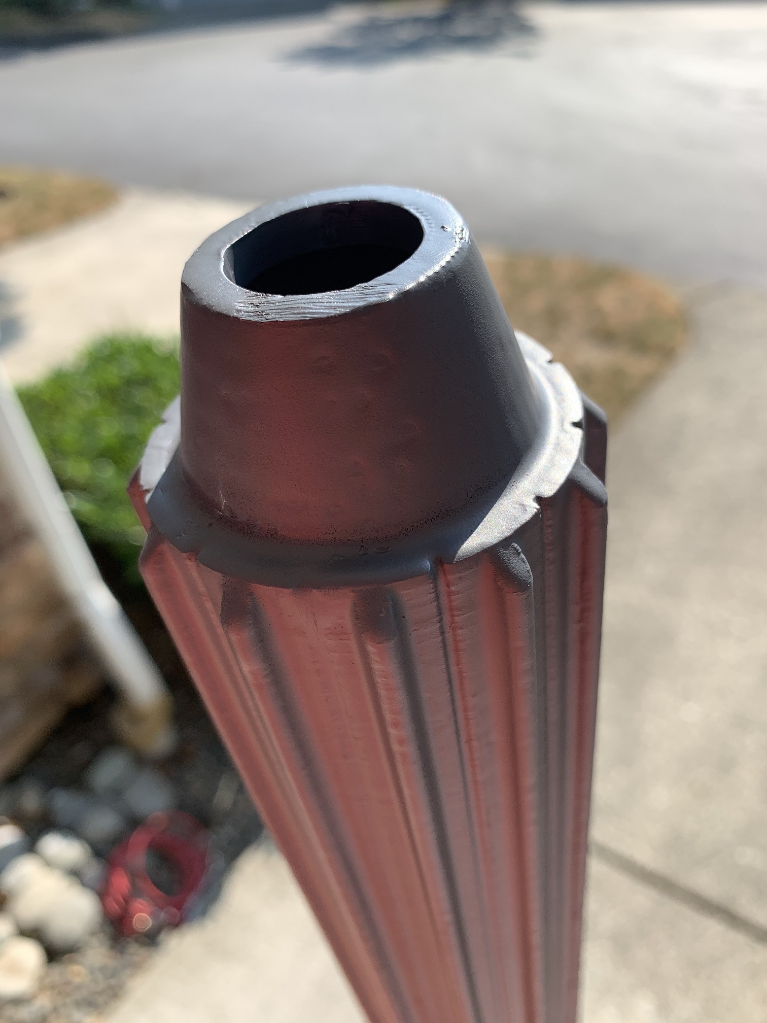

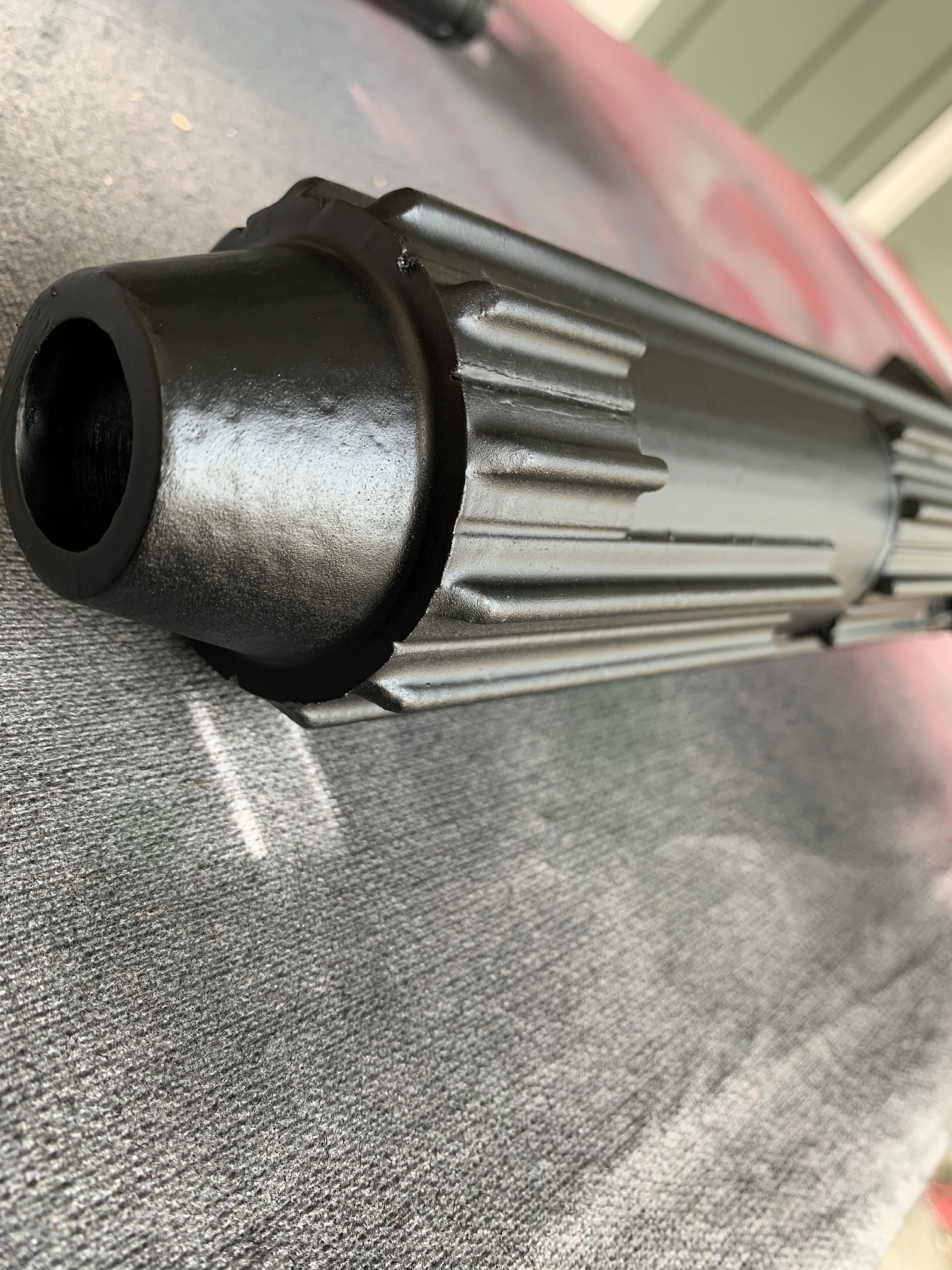

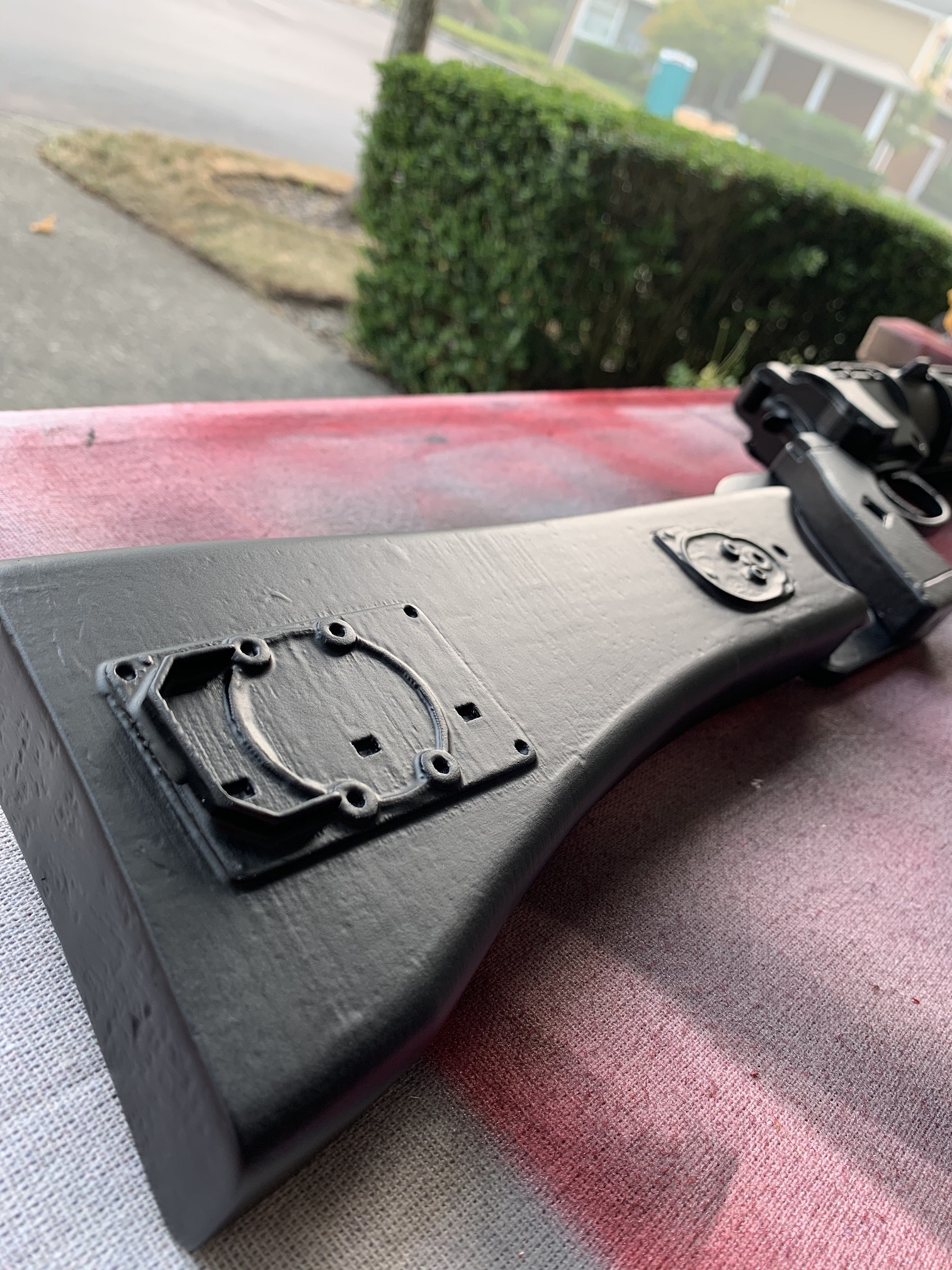

....and here's a few pics of it painted up in the flat black.
My thoughts are that this stuff actually works and offers that quick solution in getting them 3D print lines smoothed out quite nicely. This being my first time even doing this, I didn't think it turned out that bad! I know there are a few print lines that are evident, and some inconsistencies in some spots, but I think it actually adds to the over all condition of the weapon, which is....well.....really worn! Going back to my US Army days, when thinking about the M-16A2 and it's stock (as well as other weapons), and how they can get pretty dinged up and the stock on the EE-3 reminded me of exactly that. (y)

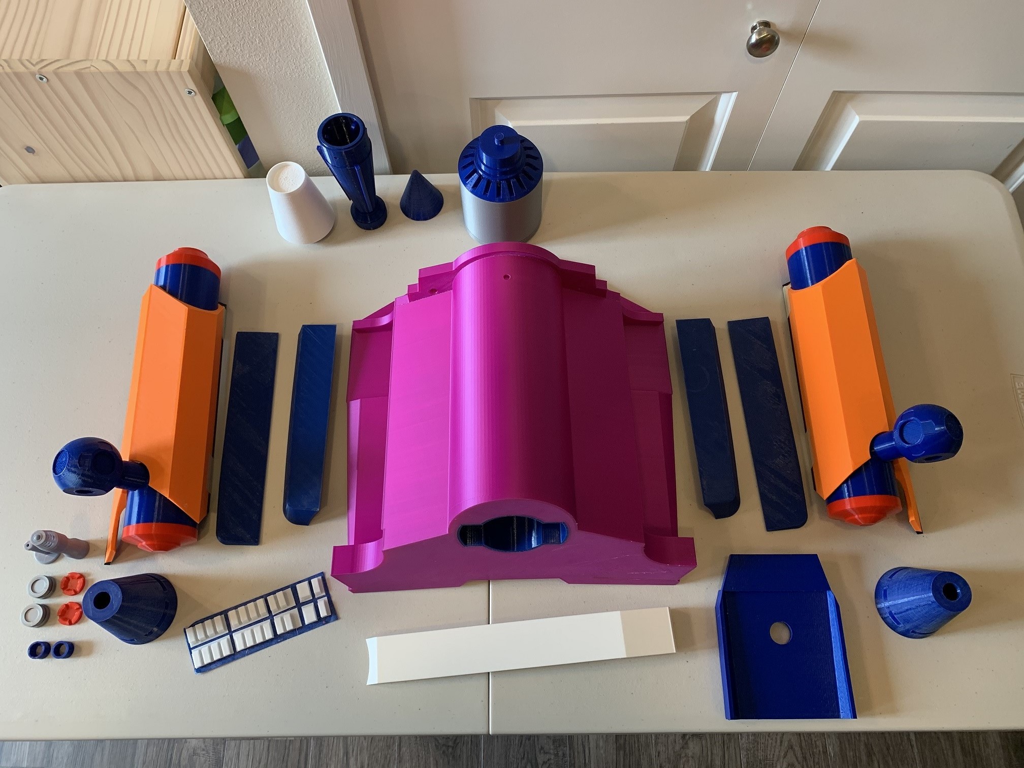

Here is how my kit came.....

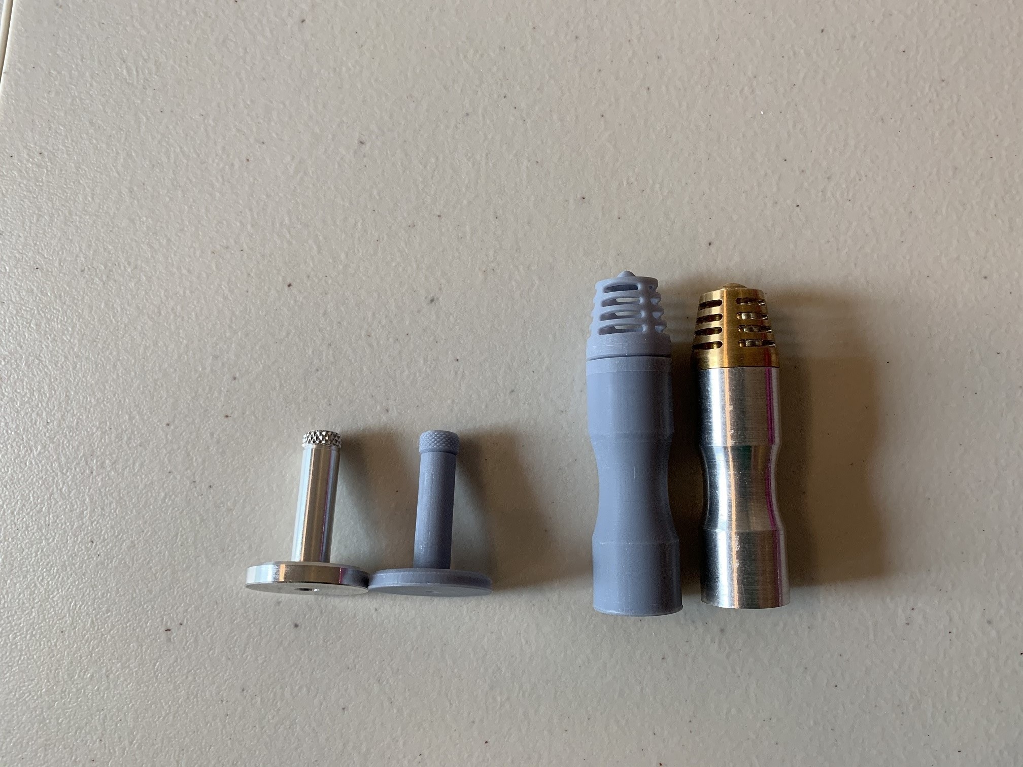

My first impressions, was that this isn't a bad little kit for the money. (Never mind the Plastic Colors it was printed with - Hahaha!) It has potential. The parts seemed to line up and go together quite easily. The plastic Jetpack Beacon and Stabilizer are to be replaced by Quest Design Canada's parts (y) . Here is a comparison of the two. (or I should say....no comparison)

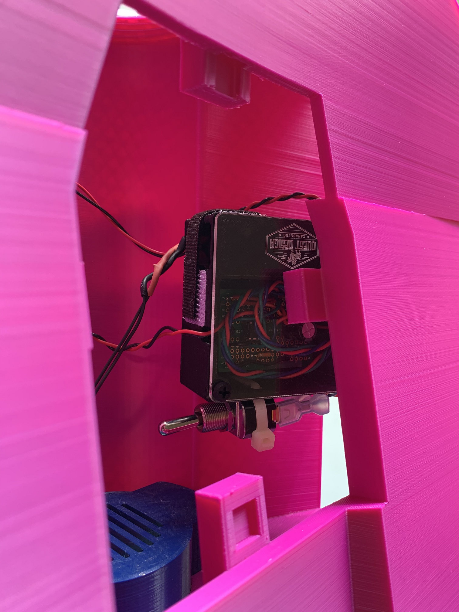

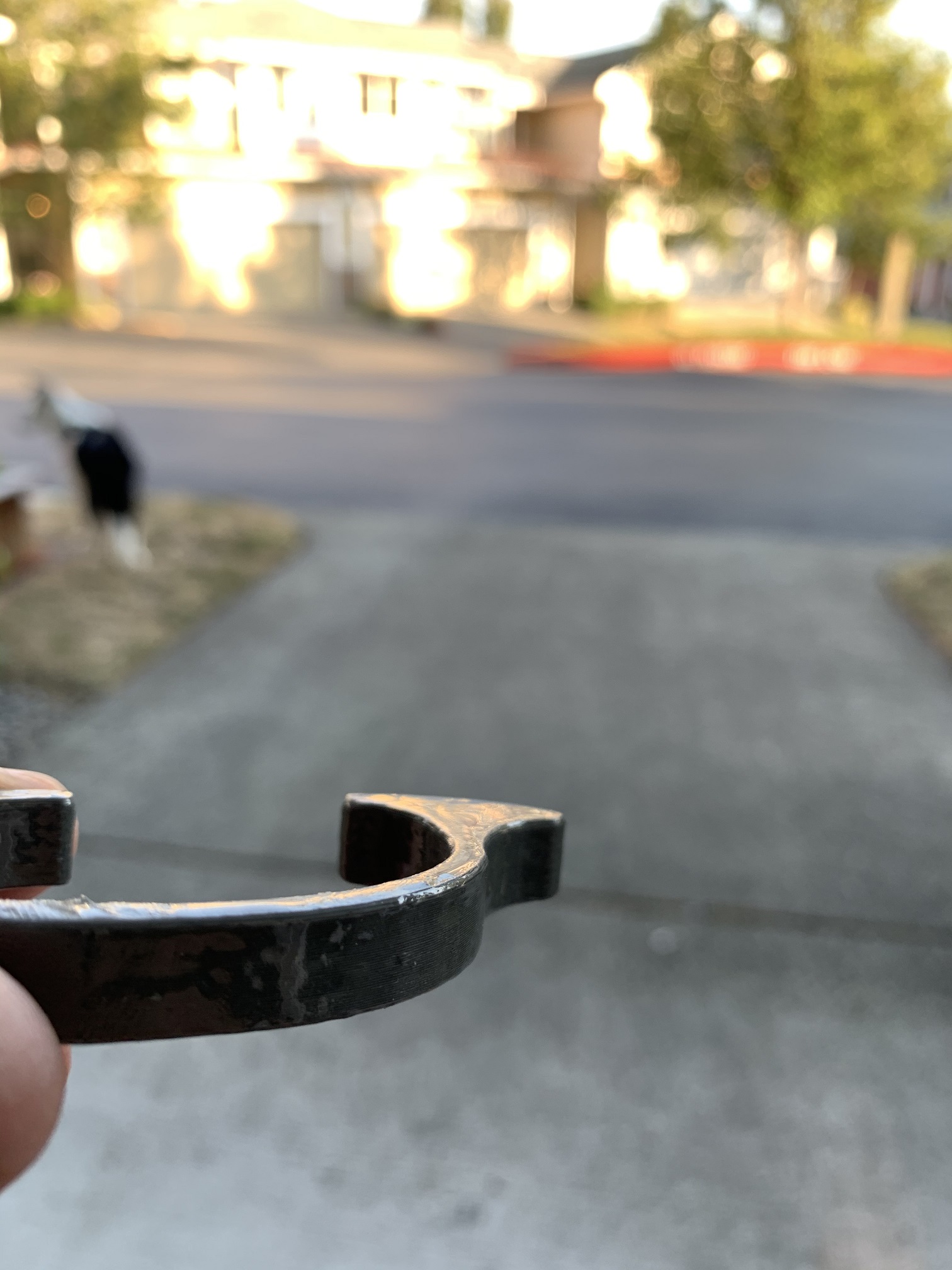

Something just has to be said about metal parts....they REALLY do take it up another notch! (y) Speaking of accuracy - Does anyone know how to go about getting Brass to look more like that Brushed Aluminum? As you seen, I was able to darken the Rocket for my Gauntlet, but this is taking it into the other direction. My thought was to leave it for now and darken it up with soot/black effects to hide it a bit. I did spend a little time in figuring out how I wanted my QDC Electronics to be installed in the pack and found a solution. Using some Velcro I was able to get the battery/electronics box mounted and installed in the pack. My LED Beacon is capable of doing a pulse and solid option. (and of course "Off") It took some finagling But I'm pretty happy with the result, it is quite solid and sturdy too!

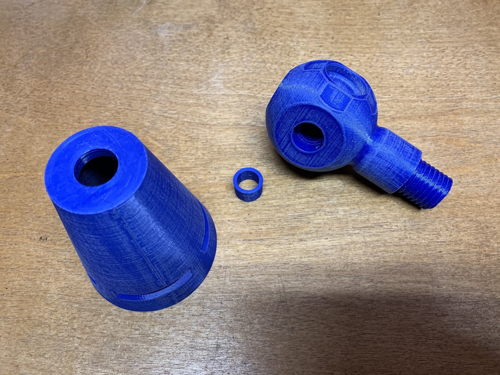

I also modified the way the Thrusters go onto the kit too. I'd like to think I improved upon the design a bit. Here is what they gave you to accomplish this.....

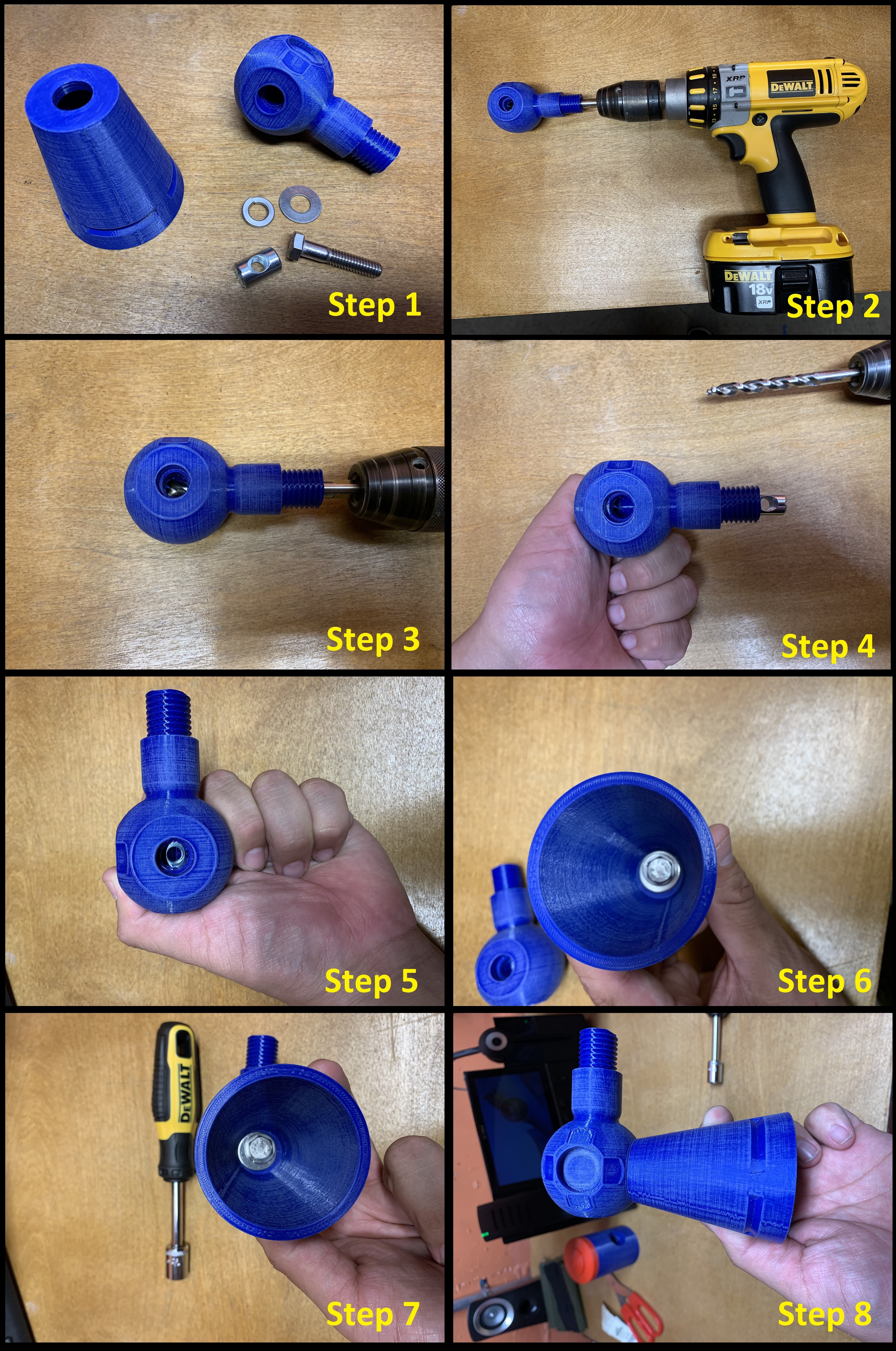

They expected you to use the little plastic piece and some glue to hold it together. After looking at the parts, here was my idea....
Step 1: Go to a hardware store and get a 5/16" furniture Dowel Nut and a 5/16" Bolt that is 2" in length and some Lock Washers and Fender Washers.
Step 2: Carefully (I cannot stress that enough) drill in a bit further as the dowel nut will need the additional room.
Step 3: If need be - and it was in my case, ream the hole out a bit so the dowel nut fits.
Step 4: Insert the dowel nut.
Step 5: Using a long screwdriver gently snug the dowel nut into place.
Step 6: Drop in the Fender Washer, Lock Washer and Bolt into the Thruster piece.
Step 7: Using a Bolt Driver, get it screwed into place.
Step 8: Enjoy a more secure Thruster! (y)
