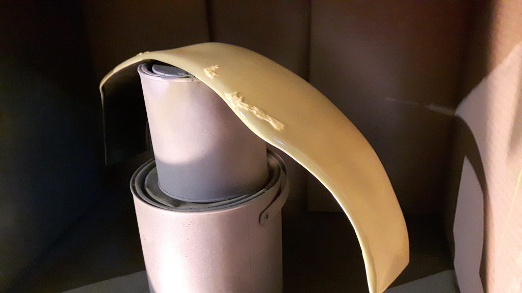

Yellow going on top of silver (toothpaste masking fluid)

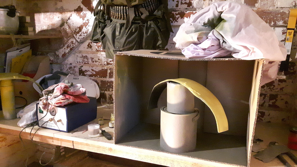

my 'spray booth' :lol:

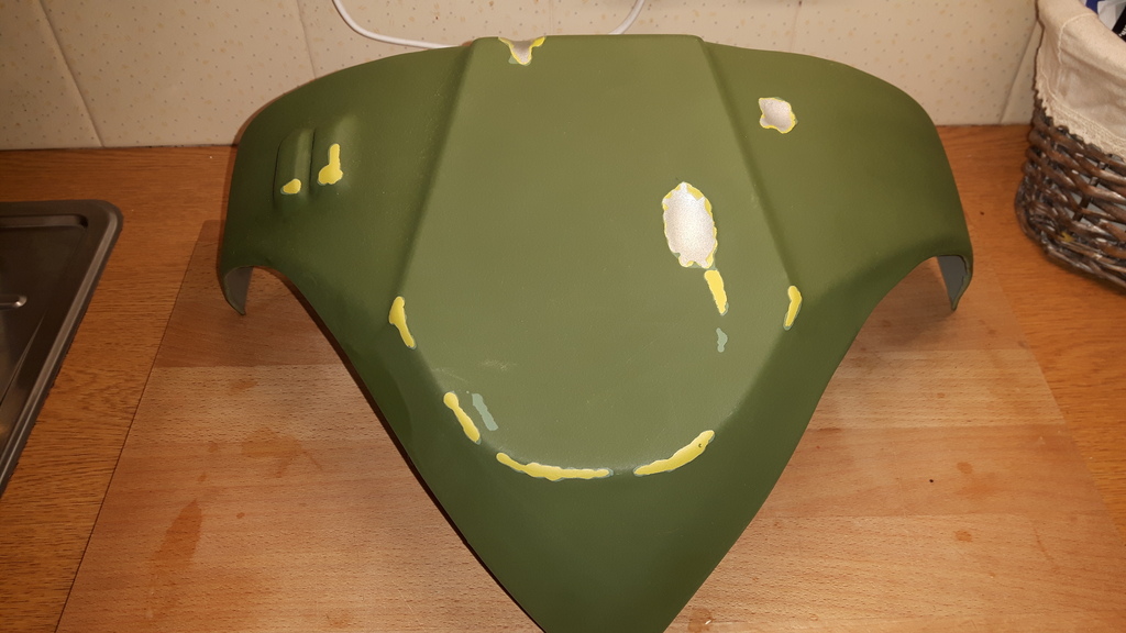

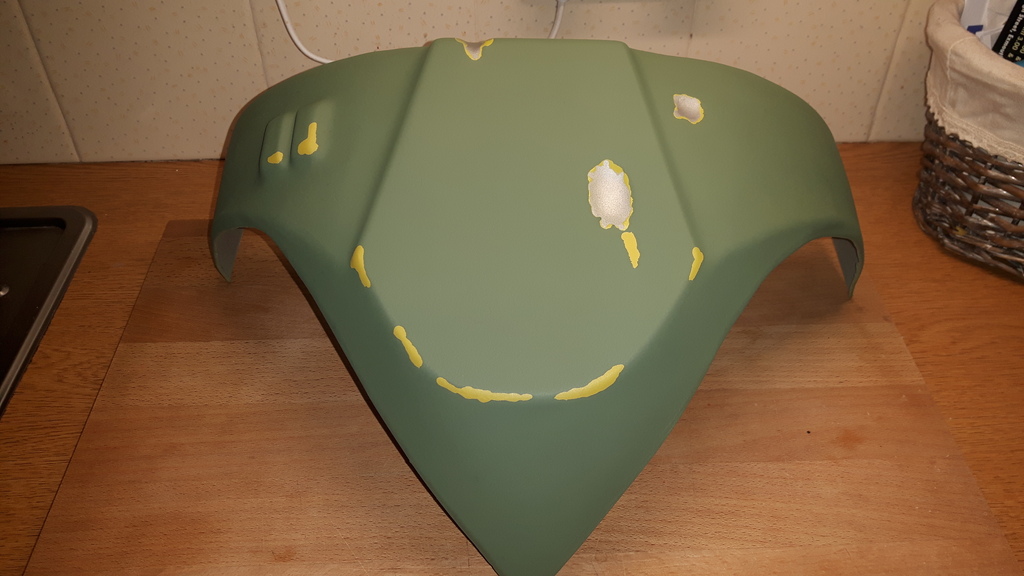

And the first layer of Humbrol 78 :) Tomorrow I'll put the darker green on then I'll weather it. Finger crossed for the eventual clear coat in several days time
Hi Silverstalker. After the primer I laid down a layer of Humbrol 11 (silver), then over that I used 81 (yellow), then 78 (green), then 117 (dark green), then weathered with 33 black
hope that helps and thank you for the kind words :)
