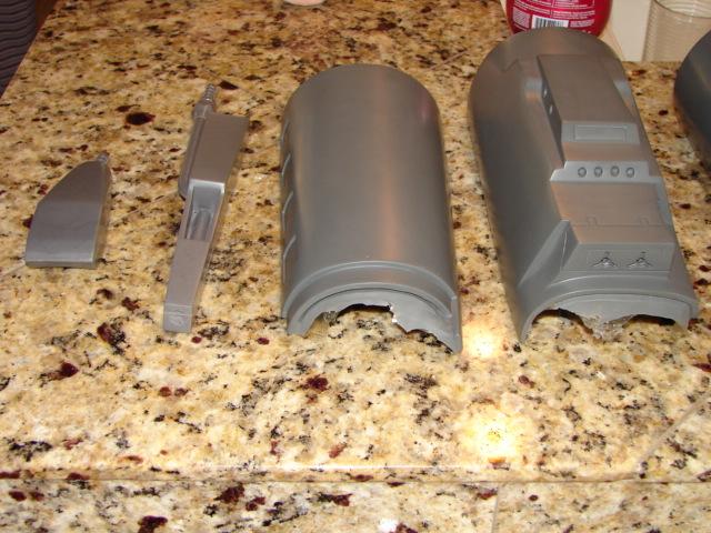

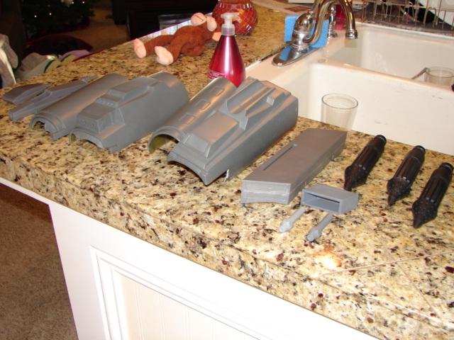

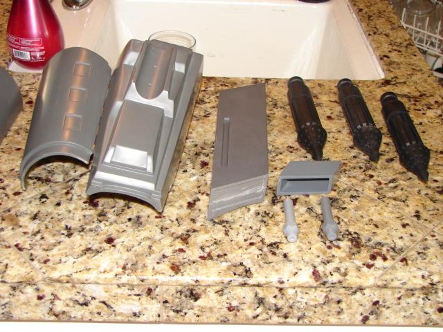

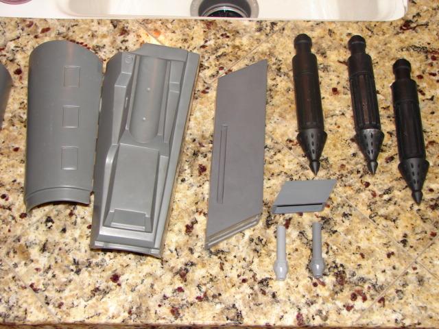

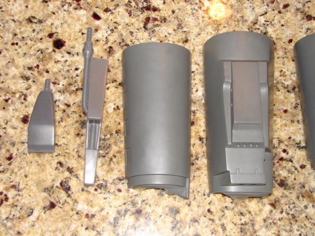

Small update:
These are all cast pieces from the molds.
The shells are fiberglass backed gel-coat.
The attachments are cast in Feather Lite resin and are very light. Pieces with hose attachments have metal armatures for strength and support.
The missiles are Hyper-Firm. Thanks to the kindness of Slavefive and Postmortem, I now have the missile mold and can offer it with the gauntlets.
I've gone through about 3 test pulls of cold-cast and it looks like I finally got the correct aluminum/resin/catalyst ratio down. There is a significant improvement in the cold-cast finish produced by the aluminum from the U.K. source. What's funny is that the shipping expenses from the U.K. cost me double what the aluminum powder itself cost.:lol: The cold weather is not helping at all with the test pulls, but I'll keep trying and should be able to offer cold-cast versions after it starts to heat up a bit outside.
For now, I'm going to offer the gel-coated version to meet any immediate needs members may have. I'll start a run thread soon with the specifics/kit options.
