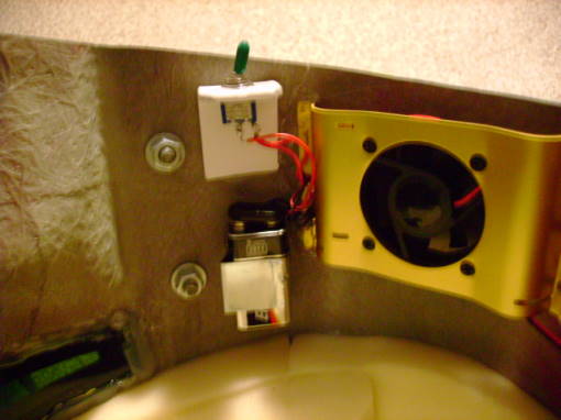

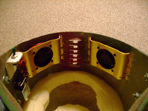

Here is a couple of pics of the inside of my MS2.
I cut a hard drive cooler in half and went this route.
-Tim-
Very nice!!!
I was planning on carving out the side of the fans over the key holes, and doing the same on the other/outer sides, then making a thin channel to bring the air to the front. To bring the fresh air from outside the bucket to the face and eyes.
Very nice setup! i like that its only running off one batt too! how long is the run time on one batt?
