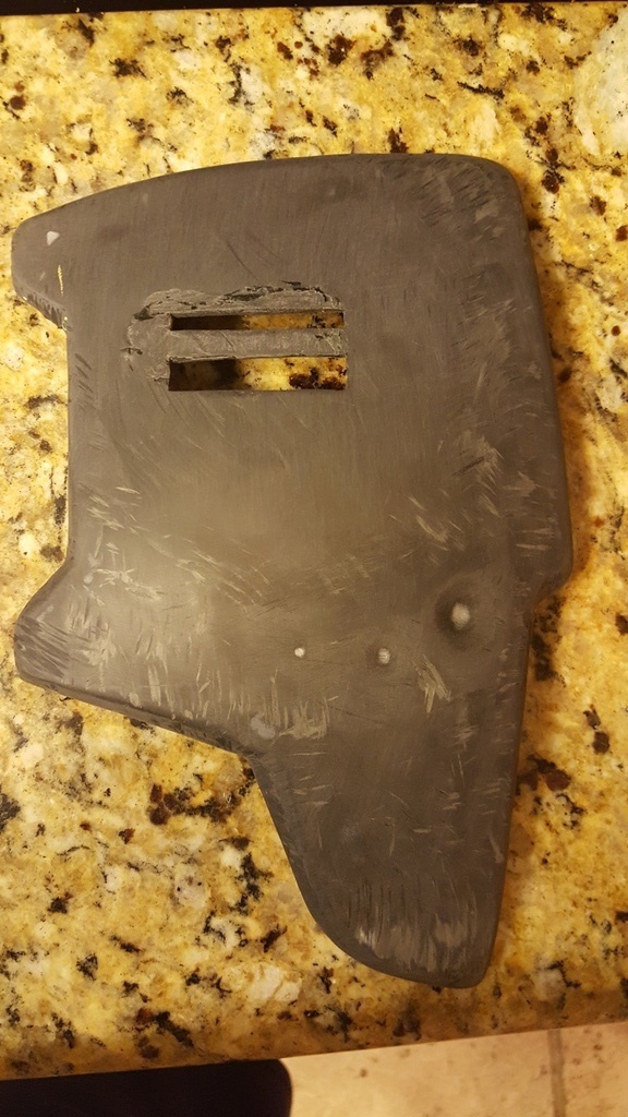

Despite numerous warnings here about buying stuff on eBay, I bought something on Ebay and it wasn't to my satisfaction, so I decided to fix it.

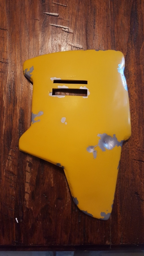

Here is what I bought... let's call it a "before" picture...
I thought it looked pretty good when I bought it. I was concerned about the dimensions of the chest display cutout... and I was right. I read about friction welding ABS plastic, so I bought some ABS filament and a sheet of ABS plastic and went to work...

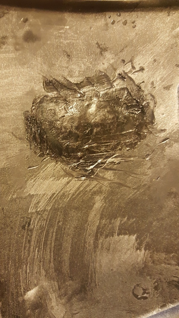

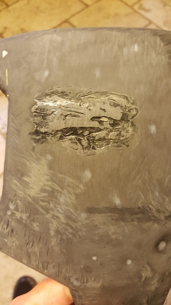

Well, I was able to cut out some appropriately sized ABS pieces, but for whatever reason, friction welding did not work, so I ended up soldering the filament in. I didn't care how sloppy it looked because I was going to sand down the final product anyway, so I added lots and lots of melted filament. Here is the front (after some sanding)...
And the rear (pre-sanding)...
- - - Updated - - -
After sanding everything down, it was time to make my appropriate cuts for the chest display...

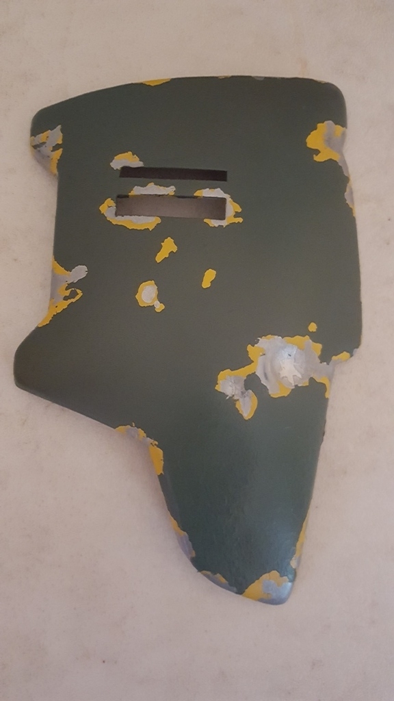

And now for painting... this is my first paint job, but thanks to all of the info provided here, I think it turned out pretty acceptably well. Here are the steps along the way...
"Yellow layer"...
And "Green layer"...

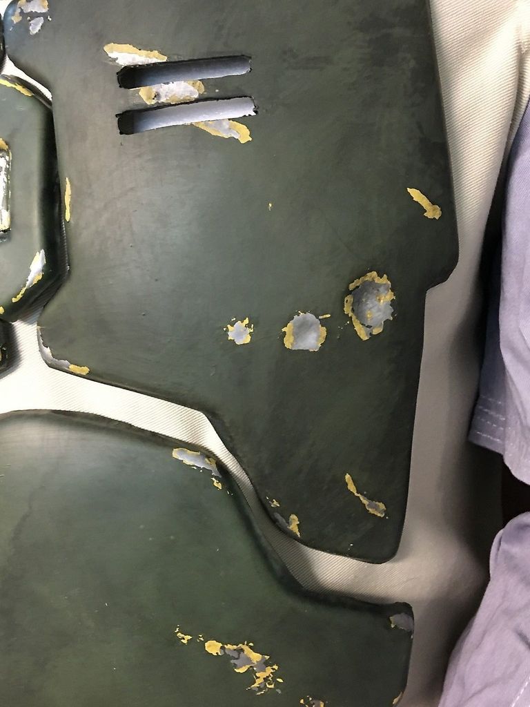

Side by side... Before...
After...
I was thinking of doing a black wash for weathering, though I know a lot of guys use black primer misting. Most people do some sort of a clear overcoat. Is that before or after weathering? It seems like that might affect dimensionality?
I know most guys do a sealing layer over the metallic layer. I tried that and it made the metallic too dull (and yes, I used clear gloss). I ended up sanding that down and spraying another layer of metallic silver, which worked out nicely. I did do the green layer too soon and ended up with some crinkling that I was mostly able to fix.

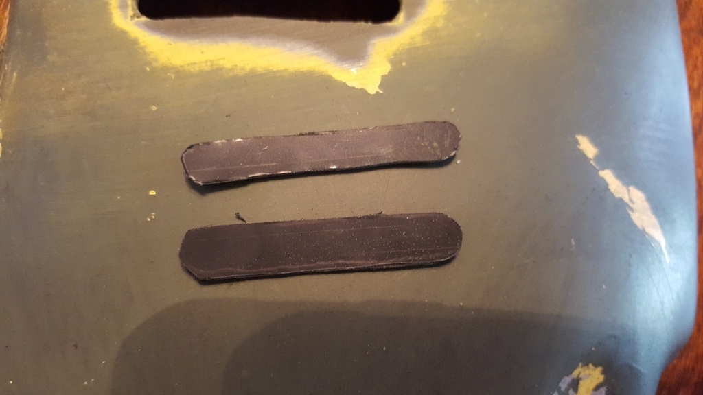

Hey great work so far, I was just wondering what did you use to cut out the slots in your chest armor? The slots in my breastplate are good but need to be slightly bigger and I don't want to damage it
I started with a dremel (actually a Foredom tool, but same difference) to cut the slots slightly undersize and to leave myself some room for error, then I used a steel file to get to the proper size and then some sand paper to smooth it out. I did try to use a pocket knife (an exacto is too delicate), which gave me nice smooth cuts, but it was difficult to control where I was removing the plastic.
If the slots don't need to get much bigger, you could use coarse sand paper (about 60 grit) and then use fine to smooth out the finish.
