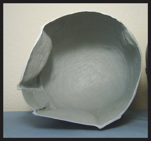

I just received a mystery bucket, but it has a rough fiberglass interior. How can I smooth it out without sanding and poossibly weekening the helmet.
How rough? Exposed fibre? Spray-on pickup truck bed liner works well on that. If it's something else, see if you can get a pic to give us a better idea. Good luck!

I would still use sandpapper. (not a rotary tool or any other machine.. manually) Just to get the roughness out of it. (there is no way you'll be able to sandpaper all the way through and weaken the helmet)
Then perhaps use the bedliner or any other filler (bondo/gelcoat?)
Oh.. and wear gloves... glasfibre splinters hurt like hell and you can't get 'em out..
and some foam afterwards?? maybe that will cover it up a bit, or glue some cloth on the entire interior?
There is also a spray on Plasti-Dip. Go to the local hardware store. I got a can at Ace Hardware in town. I used it to spray onto my pair of gauntlets, because they to have fiberglass on the inside. It is made by the same company that makes the canned plasti-dip that you can use to dip tools into to replace the plastic grips.

This is a MARROW SUN MS BUCKET INTERIOR....this is how it comes...Great Bucket...NO sanding....Maybe a Black Spray to Darken...and tons of room!!..:thumbsup:

mine was so thin i could almost see through it in spots. i sanded out the inside as much as i could and will be just lining the entire thing with foam.

Go get your self some 60 grit sand paper and go to town!!! I had to do the same with mine. Get some fiberglass and do the inside of your helmet make it a little stronger.

dunno about yours, but mine was rough to the point of actually having jagged spears of fiberglass sticking out... beyond even the grittiest of grits ;)
i eventually got it under control... dremel grinding bit to wear down the BIG lumps, then some bondo to fill in the parts that were so thin i could see through them.
