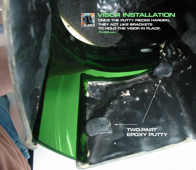

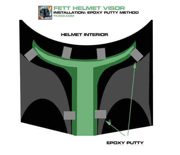

I use the dark green visor here:
http://www.rjsafety.com/EH21.html
scroll down for "HF4118-DRK Dark Green Faceshield $3.65"
It's flexible and soft enough to cut with scissors, yet thick enough, so no need to heat it in the oven. To attach it to the helmet, I just used two-part epoxy putty. It hardens to a metal and sticks to anything. Score the helmet surface with an exacto blade a couple times, then apply putty. Hold the visor in place until the putty hardens to a metal - about 3-5 minutes.
