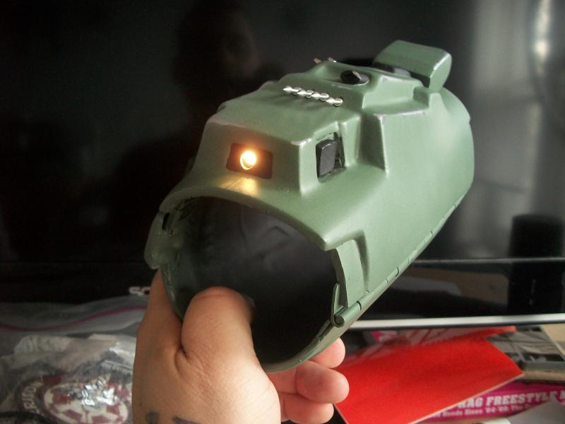

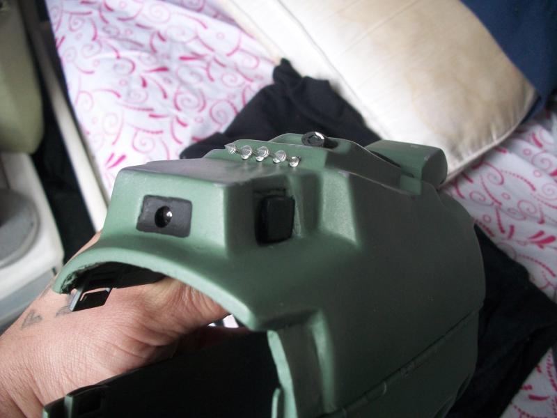

Heres pics of the light mounted in my FP gauntlet.

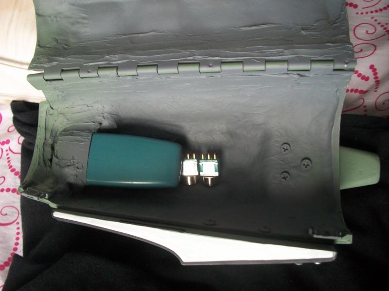

Just the front part of the light is attached to the gauntlet. The blue section comes off to house/replace the batteries. Also in inner section of the front can be removed to change the bulb.
Mind you, these gaunts are fiberglass with a gel-coat outer layer...i had to dremel away just about all the glass to get this to fit. So much so that some areas were just gelcoat. So, after i glued it in i filled the cracks/gaps on the outside with zap-a-gap superglue and sanded it smooth. Luckily its undetectable. I feared i messed up a perfectly awesome set of gaunts!
Also, keep in mind the screen used gaunts were vac formed, so the issue of material thickness was probably , well, not an issue. So my bet is the 6050 will fit in a set of vac formed gaunts just fine. The 6050 does in fact JUST make it in the glass gaunts...barely, but its in there and works!
Im not thrilled with how deep the button appears to sit in the gauntlet on the outside, but it was the best i could get it. I'm pretty happy with it though.
