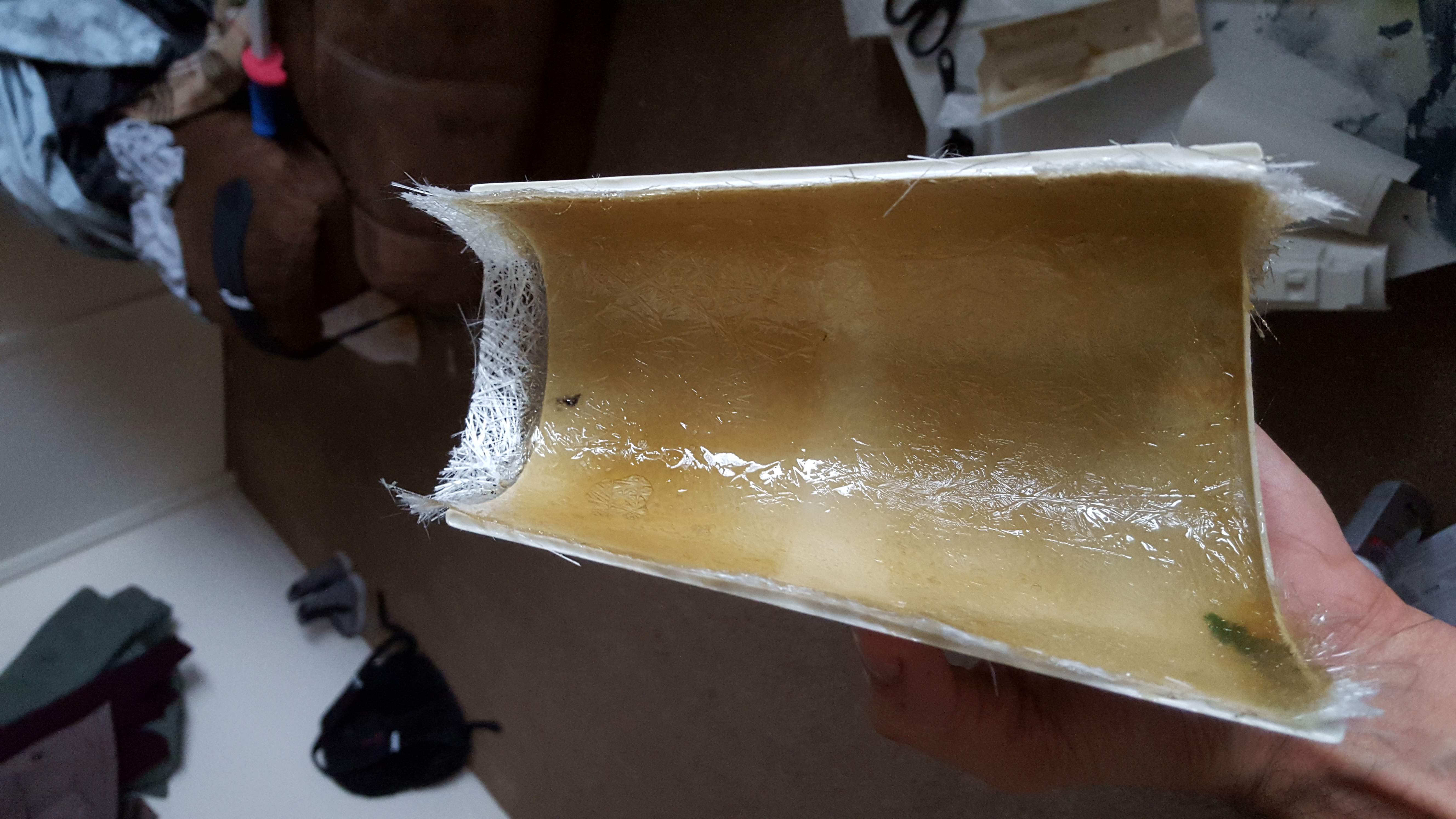

I'm about to fiberglass my MOW gauntlets, just want to make sure I get this correct: I just need to thoroughly wash the gauntlets with dish soap to remove any release agents... then I place the fiberglass mat on a brush the resin over it? Or do I brush on the resin, add the fiberglass mat, then brush on more resin?
I would wash them, then sand them with some 180 or similar grit sandpaper. Then wipe with some acetone.
After cutting you're fiberglass to size, I'd mix the resin and brush a coat down prior to laying in the FG. Then lay glass, brush on to fill fiber and remove excess. I'd start small and do one gaunt at a time, and mix more resin for the next. Sucks to get caught up with it kicking off on the cure.
uploadfromtaptalk1455581668595.jpg this was fun
Not at all, I was really nervous about it at first, but it was SO simple. Buy more than one brush for applying the resin and buy several disposable plastic bowls to mix your resin in for each separate batch.

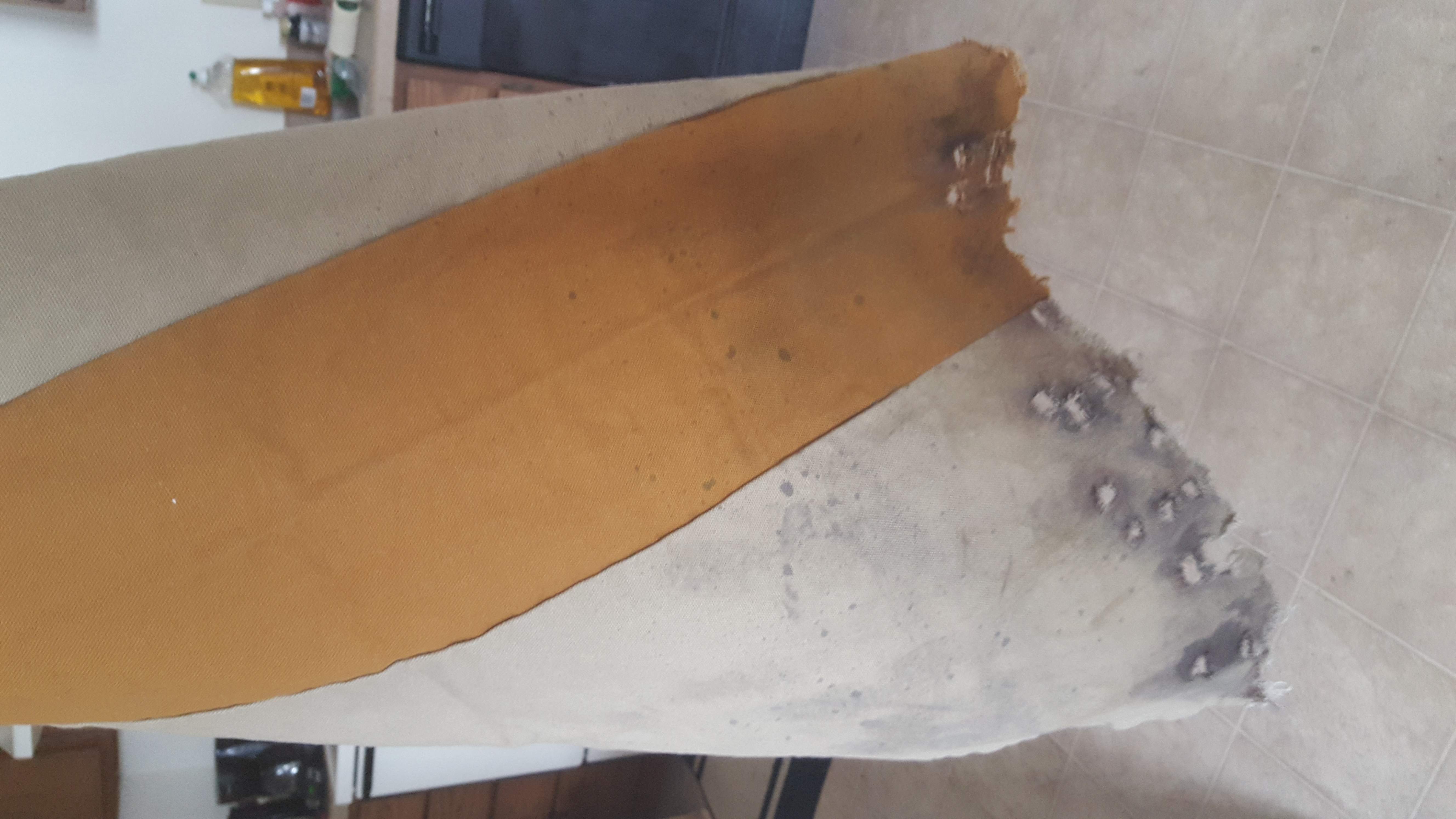

uploadfromtaptalk1456419208856.jpg Weathered the cape a bit, didn't want to over do it as most of the reference pictures don't show too heavy weathering.
