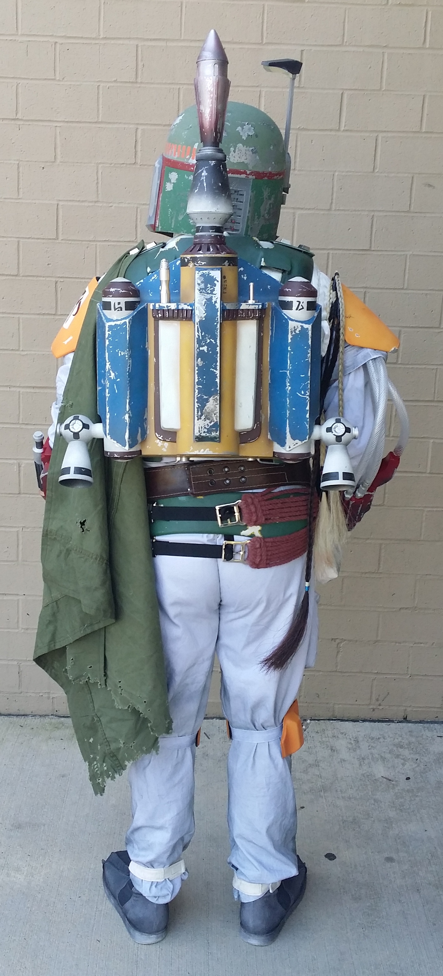

Looks awesome! you might want to toss some weathering on the backside the front looks awesome but the back is almost perfectly clean!
