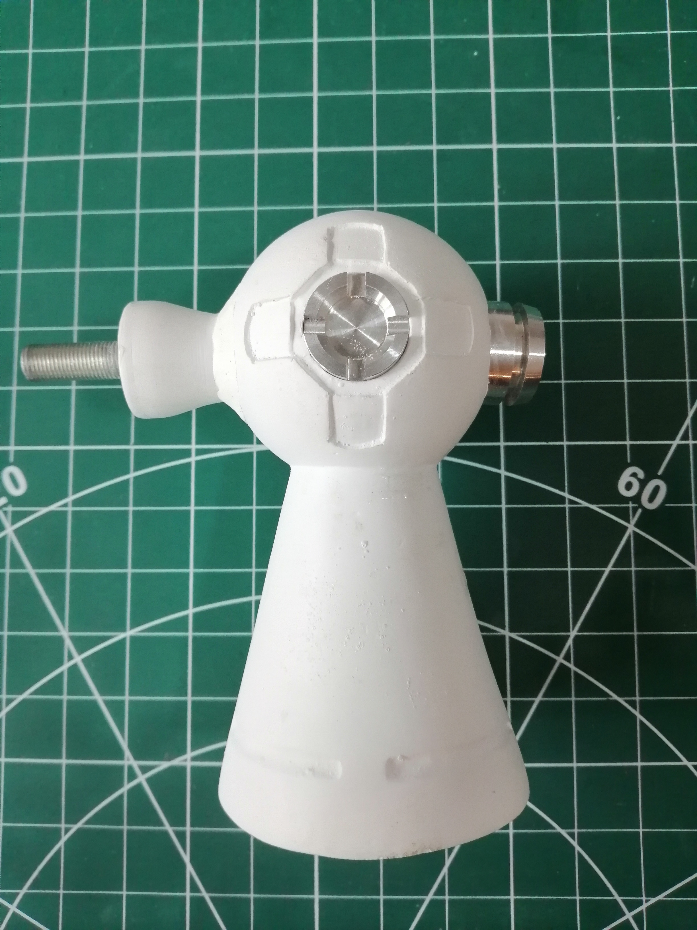

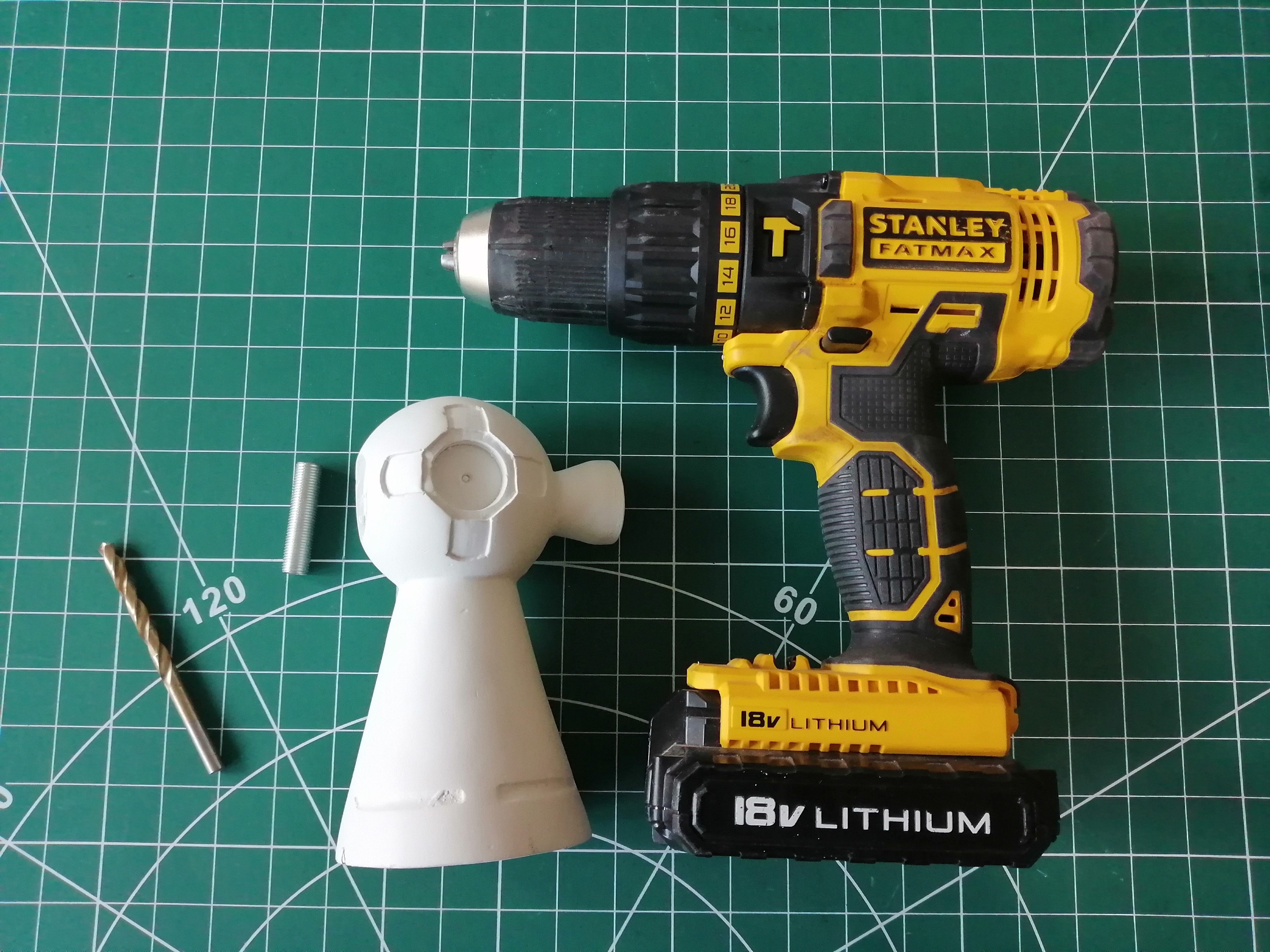

First up on the list will be modifying and fitting the thrusters. 10mm threaded hollow tube on order...... Time to drill out the thrusters....
Thrusters

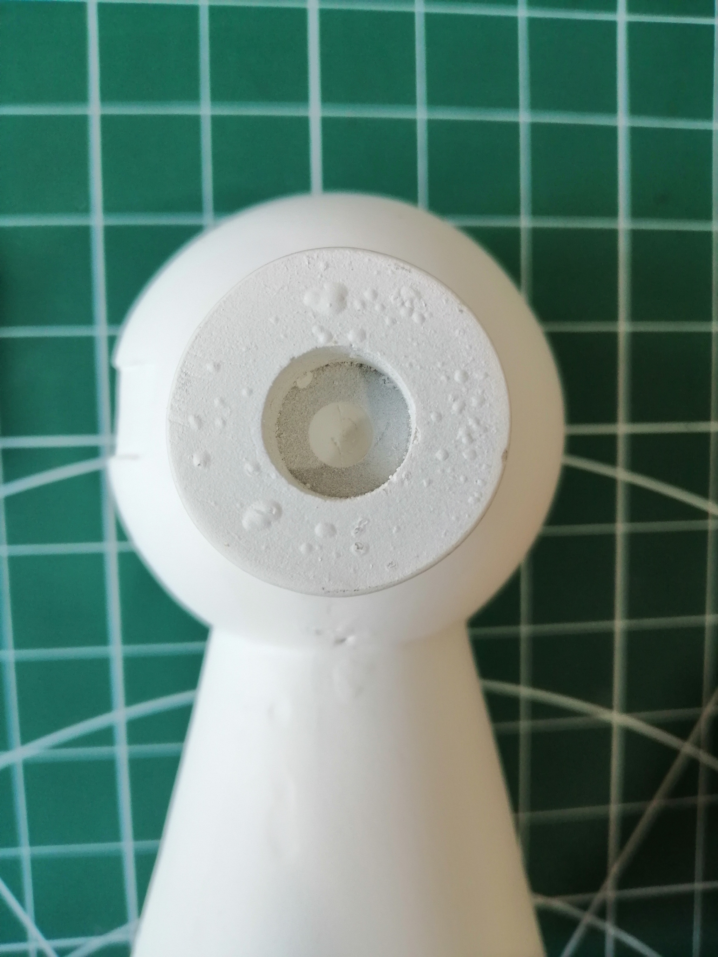

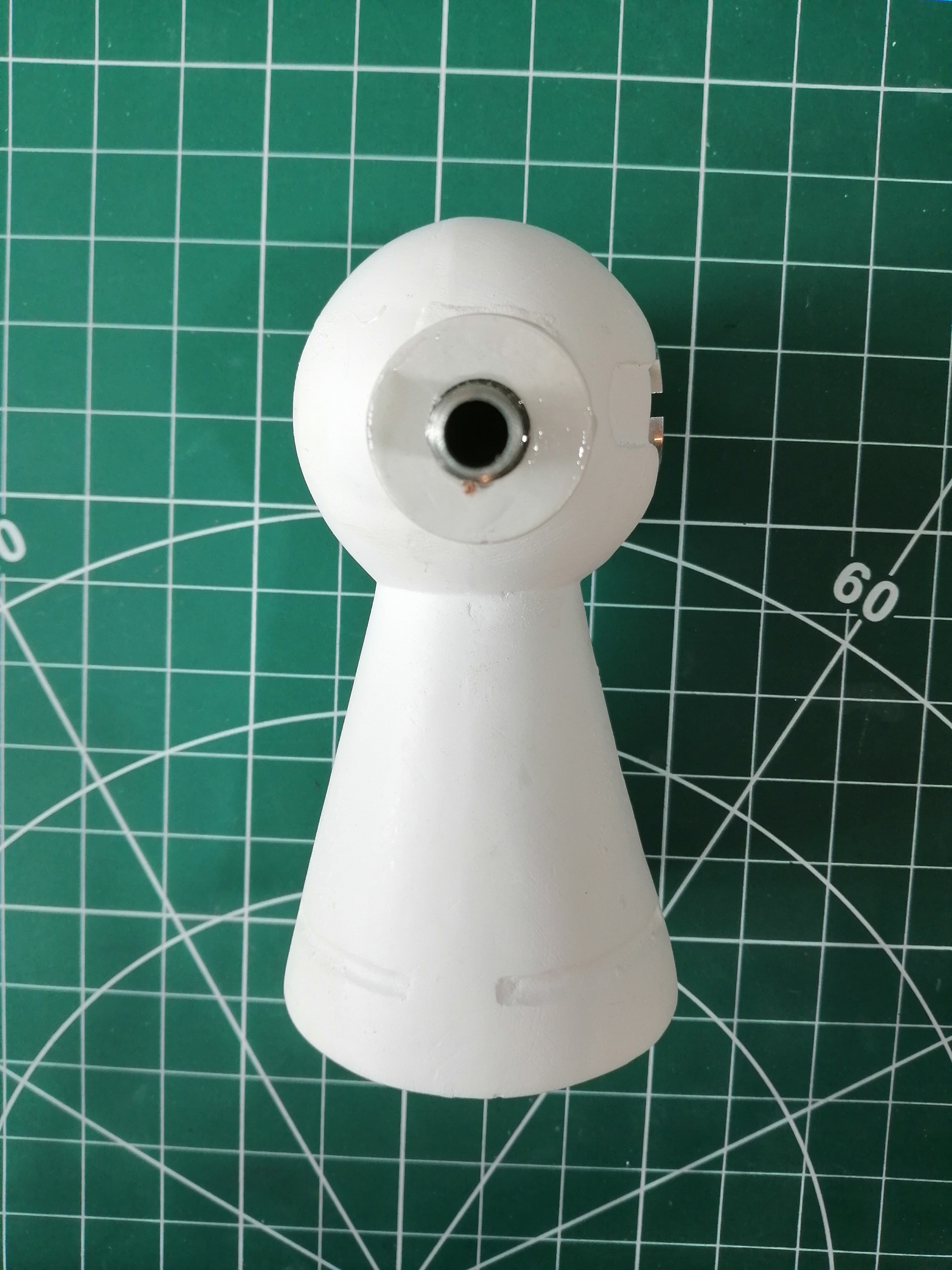

This jetpack will be fitted with a remote control smoke system in the main body to both of the thrusters so the hose needs to feed into the nozzle bodies through the fixings.
Hopefully an electric light fixing which consists of a threaded hollow tube with nut should be suitable enough for the job.

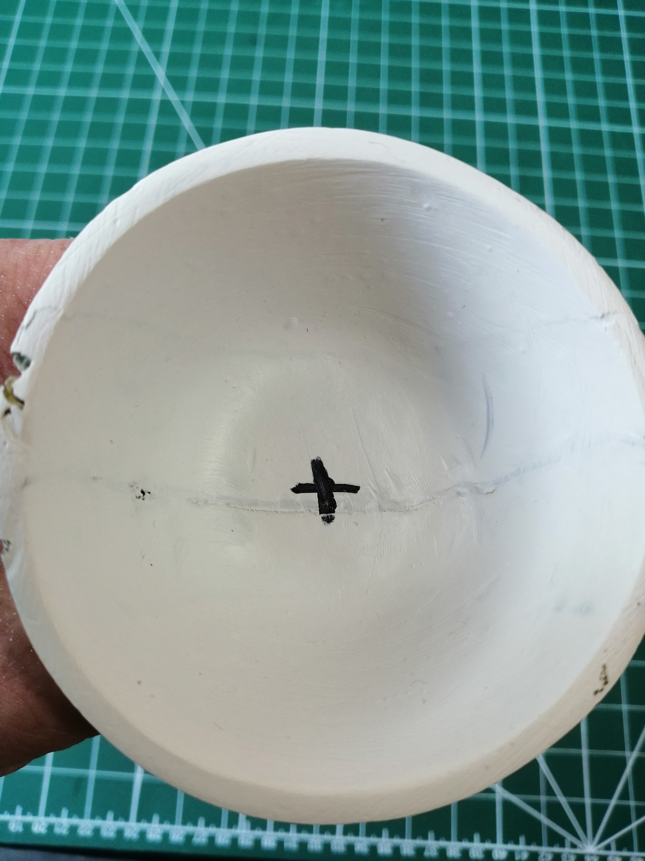

Drilled a hole from the side and underside
Then epoxed in the tube. When it was dry I test fitted the metal bits
Just waiting on thruster nozzle disc to arrive.

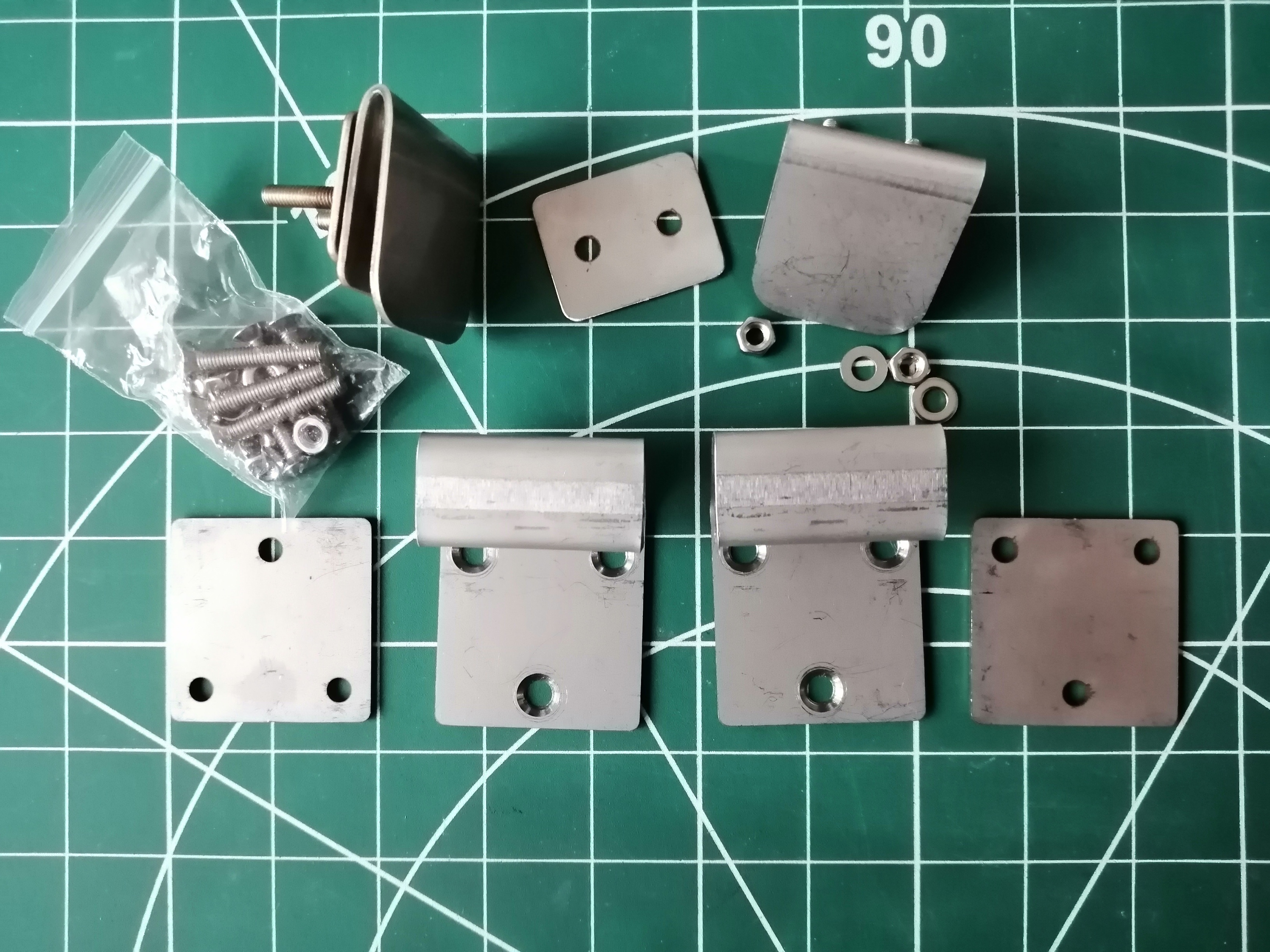

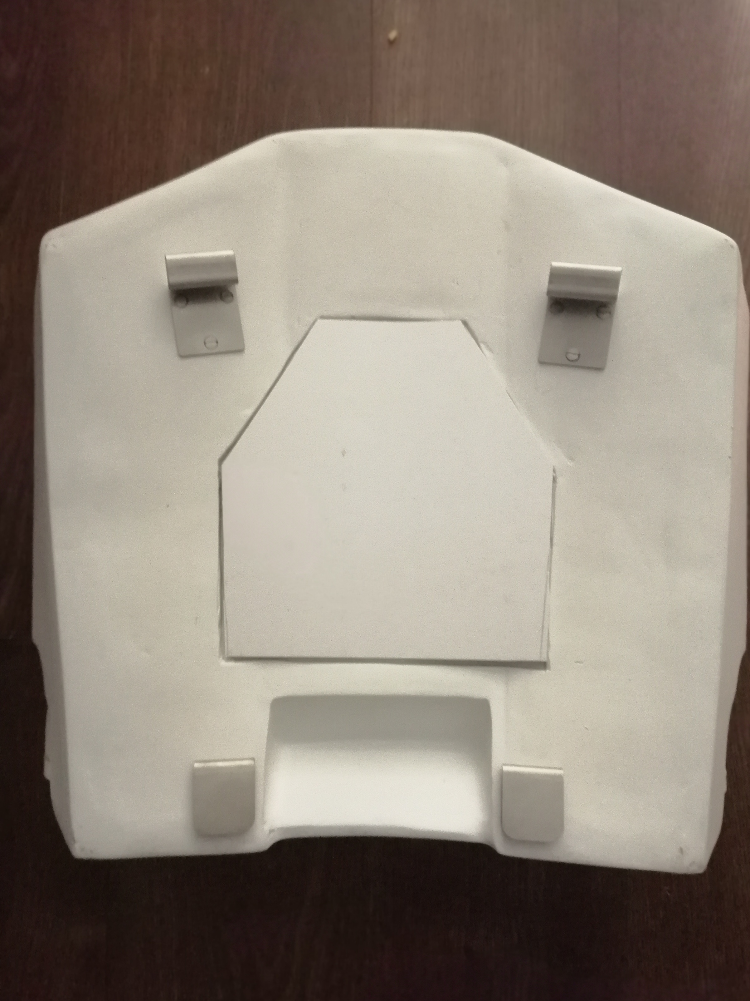

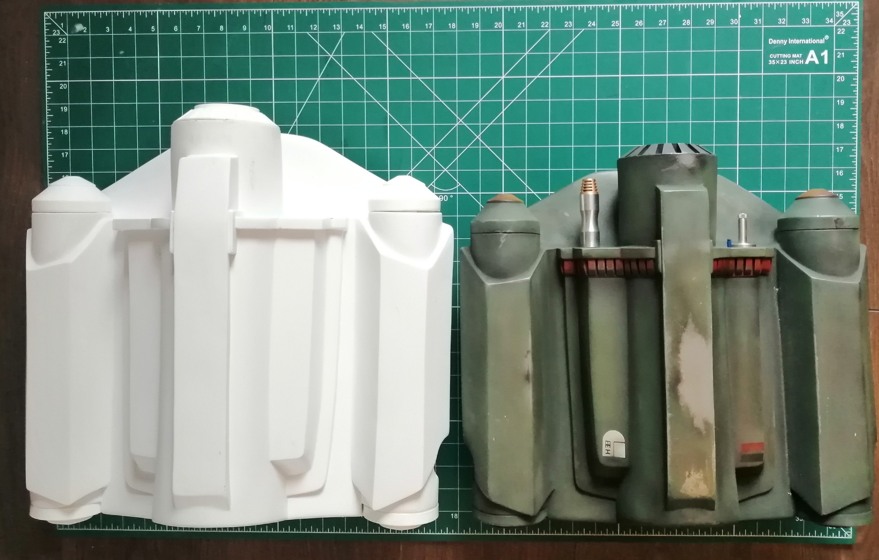

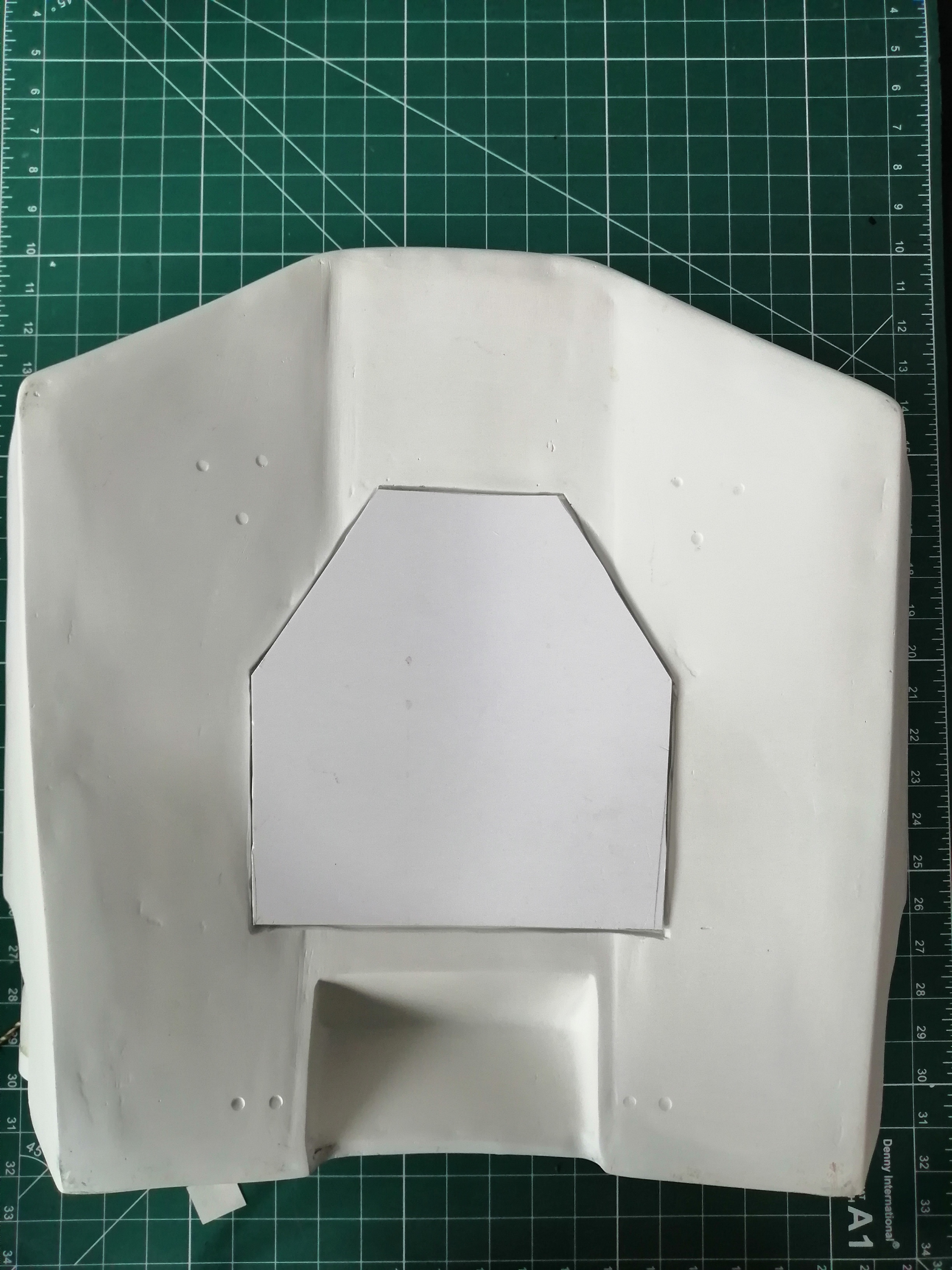

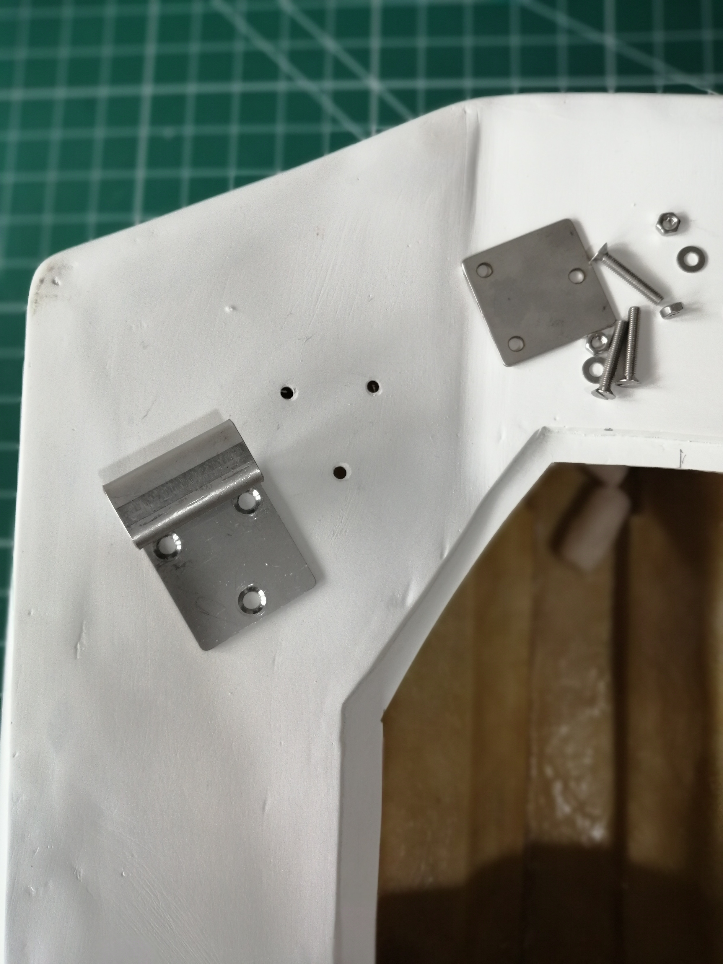

The metal pieces arrived from Dark Side over the weekend so I fitted them straight away. Using RafalFett 's excellent schematics

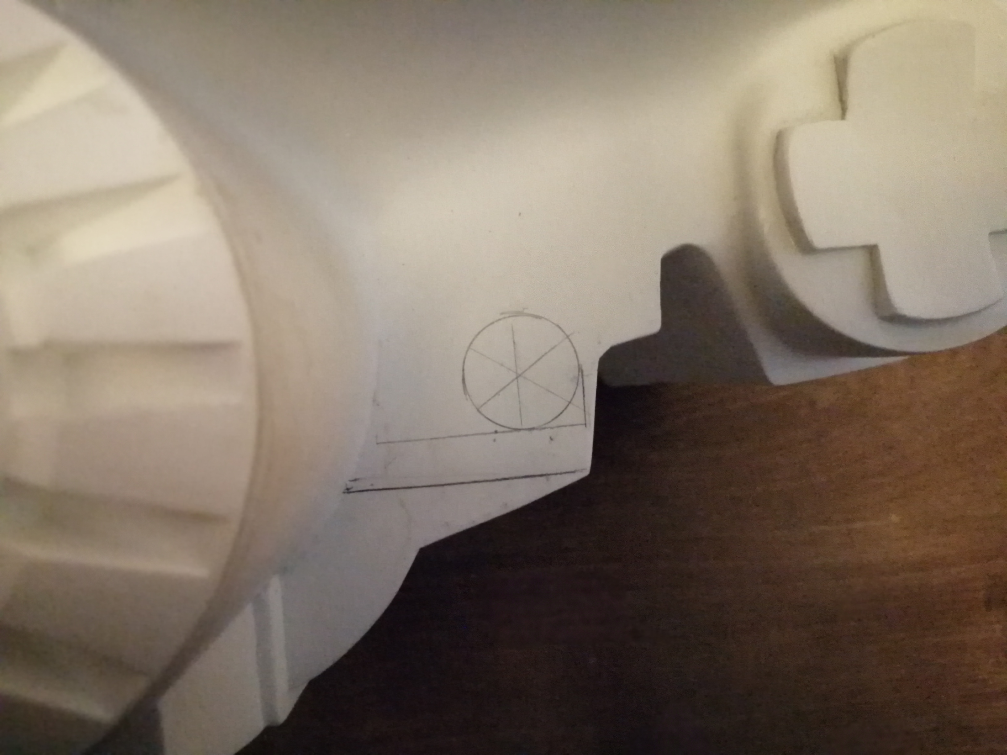

I drew the lines and positions of the Stabaliser and beacon.
Sorry for the poor images its a tricky area to capture easily.

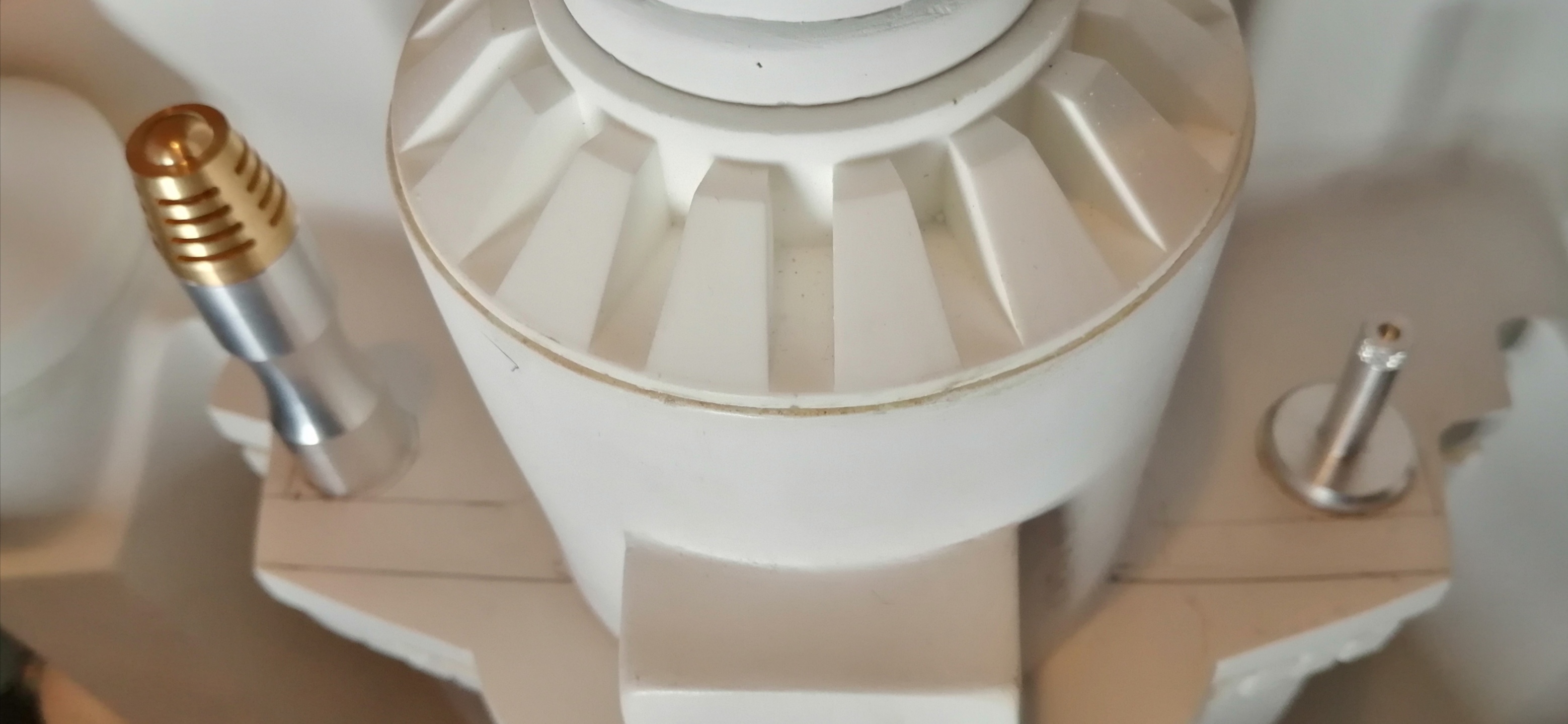

Drilled the holes and fitted the pieces
Just need to wire up the beacon and attach the dental file once the JP has been painted.

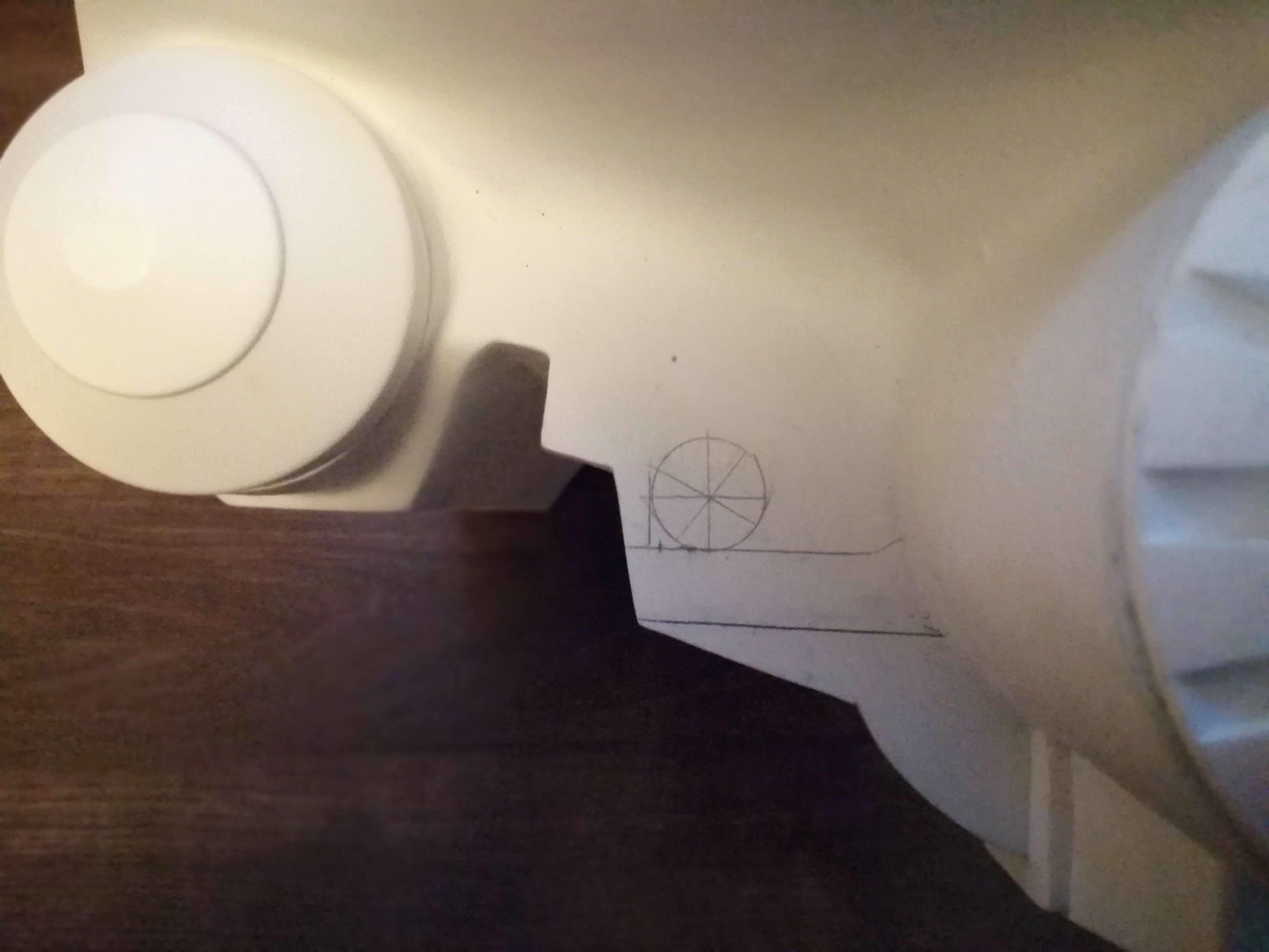

Next up cutting the jetpack body underside vents hole out for the speaker.
