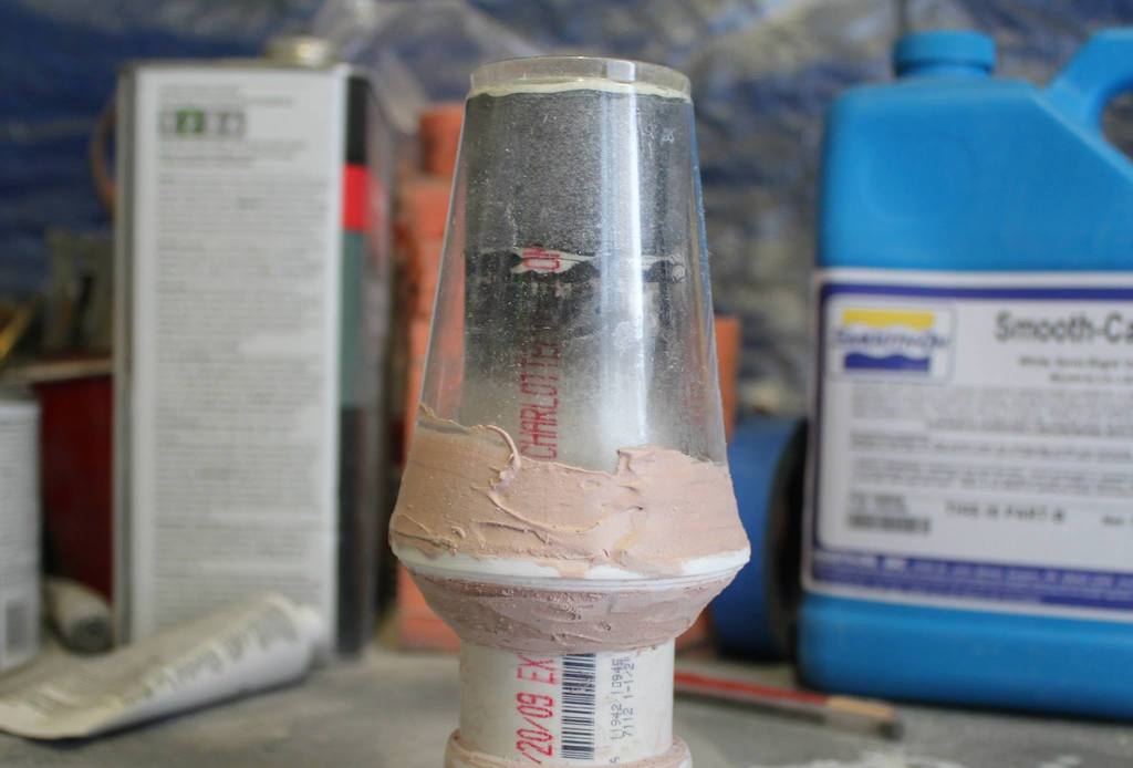

Started on the lower rocket. This is a plastic cup, some styrene sheet, a 1.5" PVC pipe and bondo.
I may trim about 1/2" off the top, not sure yet, it seems like it MAY be a little tall. But anywhys, here it is so far, obviously not done :)

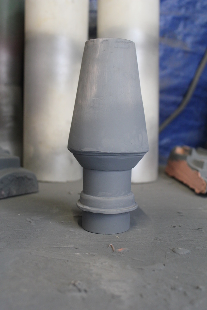

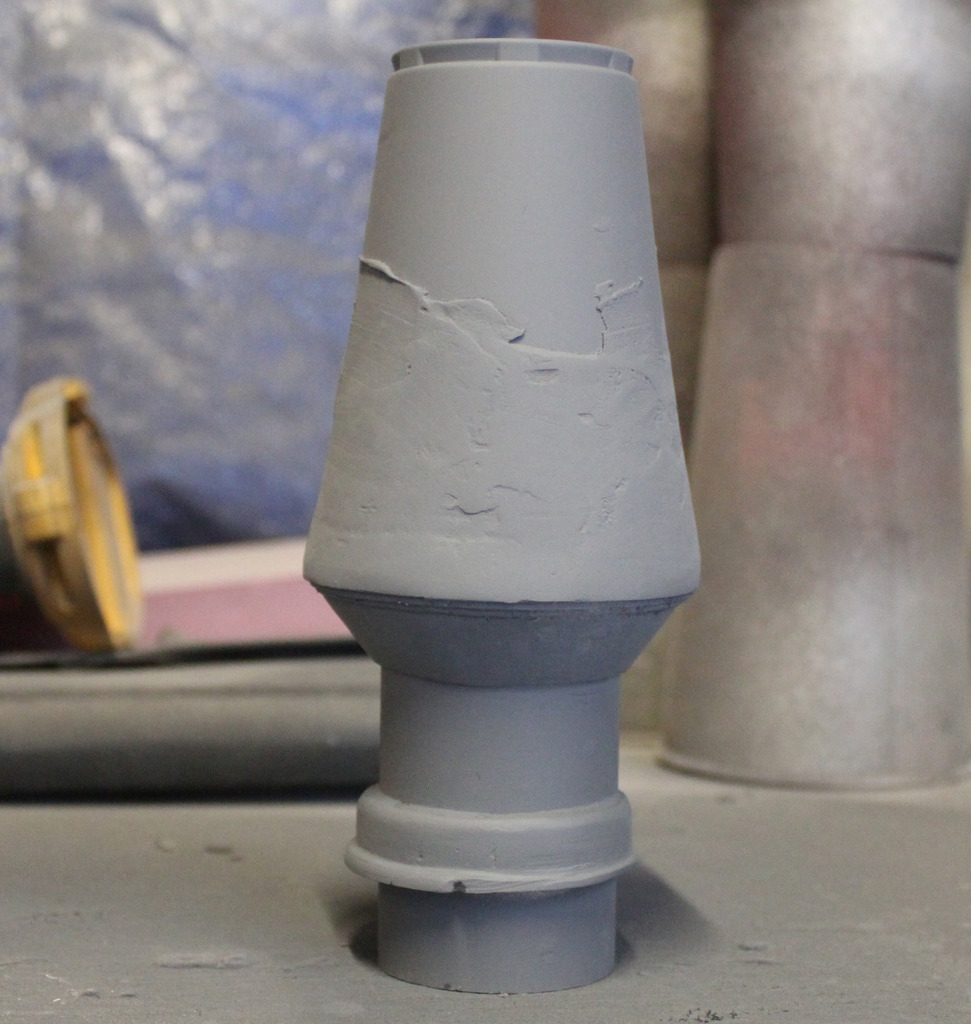

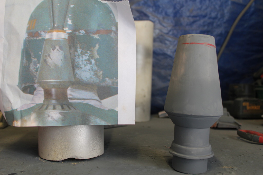

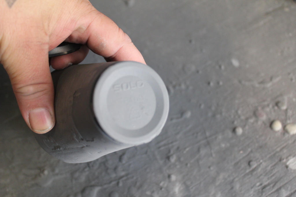

Ok some more of this done today..
This is my favorite heheh... SOLO
I think i may need to cut a little off the top..(like about where i put the orange mark)what do you guys think?

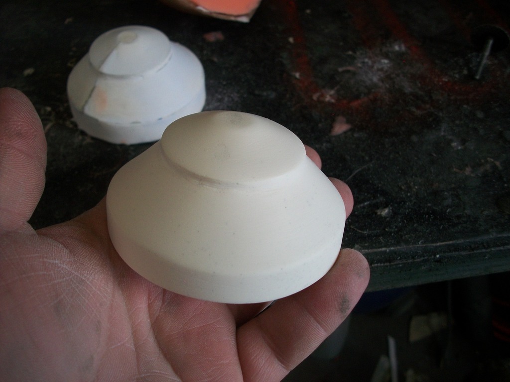

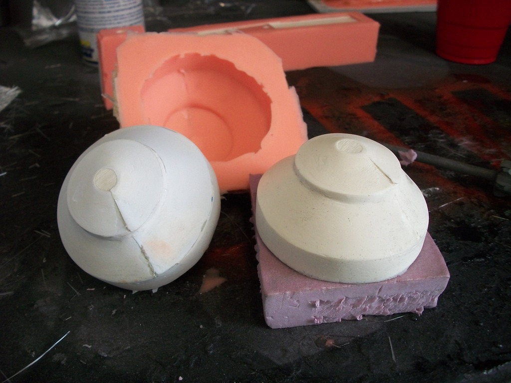

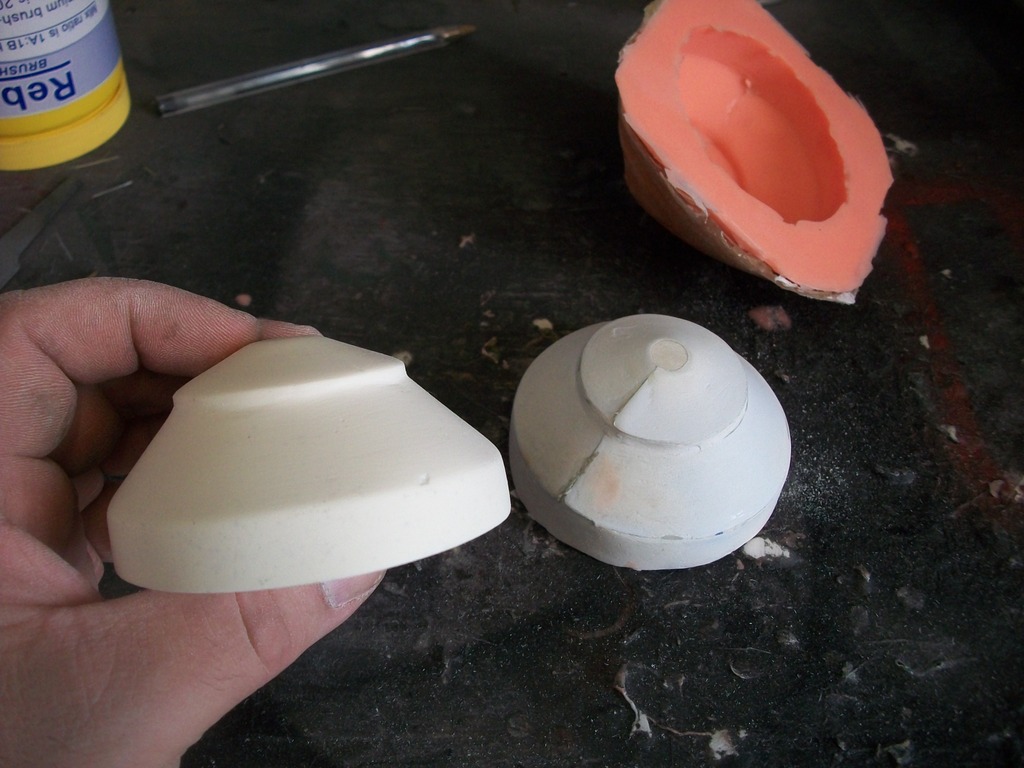

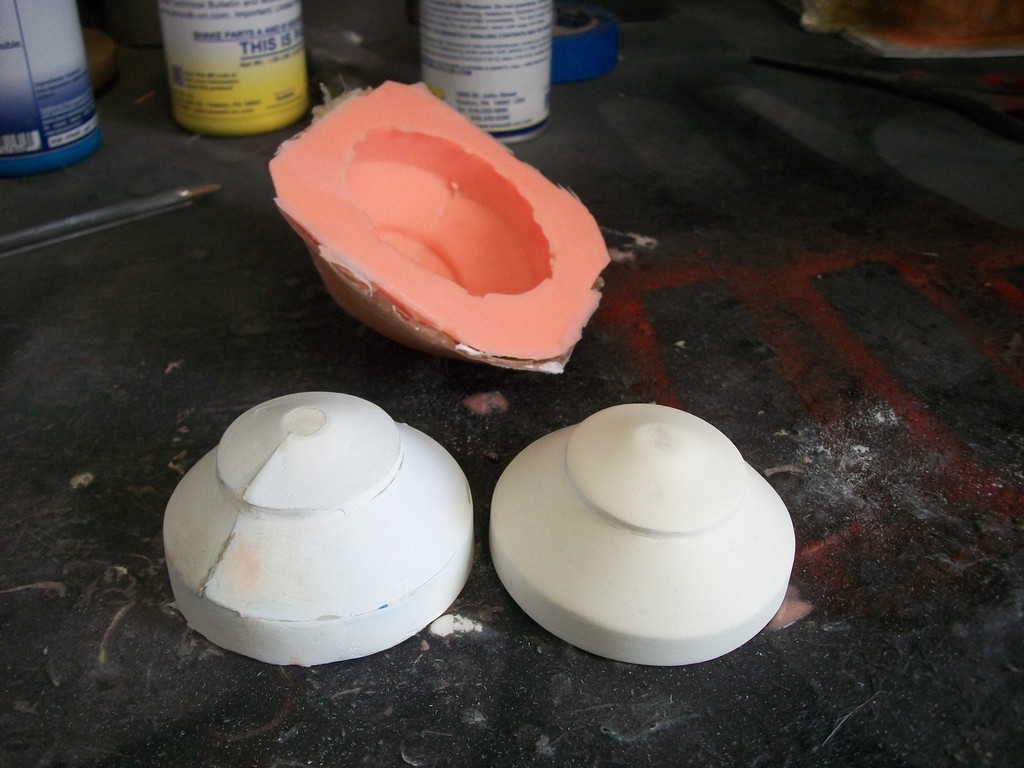

Ok i did a tiny bit of work on this today... i made a mold of the top cap a couple of days ago ...
....and i pulled my master out of it and cast a resin version..here it is next to the original before i cleaned it up..
Here it is cleaned up
Going to need to do this same process for the lower rocket also.....as well as the upper rocket and the thruster cones

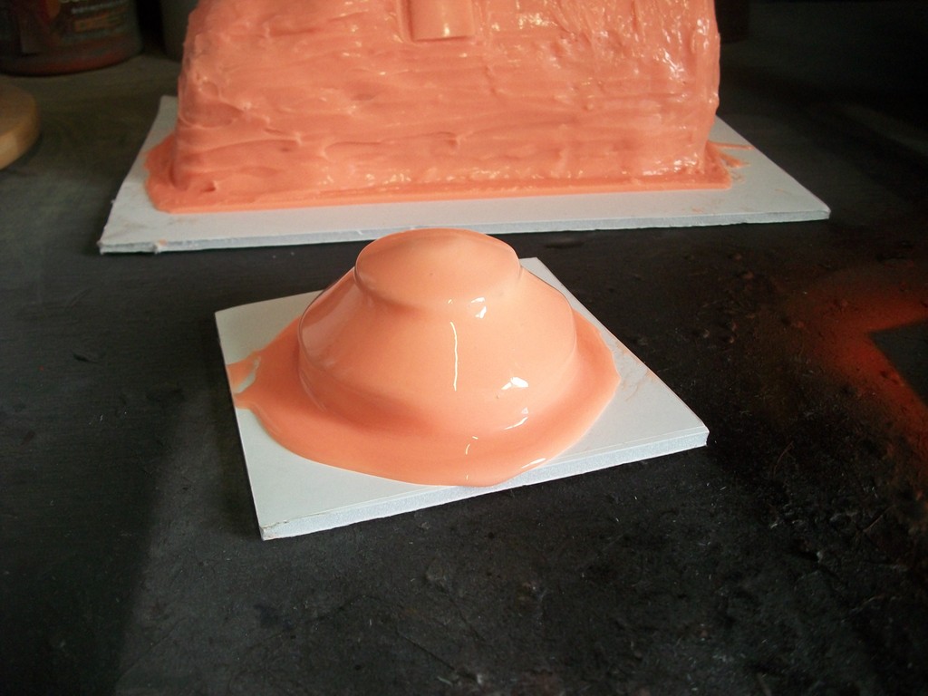

Still working on the upper rocket from sheet styrene and thrusters as well. I molded the ball part of the thruster so i will be able to cast 2, and found a plastic champagne glass i used for the cone part. Just took a crap mold off it and cast 2 soild cones that i will cut down and partially hollow out for the cone part of the thrusters.

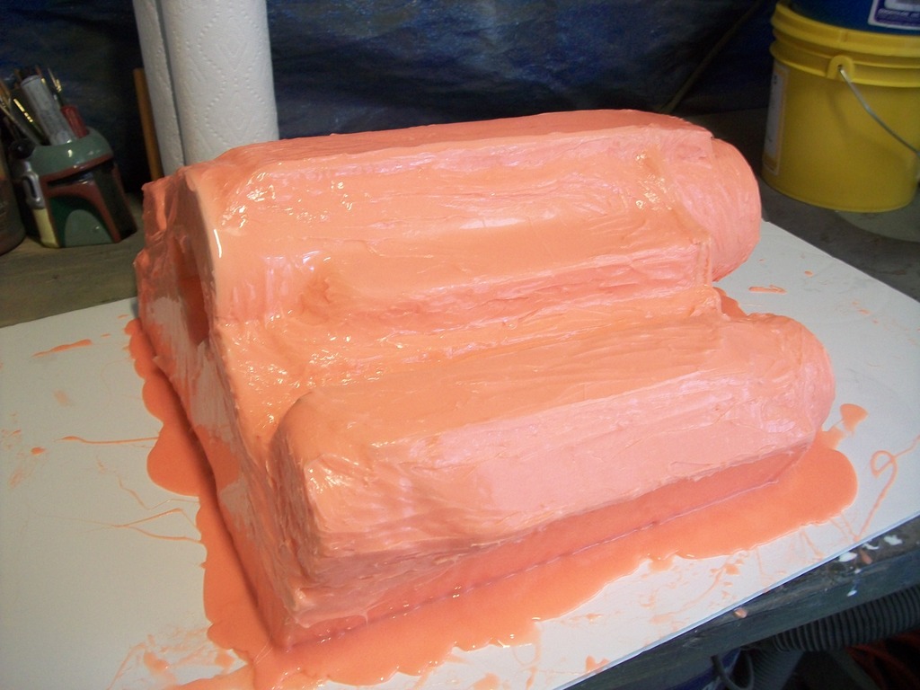

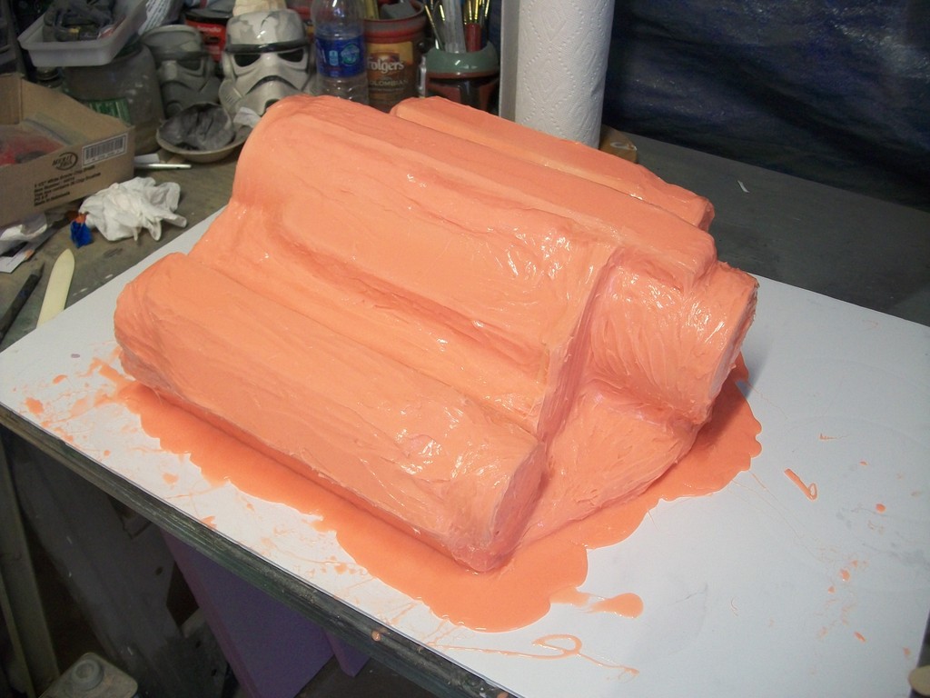

Ok here is the main body in 3 layers of rubber. 2 brushed on at the normal consistency of Rebound 25, and 1 with a thickener added to avoid too much run off and keep it where it needs to be. I added one more with the thickener and made it as smooth as i could and then added one more without the thickener. I will be flipping it over and doing the back in the next couple of days. This should be sufficient to get at least 1 cast out of it. If im lucky i can get 2 and make one into a custom design.
