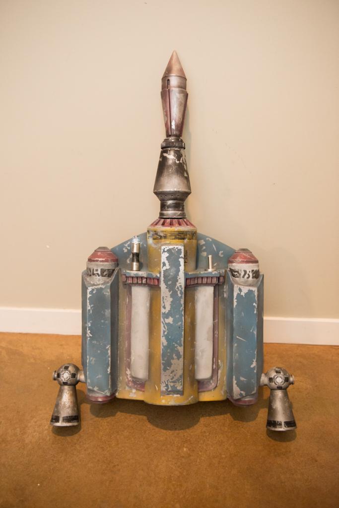

I'm done the paint job - will take some pics later. As I type, I'm installing the smoke machine.
Jetpack is almost done - I can see the finish line.

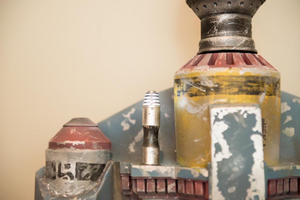

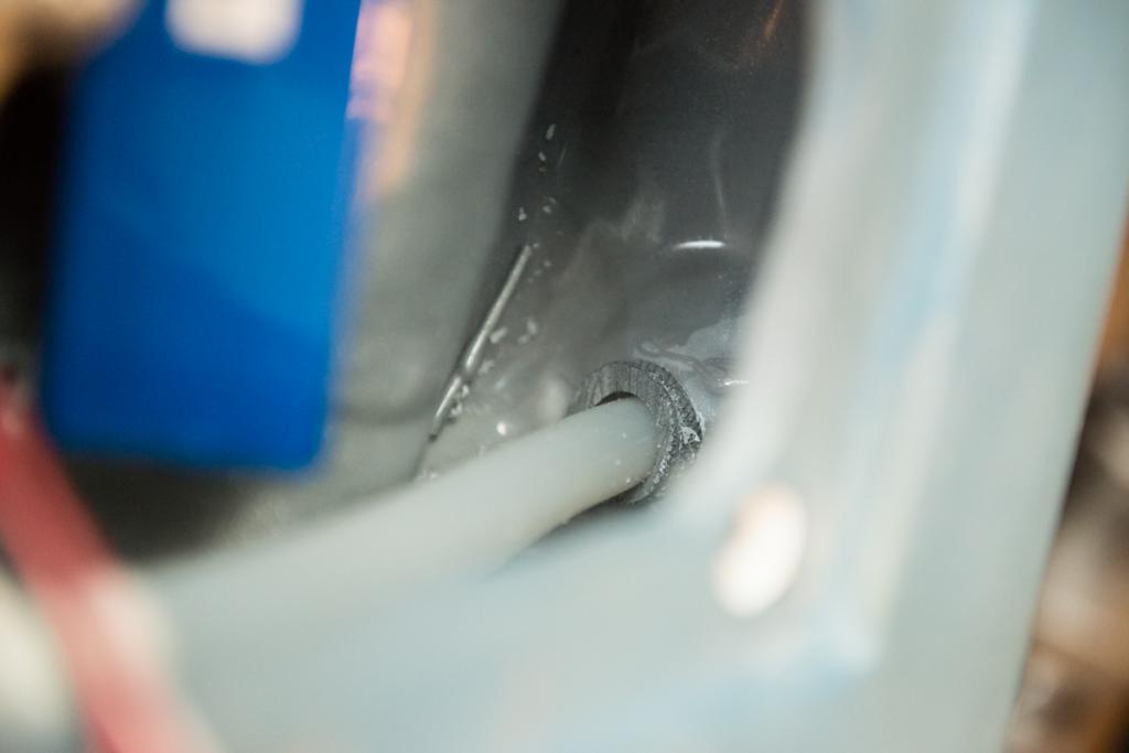

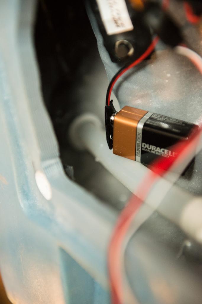

Today I spent time installing the smoke machine. I took a small corner brace and hot glued it into the body of the jetpack, then used industrial velcro to secure it. I used velcro on the 5s Lipo battery as well and connected the active armor setup for the beacon light.
I also tried to create an enclosure for the backplate. For some reason, the backplate of the jetpack was crazy large compared to the opening, so I had to use my dremel and trim it down. I then took small magnets and hot glued them to the backplate. Lined up where I would put the magnets on the pack itself and trimmed halfway down. Because of the thickness of the magnets, I had to be careful about how far down I was going to go. I hot glued the magnets to the pack. For some reason, it does not close properly and I have to figure that out. I might change out the puck magnets for magnetic strips. I want to avoid the screw method as I will need to have easy access to the smoke machine. How do you close your jetpack up? Hell, velcro would probably work better than what I have. (Actually....I might go do that now... :) )

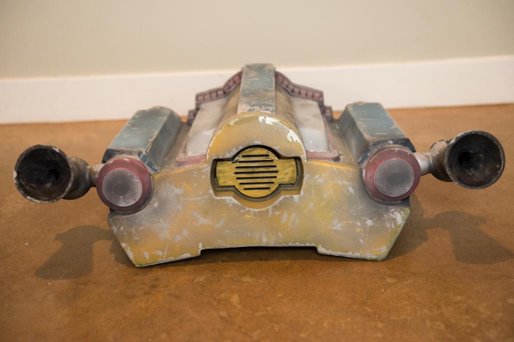

Lastly, my thrusters are currently just jammed into the slots. they seem to be quite snug, but I think. a good little nudge on something might knock them off. Based on what you see inside, any thoughts on how to secure the thrusters temporarily? I can glue them, and that's fine, but I'd rather not for storage purposes.

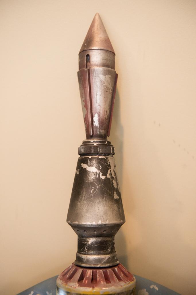

4) Touch up the colour on the exhaust vent....ugly yellow...yuck. Needs another few coats of grime :)

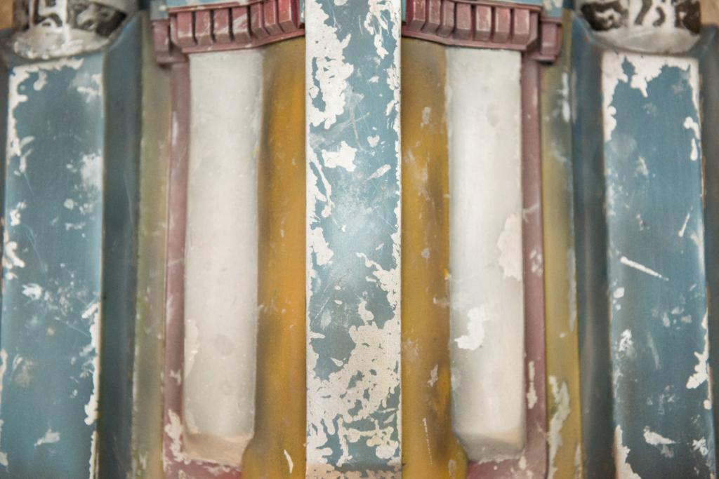

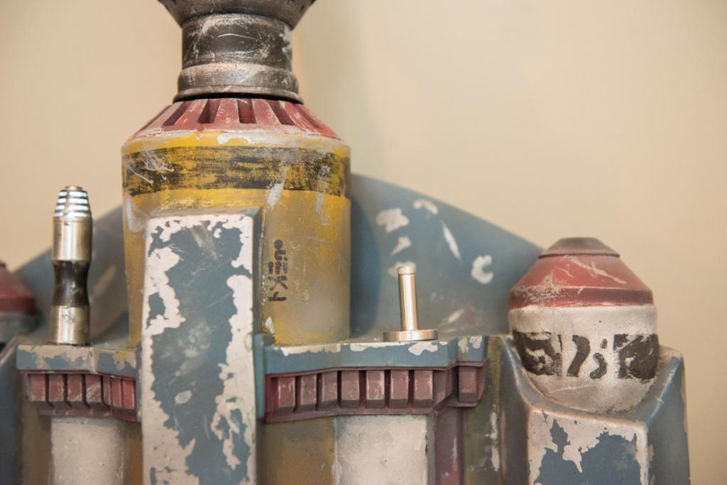

Here are some pics of what I worked on today :)

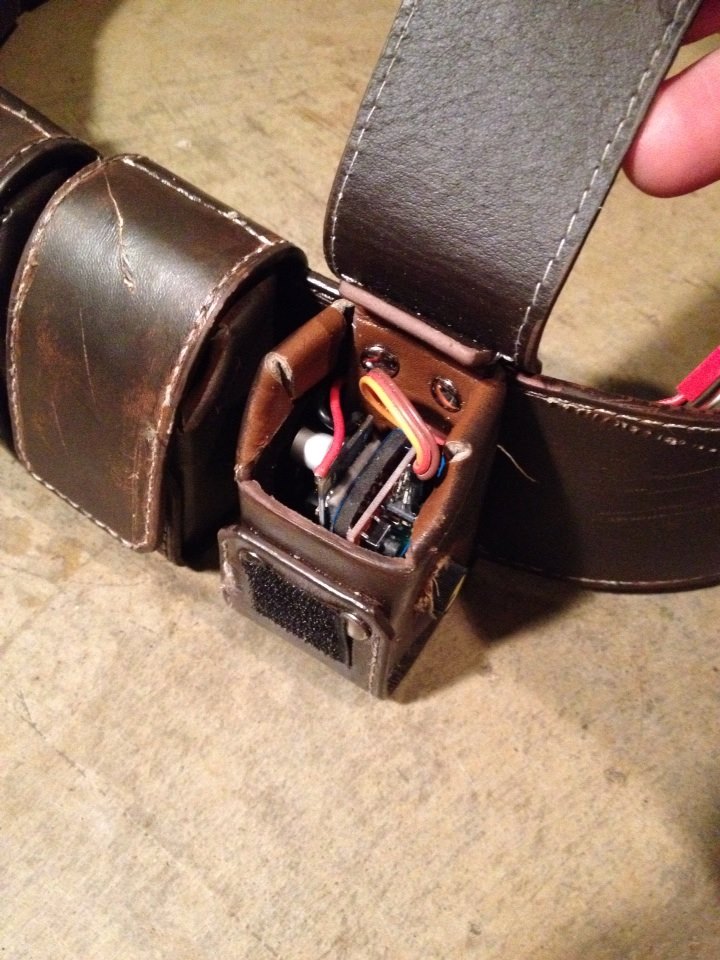

Took my drill to my ammo belt this evening and installed the servo for the smoke machine. The knob comes out just enough that I can turn it with my fingers - so it's got a nice low profile and isn't distracting. I do need to change that yellow though :) The wire runs along the inside of my ammo belt and will connect with the two wires that will leave the jetpack through one of the greeblies I will install later.
Hurray for functional pouches! :)

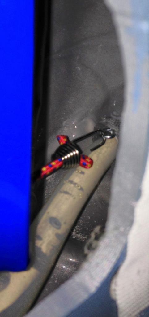

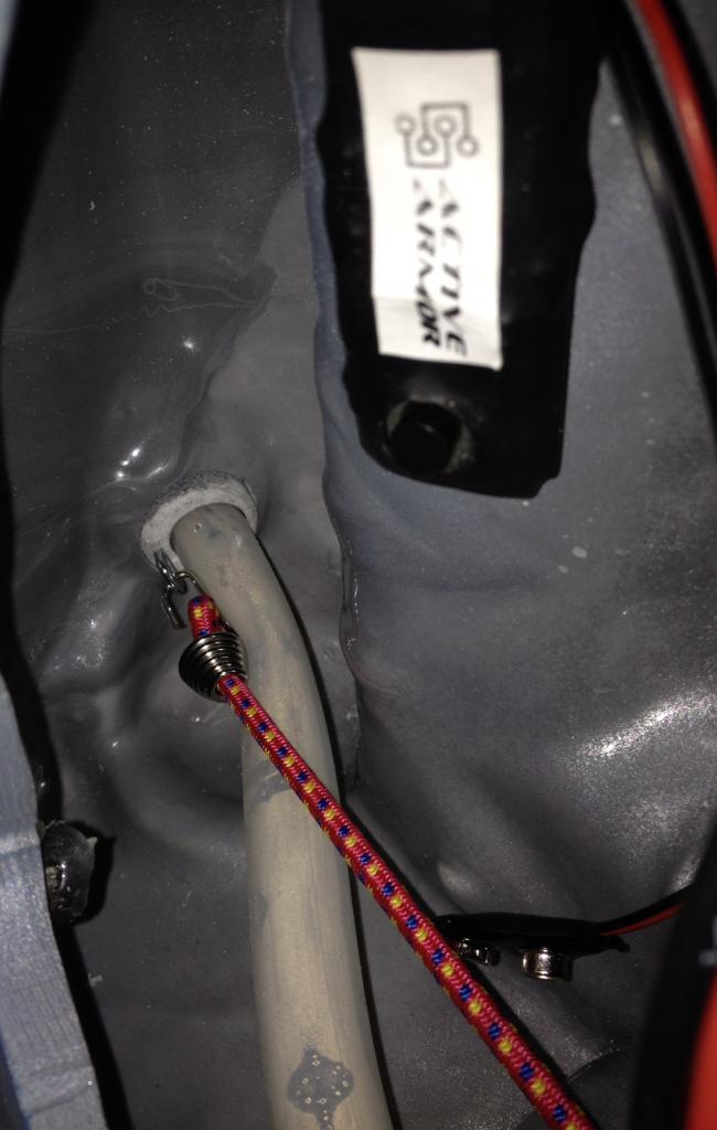

I managed to find a way to secure my thrusters without gluing them, and without the bar. I screwed in a few hooks as suggested, and used a bungie cord to hook both together. It's getting cramped, but everything is in there. Because of the lack of space, it's a bit cumbersome and will take some getting used to. The important thing is that it works.
Apologies for the phone pics, it was a last minute deal.
