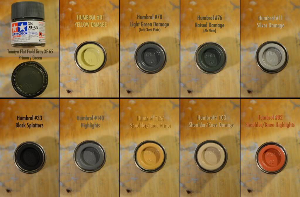

These are the paints I used:
The XF-65 Flat Field Grey is an acrylic whereas everything else is enamel. Everything had a Testor's Dullcote topcoat to protect it.
DeathProof
God I love this build thread. One question though. You mentioned the green damage colors on the Chest (Humbrol 78)and ab (Humbrol 76), but not the collar and cod. The Stencils call for Hunt Club Green Pre Pro #3. Do you remember what you used? Thank you!
