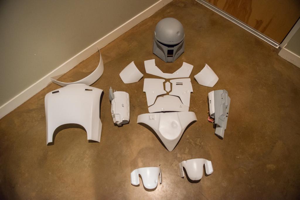

Update : Armor Arrived!

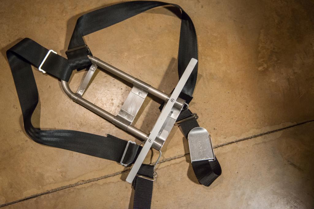

My armor has finally arrived!!! Whoop whoop! Now begins the awesome and fun task of painting :) I have my schedule laid out and I should be all good in time for Vancouver Fan Expo which is in exactly 6 weeks. Also, my metal harness came in from BigDane. High quality item if I do say so myself. It's incredibly comfy, and very light weight. I should mention though that his D rings do not currently fit over Full Metal Fett jetpack hooks. I did mention this to him, so I think he will be updating those. Also included in this post is my rough power up of JC27's rangefinder servo for a noise check. It runs very clean, with only minor tapping when the stalk is down. Very well put together kit that even a novice at electronics like me could put together.

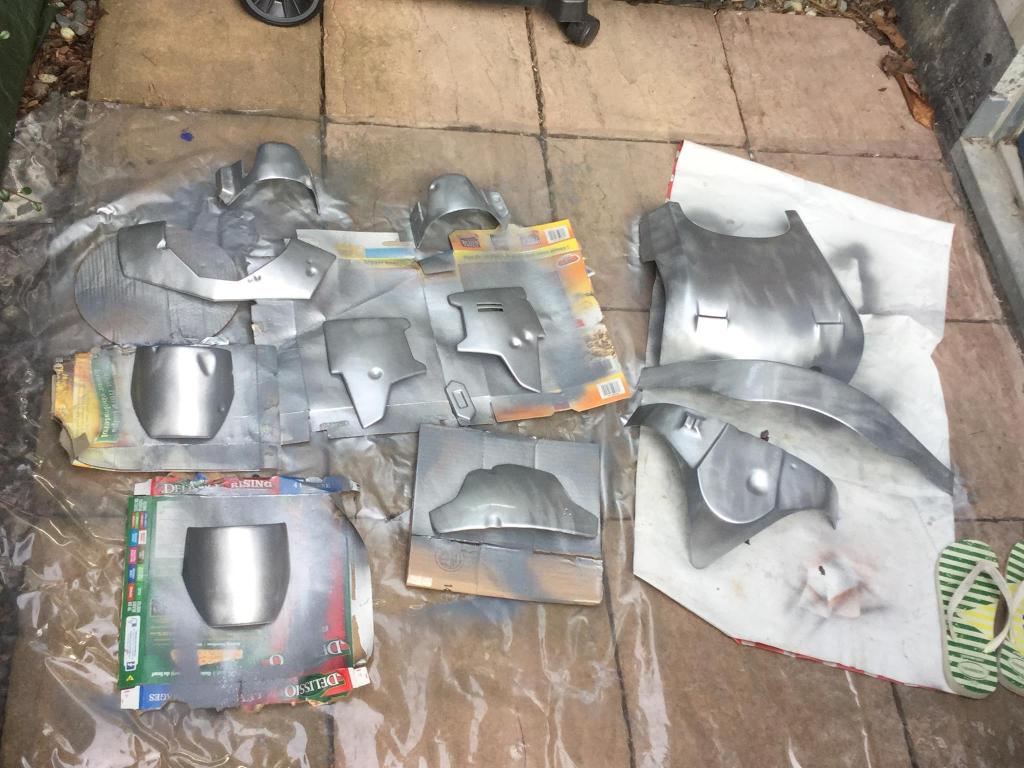

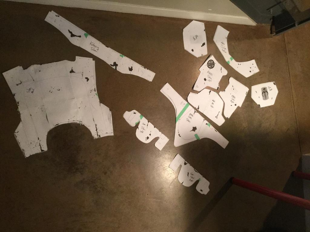

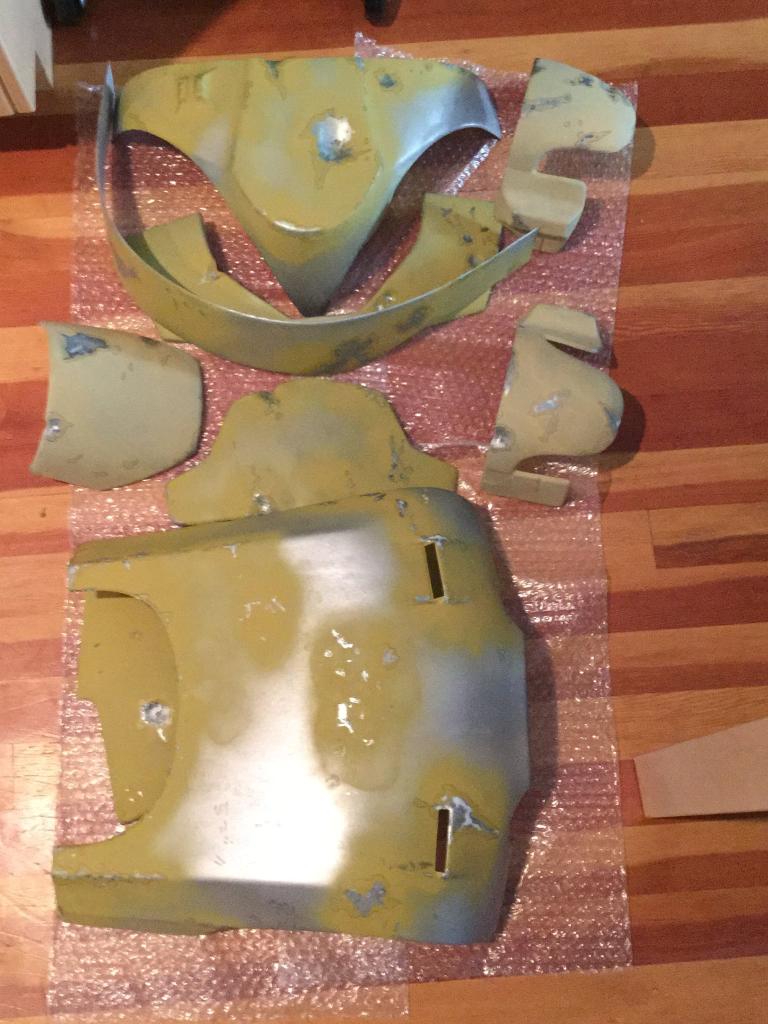

I'm plugging away at painting the armor to meet my deadline. So far, so good. I had some issues with my masking fluid - be sure to put on a GOOD COAT. In trying to do some of the finer lines, I neglected to put on a decent coat of masking fluid, thus it not doing a good enough job. Those fine lines I will bring in later topically. I'm also still getting used to finding the sweet paint to thinner ratio for enamel paints. I finally got used to it, but it definitely was a learning curve.
Here is the armor all silvered up:
This is what 2 hours of trimming, resizing and measuring looks like:
Silver masked, peeled, yellow sprayed and masked.

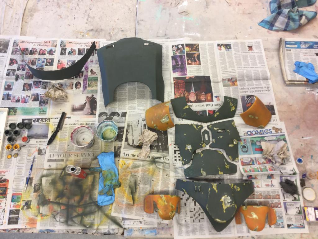

The armor as it is today. Gotta finish peeling the kidney and back, apply the decals, and then start to really have fun with weathering. When applying the decals, there is clear transfer paper around the skull and Fett symbol....does this just go on or do I have to trim it? It looks pretty glossy...
Edit - Nevermind...transfer paper comes off.....yup. I'm tired.. :)
Hard at work :)

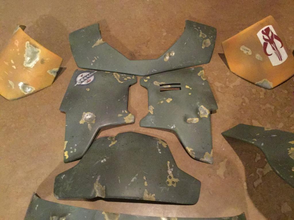

Armor all weathered up. Had some "fun" with the center diamond. Totally forgot about it and it didn't get included with the initial run of green...and now when I did it today, the greens didn't match. Must have tried to paint it 3 times today....either too dark or too 'green'. I'll work on it more tomorrow. Armor gets attached tomorrow, and I'll probably tackle the knee darts as well!
I used some browns and greys to weather, along with a matte black, charcoal, white chalk, and some acrylics.

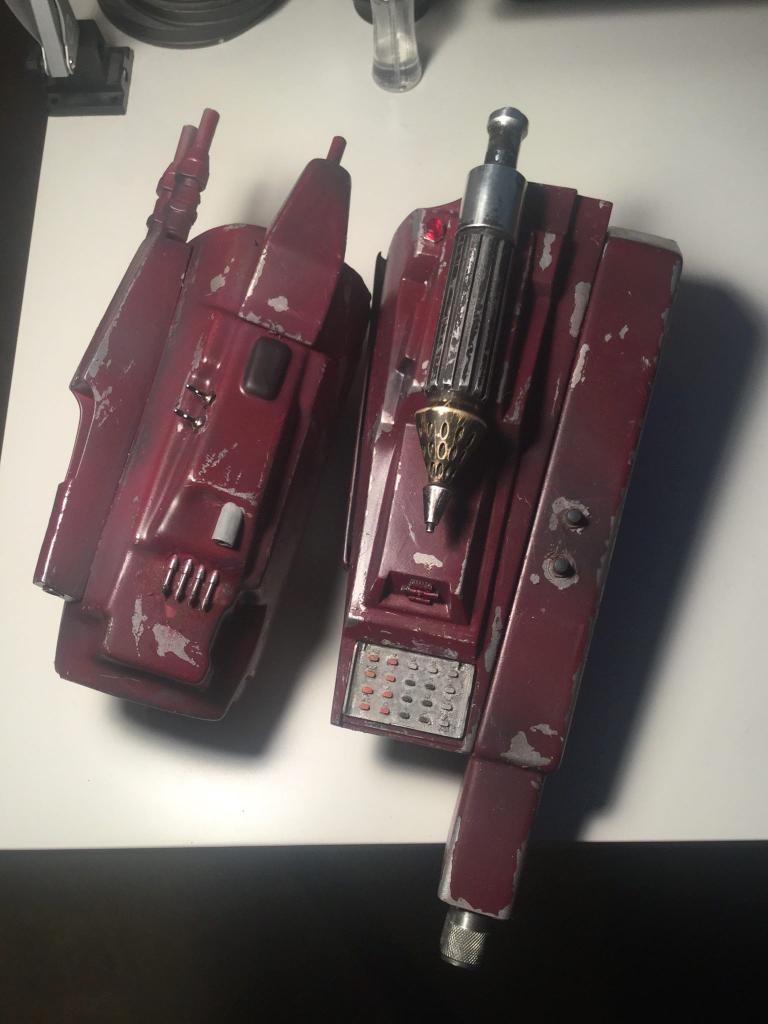

The gauntlets....ohhh the gauntlets. I spent the better part of 9 hours today working on them. They came to me already assembled from FP which was a huuuuge help. Yesterday I had the primer and silver down, along with all the damage masked. So today I had planned to to do...well...everything else. I had Model Master's British Crimson in acrylic for the gauntlets. This colour...was a nightmare. I don't know if it was the bottle of paint (I used 2) or maybe I'm not familiar with acrylics now that I've been working with enamels for so long....but the paint came out looking horrible. First off, the paint in the bottle was UBER thick. I thinned it with water, because it's acrylic, and it sprayed very nice. Issue was that once it dried, it turned into this hideous pink-ish colour....nothing like what I imagined. I thought that the silver was the issue, so I threw down some black and then sprayed the British Crimson again....nope. Even worse...something reminiscent of the 80s. Yuck.
90 minutes of trying to figure this out, 2 bottles later, I just went to my local hardware store and grabbed some Rustoleum Claret Wine. Boom. Went on super fast, and allowed me to make up some time. Coats dried fast, and I was back on the train.
Removed all the masking, then went at it with my enamels for weathering - 140, 79, 33. After it dried, took it in to slice it with my hobby knife.
Added JC27s transmitter to the right gauntlet, added Dakota's rocket (easiest thing ever to paint - sprayed it all matte black and just took steel wool to it), added the gauntlet light, flamethrowers, and foam padding. I still need to paint the hose connectors, install a battery pack for the flamethrower lights, attach hoses, and clear coat. All in all though...a good day. I'm exhausted.

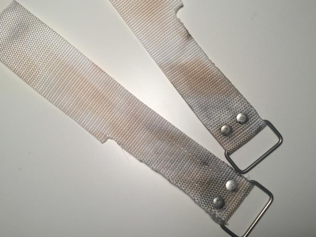

Also, how did you do the straps on your harness?
Which ones? The white ones?
I had white 2 inch nylon webbing from when I bought that god awful scuba backing in 2013. Finally got to put it to use :)
I cut a decent length, and had to trim some off the sides in order for it to fit through the slots on the back armor. This stuff frays, but take a lighter to it and it will seal. I sewed (yes...I sewed)...the D-rings in, along with some JB weld for insurance. I then added some thumb tacks for rivets. I tried to actually rivet the straps shut (to avoid sewing)...but it just wasn't happening. Then weathered. When the vest comes back on Tuesday, I'll line up the jetpack and glue/sew these onto the black straps.
