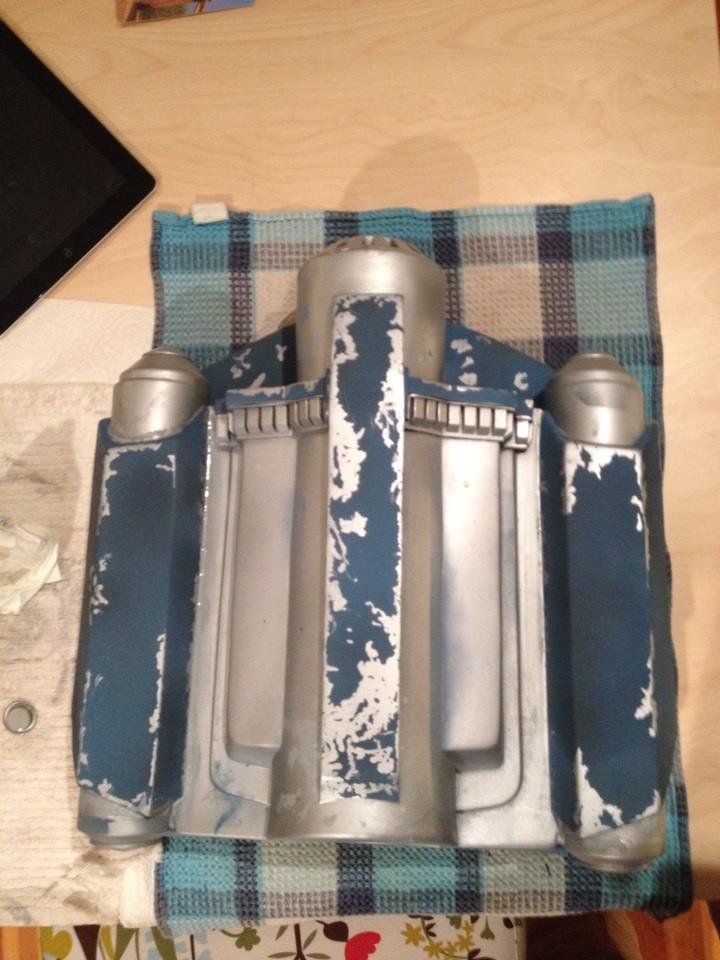

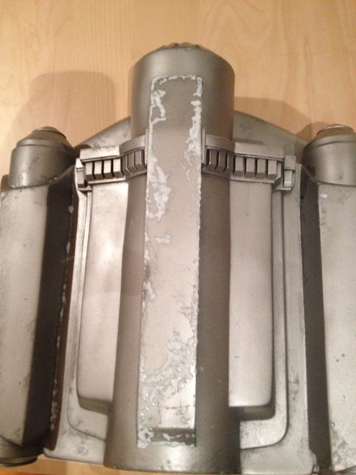

After a few hours of my eyes going wonky from trying to sketch out the damage as best I can, and then mask it all with a toothpick....
Most of it has already dried clear, but you get the idea. Tomorrow I paint the blue!!
Man that has to be a monumental task, all that weathering on those ROTJ jet packs. So far, it looks really good to me. :thumbsup:

What brand of masking do you use?

I have this massive bottle of Fasmask....probably will have that thing forever. Works well, but dries clear with a blue-ish hue...which kinda sucks because it's harder to see where I've put it.

Add some blue water color to it...it'll dry alot more blue and not effect the paint. My graphix masking fluid is the same way

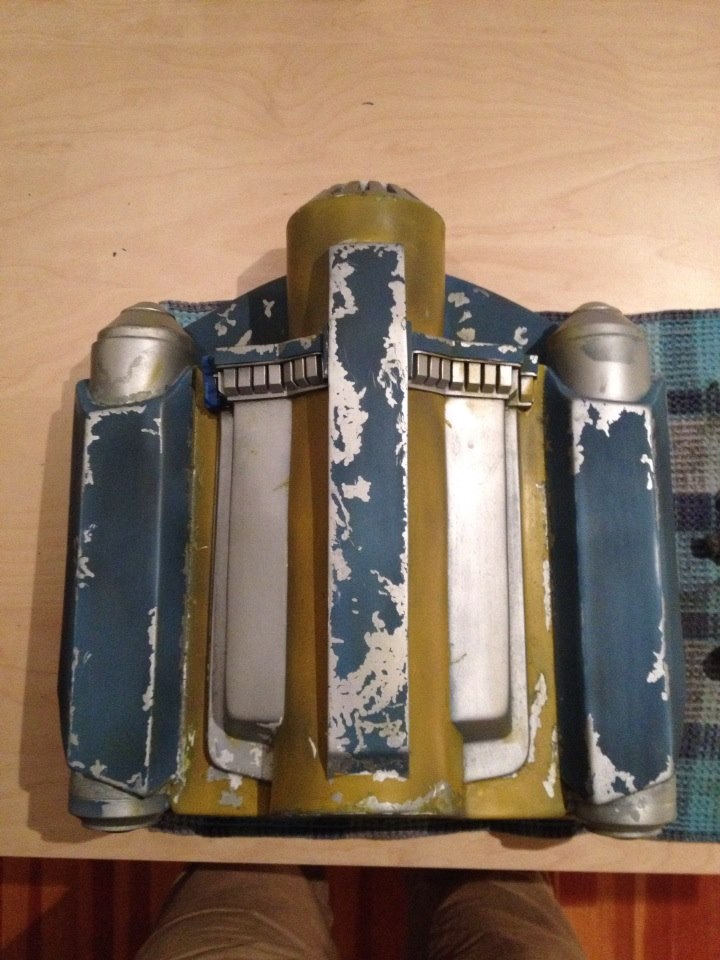

Yellow layer added. Gotta do some touch ups but that can be done during final weathering. Onward to the red and white layers!
Thanks guys! I was a bit worried about the yellow. I didn't want it too vibrant, but now I hope I didn't overkill it with gray. My airbrush was really acting up the last few times. It's a gravity feed internal mixing brush, so apparently gums up a lot more. I had to take the nozzle apart several times to clean...and my instructions didn't really say how to properly take it apart. All good now though.
I still don't think I get the paint consistency right (thinner to paint). That's been the biggest hurdle thus far. Any tips on this?
i get the idea that it's supposed to look like milk but that's such abroad scope of measurement for me.
What brand are you using for paint? I found that the PollyScale paints plugged up my airbrush like nobody's business. It might be the thinner I was using (Tamiya Acrylic thinner). No problems with Humbrol or Testers enamels, or Badger or Tamiya acrylics.
For my Badger Patriot, I found that 1:1 paint thinner for Tamiya worked fine. PollyScale was 2:1 paint to thinner. I tried other ratio's, but it didn't help the clog factor I always got with it. Badger is ok to airbrush straight from the bottle. For Humbrol, I use about 1 or 2:1 paint to lacquer thinner ratios, depending on the paint consistency straight from the jar. I have never tried to airbrush Vallejo paints.
Another option is airbrush restorer. You can get it at the art store. Disassemble your entire airbrush completely, then let all the parts and the body soak in the airbrush cleaner fluid for about 24 hours. It will revive any rubber or plastic gaskets and loosen any and all built-up paint crud from all the nooks and crannies of your airbrush.
I'm using Humbrols. Some of them I find to be a lot thicker than others. The yellow (#154) was a real pain in the ass because it took many coats to get it to the correct shade. I think I've been bouncing between too thick and too thinned. I don't have any means of measuring (kinda been eyeballing - shame on me),...I need to find little plastic cups that have numbers on them. That might help ;) I've been able to clean my airbrush pretty good the last two times, so it's now more a matter of getting the paint right.

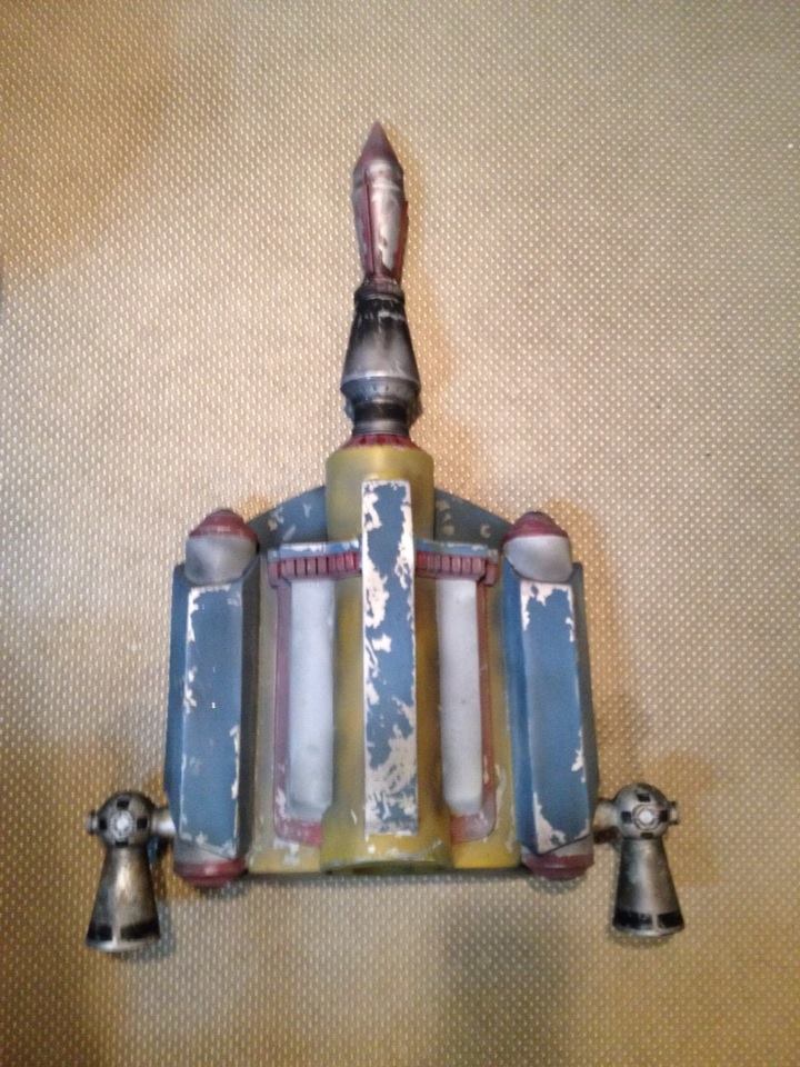

White layer and overall dusting done. Still gotta do the scratches and add decals and greeblies (becon, stabilizer,etc.) but getting close!
