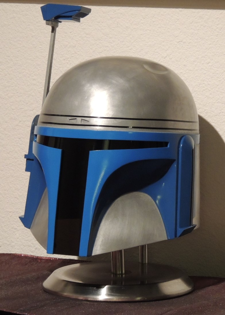

The outer surface is aluminum cold cast, and then that is backed with fiberglass cloth and resin.

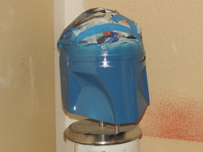

Here are a few in progress paint pictures. After covering the inside of the visor also with tape, I draw light lines with a sharpened pencil using the contour of the check to guide the pencil to separate the two areas. Then I use 1/8" blue stripers tape to tape off the part that will remain CC and fill it in with blue painters tape.
Then I use the same stripers tape to tape around the rf curve and place small pieces of tan masking tape (stickier) in small sections as I go to hold down the stripers tape.
When that's done I mask off the rest of the areas with the tan tape and newspaper.
When painting, I keep the coat thin and paint the areas that are going to be blue to give me a smooth surface for the lighter blue. I prefer to do the darker blue first so that the lighter blue is raised a bit and because it's easier to tape off the darker blue sections later using the 1/8" stripers tape and following the contours.
Also, a note on the ear pieces. Usually even after sanding, little air bubbles and small dots randomly form where the paint will not stick. So I usually spay a thin coat, and then use my finger to lightly rub those areas filling in the small bubbles with the paint. Then I go back and give the ear pieces a second and thicker coat that will smooth everything out and makes the paint stick in those initial troublesome areas.
After this, I won't touch the helmet for an entire week. This is very hard to do but critical to minimize tape indentions when taping off for the second color. However, I will probably bring it inside the house after it has aired for a few days due to the cold outside temperatures. In the meantime, I prep the rf and paint it as soon as possible. Hope this information can help someone.
-Lorenzo
