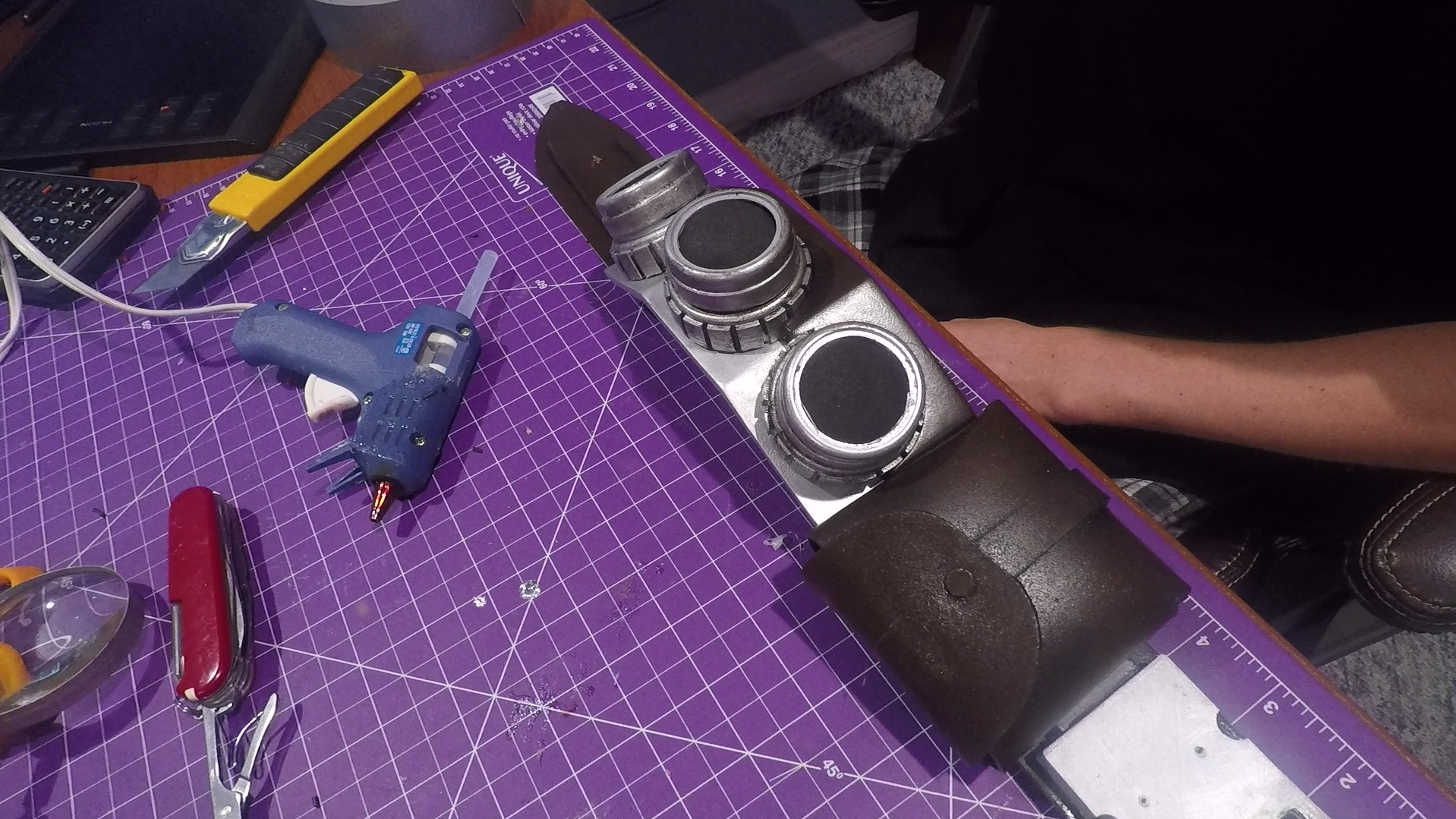

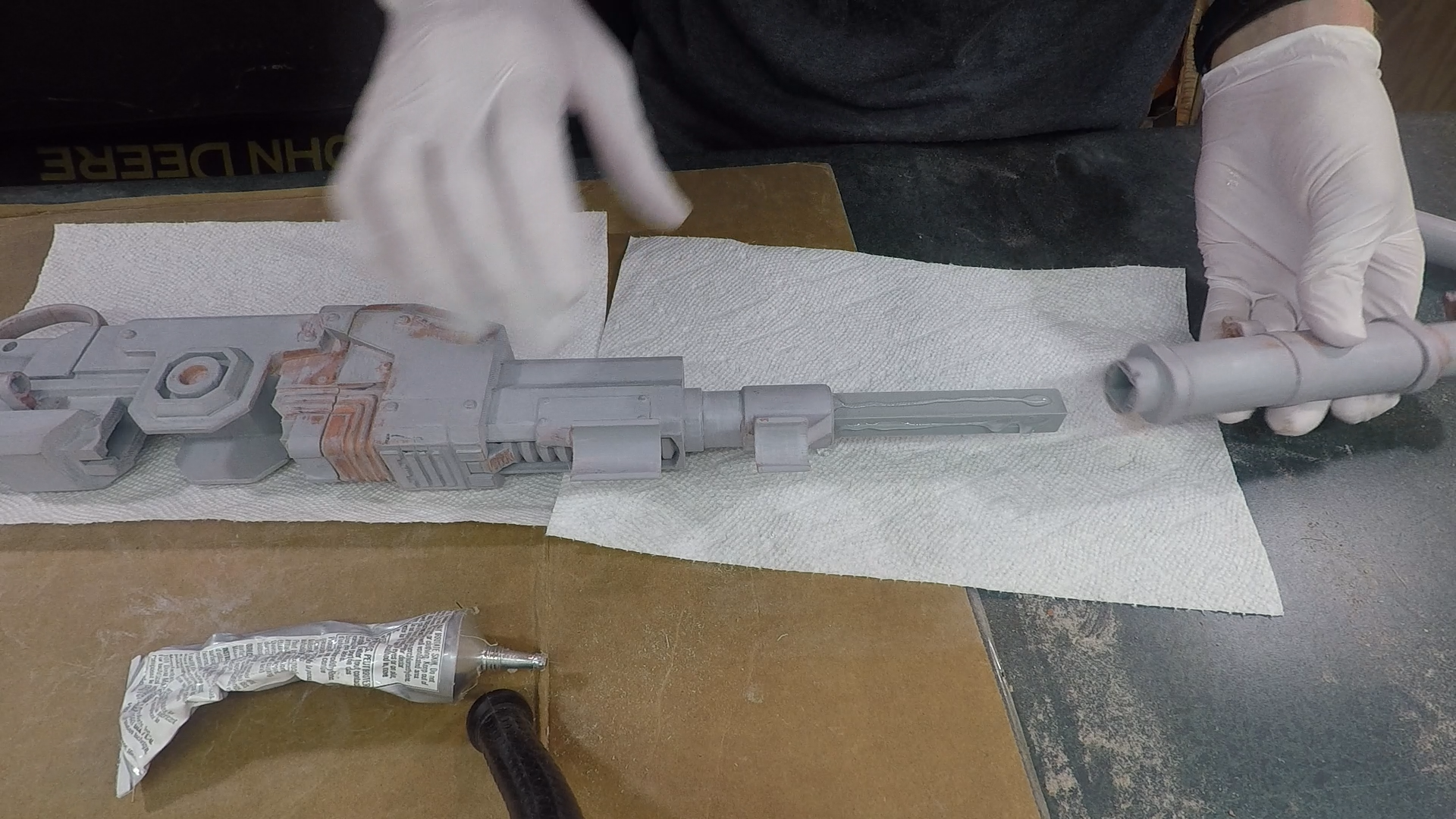

I then sanded each piece, gave them all a few coats of filler primer, and sanded them again. I also used some bondo spot putty to help fill in some larger defects.
I also removed the narrow cylinder bits from the barrel of the gun because they were getting in the way of sanding. I'll add those back on later. Anyways, Glue! I used e6000 to stick it all together. OddWorks (the designer of the model) made square inserts to put inside the gun to securely hold it together and align it, and they really helped with assembly.
And of course now I have to fill in those gaps. So.... more spot putty and filler primer!

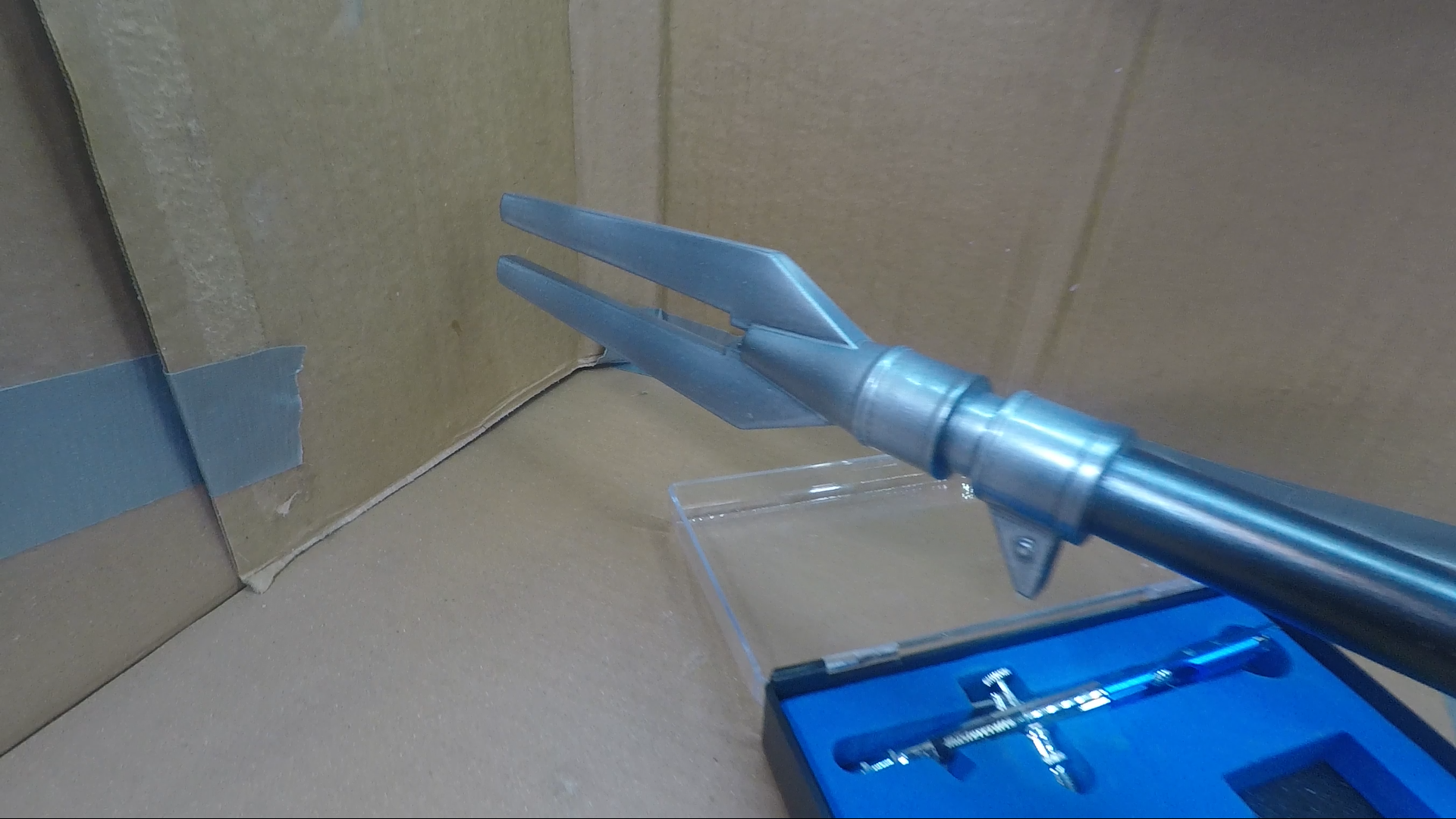

Yayayay!! Now for paint, which frankly is the part I usually suck at. First thing I did: a base coat of black
Now for the silver. I don't have money for nice paint, so here's what I did. I used a $20 airbrush and some dollar paint. I thinned the paint out with isopropyl alcohol and believe it or not, it worked! Tried my best to leave some shadows in the middle. I've never really used an airbrush like this before to this is pretty good for a first try I think!

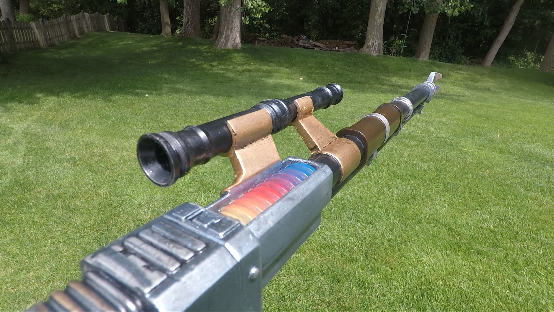

Then I used some gold leaf and silver leaf rub n buff. the gold was used to paint a few detail bits, and I used the silver along all of the edges and on the screws. It gives it a bit more of an authentic metal look I think.
I also used the airbrush to try and to the coloured bit at the end. Apparently when metal is heated up, a layer of oxide forms which distorts light, giving metal that coloured look. Didn't know that until I just googled why metal turns this colour. Again, I just used dollar paints water down with alcohol.

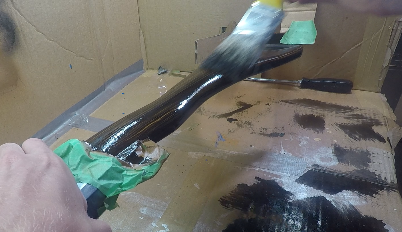

Now here's one of the coolest things! The wooden bit at the end. How will I paint it to look like wood??? I found this AMAZING tutorial on YT:
I think it's the easiest way to paint something to look like wood. Step 1: apply a base coat of "Warm Caramel" Spray paint. (Unfortunately this colour isn't available in Canada where I live, but I have connections to some American buddies that went shopping for me. couldn't go myself cuz, ya know, Canadian border's still closed. It had to come across with some essential workers ;p)
Step 2: Use a large brush to paint on "Dark Walnut" wood stain. Add lil swerlies and squiggles for a more authentic wood look!
In the light it looks AMAZING!! Can't believe its' so easy to make plastic look like this!

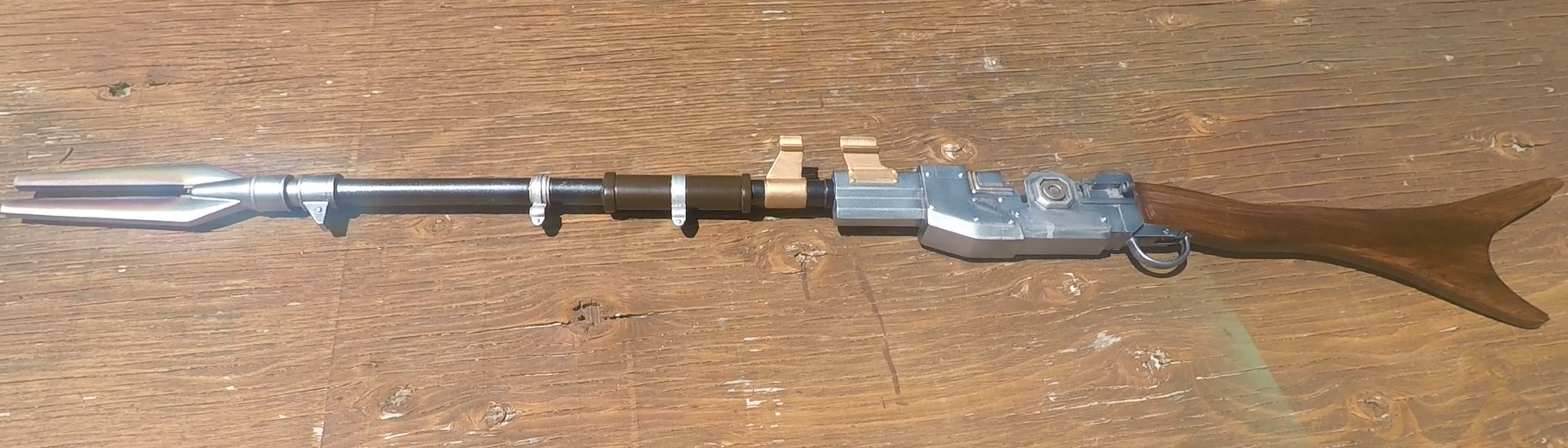

Remember the pieces that I took off earlier? Well now It's time to add them back on. I just used some CA glue.
Also put in the Mag and trigger. There's a little spring activated mechanism designed into the model, which means the mag is removable and the trigger moves too! All nicely painted and weathered of course

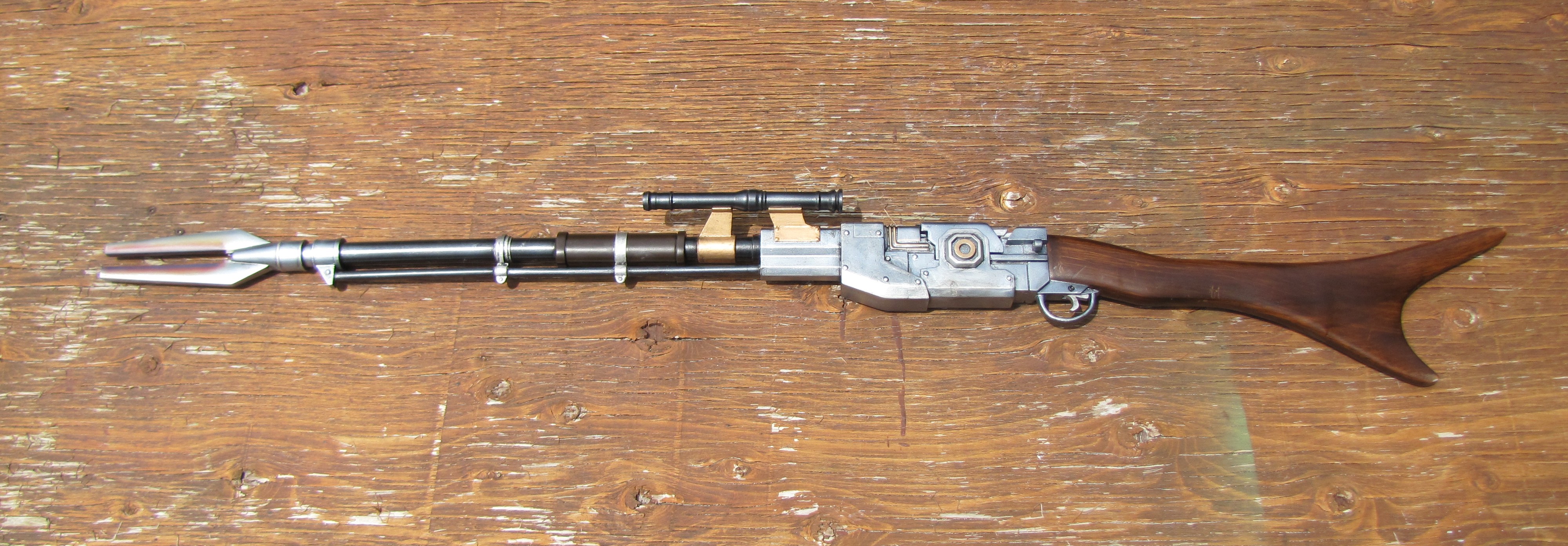

and with that... the gun is finished!!!
Pretty cool eh?
